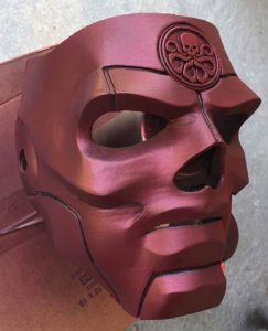

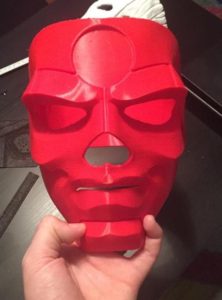

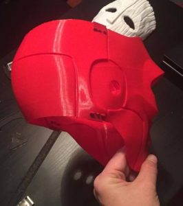

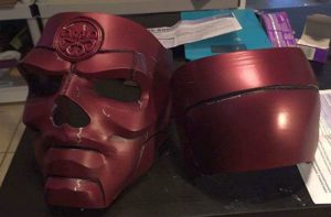

I reached out to one of my most frequent collaborators, @Graphic Jordan, and got him on board. He then put his 3D skills to work on drafting the base helmet. I took his initial shapes and marked up some decorative seam lines and details.
He then went back to the model and began interpreting my ideas.

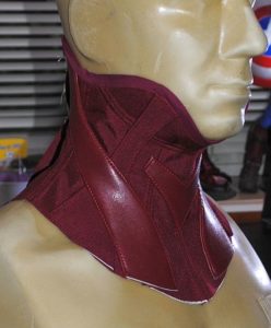

While we were discussing the helmet, I began working on the neck piece that will go with it. I created a template by making a tape mock up on my trusty Ed Head and drew out some preliminary details.
This tape was cut apart and I made a base pattern for the piece out of Swedish tracing paper. I built up the base in red cordura and then made a working mock up in the tracing paper to design the details.
I decided I wanted the neck to have a somewhat organic feel but also look mechanical. So, I began to work up a design that would incorporate some very structured elements that followed the anatomy of the neck. I then began playing with creating these elements in my usual style of covering 2mm craft foam with materials and layering them onto the base.

After reviewing the neck, I decided to make a few changes to the design in the front. The "Adams apple" section seemed too large and odd, so I took it down a notch and am much happier with the new version.

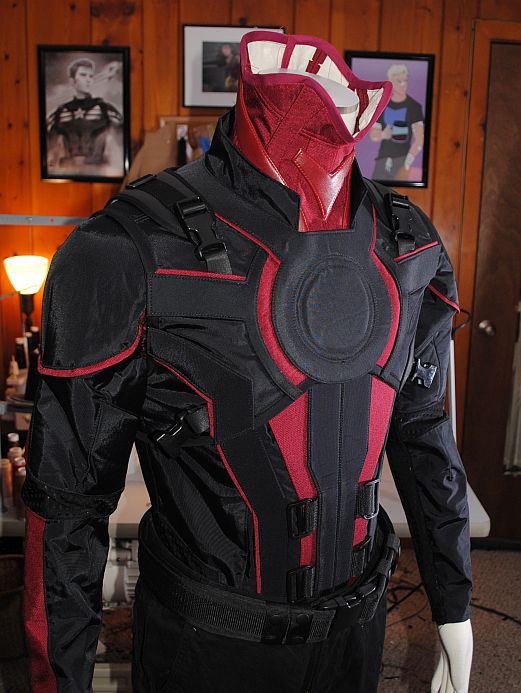

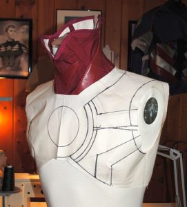

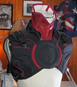

With the base neck complete, I began working on the chest and torso. This costume is being made as a companion piece to my most recent Cap project, so I want to design it go align with the Cap but not be a copy.
I worked up a muslin chest pattern that would fit the neck and then began sketching out the details. Once I had the design figured out, I began building up the details using craft foam covered in cordura. I also wanted to have the harness for this costume integrate directly into the chest, so I included the buckles as well as some red piping into the chest 'armor'.

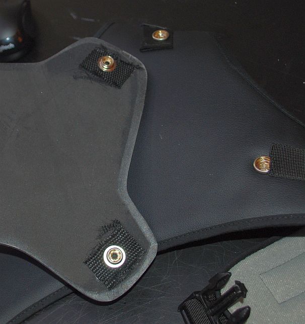

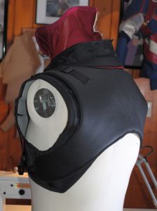

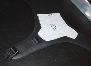

The next step was to develop the harness that would fit onto the back of the chest piece. The harness was drafted on the form to match the shapes of the vest and an additional layer was traced out to form the 'backplate' that's still in development.
The harness base was cut from black faux leather, backed with headliner foam and the edges bound with twill bias tape. The upper straps were then added using the template for the backplate that will be the outer layer of the harness.
Here are images of the chest and neck with the harness as it is now.
In the meantime, the helmet from Graphic Jordan is looking awesome and I'm super excited put it with the rest of the suit.

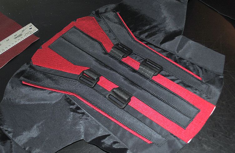

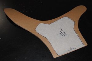

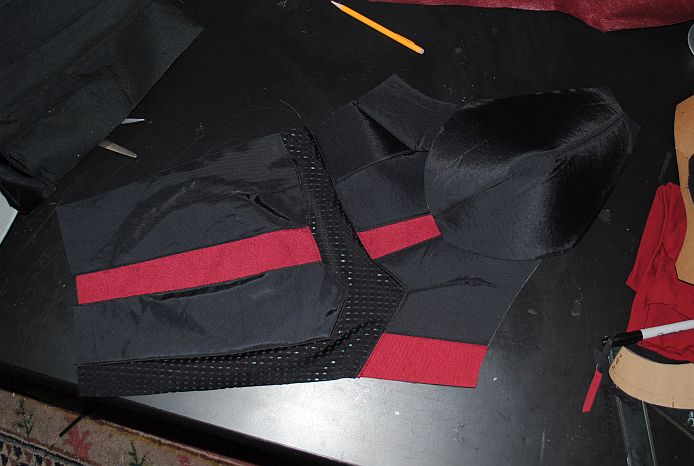

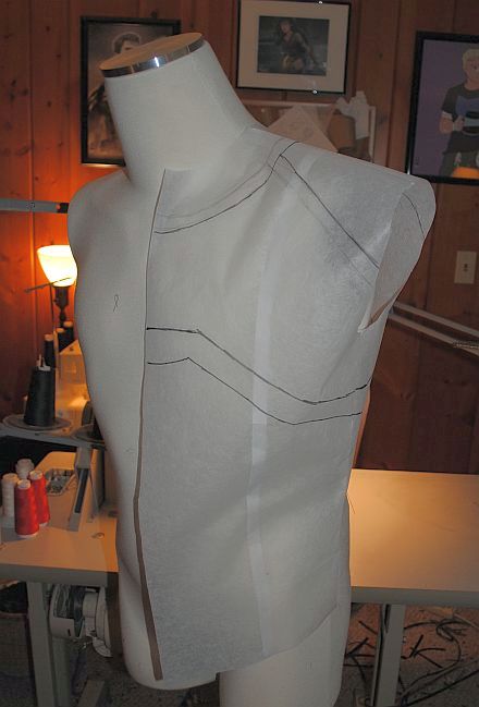

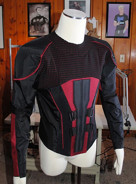

I created a base sloper for the for the torso and marked it up to match the chest. This was then used to map out the details.

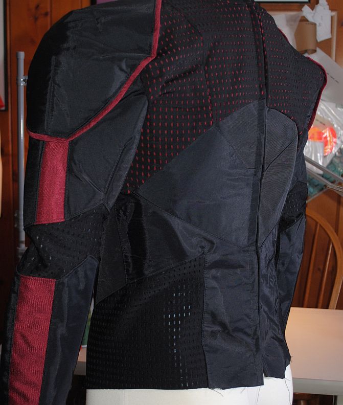

The torso was built the same way as the chest. I created a base and then used 2mm craft foam and cordura to build up all the details and layered 'armor' look. There are also stretch areas at the sides and the top is all stretch under the chest for flexibility.
Originally, there were going to be straps that went around the torso and created a kind of 'tactical bondage' look. However, after I got the whole thing together, it just was too much and so they were edited out.

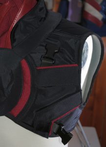

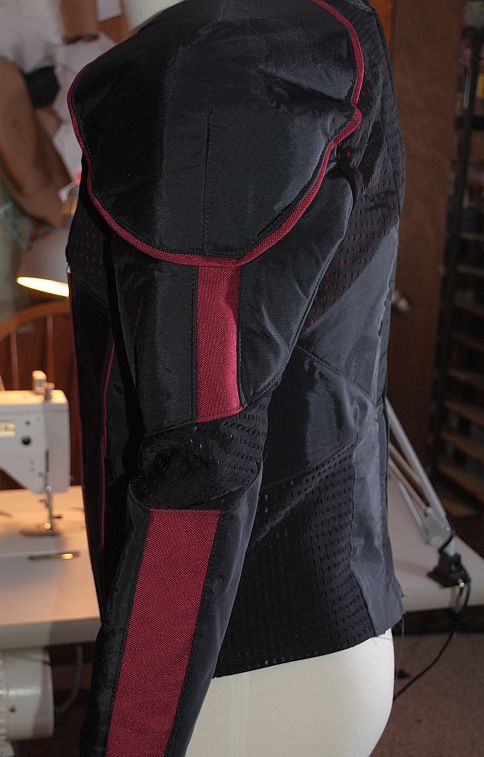

The sleeves were built based on the Armor Cap pattern and featured piping on the shoulders, stripes on the outer arms and stretch sections for movement. These images show the sleeves being constructed and the assembled torso.
Here is the torso with the chest added.

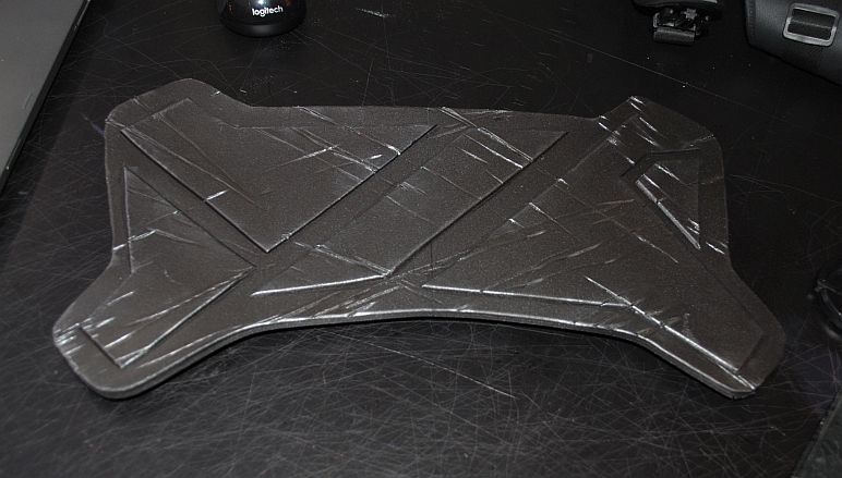

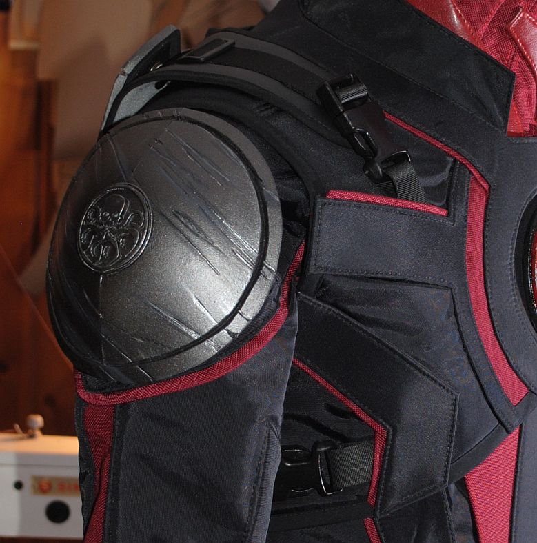

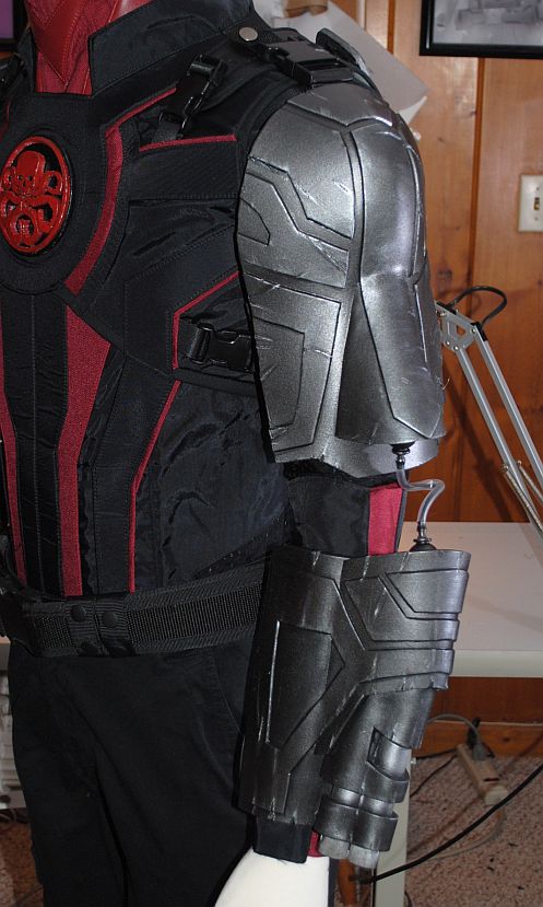

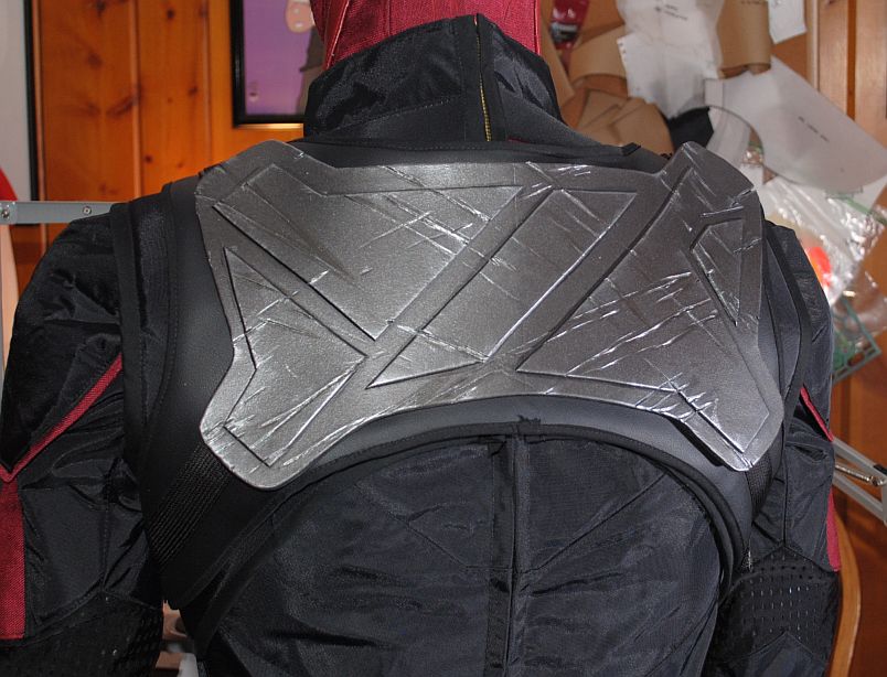

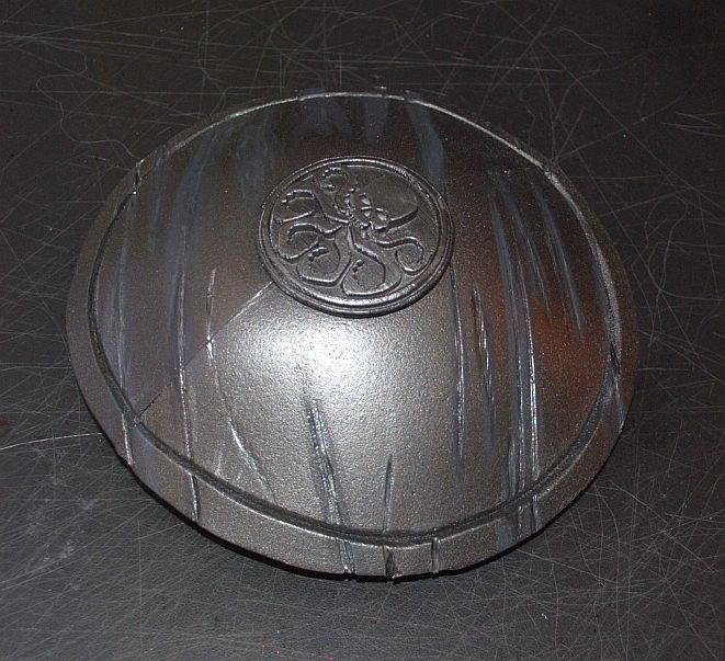

Next, I wanted to create some armor pieces as accessories. I made a back plate for the harness and a shoulder piece for the right arm. These were created with 6mm craft foam that was Plasti-Dipped, scratched up with a dremel and painted.

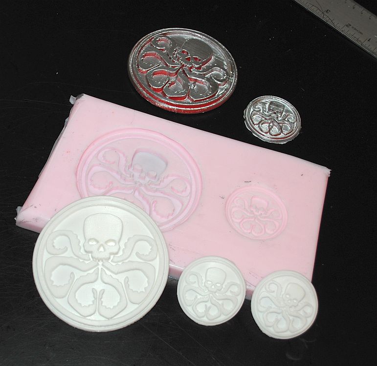

The Hydra logos were modeled and 3d printed by Graphic Jordan in two sizes - a large one for the chest and a smaller one for the accessories. These were then cast in resin and curved to fit the pieces.

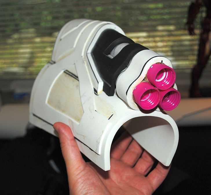

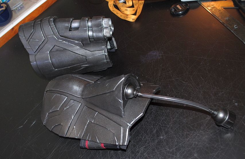

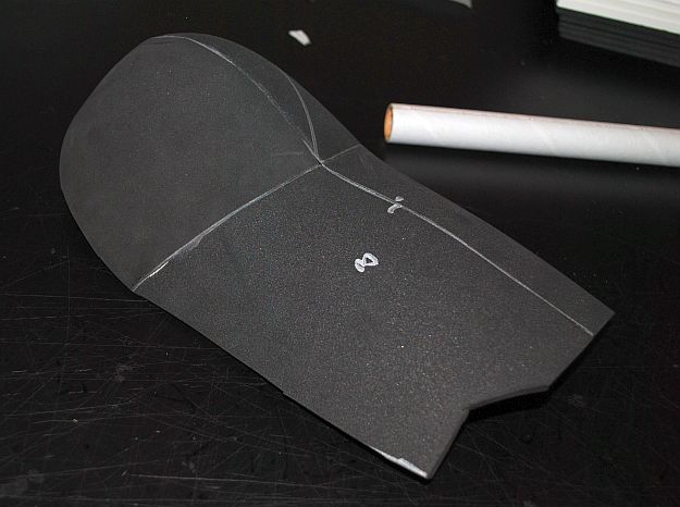

I decided that Red Skull needed a weapon that rivaled Cap's shield, so I decided that I would outfit the entire left arm with my own 'Hydra weapon'. I began with the base shape for the upper arm. This was built from 6mm craft foam using the Winter Soldier arm template I created and heat shaped to fit the shoulder and bicep.

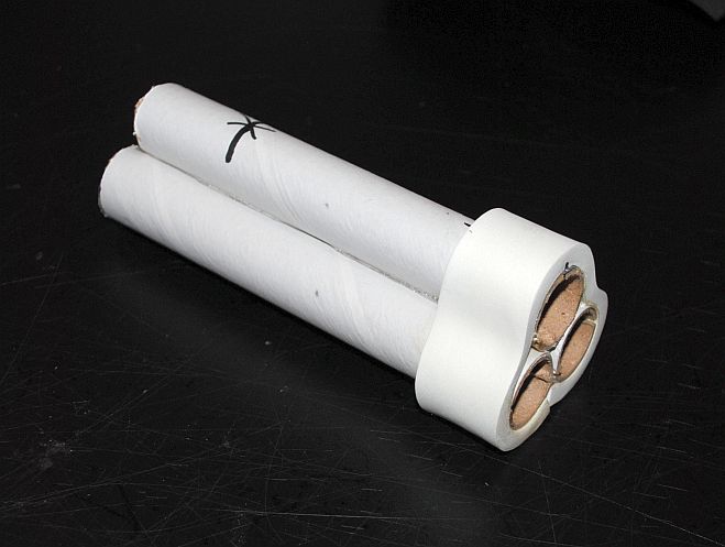

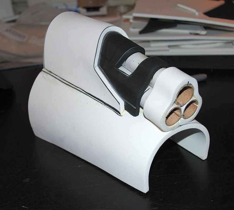

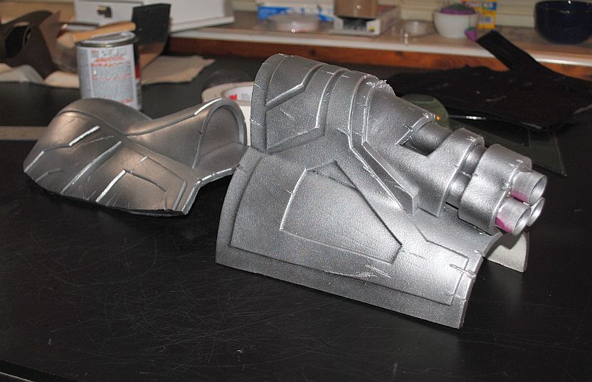

I then began creating the lower arm which would become the main part of the weapon. I used some cardboard tubing I had to hand to create a triple-barrel and then added some foam details. This was then added to a foam base and casing layers added on top.
The muzzles for the barrels were made from the tops of old fabric paint bottles (seriously) and some 2mm craft foam details were cut and added to both the upper and lower arm sections.
Once all the details were done, the pieces were Plasti-Dipped, scratched up to match the other pieces and base coated with silver.
I created a connector for the two sections using some plastic garden hose parts and rubber tubing. The pieces were then detail painted and the straps added to connect them to the arm.
Here is the finished Hydra gun arm on the costume.

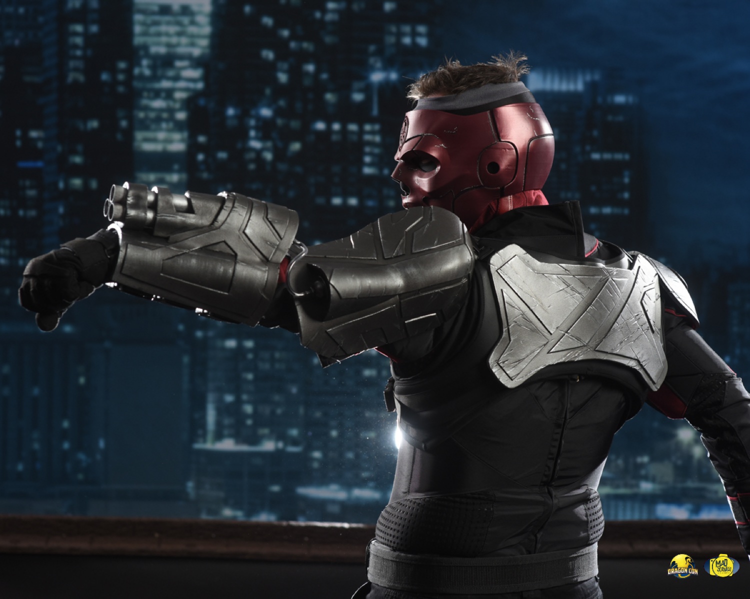

And, finally, here's a shot of the whole thing in action (VFX added in Photoshop).
