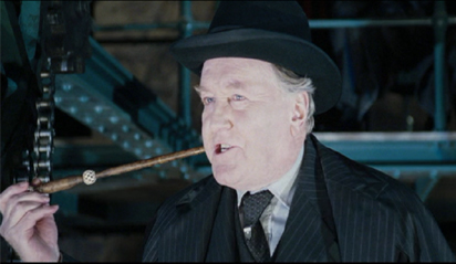

The prop is very similar to Cornelius Fudge's wand from Goblet of Fire: View attachment 774312
Perhaps they reused parts? Who knows?
Wow, I never noticed that before! It’s possible they might have even reused the same moulds (although having said that, the handle on Fudge’s wand looks slightly different) Nicely spotted though! [emoji3]

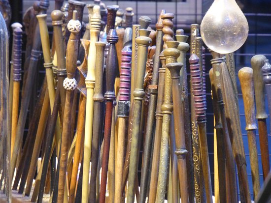

This photo (not my own) from the WB studio tour shows some of the generic background wands, along with some character ones. The one to the mid-left looks like it could be flitwick's, though it could also be Fudge's. Thought I might be able to help, great replica!
That’s awesome, thanks Rnmld91! [emoji4] Unfortunately the photo doesn’t seem to be showing up in your post (it’s just a blank square with a broken image symbol inside it :-\ )
No problem, the image shows up fine now.
Yep, that definitely looks like Flitwick’s wand. The details on those two balls look very different to how I imagined them on my replica, and we get a great view of the handle which we didn’t before. Thanks again! [emoji4]
