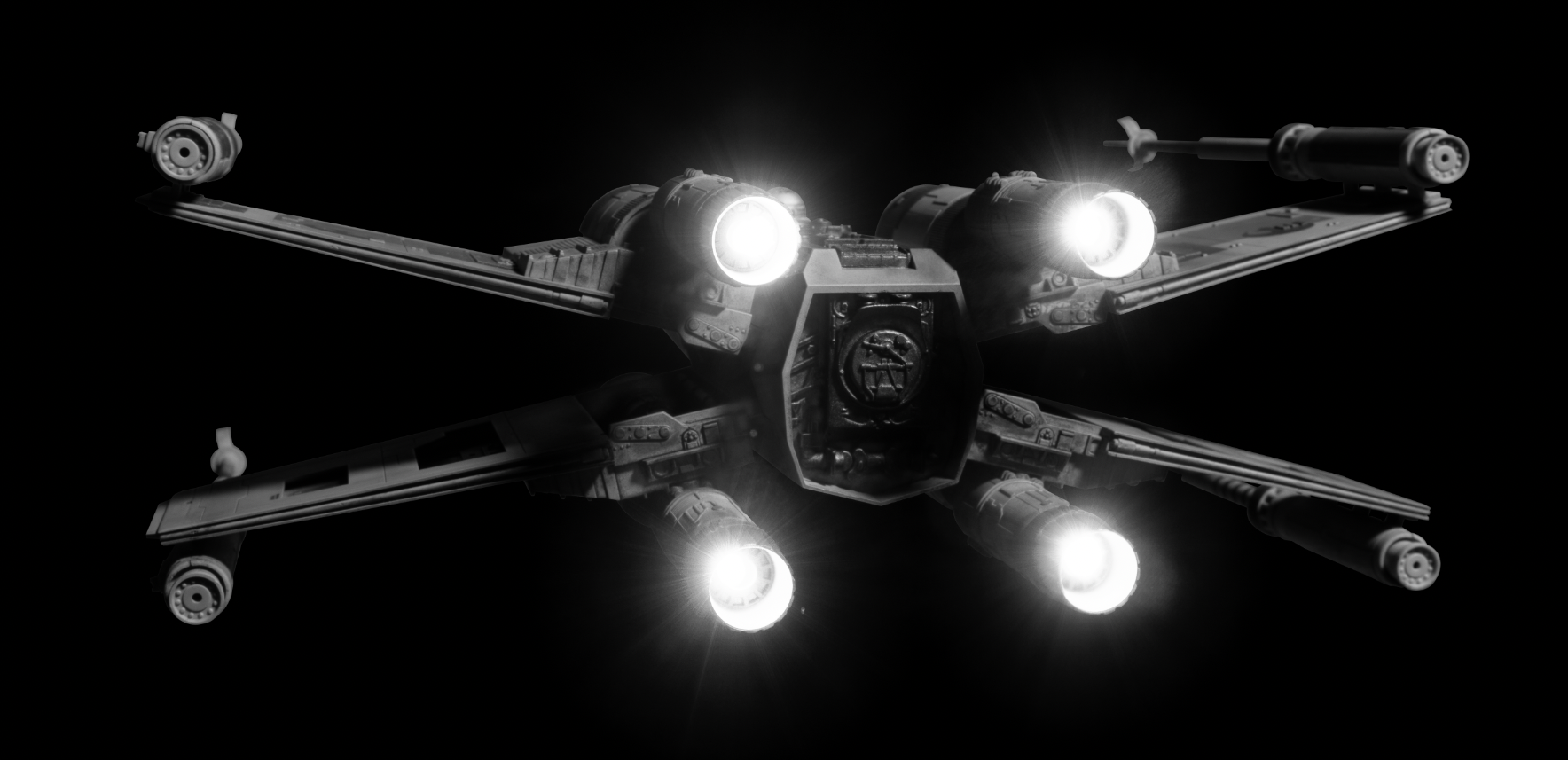

Thanks for the advice, everyone. The prints for the engine nozzles came out great! This is definitely the direction I am gonna go with this bird. I placed one of the nozzles on the engines and took a quick photo. This is just after it was cured, straight off the printer, so it's kind of hard to see the details. I shot all four (well, I actually printed five of them just in case something happened with one of them) with some primer late last night, and the details just pop! I am going to try and get a coat of paint on them tonight and I'll post some more photos.
SB
