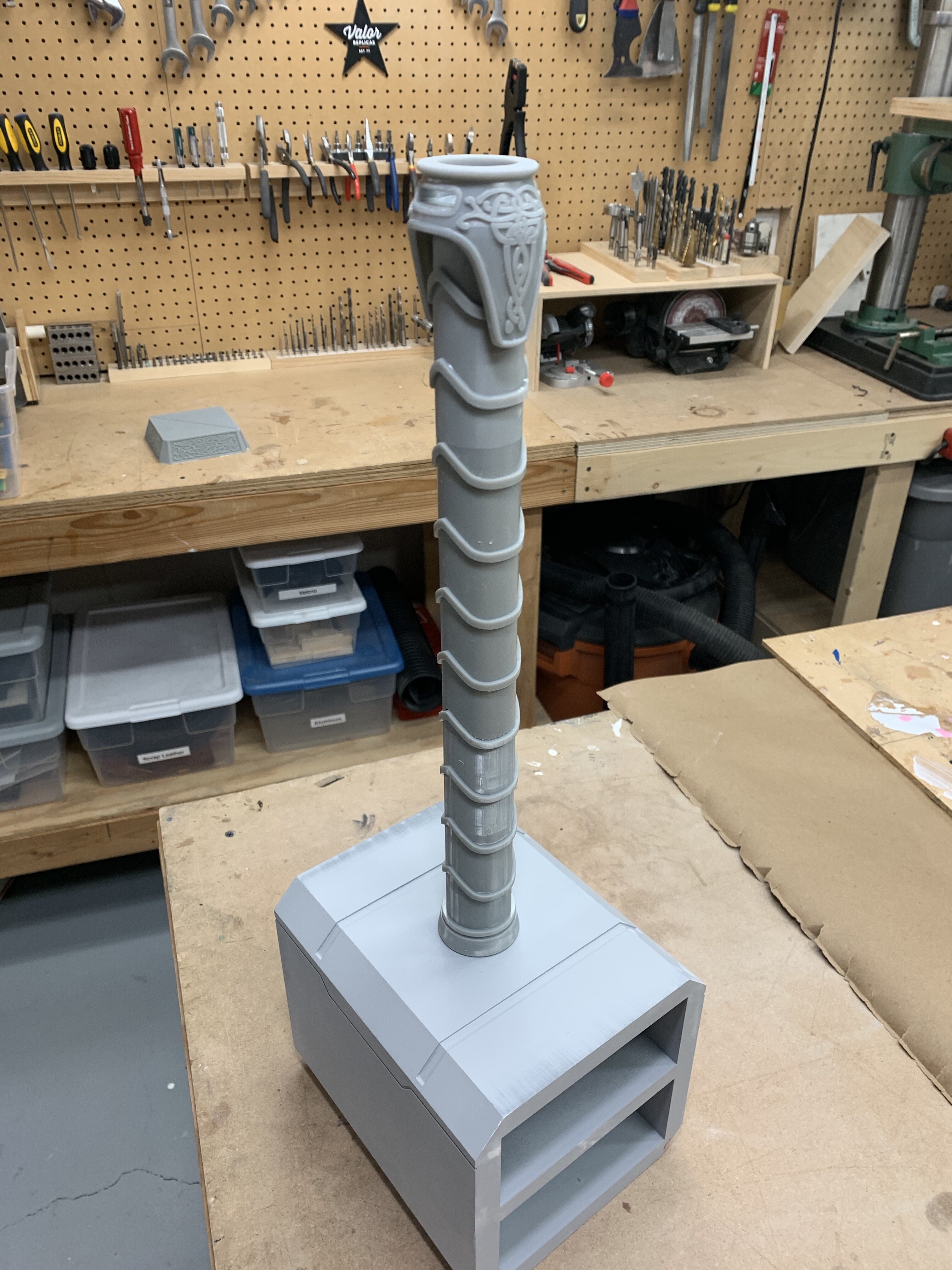

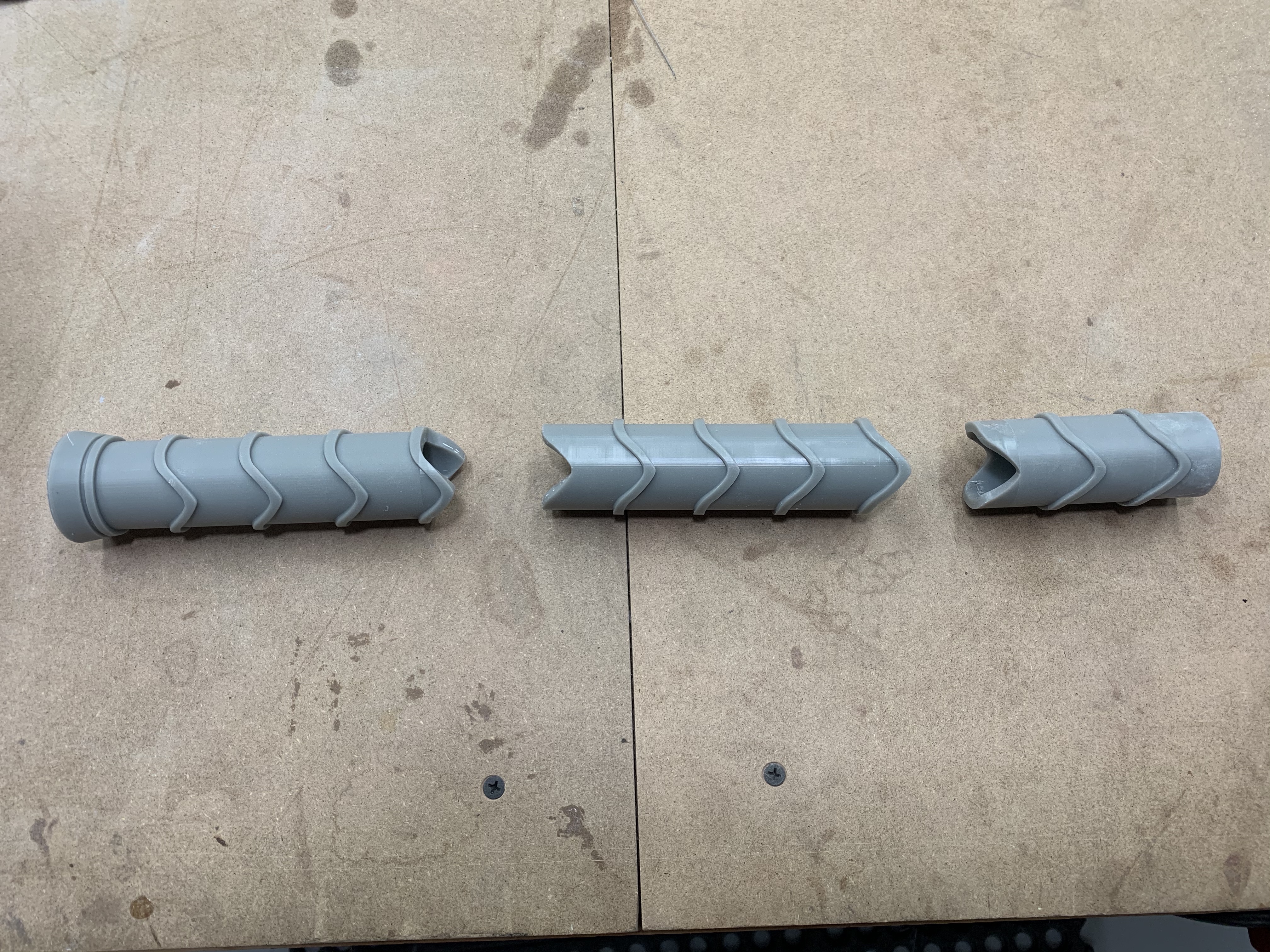

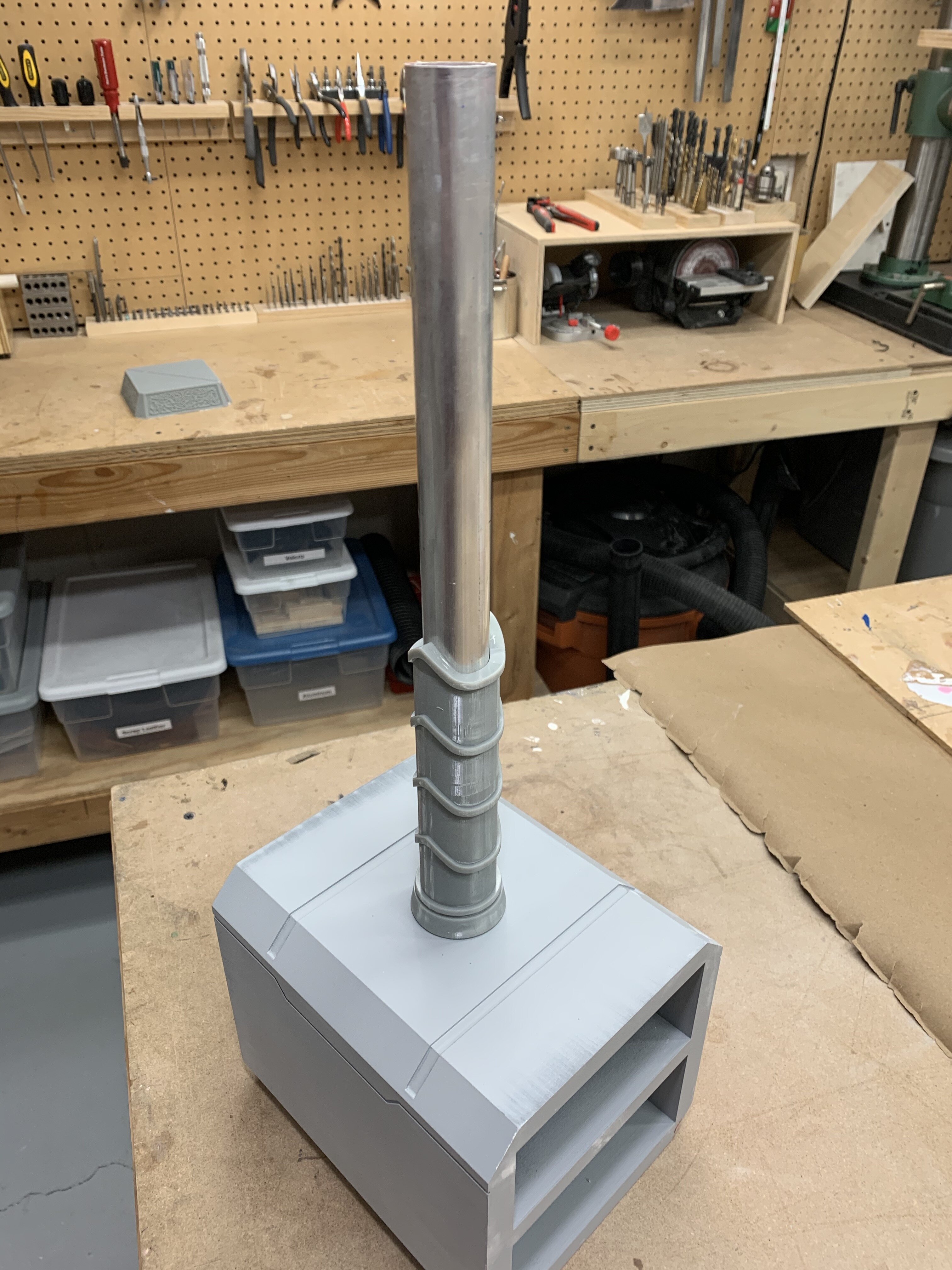

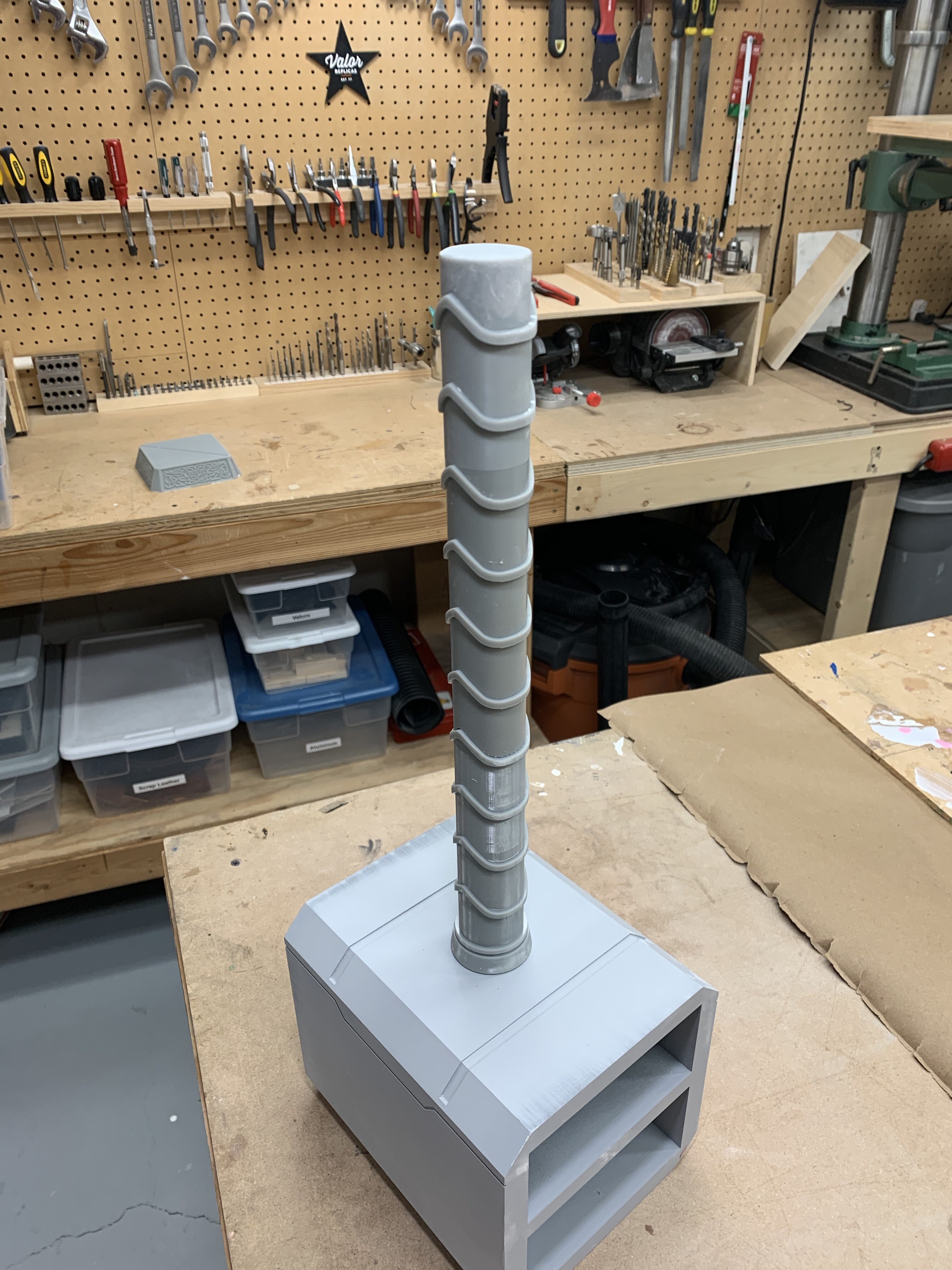

Working through the parts. The handle is split into three pieces that fit together over a 1" aluminum tube. I might merge the end pommel with the end part of the handle and reprint. Not sure yet.

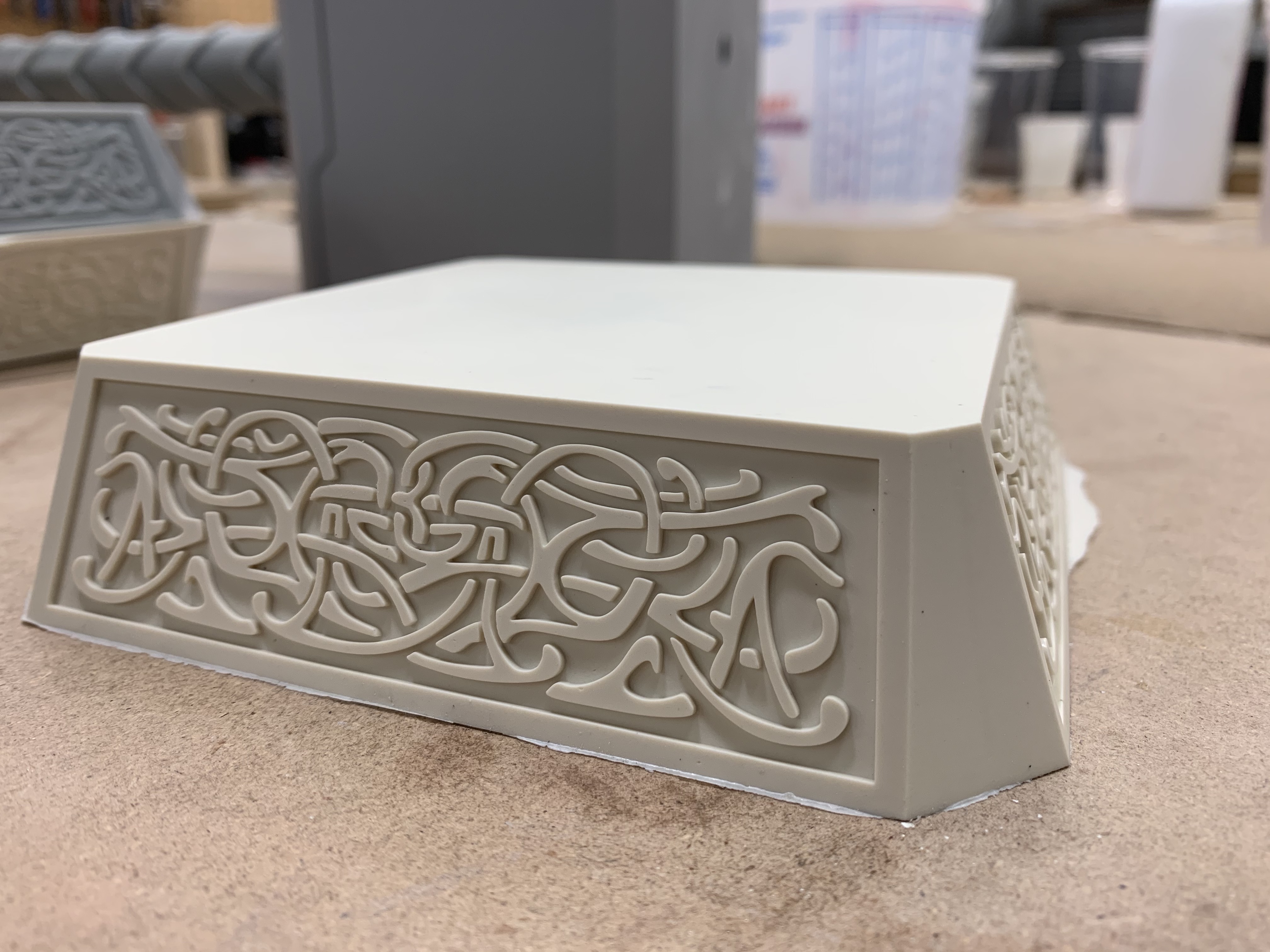

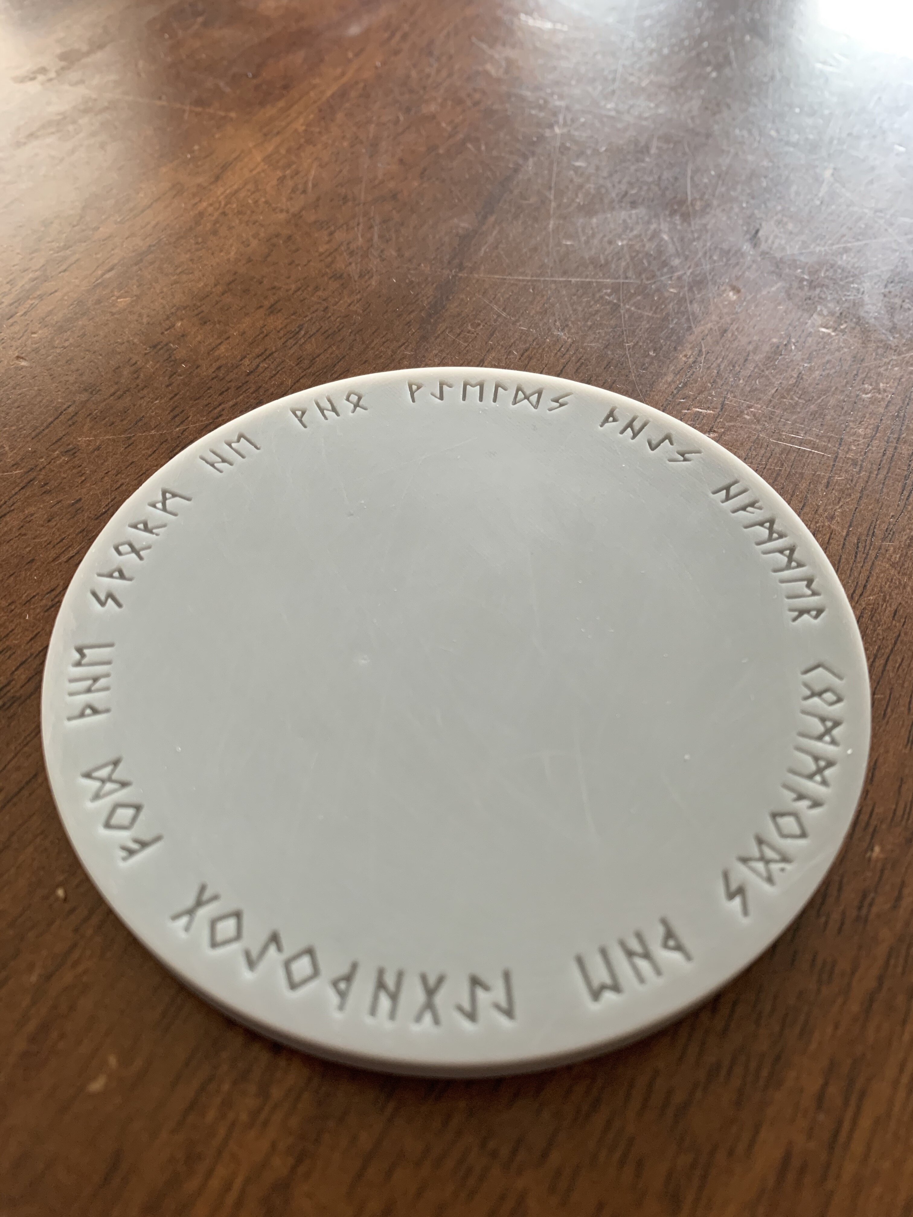

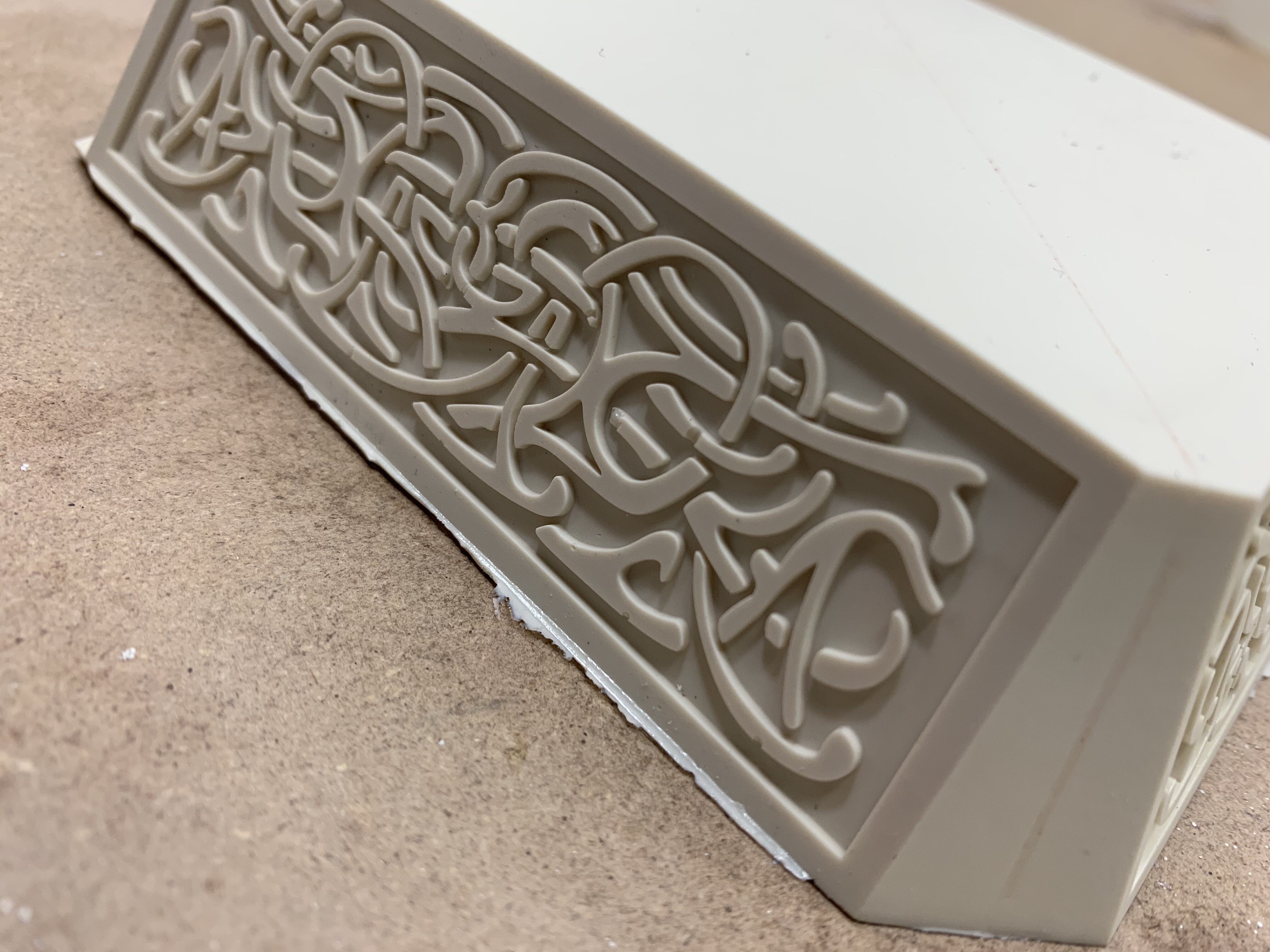

I created a mold of the hammer head I printed out. My plan is to cast the two heads in solid resin .. nice and heavy. But I'm getting a few bubbles in the engraving details, even when pressure casting. Going to try dusting the mold with baby powder and see if that helps.
Nice progress! The modelling on the hammer looks spot on. Are you planning on using real leather for the handle?

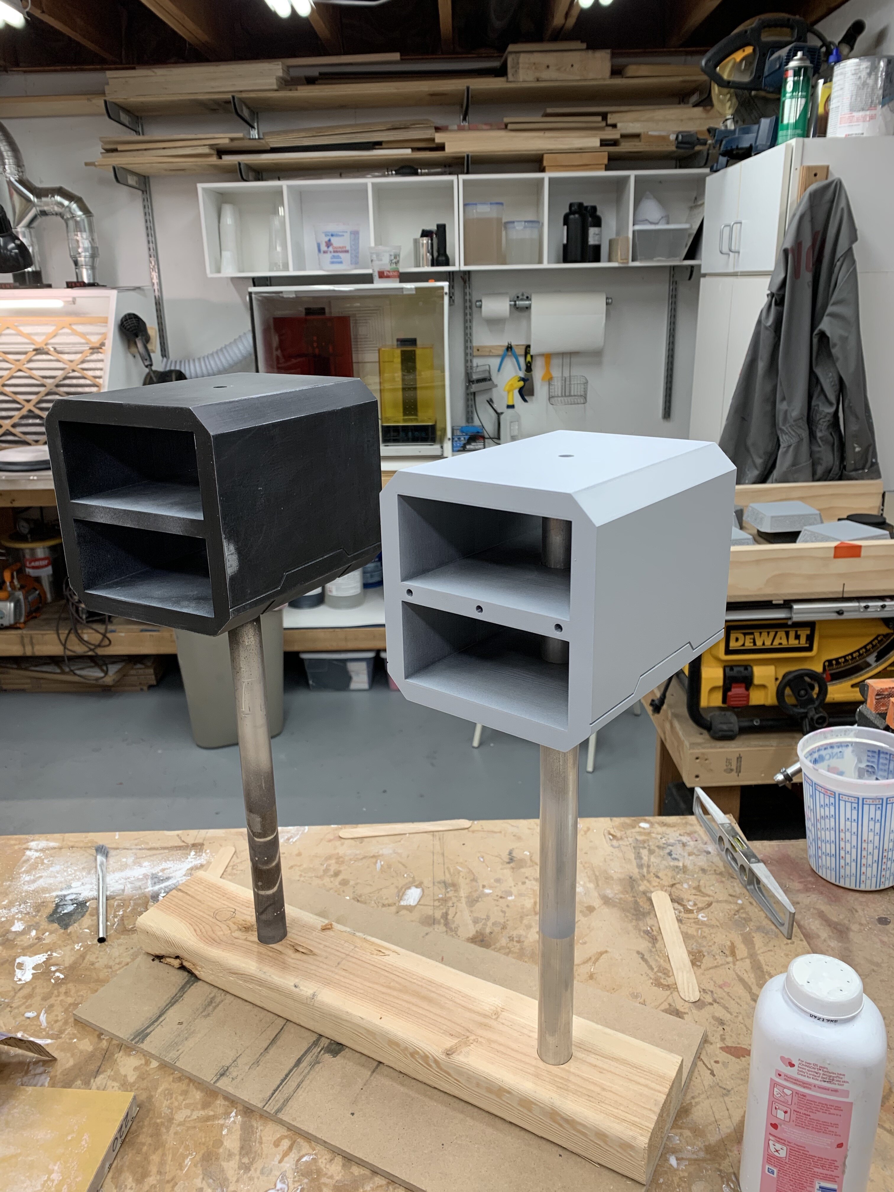

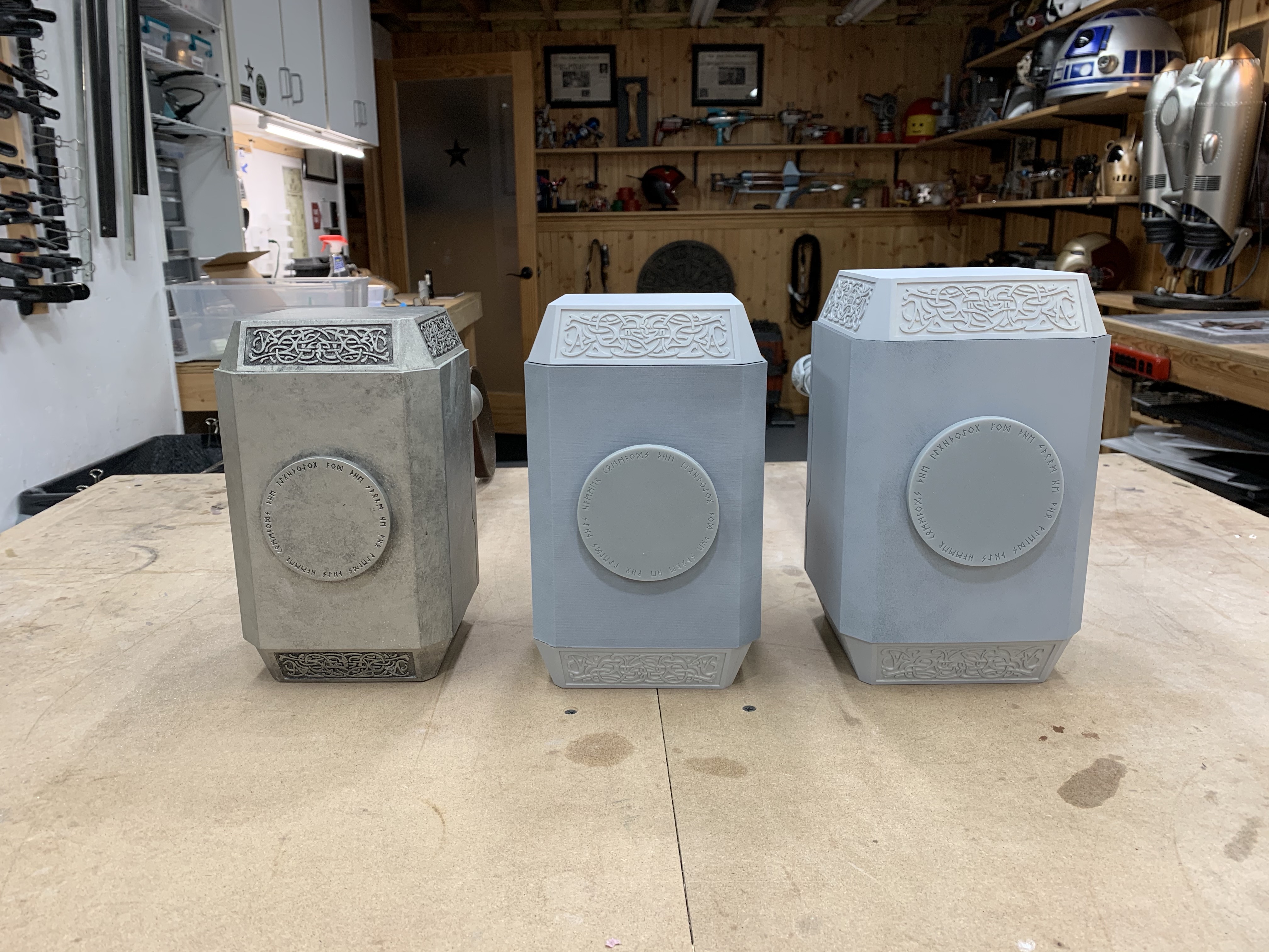

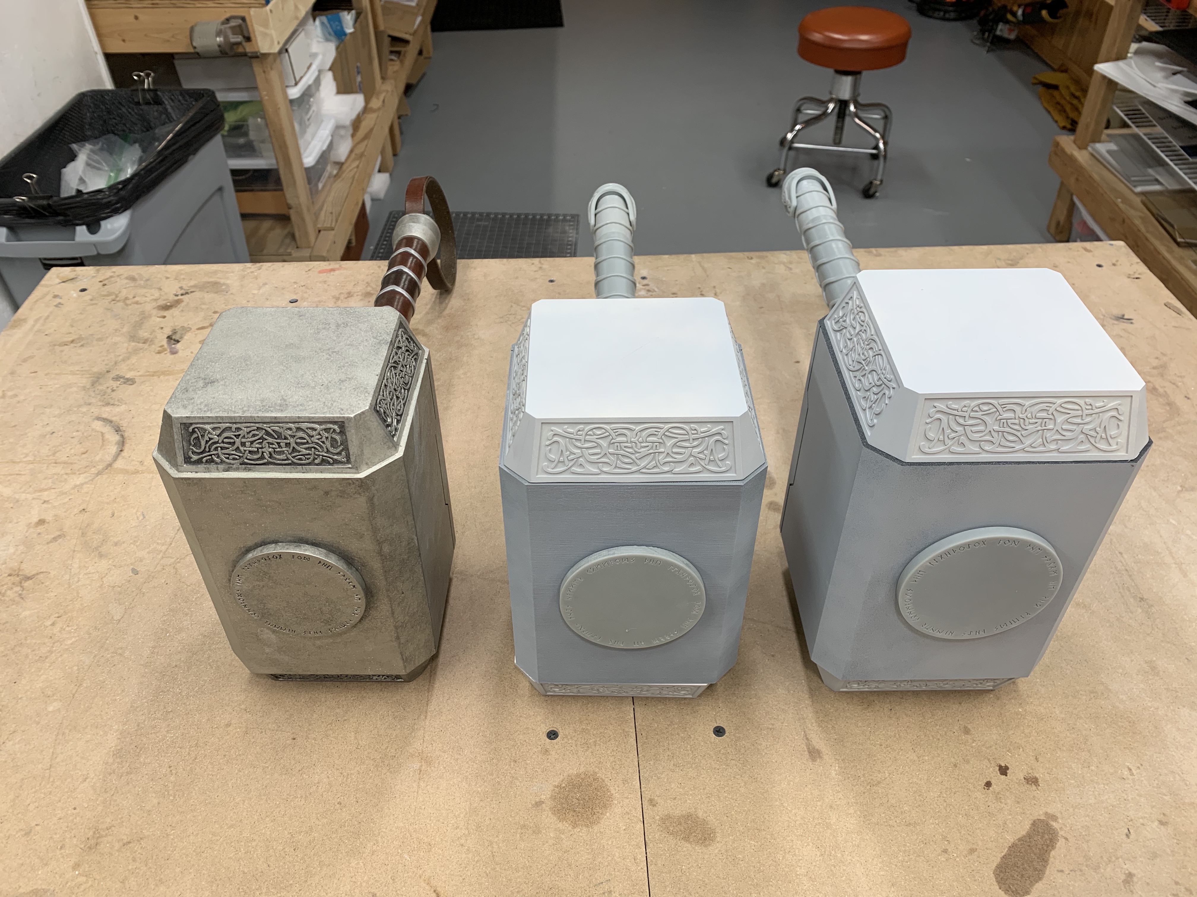

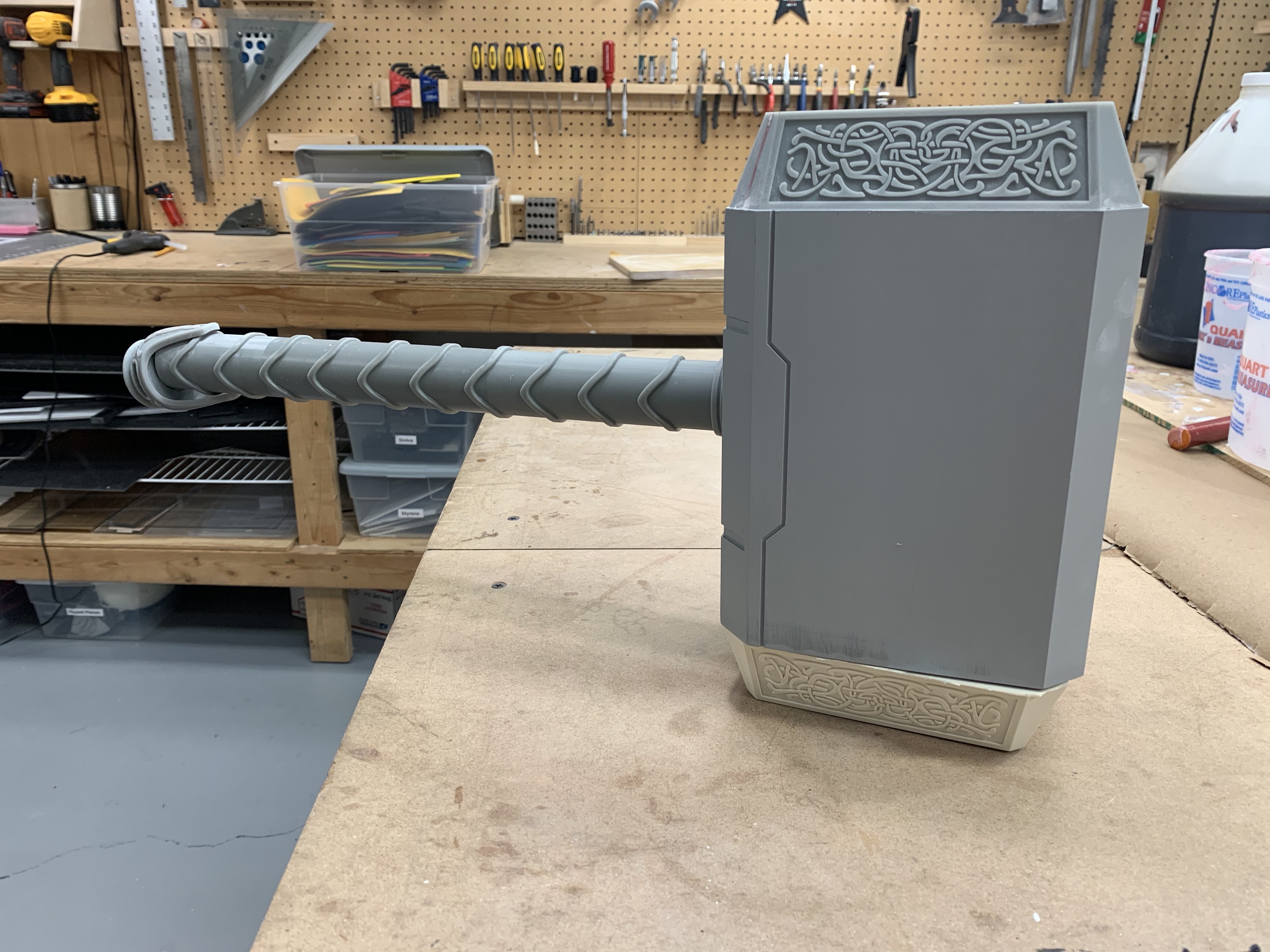

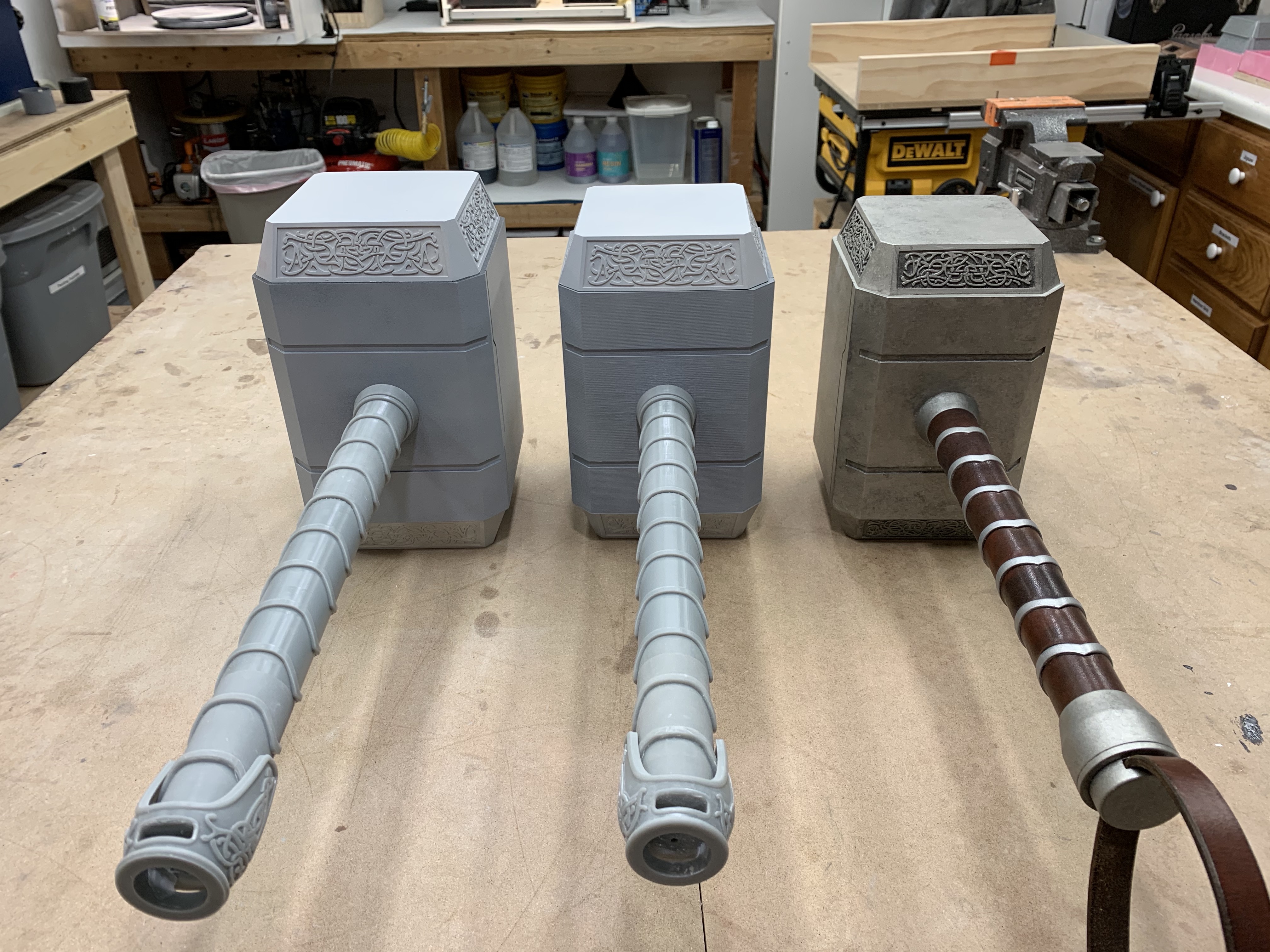

So, here's the current problem. I am not impressed with accuracy. Here are pics of three hammers in various stages. Small, Medium, Large.
Small: My scratch-built Mjolnir from 8 years ago. It's too small. Head size: 230mm x 130mm x 130mm
Medium: My new file, which is the accurate dimensions of the screen-used Mjolnir: Head size: 235mm x 140mm x 140mm
Large: Also my new file but scaled up to what I thought was accurate: Head size: 250mm x 150m x 150mm
What's the problem. I friggin LOVE this big hammer! Ad so does the customer who ordered it. But I wanted to make mine ACCURATE ... but the Medium (accurate) one ... feels .... smalllllllllll. The Large one feels like what Cap was holding in the final scene in Endgame!
Having a real internal argument here. Would I rather have what was technically used on-screen, or what it FELT like on screen?

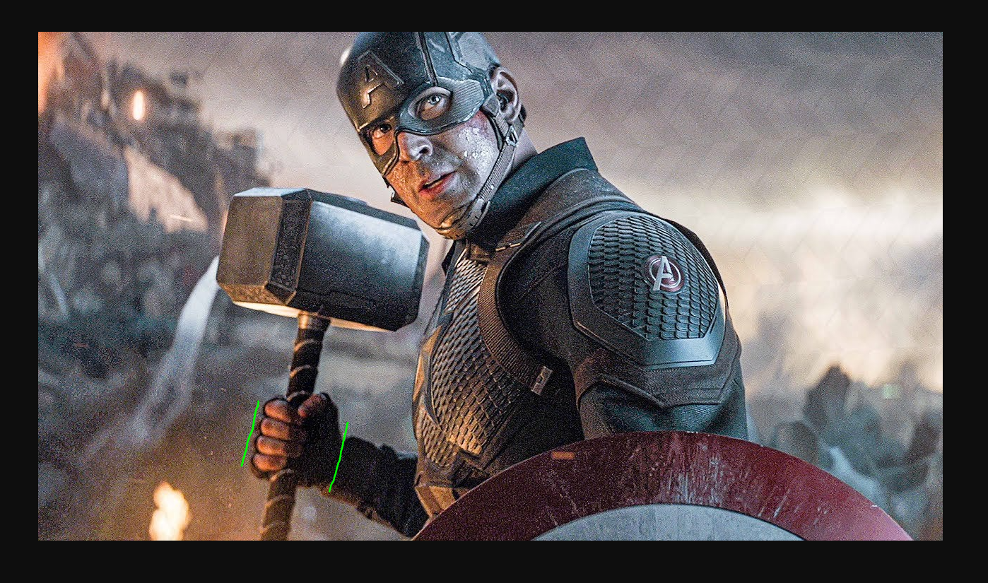

to be honest if you take a look at the hammer in cap's hand in endgame, it actually isnt that big...
the head of the hammer actually isnt that big.
also in ultron...
hemsworth has a large hand and the length of his fingers span almost the entire end
Totally fair points. Maybe it was the contrast of seeing the HUGE one first, which made the real one seem small ... uh, that's what she said.

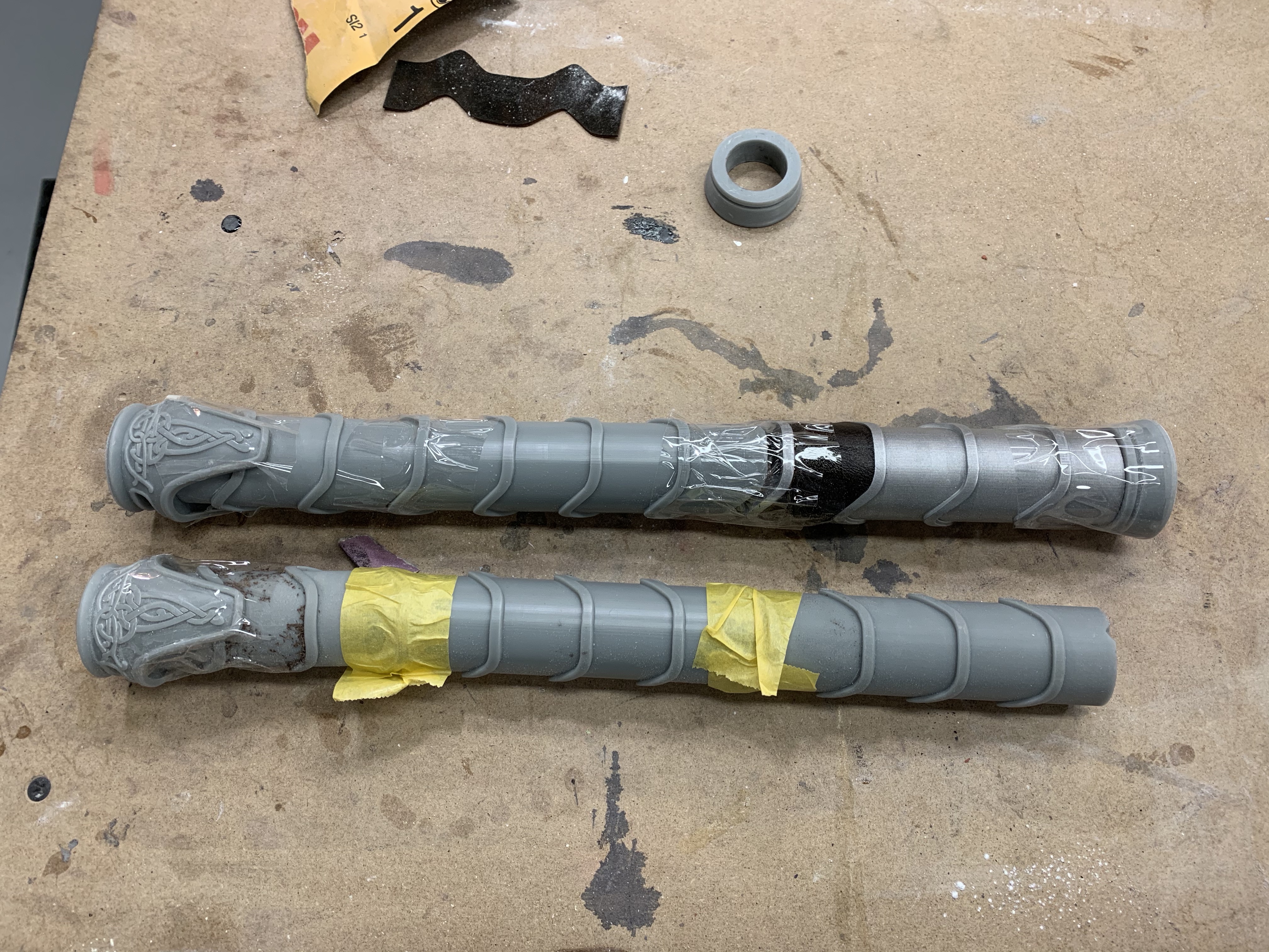

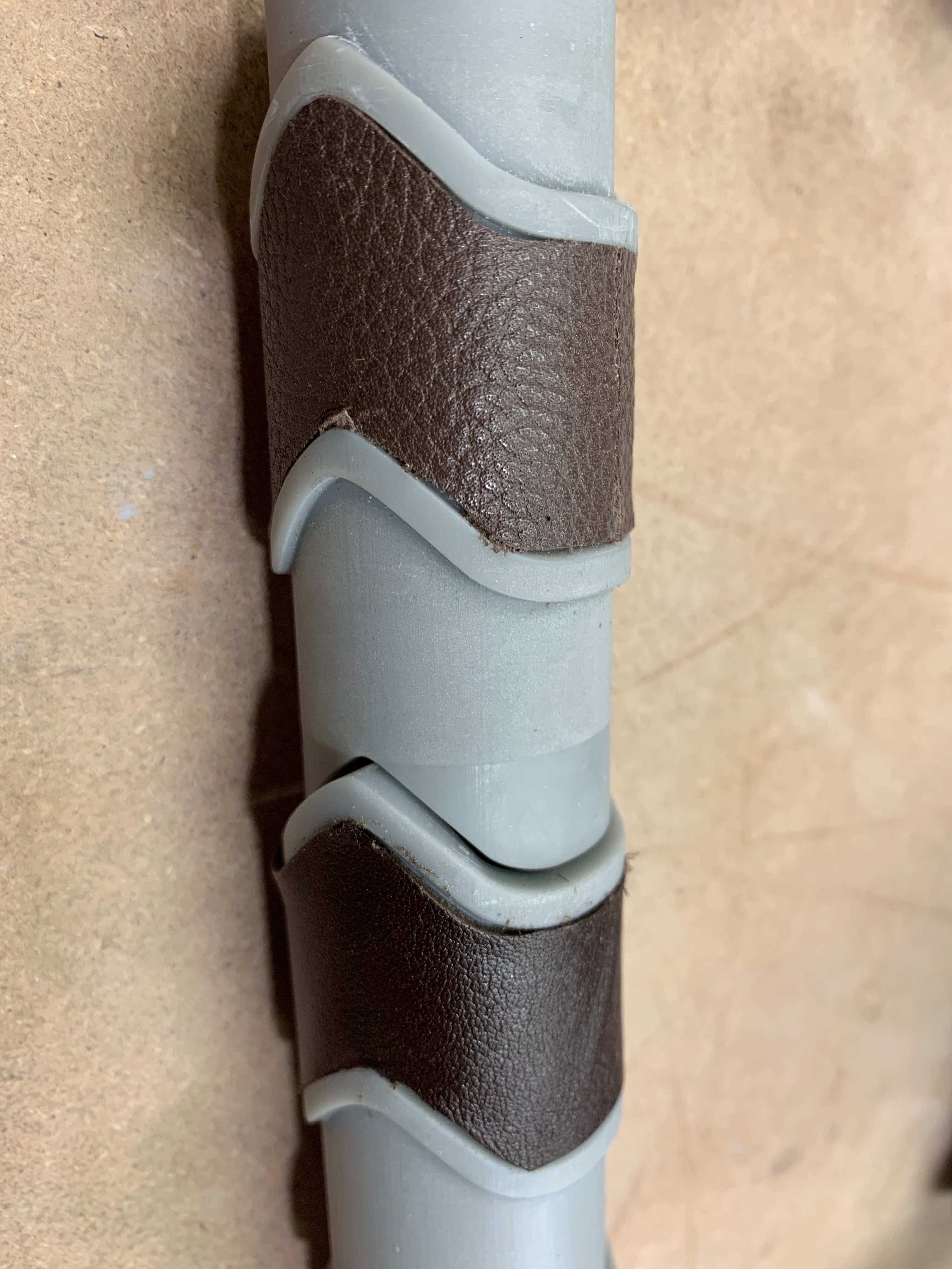

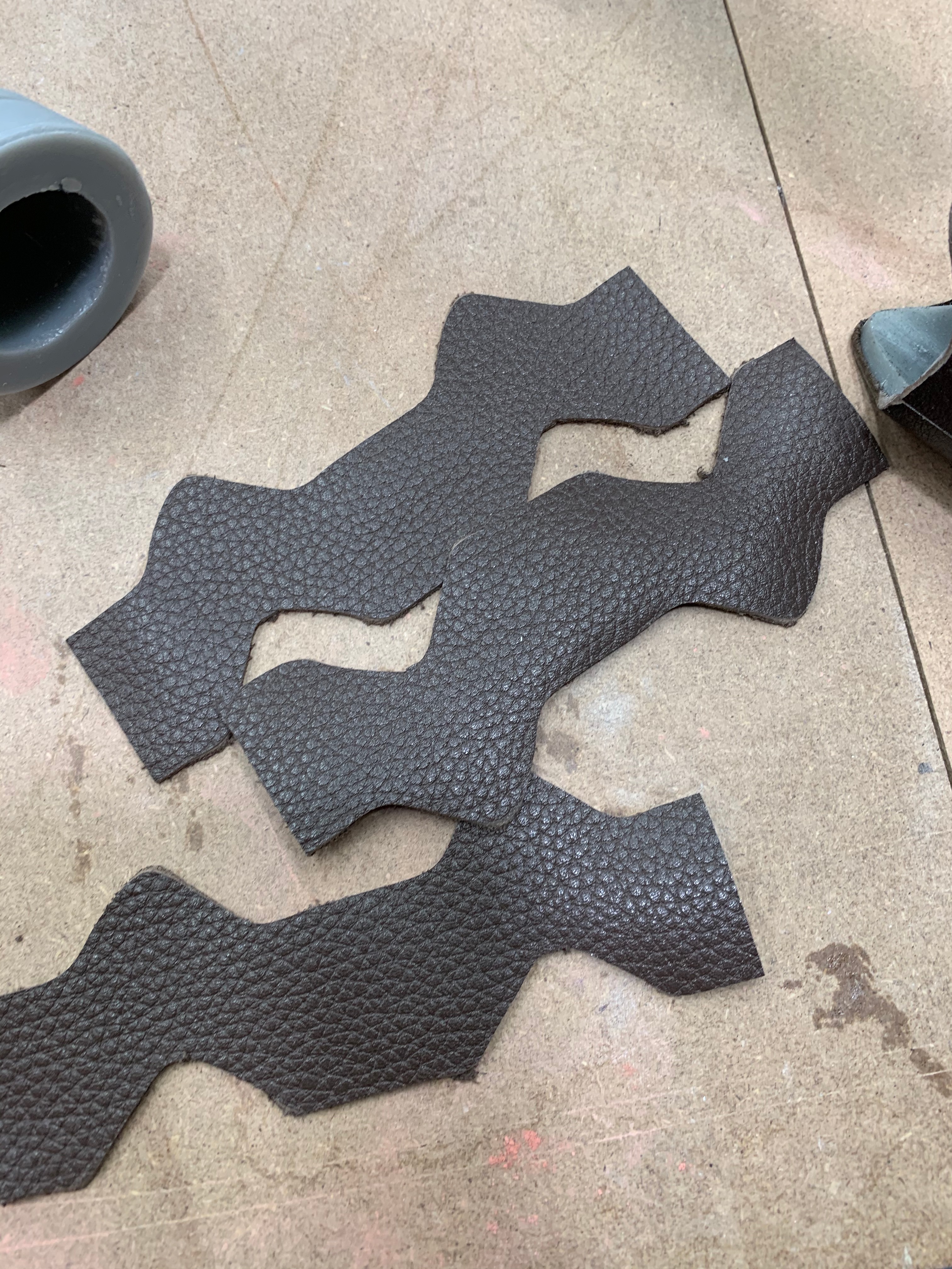

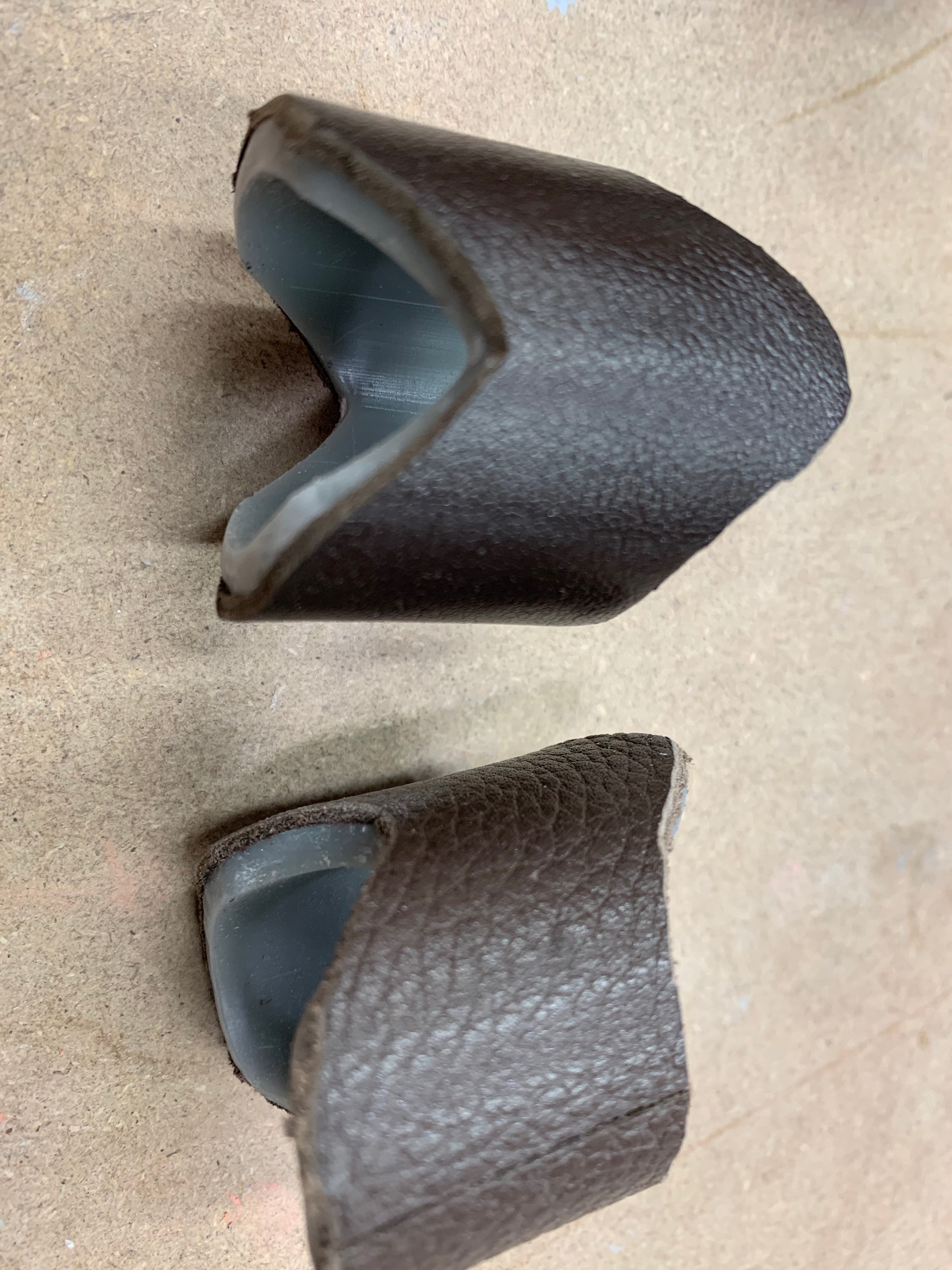

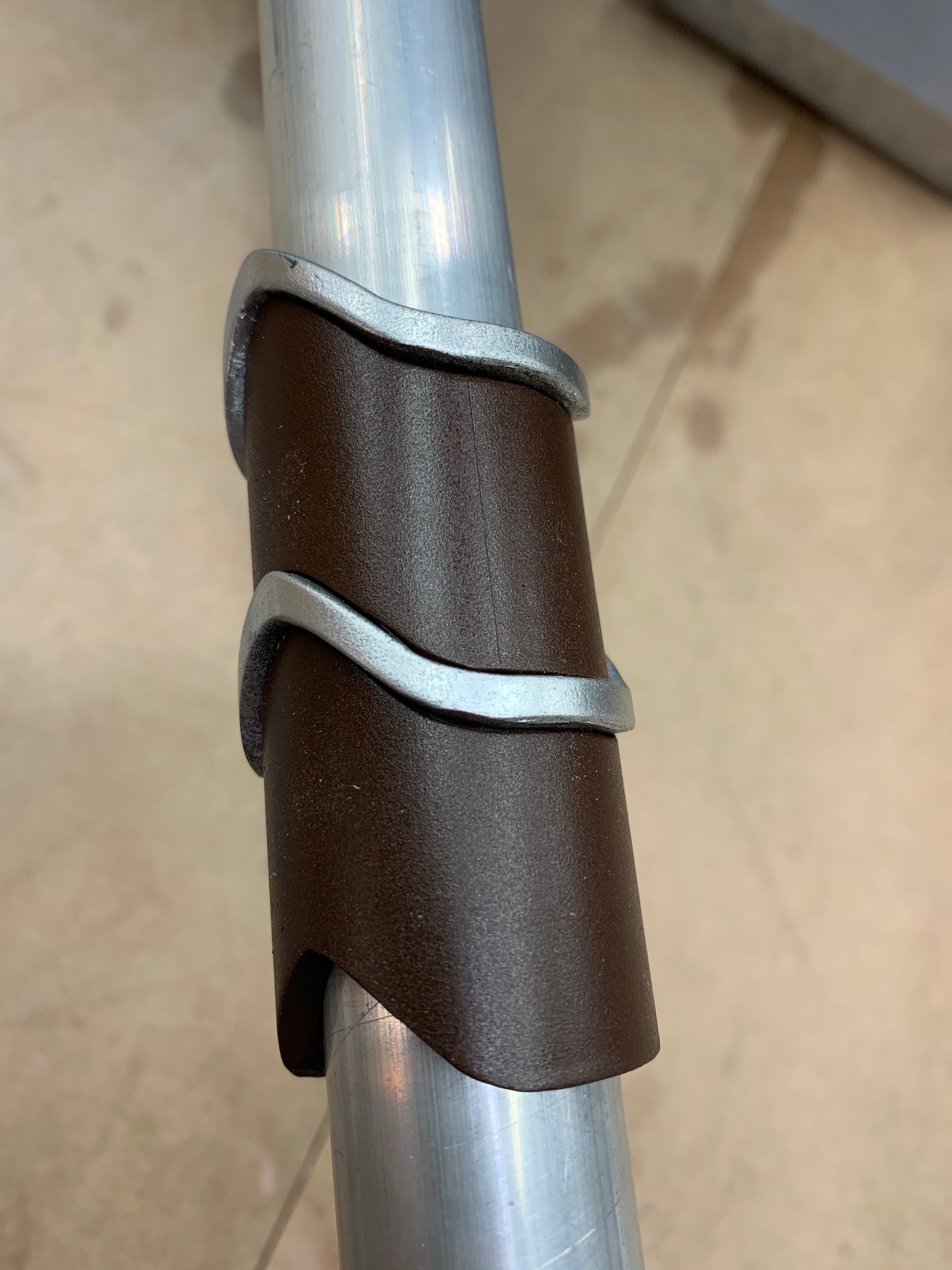

So, today's struggle. The grips. I though I had a swell plan. Mold the rings and grips together into large joined segments ... then cut thin leather to cover the spaces between the silver rings. I tried cutting the leather by hand and it looked like crap. Then I tried cutting the shapes out with my Cricut cutter. More crap.
Then I tried separating the rings and leather sections into separate printed pieces, thinking it would be easier to cut the leather around the loose rings. Still crap.

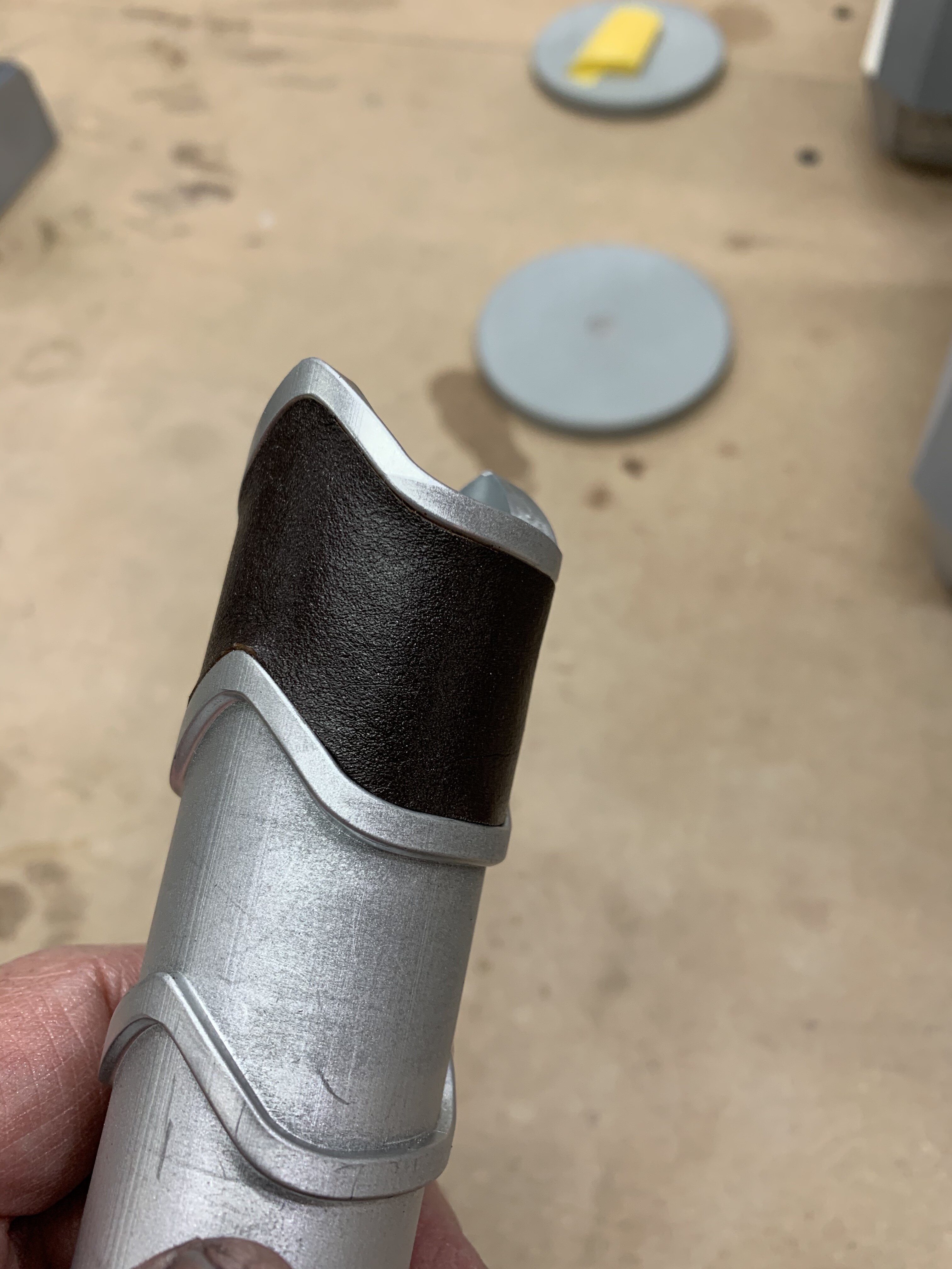

FInally, the last picture here is me just painting the 3D printed "leather" rings with brown paint. And I like it a bunch better. The join between the "leather" and the silver ring is tight. I'm a little sad it won't be actualleather on the handle, but it will look much neater.
yeah the last one is my favorite as well also because it has the right profile from metal chevron to "leather" section... looks really nice!
Okay, fine. I admit it. I just had to do the work of tweaking the template for the leather pieces until they fit properly. I think I'll proceed with the original plan, where the rings are incorporated into the handle, as opposed to individual pieces. Not sure if I need to cut all these leather bits by hand, or if I could maybe get my friend with a Glowforge to help.
