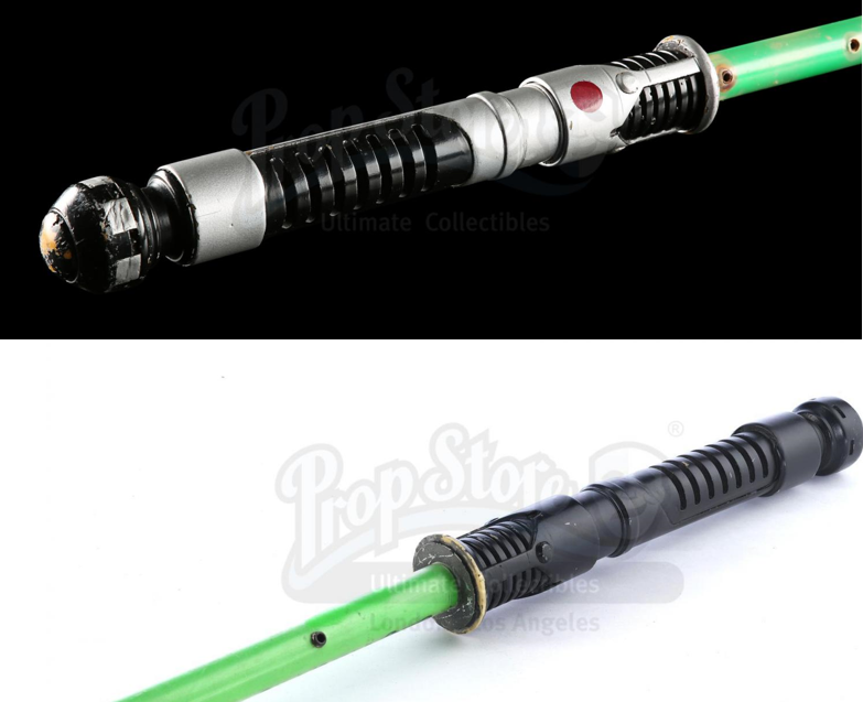

As I alluded to in another thread recently, this particular prop has always been an obsession of mine and I have been working on my own parametric 3D model on and off for nearly 3 years. I have amassed a fairly large collection of reference photos of both the hero prop and the various stung props. So to the best of my abilities I have been using perspective matching photogrammetric techniques within SolidWorks to align my model to reference photos.

Another detail that has always eluded me is this one on the black "emitter core" piece:
That last dark shadow that the blue arrow is pointing to is different than the other grooves. I'm seeing one of two things:
Option A - the emitter core necks down in diameter and we're seeing a taper
Option B - We're seeing another groove with sharp corners (no radius or chamfer) that then steps up in diameter
What do you think?
What do you think?
I can see both if I force myself, but my instinct/opinion is Option B
Always felt like this was just a groove added for symmetry after they added the cutaways in the outer aluminum shell.
Oh interesting. They made the black part short by one groove. Assemble the thing, realize it looks weird, then hastily disassemble and add an additional groove on the lathe. That would explain the uneven size/spacing.
Exactly. Not sure if true, but it seems plausible.
Also, love the work Dewy! This was always by favorite prequel saber.
I'm inclined towards B.
Did a quick render with similar options and this is what came out.
This model of course isn't totally accurate, but there are a couple things about it that push me towards thinking B is more likely.
- The shadow from the 'U' cutout is more pronounced on A with the step down in diameter than I'm seeing in the reference image.
- The lighted area inside the 'U' has a highlight along the top edge just below the final groove shadow area that would seem to be a slight bevel at the top of another ridge. This isn't exhibited in my B render, though I did make that edge fairly sharp which might have been too much, but it is exhibited on the other ridges in the original image.
- The highlight on the top edge seems to be too much for the bottom of a taper, since light wouldn't catch as much on the curve from taper to straight, as can be observed in A. The highlights I'm seeing in the grooves of the original appear to be at the bottom of the groove as it begins to curve back outwards.
Interesting observation and I'm curious to see what you determine from your model.
I agree, I’m moving forward with Option B. More reference photos support option B to my eye. Additionally, from a construction standpoint Option B makes more sense to me.
