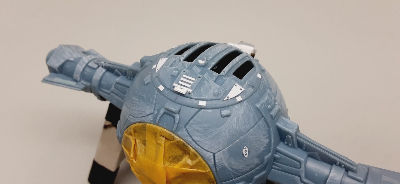

Another Revell Snap Together kit with some additions. I think this is 1/48 scale, anyone know if that's true? I have to say the fit of the parts was very precise, I was pleasantly surprised at how little trimming and sanding I had to do to get nice, clean joint lines and essentially NO puttying at all. I'm trying very hard to emulate all the missing detail I could gather from the reference images across the web that I could find. Of course, it's not screen accurate, so any rivet-counters wishing to complain may do so to that brick wall over there. I've got most of the extras on, including aluminum tube engine exhausts, a pile of paper-thin sheet styrene, and a couple of small bits from my spare parts box on the upper-rear of the fuselage. Still working on that bit.

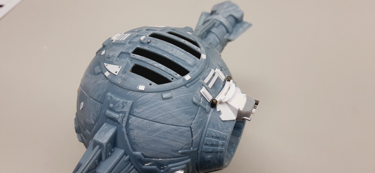

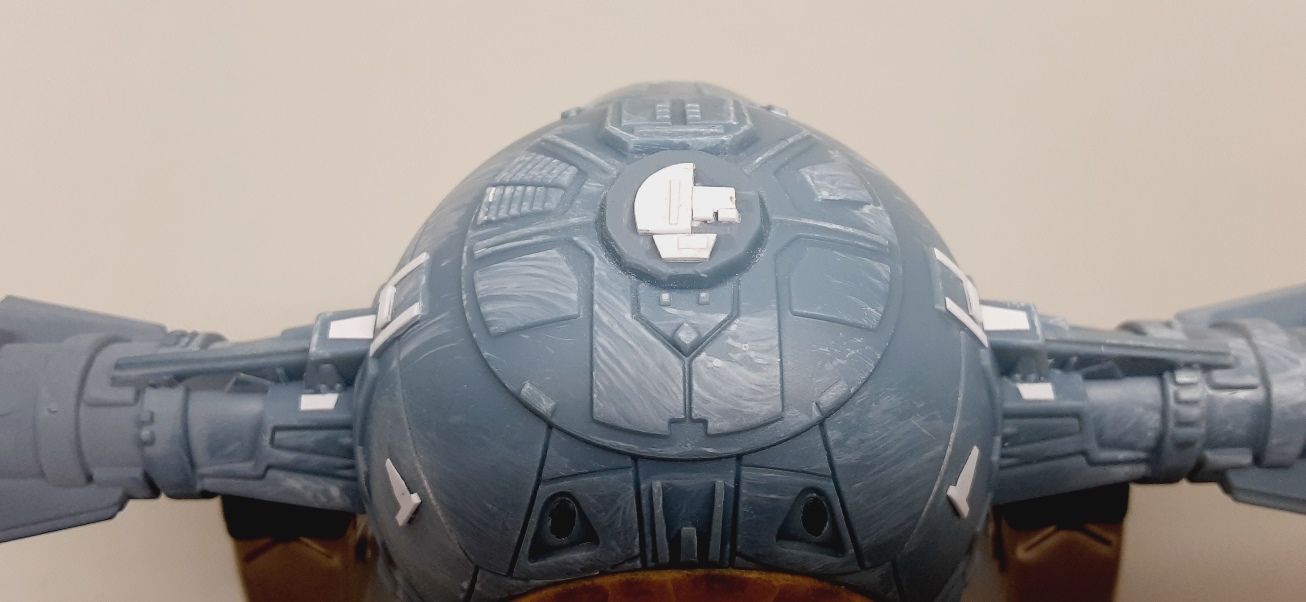

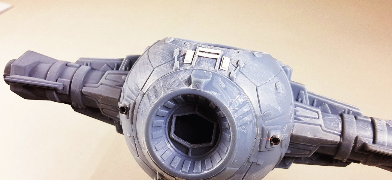

Yes sir, it's the larger kit. I was thinking the same as you, it sizes pretty well next to the MPC X-Wing. On a 1/67 scale kit I wouldn't even have dared to try and add all the bits and pieces that I have on this one. This kit was so well engineered and good-sized that I had to get some more detail on it to do it some degree of justice. The main assemblies go together very quickly with minimal effort, so that afforded me the time to dress it up a bit. Being a Star Trek fan most of my life, I have to say I'm starting to really enjoy the Star Wars kits. Already got the lid lifted on an old MPC Snowspeeder, and looking for ways to scratch up a better looking cockpit and pilots without spending another $100 on aftermarket parts. Yeesh, the kit only cost me $20.

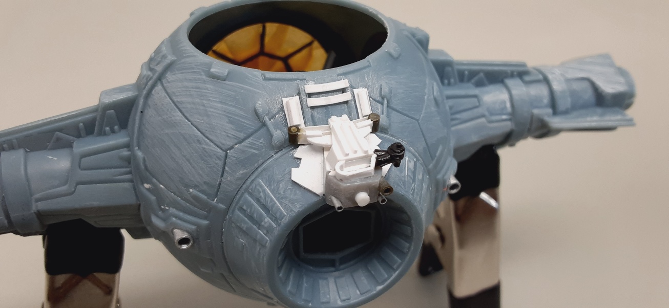

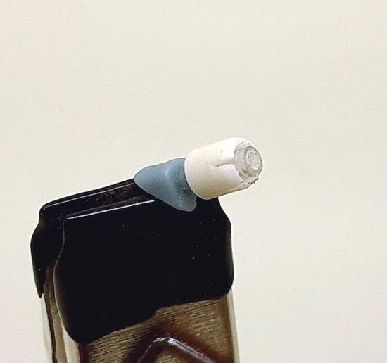

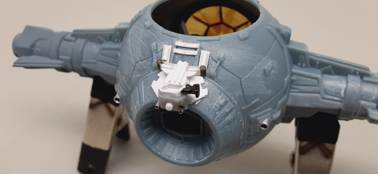

A bit more detail added. I got the tank suspension part (at least I believe that's what the original part was) constructed, which is made of several dang-near microscopic bits of sheet styrene and a couple of small spare parts, cut and sanded to shape. At this scale I think it will be passable after paint. I also modified the laser emitters(?) by replacing the orange painted parts with clear ones, drilled out to simulate the barrel effect, and I created the shrouds that are prominent on the emitters, but totally missing from the kit.

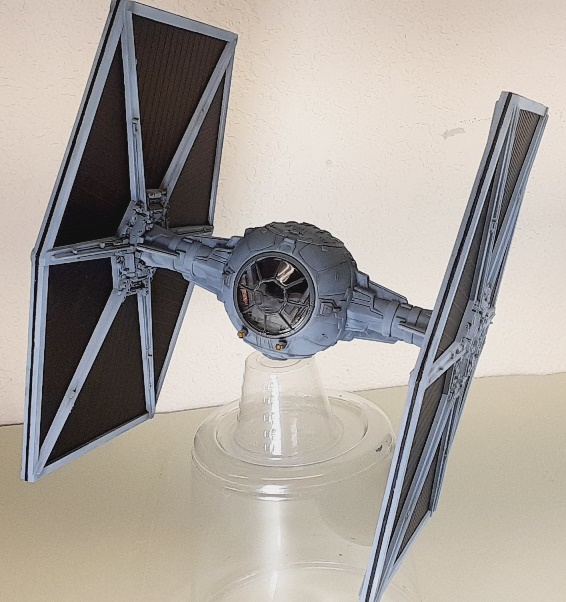

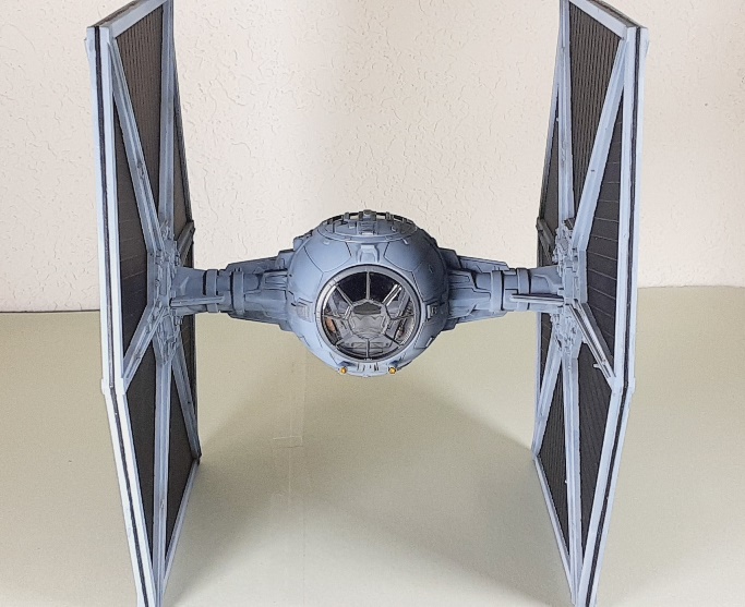

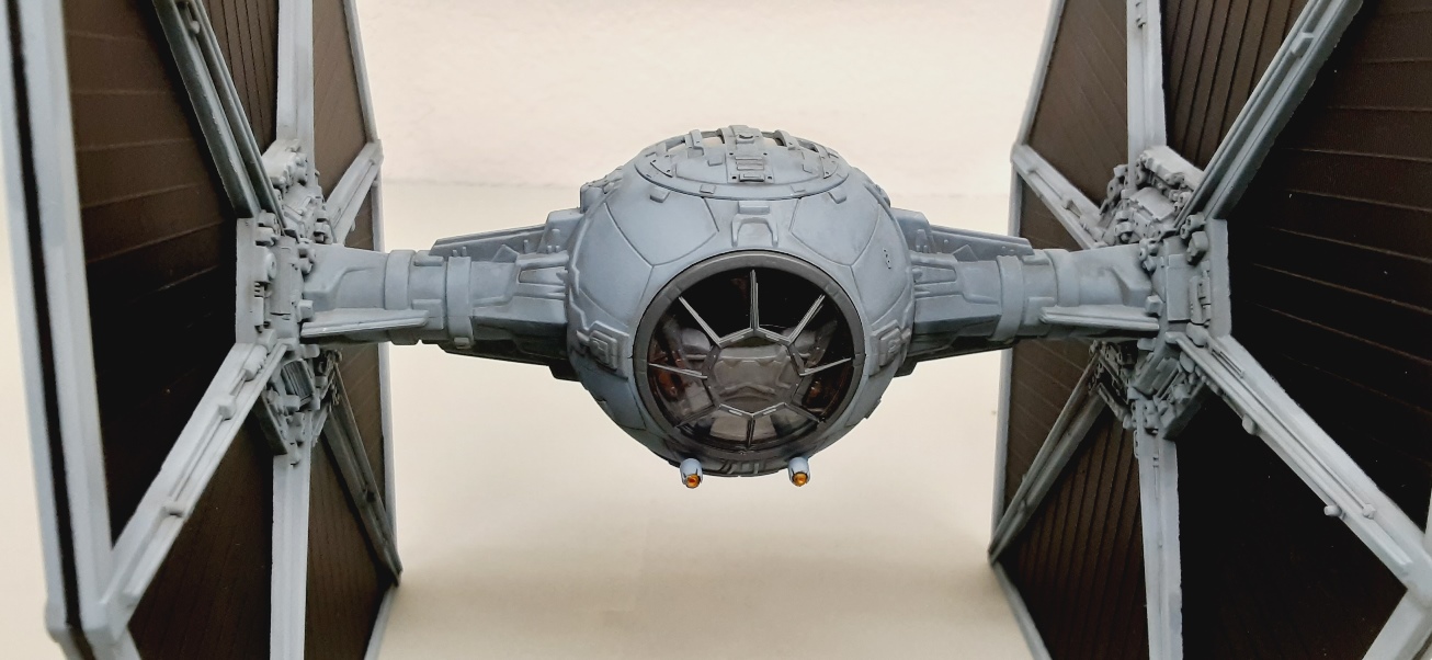

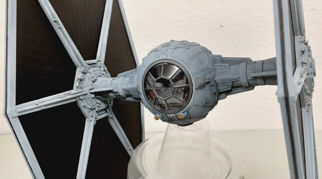

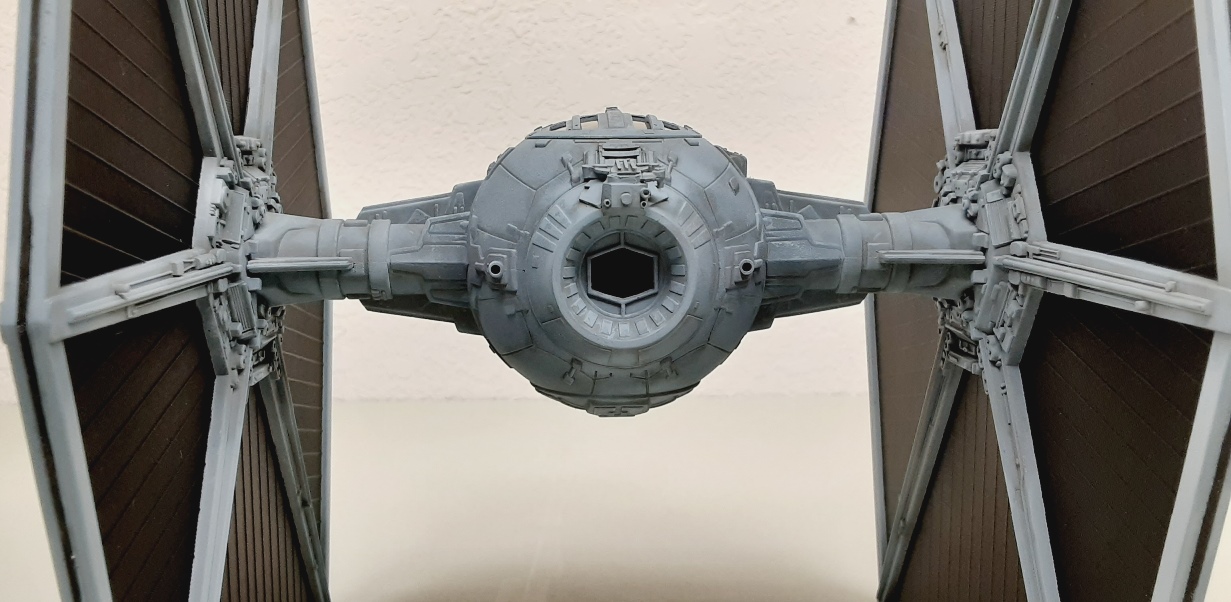

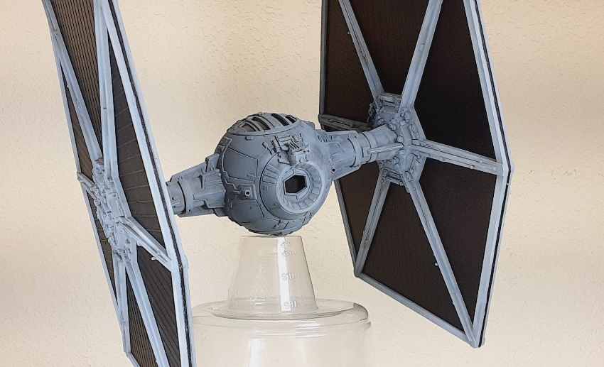

Alrighty, stick a fork in her, she's done. I had a couple of disasters involving peeling paint when removing masking tape from the black strips around the edges of the side panels, and a foolhardy attempt to cut new clear styrene for the roof windows that ended with simply polishing up the kit supplied plastic and gluing it in. Lessons learned. Overall it turned out a lot better than expected. I think however, that is mainly due to how sharp the detail is and how well engineered the fit of the parts is. My input had little to do with it... But, I am quite happy with my scratchbuilt parts, I just wanted to get in those missing details that if omitted would leave her looking really... well, toy-like. Revell did a fine job on this, and it's just a snap-together kit.
Many thanks Analyzer! Yes, the color choice was meant to emulate the images I found online from the first film, with allowance for monitor induced hue and color settings, of course. I like Tamiya bottled acrylics, in this case it was Medium Blue lightened up with a LOT of white; I simply kept lightening the blue until I got something that was close enough for my eye. If that's a crime around here, then I'm guilty as charged! :D
I also used white primer to try and lighten the top coat more, and it kinda worked. After paint I used a VERY LIGHT wash to try and darken the shadows, and then dry-brushed with my original color for the highlights. I know these are supposed to be CLEAN, well-maintained Imperial Fighter Craft, so I tried very hard not to go overboard on the weathering.
My understanding is that there is a particular gray that is agreed upon as the correct color, but I like the blue better, and it feels more "correct" to me. This and my Snap-Tite U-Wing are the first Star Wars models I've built in almost 25 years, and I'm enjoying them so much that now I've got the old MPC Darth Vader TIE on the workbench, busy correcting all the horrible fitting parts...

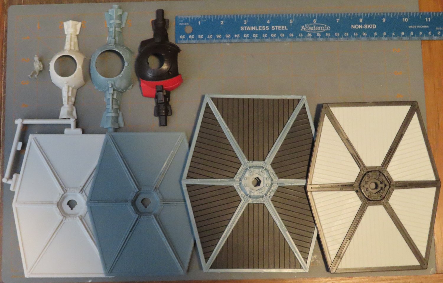

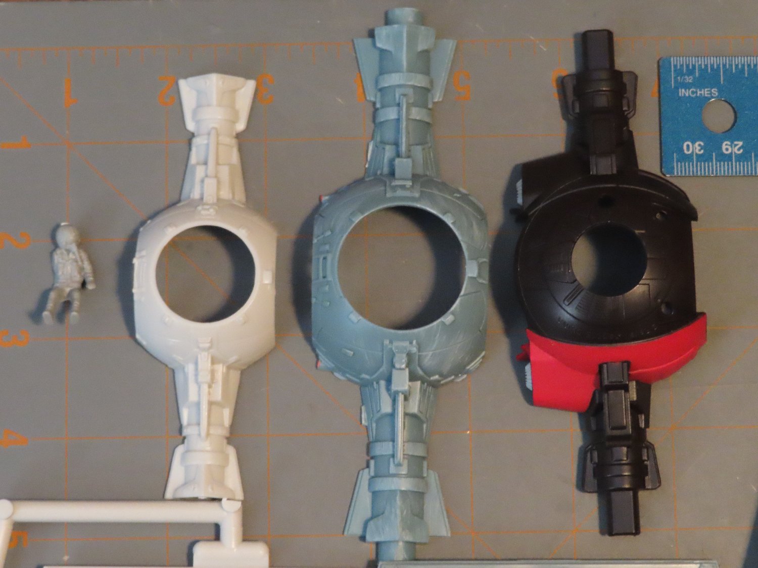

I've included a couple of comparison shots of the two Revell kits and the AMT kit, including the new, improved wing part from the latest reissue (which addresses the main accuracy issue with the original kit... now if they could have retooled the Interceptor wings as well!) Although the FO TIE (in black) seems a third size, the front portal panel opening is almost an exact match the the standard TIE Revell kit you built. Note the Monogram 1/48 scale pilot figure.

rbeach84 those are VERY interesting photos, thank you for posting them. The FO TIE and the Revell TIE cockpit spheres look to be almost identically sized, yet the FO TIE wing spars are so much smaller, and the panels slightly smaller. Is this accurate? Genuinely asking, I have little to no knowledge of things Star wars... I see what you mean about the AMT issue being 1/48, the pilot is a perfect match. The whole "box scale" issue has been a conundrum for many, many years, so I agree with your conclusion that it can be whatever the builder chooses it to be. Your "reasonable engineering" rule seems sound to me, I'll go with it! Here's a stupid question: The FO TIE has 2 crew? If so then 1/48 would make good sense to have room for two on board. I'm displaying my disgusting lack of knowledge concerning Star Wars vessels here, forgive me if I offend with my stupidity...
No worries! Yes, the kit is of the two seater 'TIE/sf' variant, aka 'special forces', that Finn and Poe escape (if you'd seen the movie which one I forget exactly, Ep.7 I think...?) in a scene where the TIE is hangared on an angled vertcal 'rack' that resembles a set of bleachers... when they launch, some kind of umbilical is still connected so it goes a'swinging about like a balloon in breeze... not exactly an stealthy escape!
The movie set shows the crew seated back to back, one a pilot and the aft facing one some form of 'gunner', of all things. Like a TBM Avenger, what? A aft facing (actually, swings 360 deg) weapon hangs below the cockpit, something for the 'gunner' to do!
