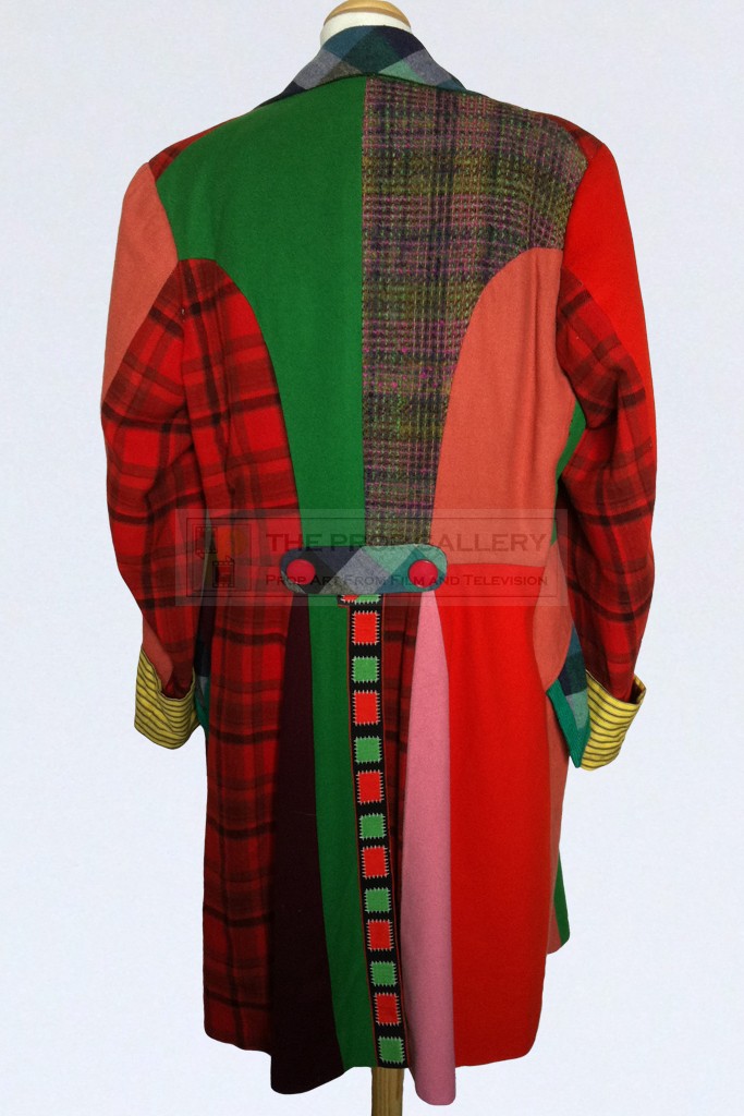

here's a picture of the back of the coat from this thread on the TARDIS Builders forum, which is apparently from a listing of a screen-used coat that went up for auction several years back. based on this, it looks like the same tartan from the front is also used on the back left panel of the coat, and on the lower back panels of both right and left sleeves.
I'm actually hoping to have an initial mockup from the coat pattern I'm using finished soon, so I can make the necessary alterations to better match the screen-used coat and figure out how much of each fabric I'll need and be able to calculate costs better. because of the changes I'm making to the overall structure of the coat for my version, I don't think I'll end up needing a ton of any one fabric (mine is going to be shorter than the original, for one), so it should keep it slightly more budget-friendly than a full-scale 100% screen-accurate replica would be.
