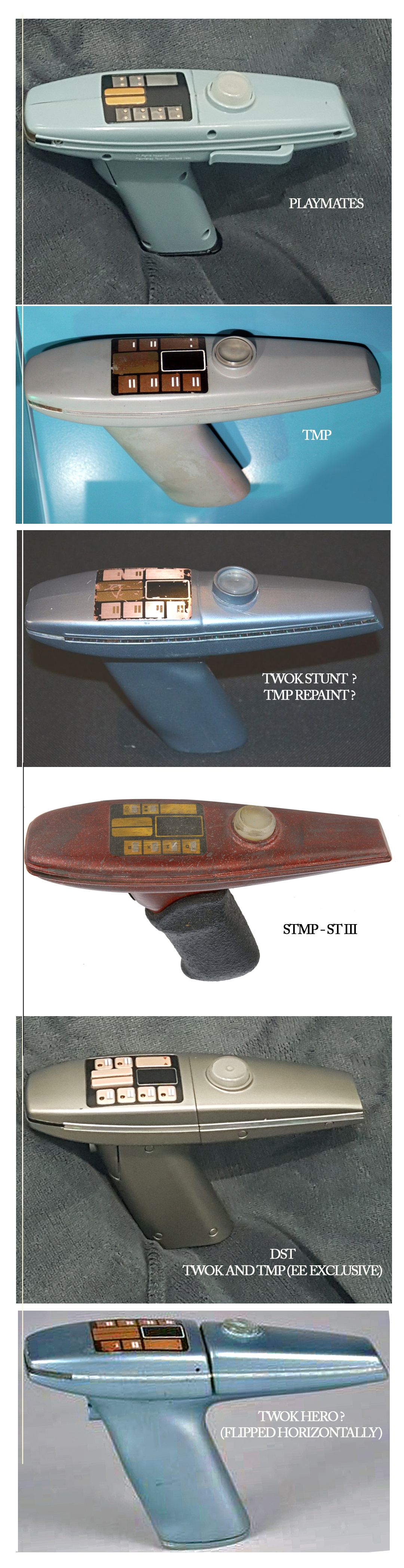

Here's a rough size comparison - note the differences in the 'nose' areas.

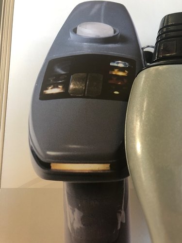

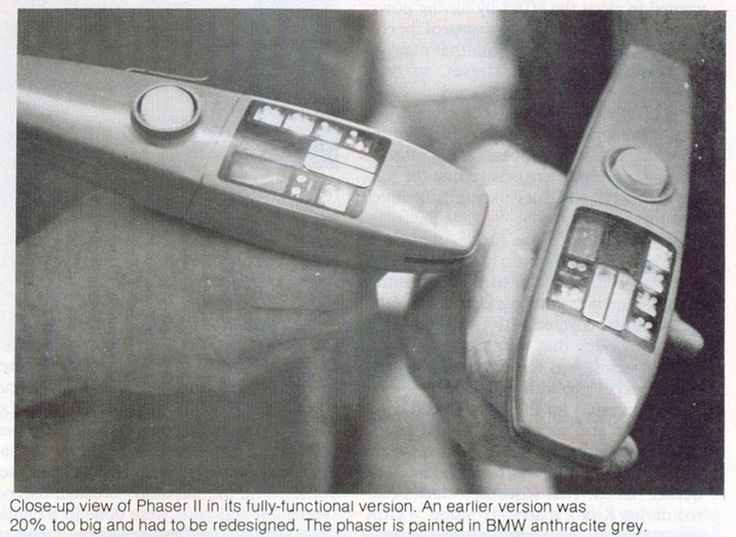

The TMP Hero props appear to be a dark gray color. I know that Dove Gray has been cited as the base color, for years, but that does not appear to be the case. It seems that poor photography has led to this assessment.
For contrast purposes, here is a high quality photo of a TMP Hero (from the Art of Star Trek TMP book), next to my Dove Gray Dustbuster Phaser.
“BMW Anthracite Gray” is also cited as the color of the Hero TMP Phaser. A 1979 BMW painted “Anthracite Gray” is captured below:
According to the owner of an original TMP Tricorder, the closest match to the base color of the TMP Phasers and Tricorders is Tamiya XF-75 IJN Gray.

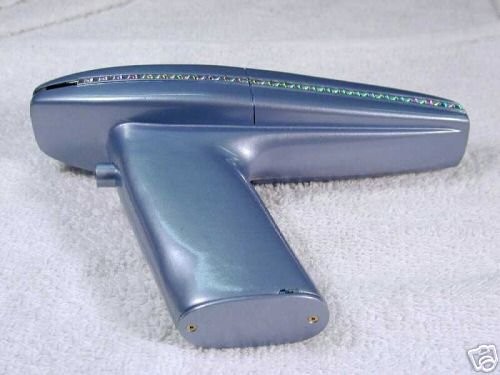

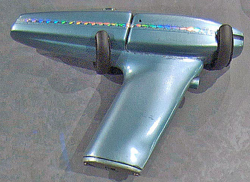

As far as the WOK vacuform Phasers (hand-me-downs from TMP) the color is definitely a different “metallic blue” color that is similar to the TOS Phaser Rifle color.
I'd say the nose seems closer to the real deal on the DST despite its size (that stuff seems HUGE in comparison)
I would also point at the tapered shape. The screen prop seems slimmer and more tapered on the back part than almost all replicas.
the TWOK stunt prop appears to be narrower than the hero version but it's hard to tell due to the view angles on most the pictures.

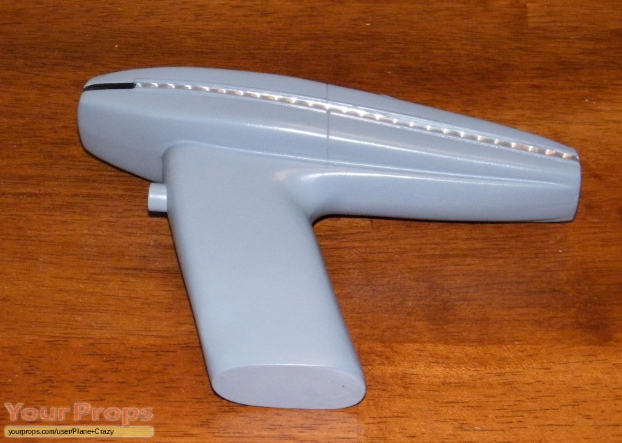

There's also another detail that bothers me: the handle shape. On the sreen prop the handle seems much more ovale and rounded than it is on replicas
screen props
replicas (Roddenberry and HMS)

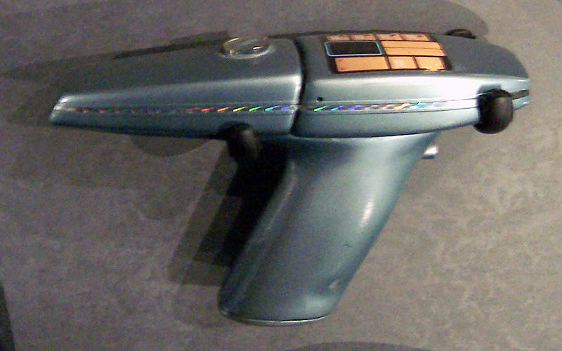

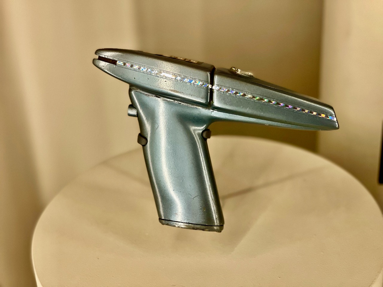

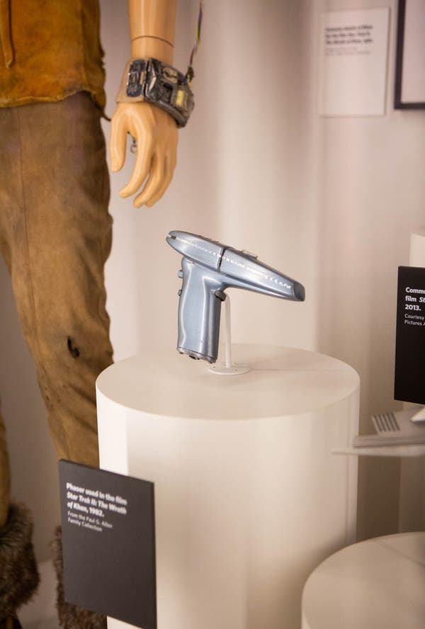

I recently found out some new pictures of the TWOK hero phaser prop, taken at the exhibit "Star Trek: exploring new worlds" that took place in 2021 at the Seattle Museum of pop culture.
the handle and trigger area shapes appear more clearly

It's worth pointing out that since the vac-formed props were a left and right half, the wide/narrow body and oval/round grip are both affected by how that particular pull was cut and sanded.
There also seem to have been two different molds for the TMP phaser, judging by the wide and low vs. tall and narrow bezel around the "dilithium crystal" light on the back.
It's really hard to be sure, but someone could probably convince me that the phaser with the wide and low bezel on the right is also ever so slightly wider through the whole body, when looking at how much of the body you see on either side of the control panel.

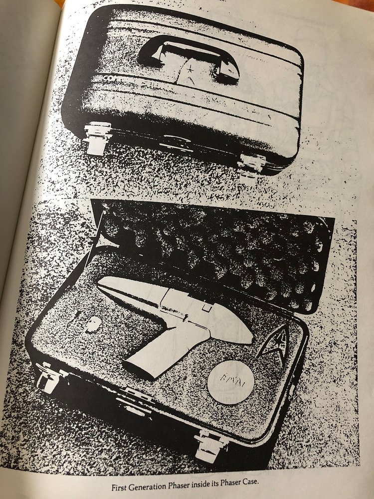

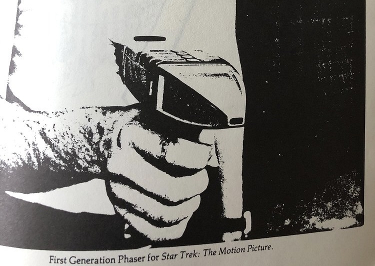

Awesome. Did they made bigger props to have enough space for electronics? That one looks like the Ed Miarecki version. Indeed the first version of the TMP phaser was larger. I have an article where Brick Price talks about the prop conception, he talks about the first bigger version.
Yes, pictures of this first—and substantially larger—prototype TMP Hero Phaser do exist.
Here is an old copy of Enterprise Incidents in which Brick Price Supplied photos of the unit.

Yes, pictures of this first—and substantially larger prototype—TMP Hero Phaser do exist.
Thx a lot ! I always wanted to see that thing. I must say I finally much prefer the second version , much more Star Trek than this huge square stuff in my opinion.

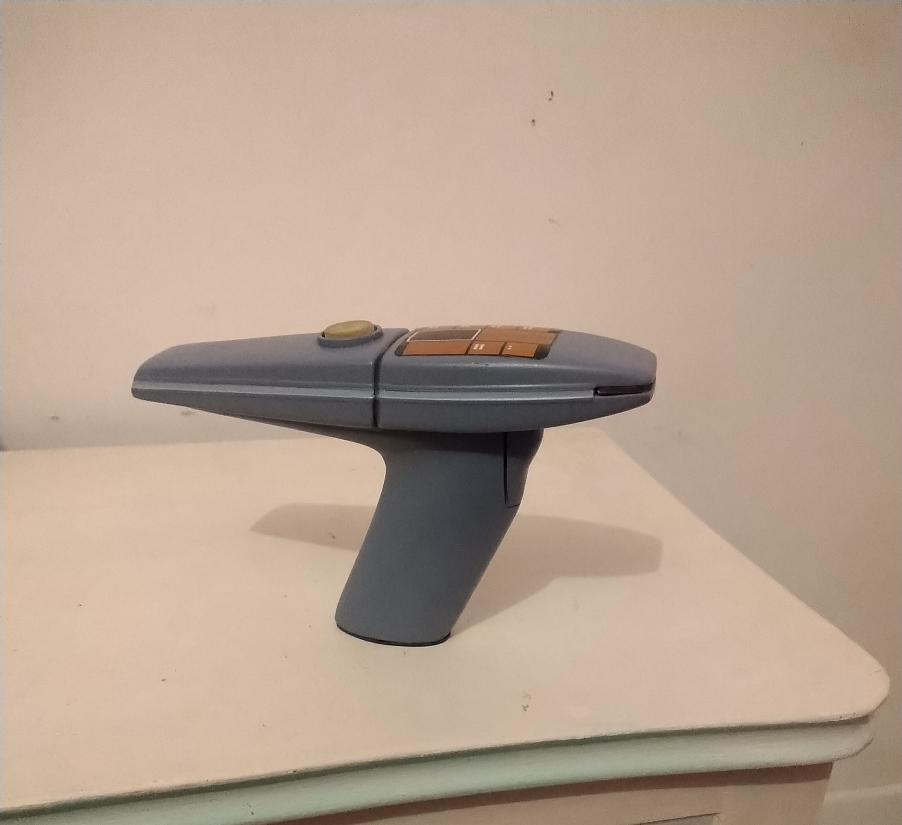

I've just finished my TMP phaser, based on the background version
