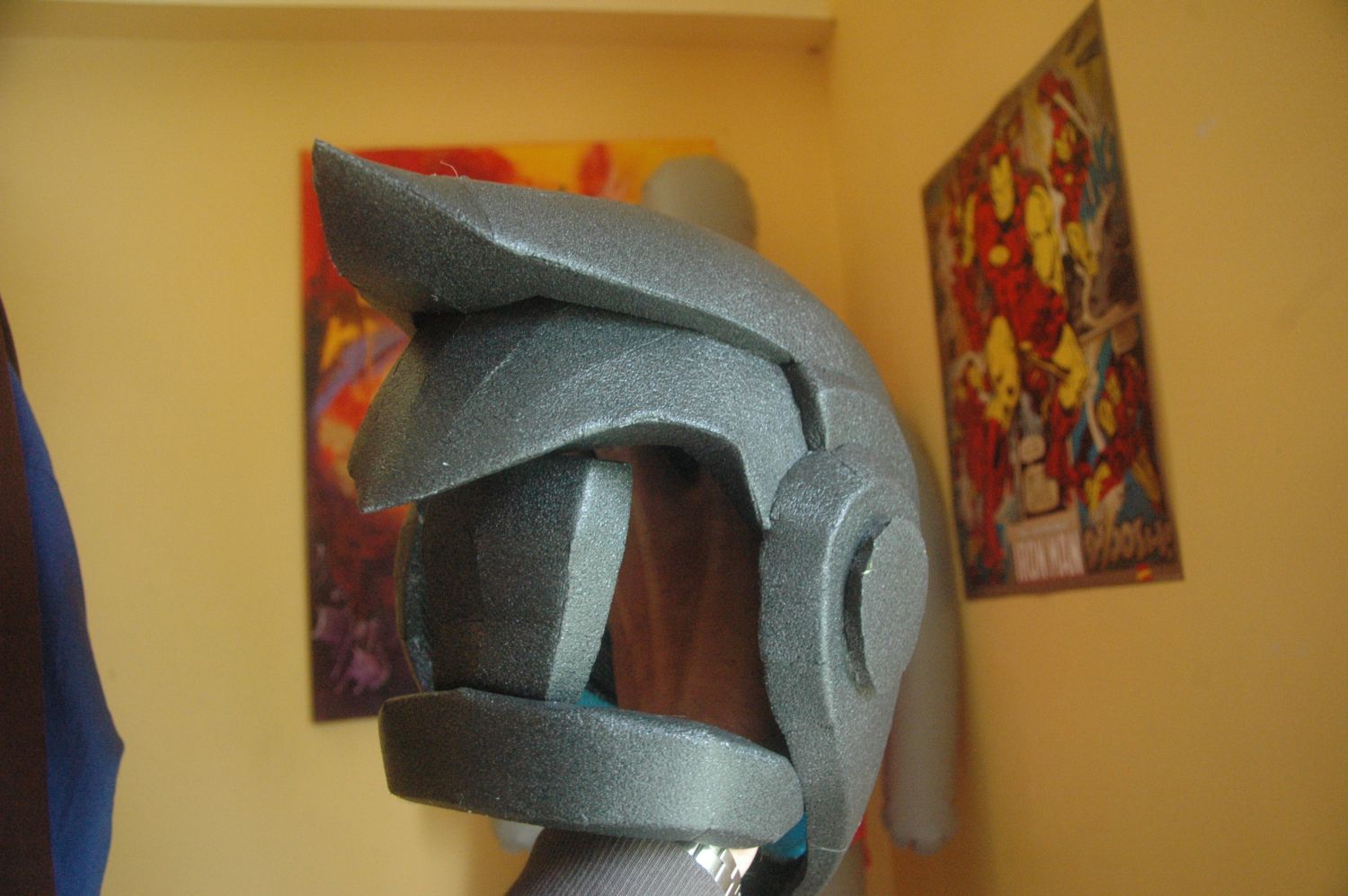

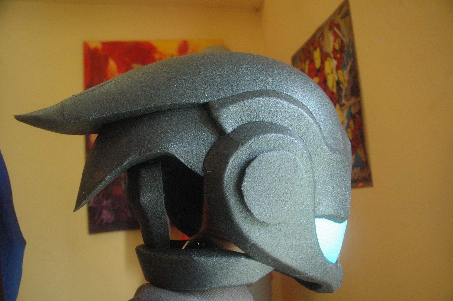

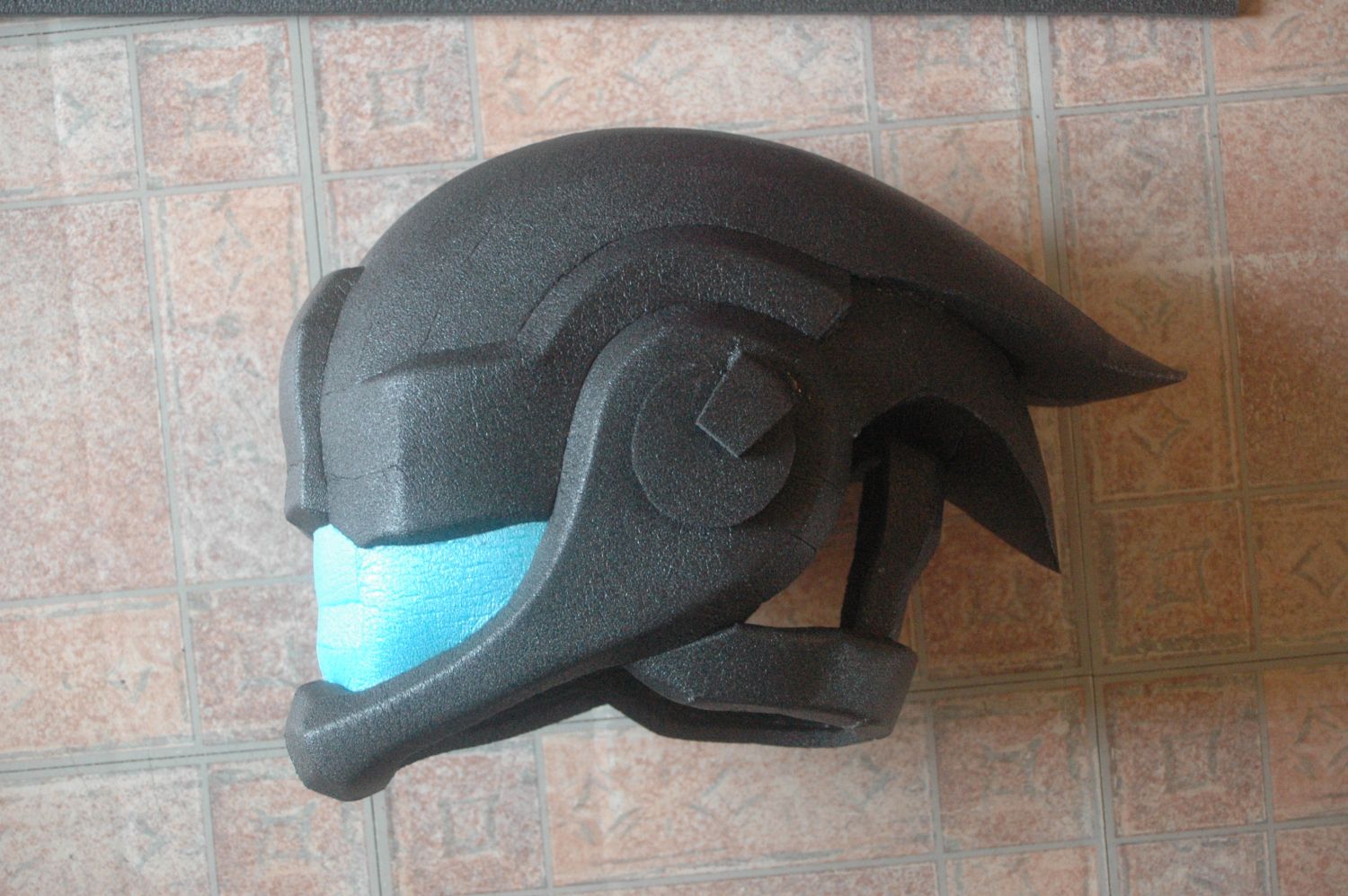

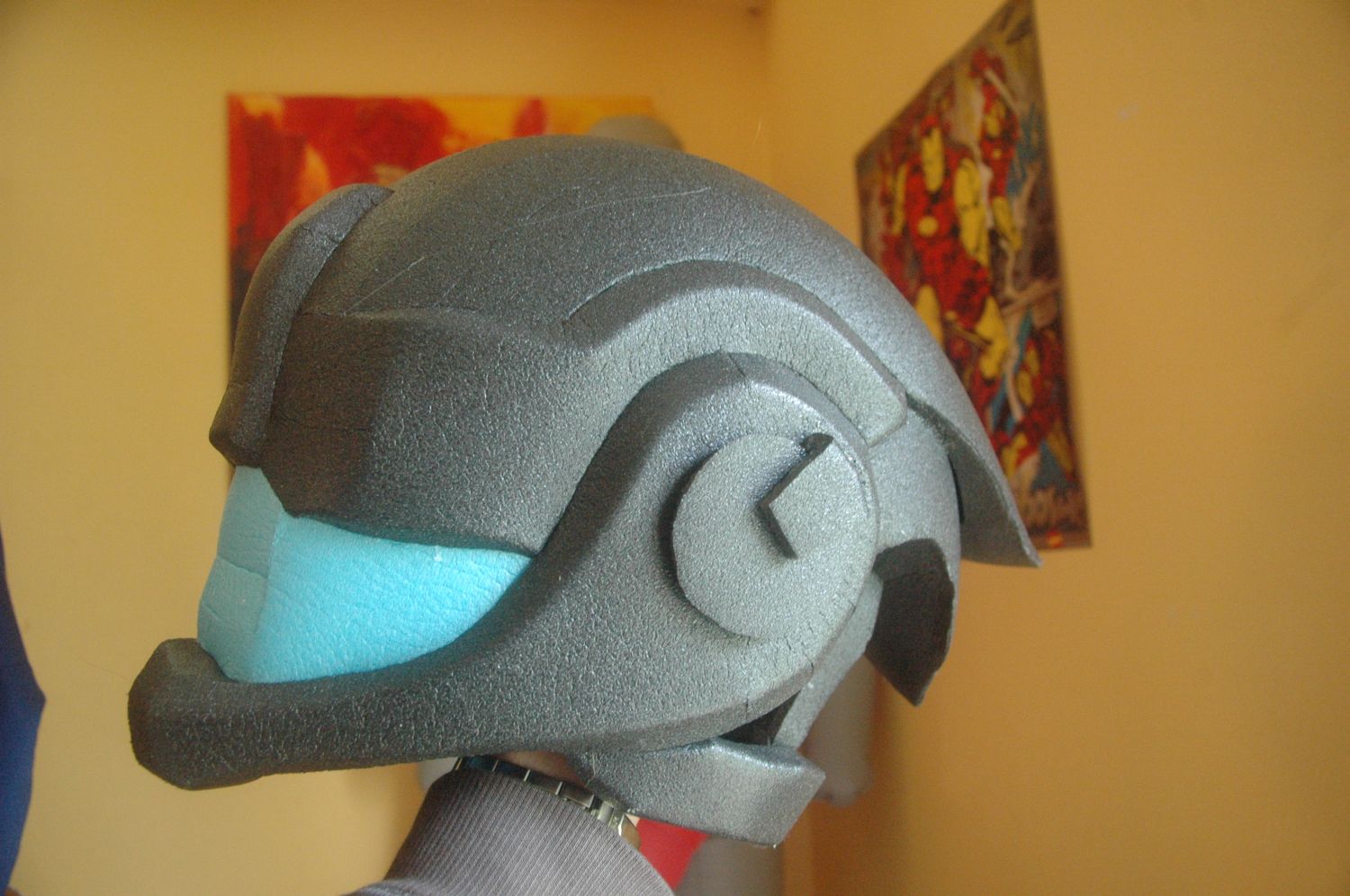

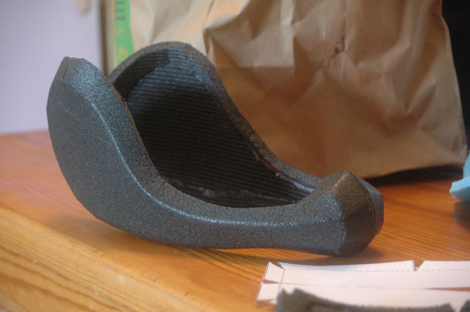

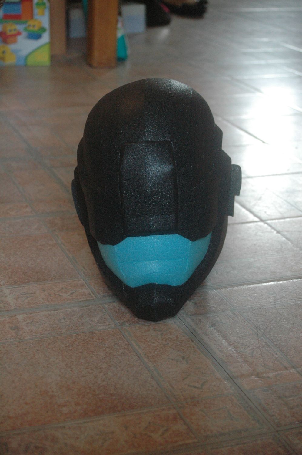

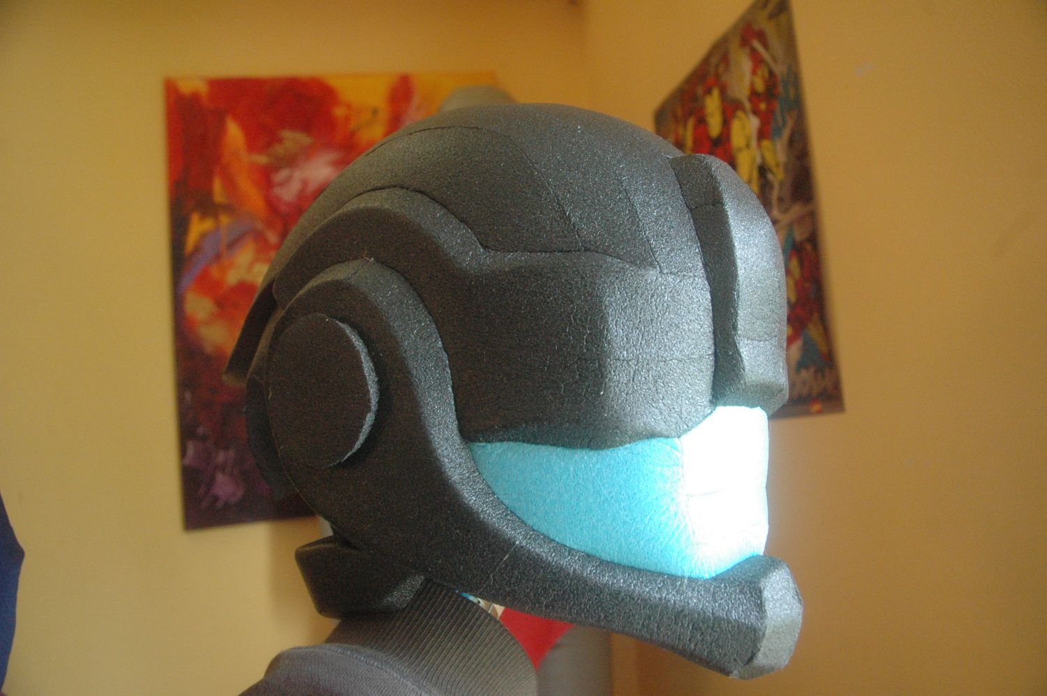

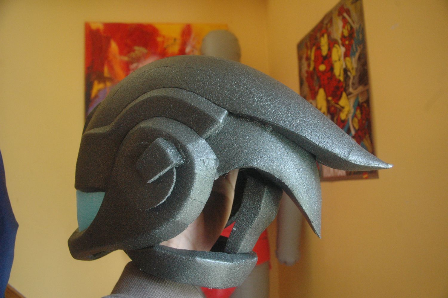

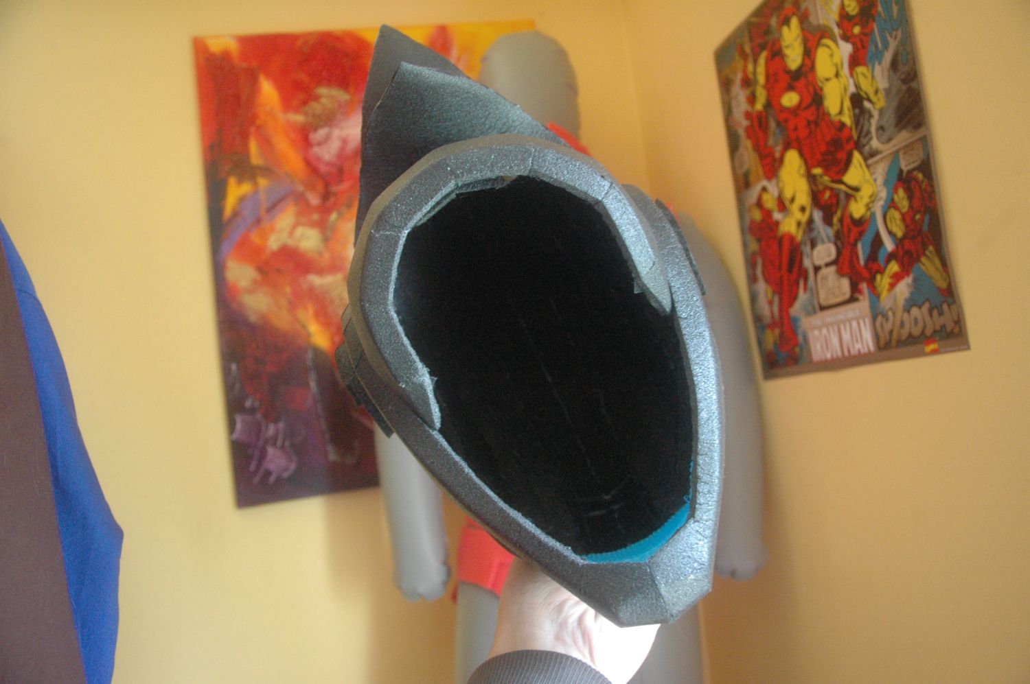

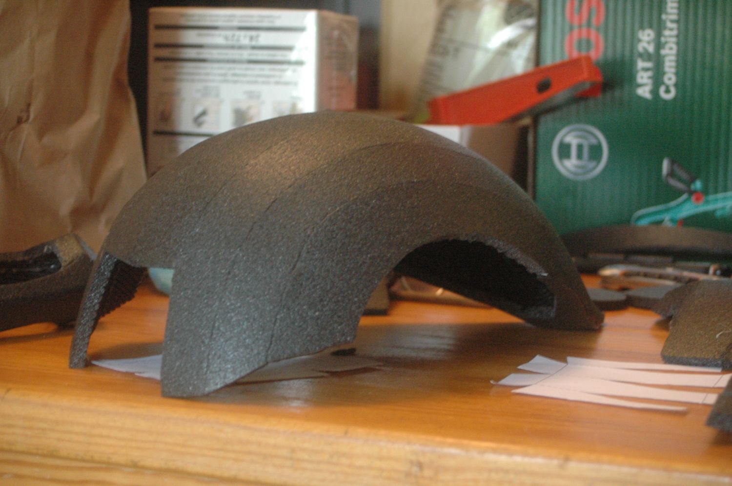

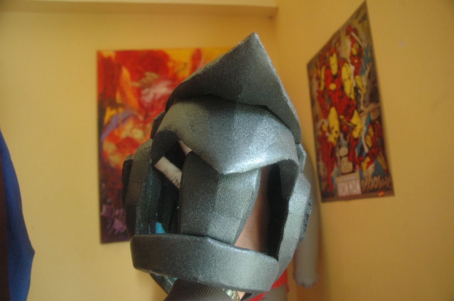

Well, let's start with the forbiden-first-part, the helmet. I love challenges.
No particular trouble there, since you remember to glue the chin/ears part at very last ! I left the back 'T' part removable so I can lock the helmet once my head is inside.
I'm not happy with the curve of the blue visor. It's a matter of gluing, I thought this piece was more flat.

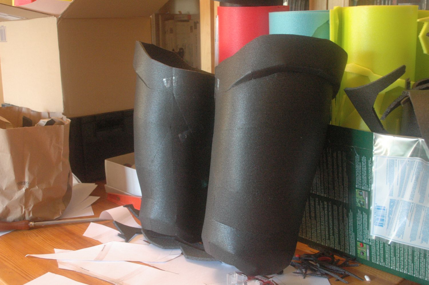

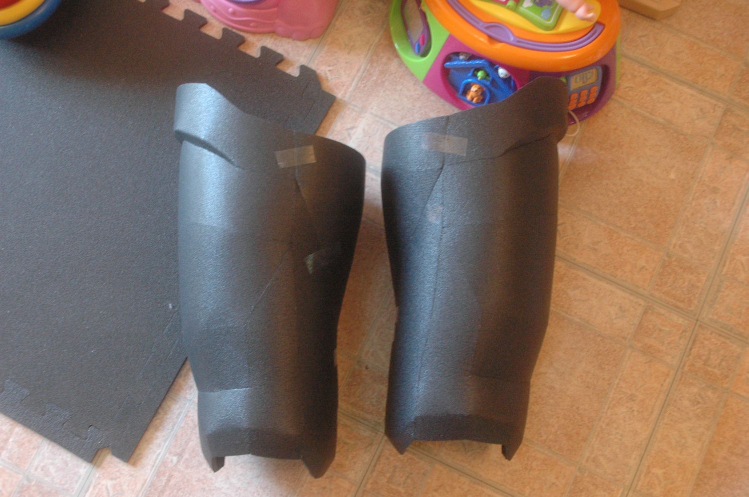

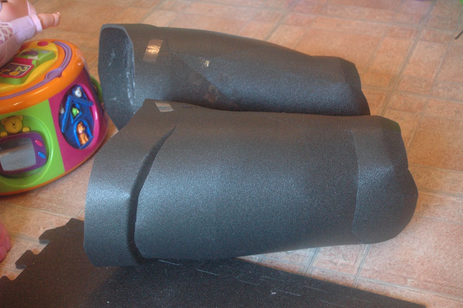

Next time, a thigh. Or two.

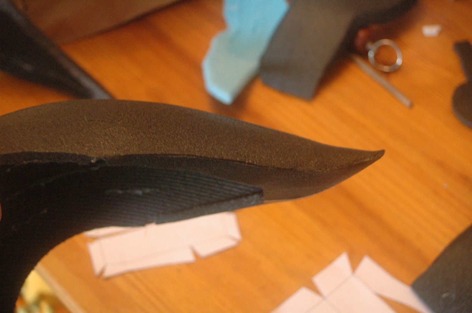

I spent hours and hours, trials after trials to do what you did here.
And I am still far from moderate.

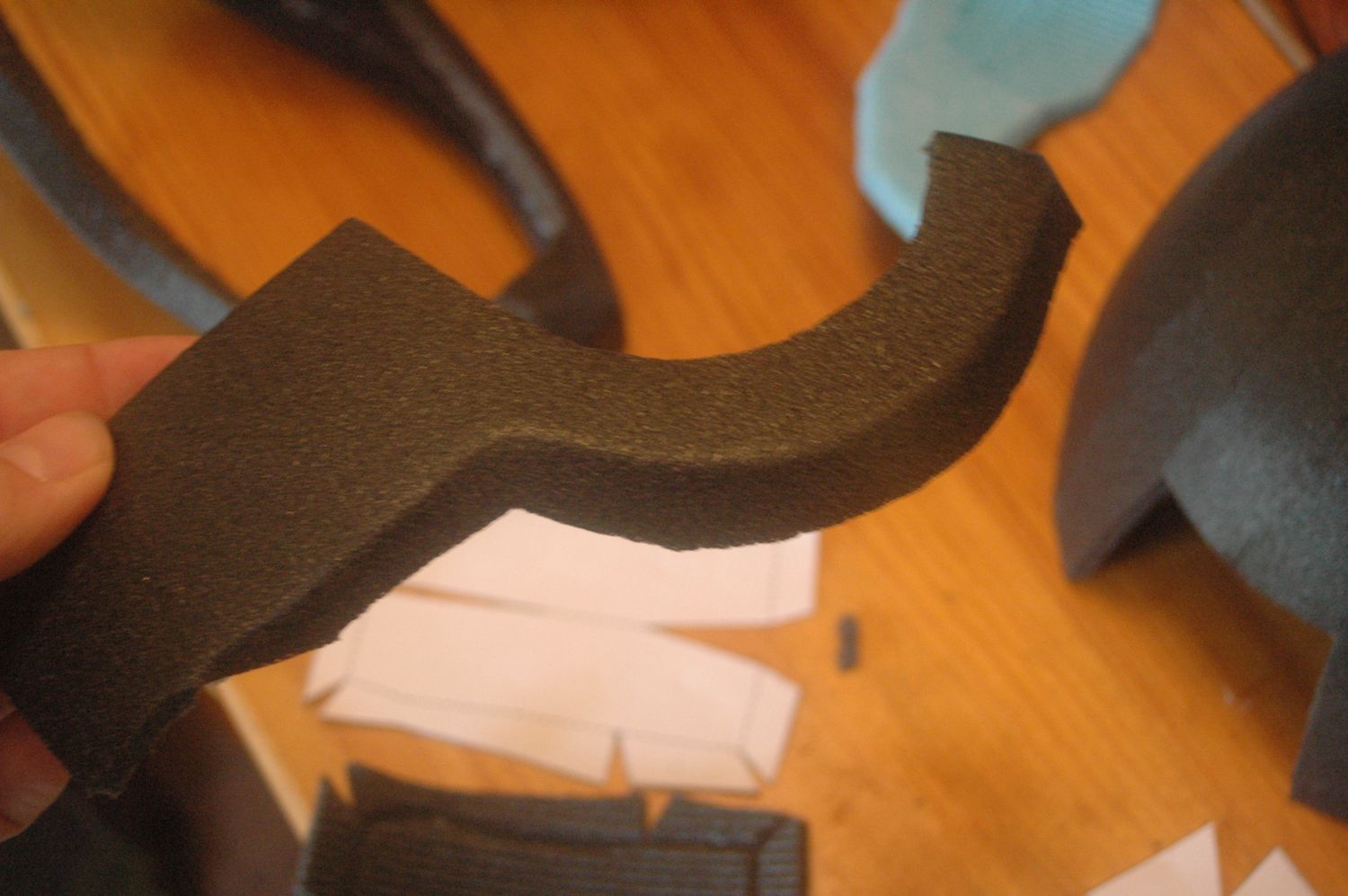

How can you glue bended curve like that so clean?
Unfair, this is unfair.......
You're killing me.

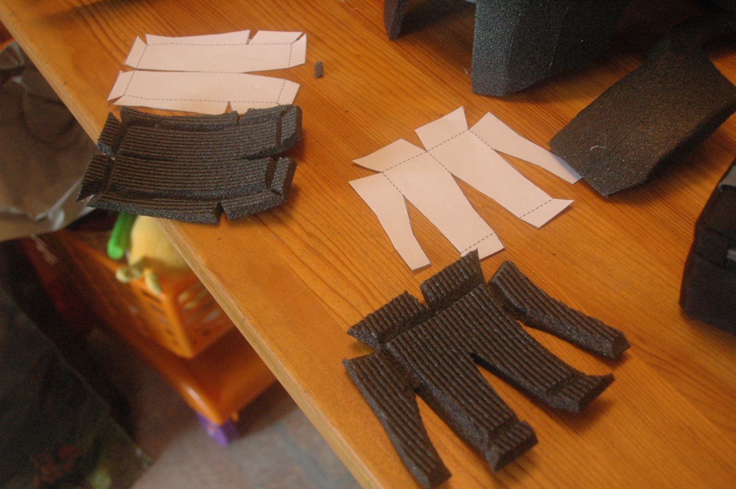

It doesn't look like you're having any problem with drawing on black foam, but my first thought is silver sharpie. What did you use?

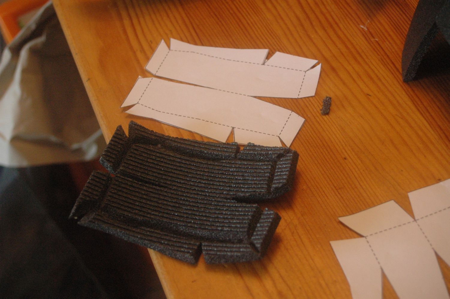

What did I use to draw on black foam. In fact, since every pen I tried have left an invisible draw, I had to resign myself to use... nothing. I simply laid down the paper onto the foam, and cut out my paper masks and my foam pieces at the same time. When a reverse piece was required, I flipped upside down the first foam piece to act as a mask, and obtained the second piece by cutting along the edge of the first one. It needed a larger workspace than usual to be sure that nothing would move during the process, because with a pen you have several trial runs you don't have with a blade.
In return it seems I saved time, and my cutting lines were more accurate.
Anyway, I will continue this way waiting for a silver sharpie, even if the cutting lines for the mountains and valley must be roughly located by rule of thumb. After all it aims just to serve as a kind of a crash-test speed foam build prototype, not a masterpiece. Even if, I must confess, I plan to show off a bit at my local videogame store if the suit turns out not too bad. :love

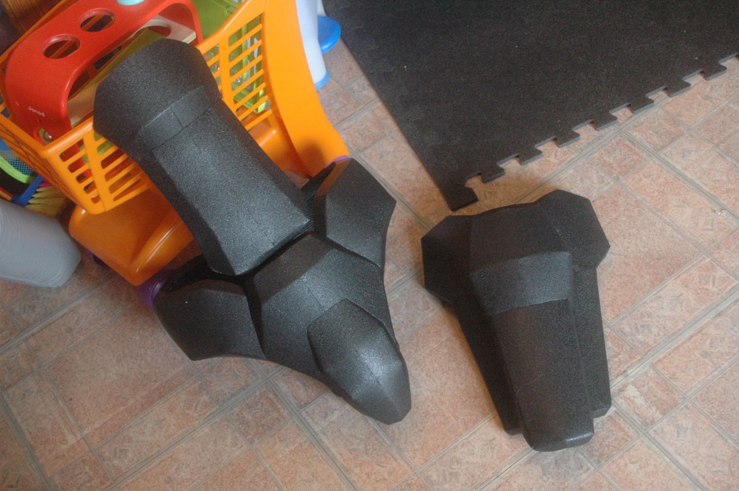

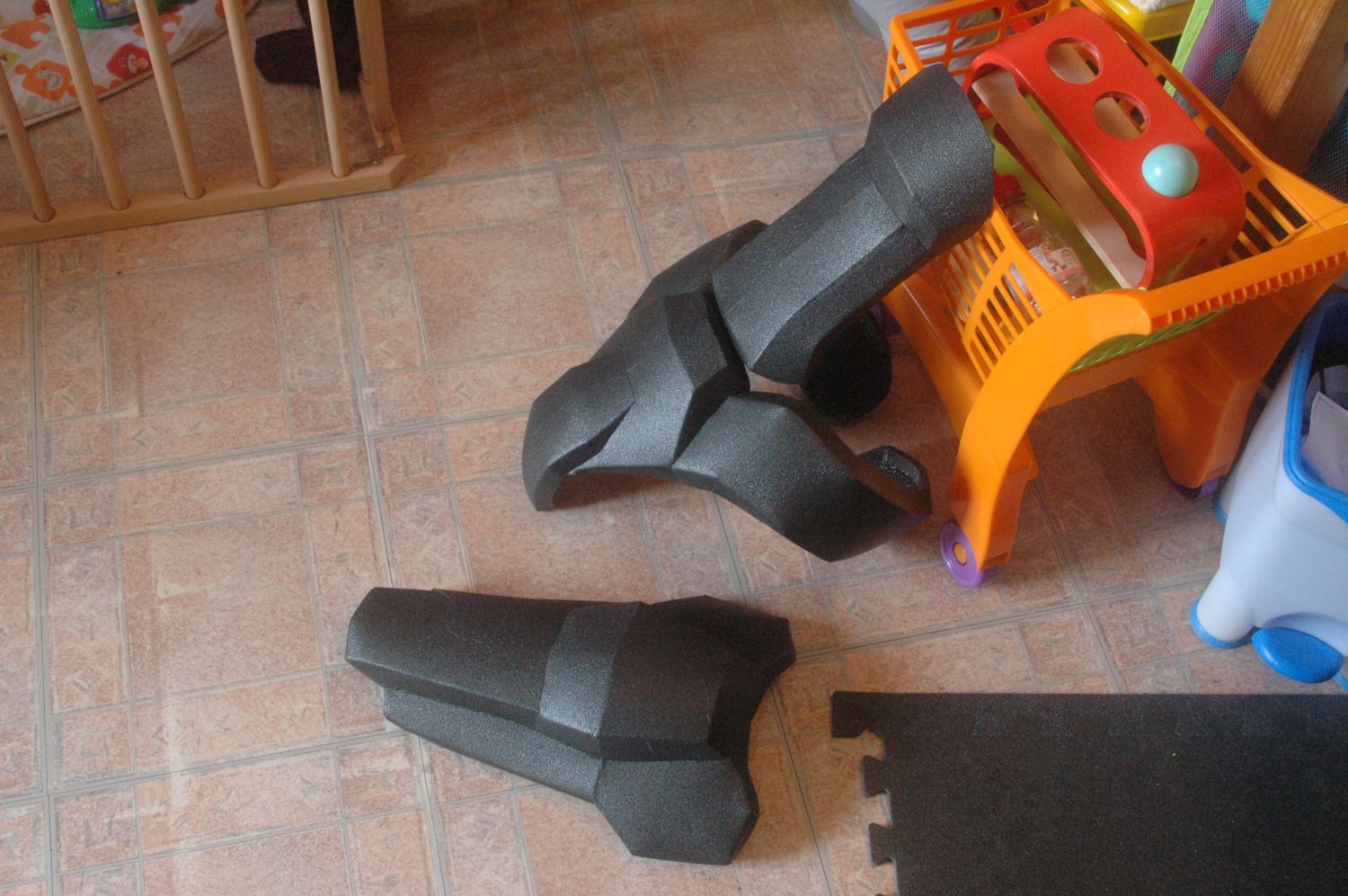

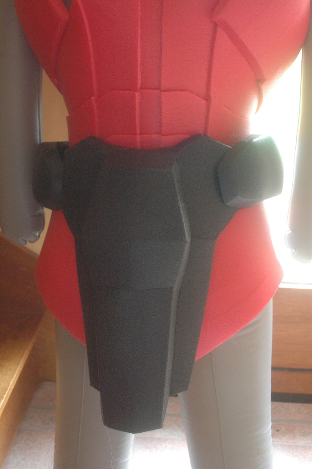

Cod piece and abs done.
I had to stretch cod, abs and spine, chest and back in height to match human proportions. So, many files are now updated in the shared *.rar package.
Thighs booster are still in spare parts on my desk. I didn't see it coming, but now I run out of glue... Will have to make a jump at my craftstore.
Yesss... Some trial parts I can't resolve to through away without heartache :$ Let's say they dress my dummy for the winter :)
