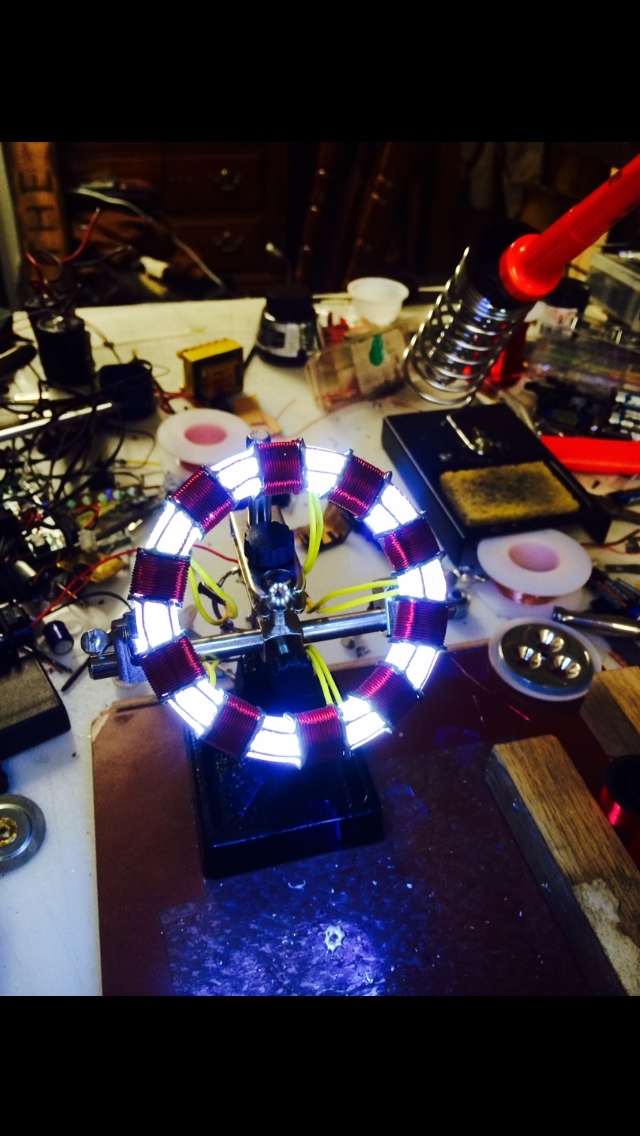

Is this for the Mark 1 Arc reactor?
if so:
Inside dia: 59mm
Outside dia: 71
Thickness: 7.6mm
(dimensions from the one I built, may not be 100% accurate but im sure its pretty close)

i do, however ive already began
to mark them out for the retainer slots, i use 8 retainers instead of 12 (12 being more movie accurate) the 8 makes the LEDS brighter and no light spots.

these are bubble free, but they are buffed and frosted to diffract the light to reduce light spots from the LEDS otherwise it wont look like a continuous ring of light.

I made mine out of 2 layers of 1/4" plexiglass that I glued together and machined on my lathe. I then sanded it with very fine sand paper and used an automotive headlight restoring kit to polish it back to crystal clear with no bubbles at all; leaving it with no visual appearance of it being two pieces.
I Then glued the numerous h/o leds in the same locations that the transformers would be and then wrapped foil around the top side, which I would then mount the transformers on too of. That way the windings of the magnet wire would hide the foil and eliminate any light from peaking through; as well as reflecting the light off the foil through the plexiglass which results in a nice uniform glow without being able to see where the light is coming from.
I hope this tip helps you and anyone else in need, and I hope to see more progress on your build. Keep up the good work!
