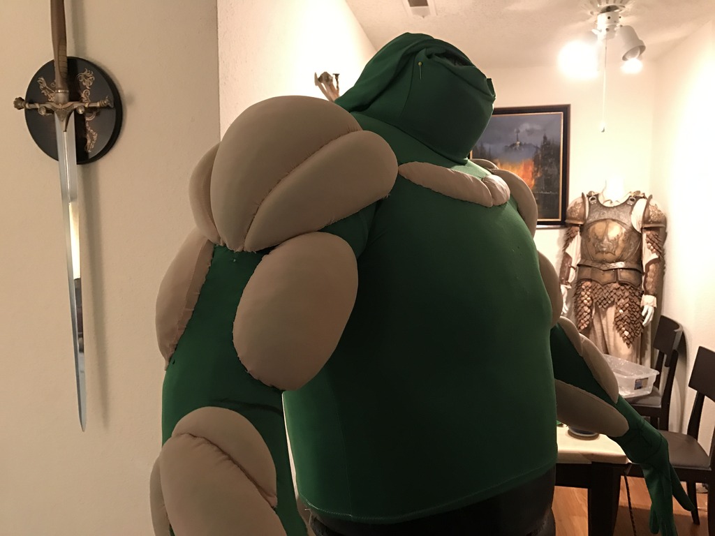

The Body Suit
I originally considered doing a full body sculpt and casting in foam rubber, but quickly decided that the cost (and my apartment) wouldn't make that feasible. So, I decided to take a cue from the costumers over at predatorium.com and make a muscle suit covered in latex. Using a duct tape dummy, I created a mannequin out of polyfoam. Muscles are being carved out of upholstry foam, covered in spandex, and then stitched to a spandex body suit. Once the muscle suit is completed, that will be covered in another layer of spandex to act as "skin". This skin layer will be covered in thin latex where I'll add textures and paint. The boundary between this muscle suit and latex gloves will be covered by leather wraps and accessories, so I'm not concerned about the differences (yet, haha!)

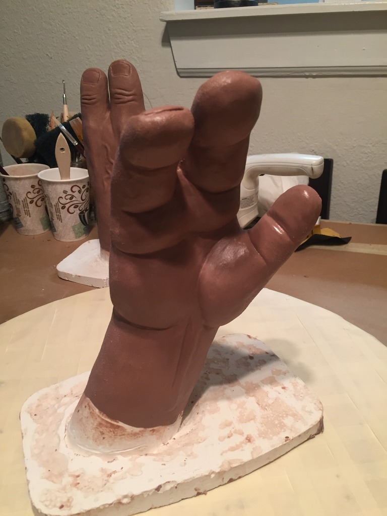

Hands and Feet
My foam and spandex method won't work for the hands and feet, so I'm casting them in (foam?) latex. I initially planned on simple latex rubber, but really don't like the way the gloves "bend", so I'll likely cast them in foam latex (which means learning how to cast in foam latex!). I haven't sculpting anything in over a decade, and was never very good, but I've been watching a lot of videos from the Stan Winston School, and that's helped a lot. I've gone through a few sculpts of the hands, and made a few test pulls of latex to figure out the process. The hands are sculpted in Monster Clay on top of a life cast of my hands. I wasn't sure what position of my hands would be best, so I did two kinds. I prefer the slightly cupped position (for the latex rubber casting at least).

A small update. I was getting tired of carving foam, so I decided to do a quick test to see how the spandex "skin" would look. Even though I just quickly tossed it on a single arm, I'm surprised with how well I like it. I'll be sewing it down in a few spots to give the muscles some definition, but it doesn't look too bad. Seeing the skin on top of the muscles also helps me see where I want to adjust the shape of a few things, but it's nothing to bad. For those who may wonder, I chose red in case the final painted latex rips anywhere, it'll look like more like a battle wound than a costume malfunction.
