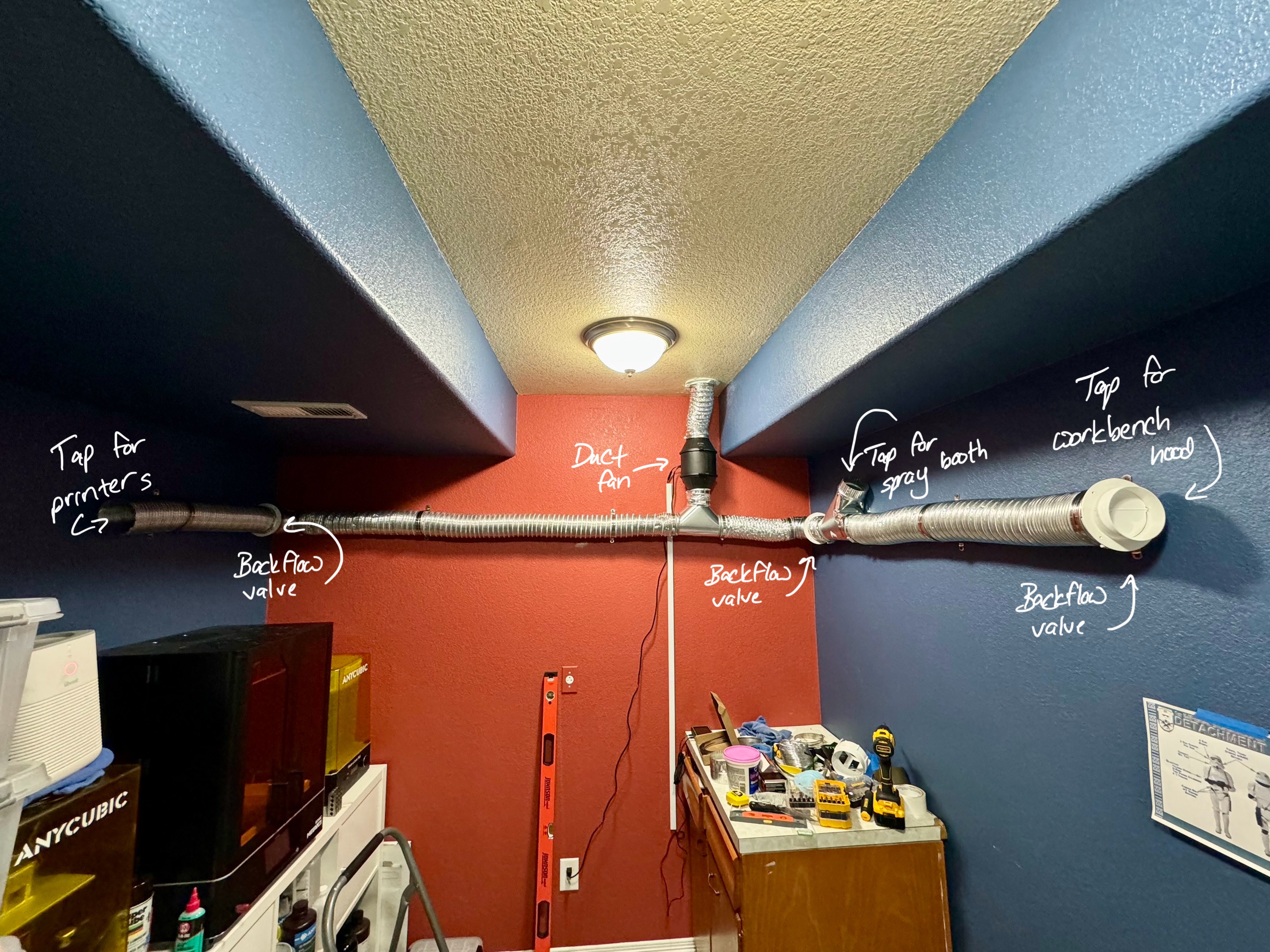

This is what I did in my shop:
To help with the air flow, I picked up one of these grow fans from Amazon. They have different models depending on how much you want to spend. I went with this one as it has a digital controller with temp sensor and a mobile app : VIVOSUN AeroZesh T4 Inline Duct Fan, Quiet 4" 210 CFM Ventilation Exhaust Fan w/EC Motor and GrowHub E42A Temperature Humidity WiFi-Controller Amazon.com

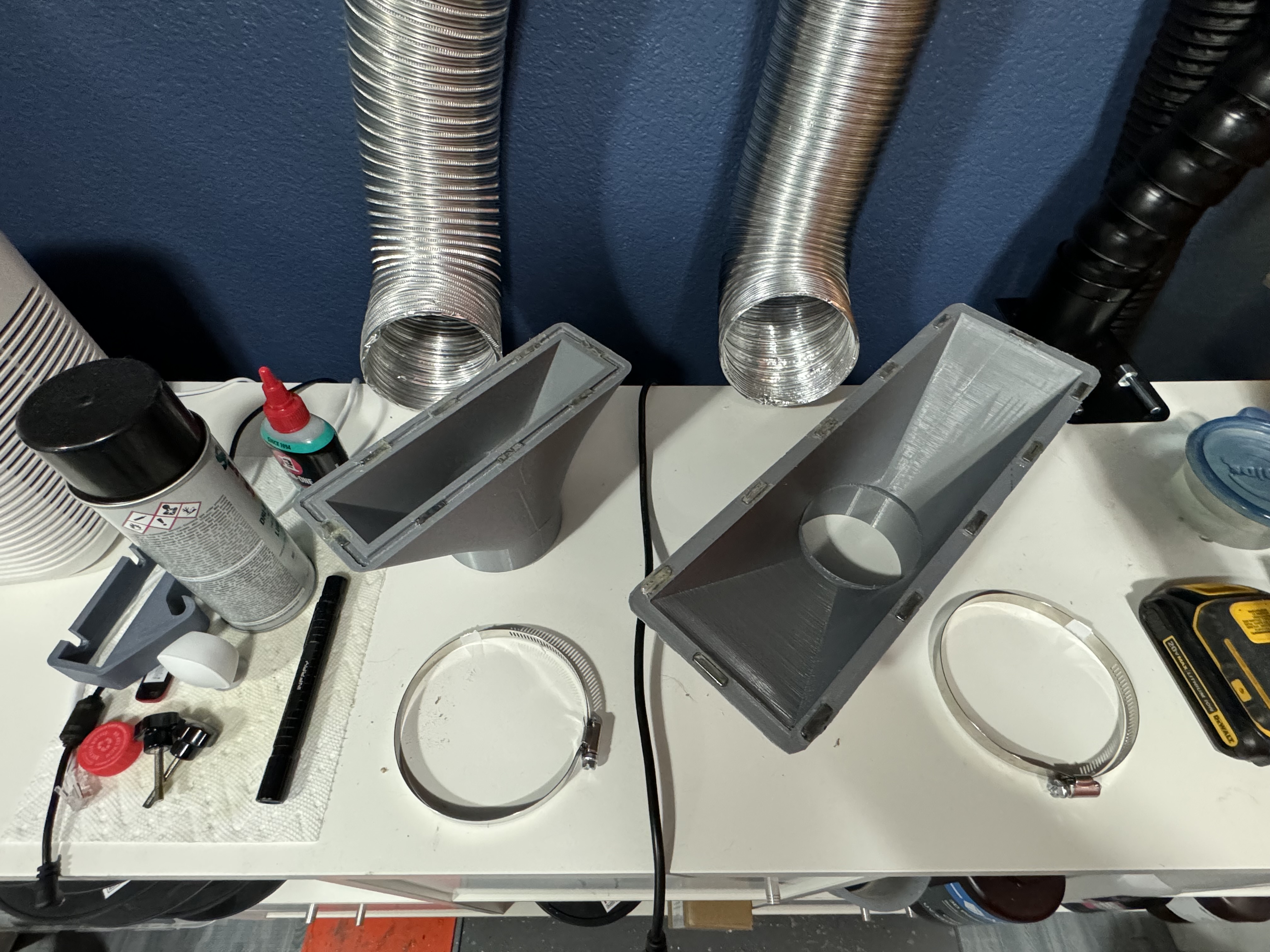

Lastly, I whipped up some custom vent hoods in CAD that fit over my printer exhausts. Added some magnets, and they slap right over the printer’s exhaust:
Even with the fan on low, I don’t notice any more sticky resin smell.
Let me know if you have any questions!
