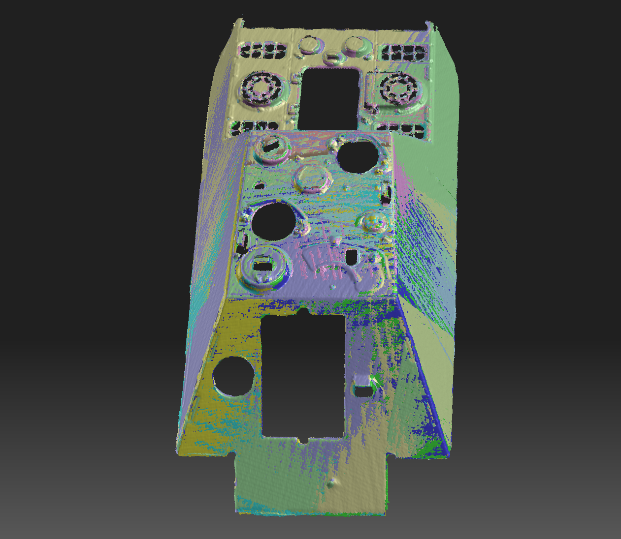

Hi Tracy,
Generally speaking, and from my somewhat limited experience, some or most scanners have difficulty with transparent, reflective or dark materials.
You can sometimes get round this by either painting if that is acceptable for what you are doing. Alternatively, you might get away with applying a temporary coating like scan spray, or similar product which provides a better surface for return of light without reflections and artifacts which can confuse the scan software results.
I think there have been some new developments recently with either the wavelength or type of light used in some scanners. Structured light is becoming an alternative to laser. And there are different grades of laser accuracy.
I use scanning more frequently for doing this type of work.
Are you looking to do this yourself or use a commercial scanning outfit?
