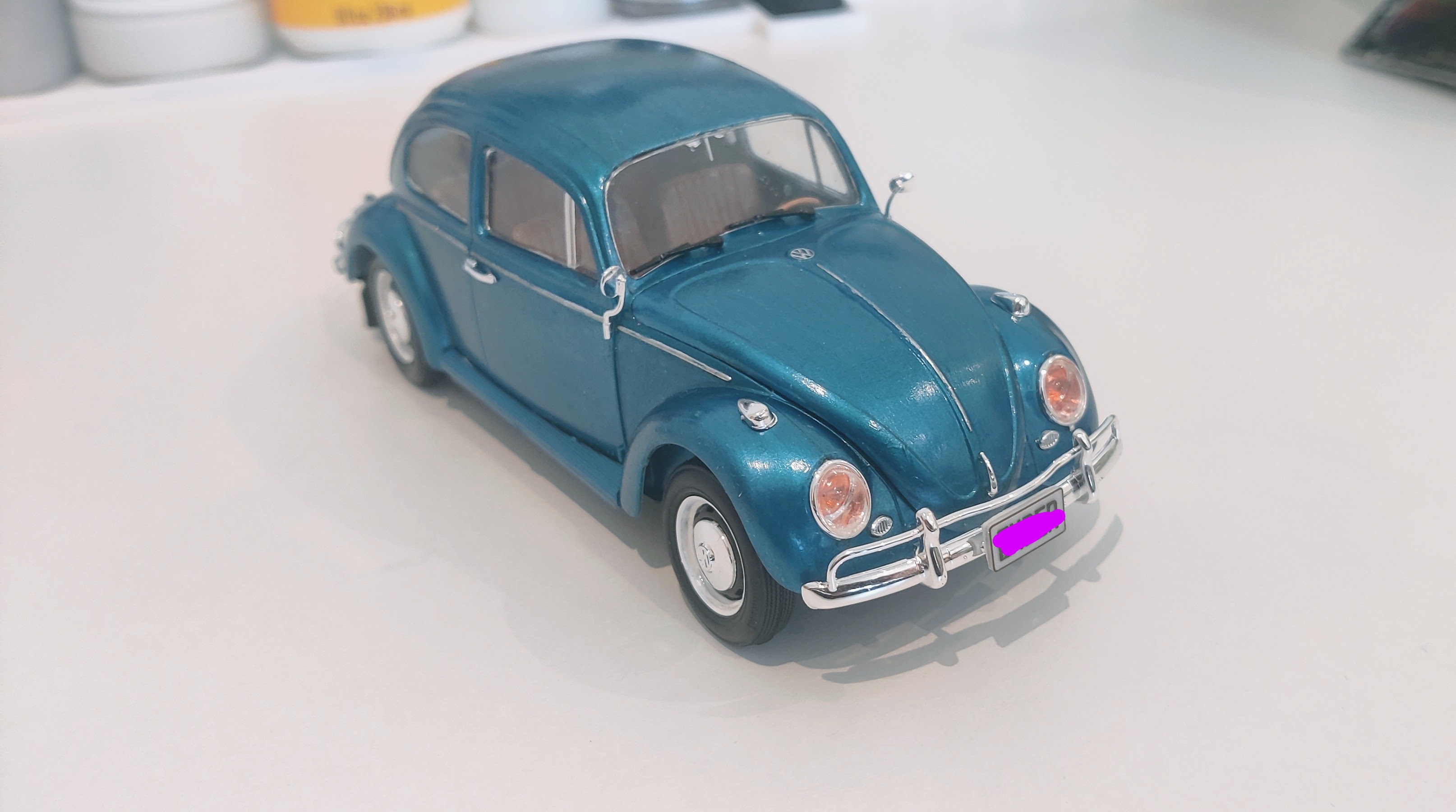

Update, thanks so much for everyone's help, that went loads better! (Had to censor the license plate because I ended up 3d printing a custom one with my name lol)
I have my eye on the bandai falcon next, hopefully that's not too ambitious as a second real go at it haha

That came out great! I'm glad you're getting some quality time with your dad. :)
Which Bandai Falcon are you looking at? The 1/144 TRoS version is a decent compromise on size vs. cost and it's a really great kit. It comes with both the rectangular and circular antennae. It does have some small and delicate pipe work, but it all fits together really well.
