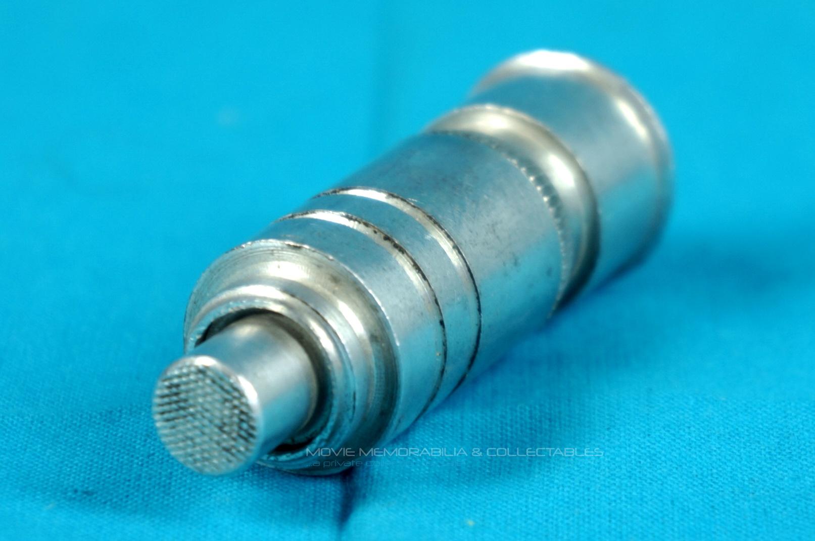

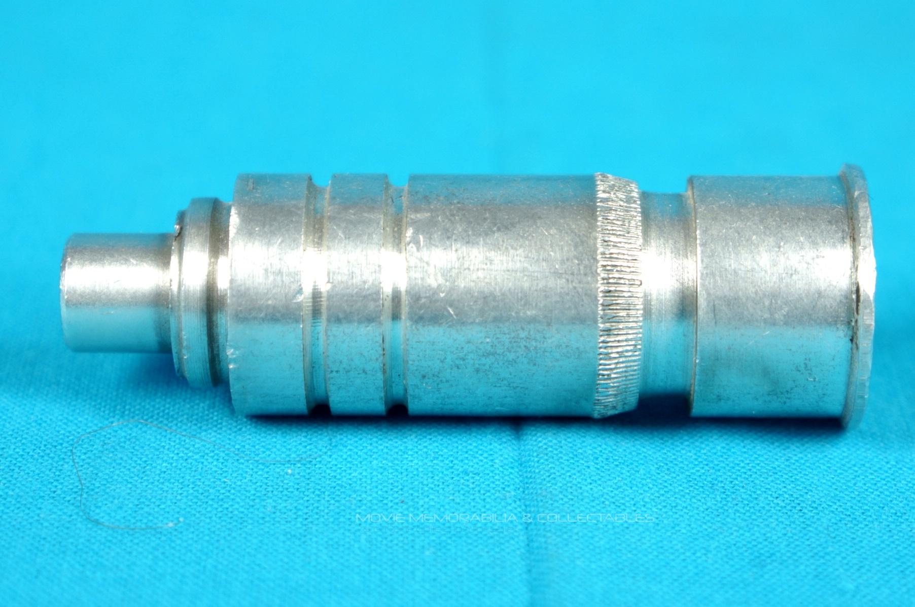

All of the original prop grenades used in the movie were hand made on a lathe, some out of wood. So there will be some variation between them.

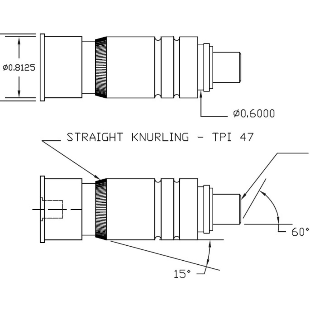

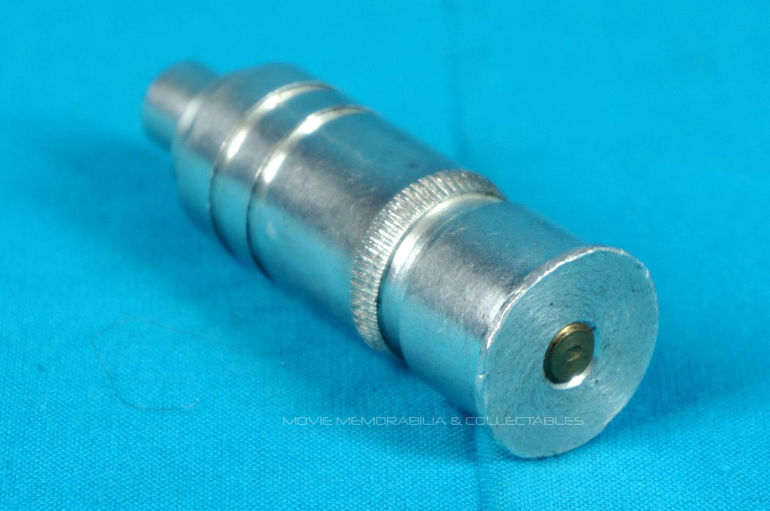

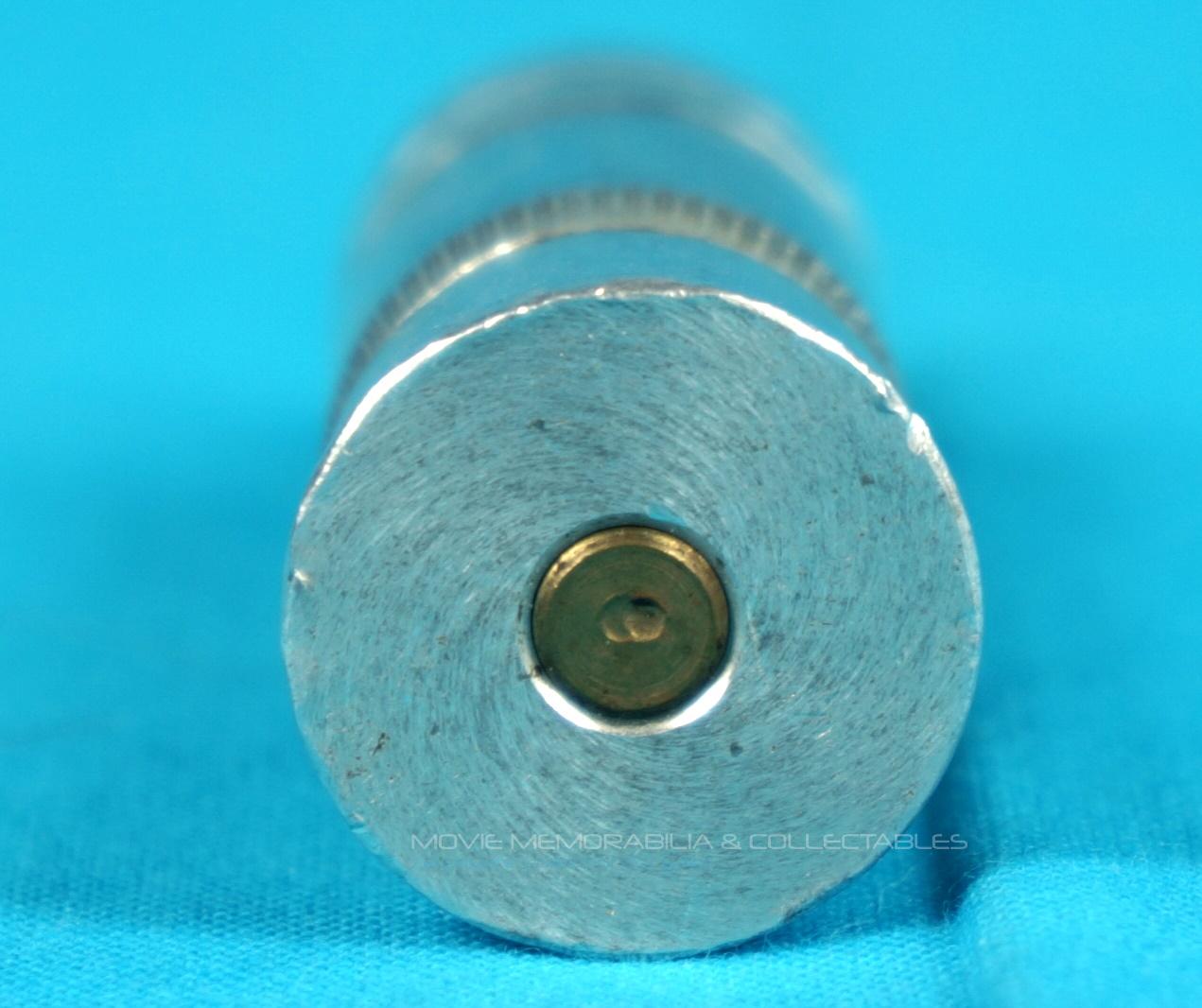

I reverse engineered a grenade in AutoCAD, from a Screen-Used prop, for the most screen-accurate grenades as possible.
The goal here is to have the most accurate prop possible, while keeping unit cost as low as possible - So there will be no moving parts on these. They will be a solid piece of aluminum. I'm also going to press a spent primer in the base, rather than have a custom piece of brass machined.
I'm working with a new machineshop, I talked with them today, and they can fit these in before the end of the year.
We're aiming for a unit price of $10 each. Shipping may be extra.
I want at least 50 for myself, and I've already sold 40 on Instagram... So we might be aiming to have 250 or more made.
Send me a message for the quantity that you want, and for payment info.

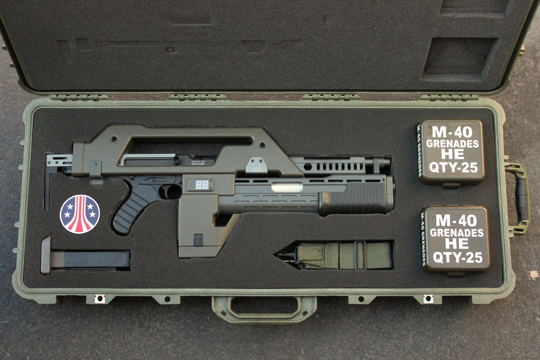

If project costs go over, I'm going to eat it, because I'm keeping 50 grenades for myself. I'm going to fill my two Grenade Boxes in my Pelican Case.

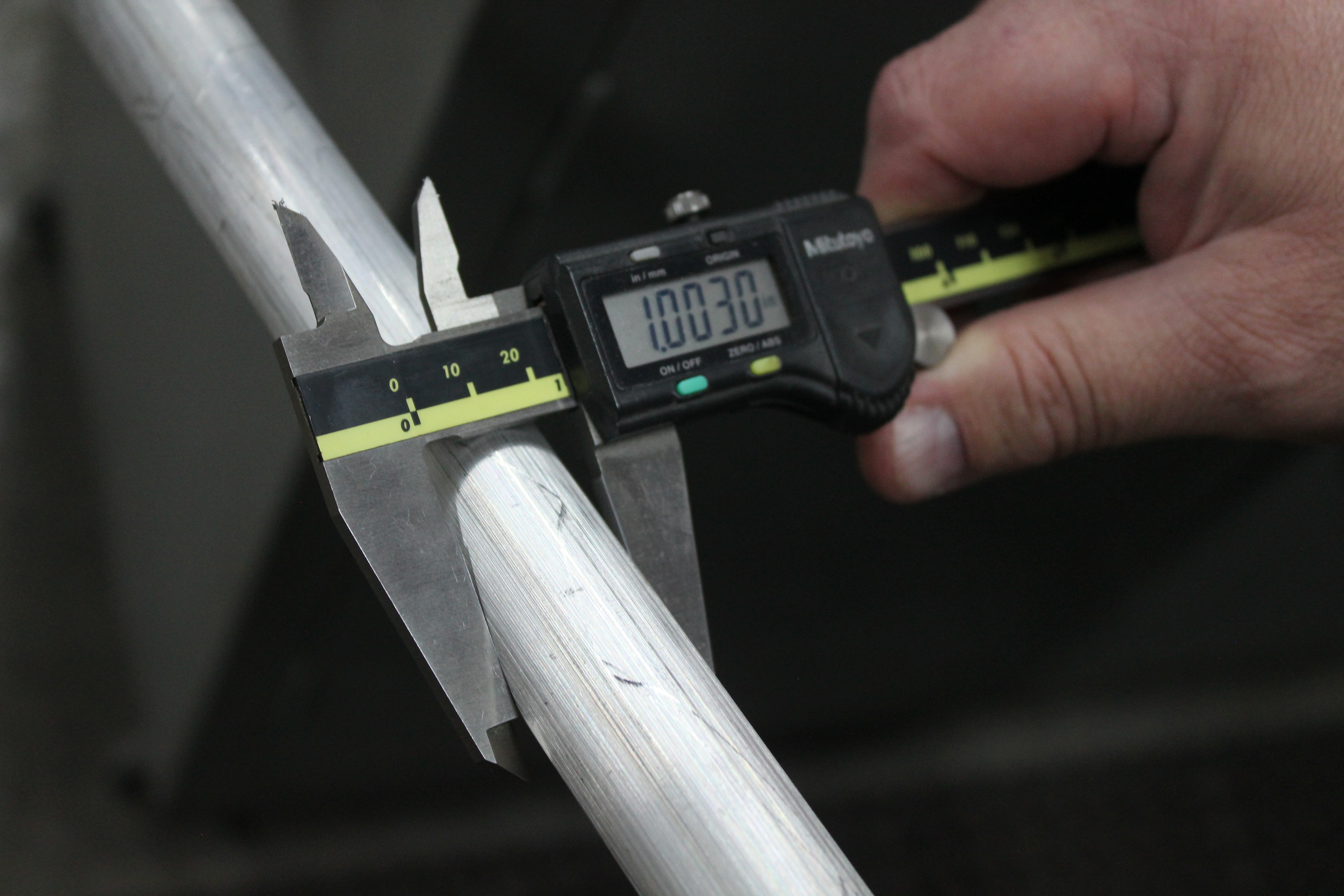

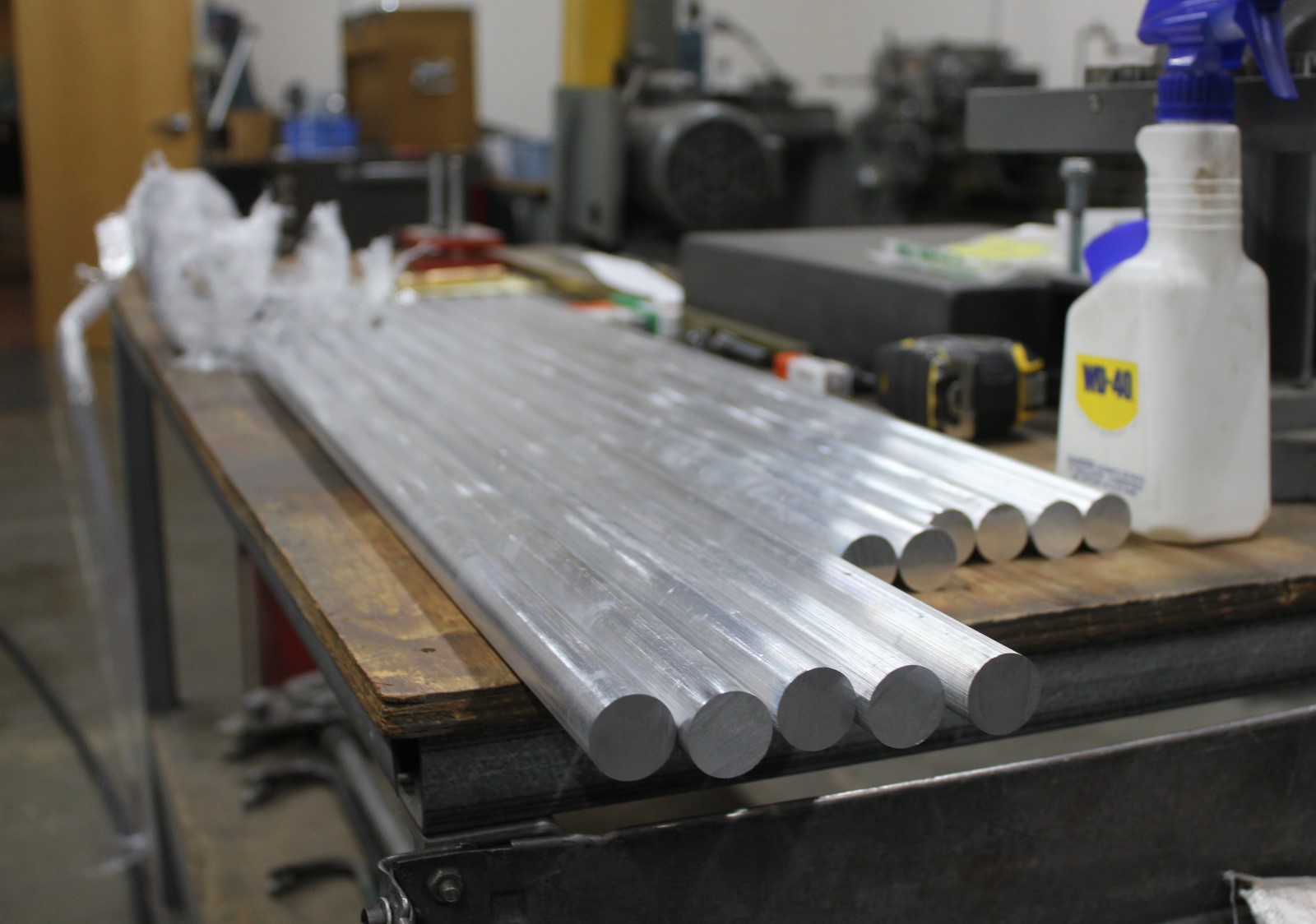

Aluminum stock has arrived!
We'll be making 250 dummy grenades
Expected to be ready January
Pre-Order is $10 each! (about 150 available)

“I'm also going to press a spent primer in the base”
The first few times I read that, I think I misunderstood; now I’m slightly surprised. Are you saying you will insert (press fit) an actual used shotgun primer into a recess in the aluminum part? You have 250 of them, salvaged from a shooting range or something?
I have thousands of spent shotgun primers. I sorted them, by hand, into different colors.

SET BACK!
We discovered that the aluminum ordered is "over-sized". The machinist had to order a new collet for the CNC Lathe, directly from Hardinge. This will add about a week of a delay.
Expected ship date on inert dummy aluminum machined M40 grenades is now early Feb 2023.
PRE-ORDER $10 EACH until the end of January. After that, there will be a price increase.
