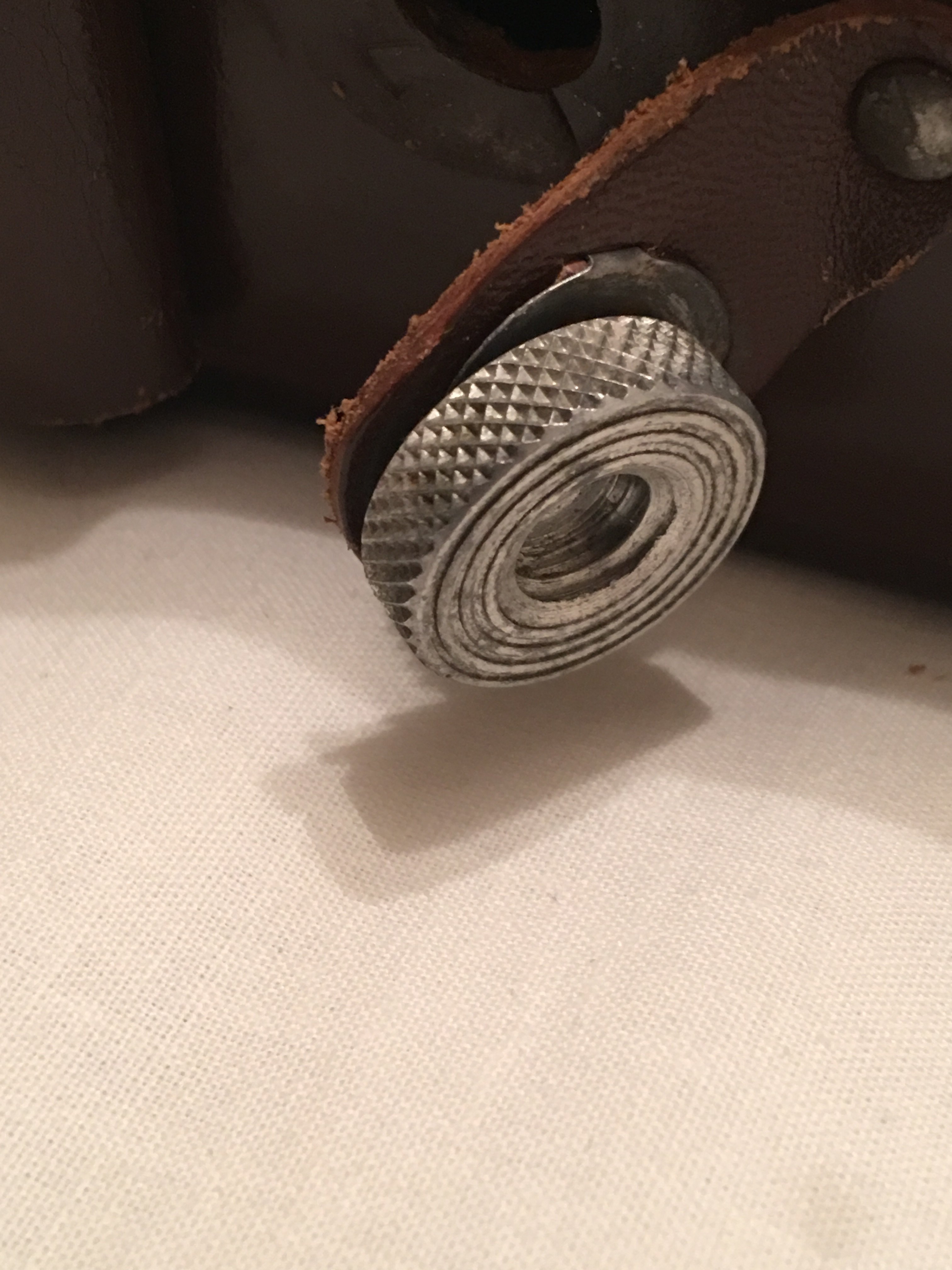

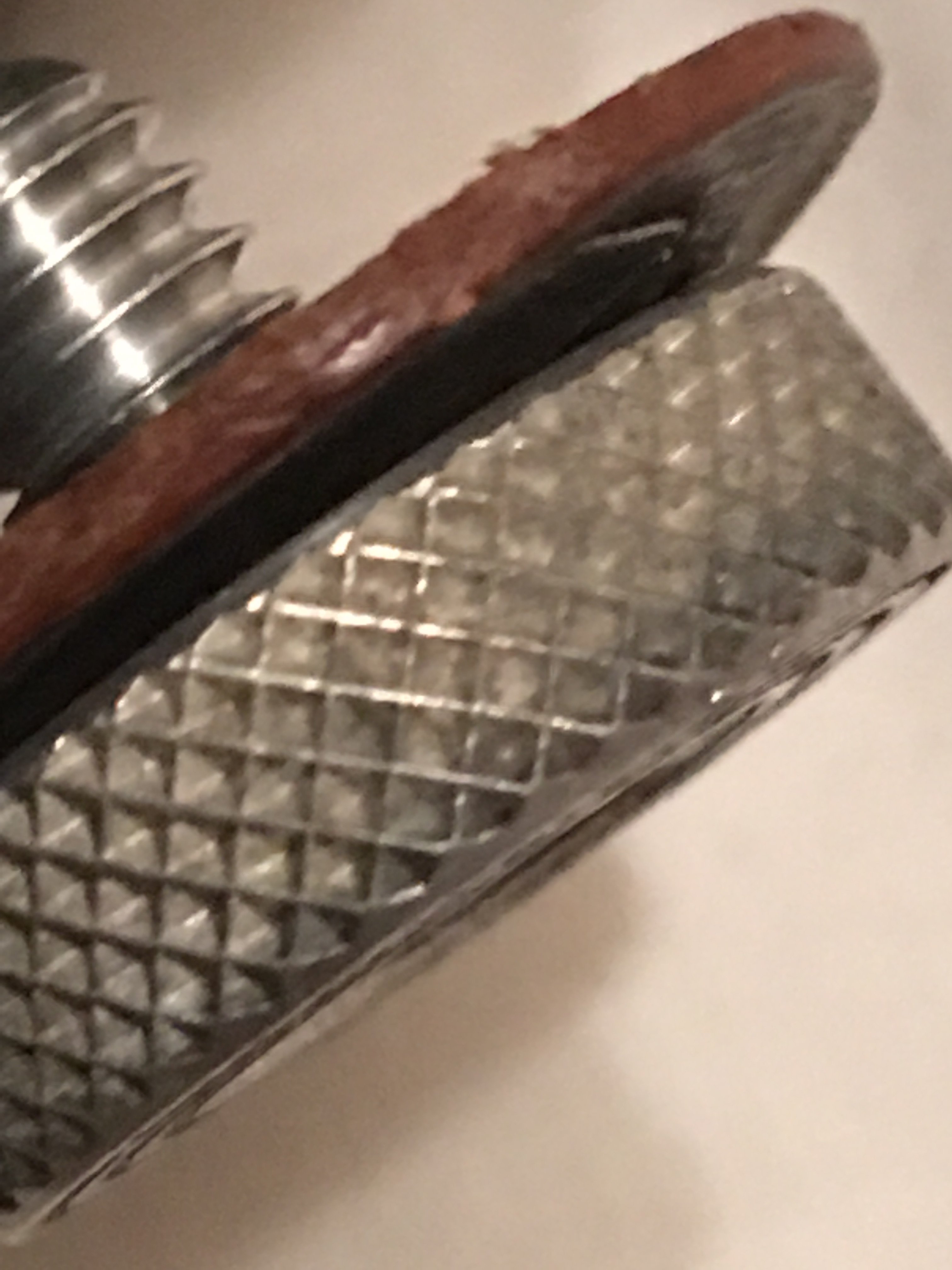

Going over reference for this blaster the other day, I noticed a small detail that everyone seems to have missed.
The two thumb nuts are STRAIGHT knurled, not diamond knurled. It appears that every single replica missed this from Master Replicas to the new movies.
I'm guessing that after MR did diamond knurl everyone else assumed they knew what was correct and copied it.
Not sure how MR missed it.
Close up of the original prop (same top view from Chronicles)
Dave at Dark Energy said he's in the middle of a run now and could make some with straight knurl.
Yeah the proper thumbscrew is not on the Eumig case. I believe the poster was mistaken.
I do like that inverted kneeling on yours, though. Or are my eyes playing tricks?
Sent from my VS996 using Tapatalk
it is inverted I never even noticed it before

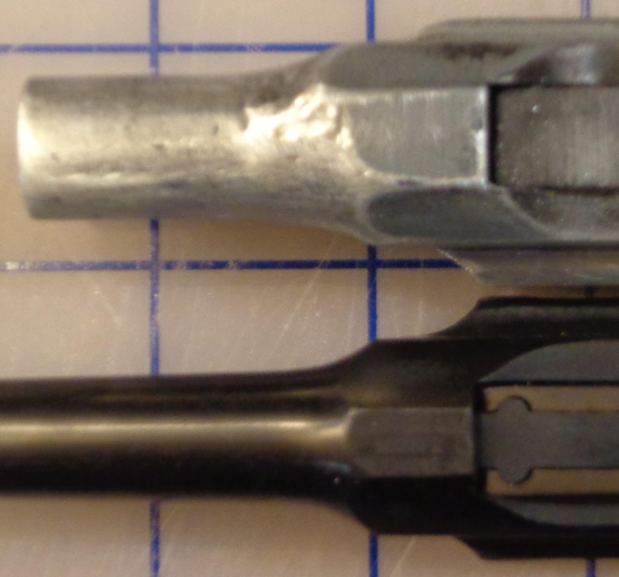

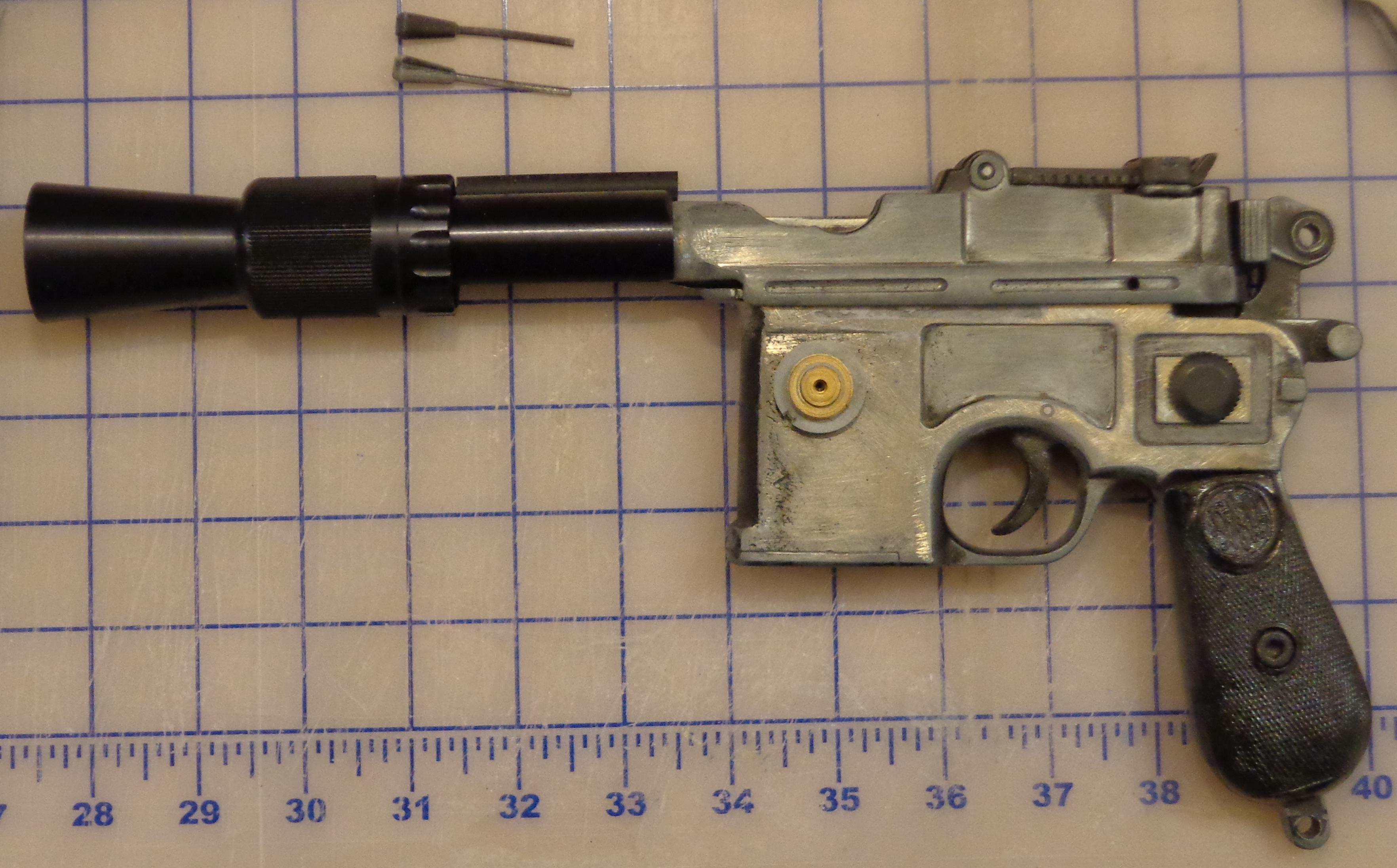

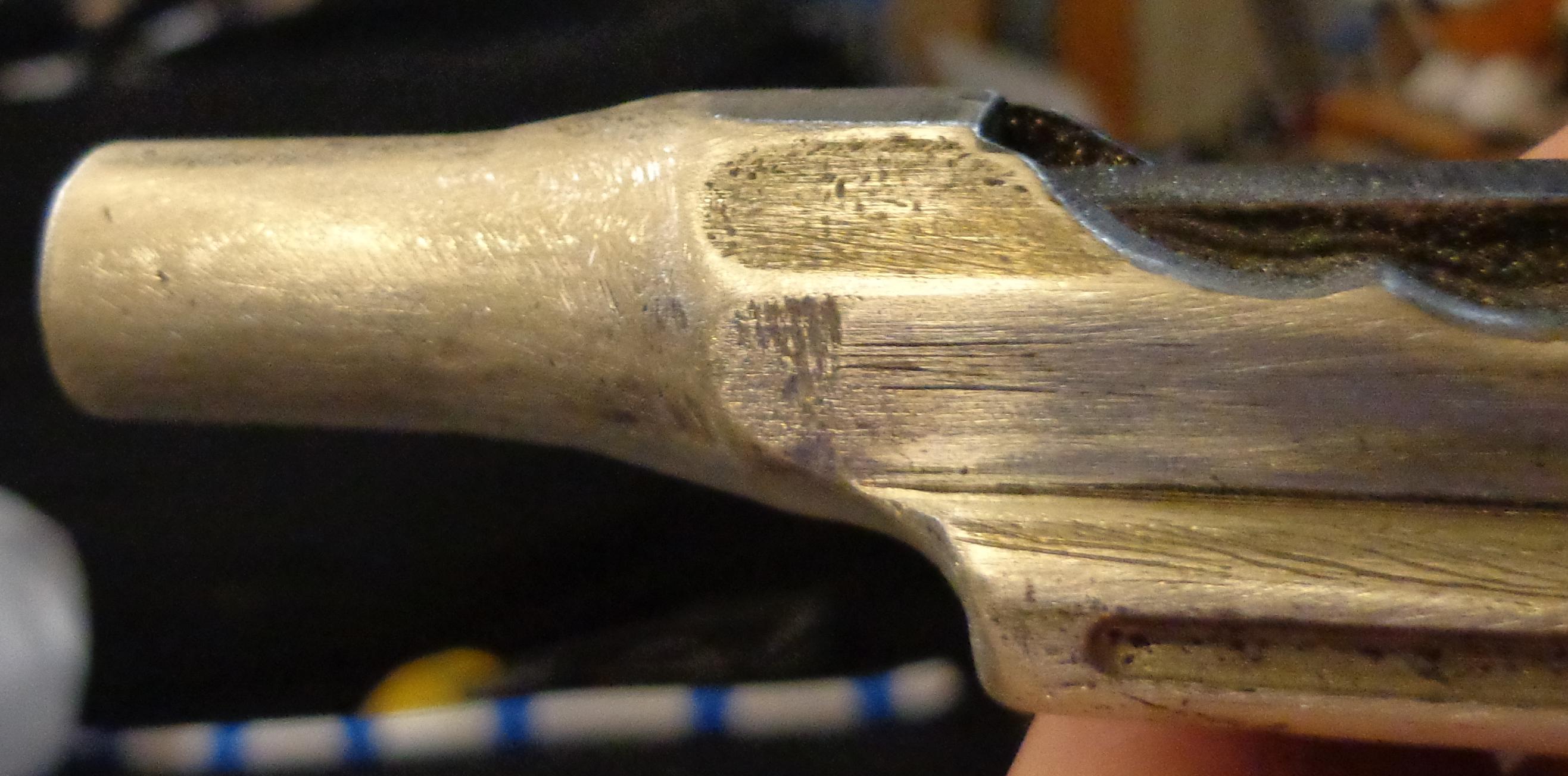

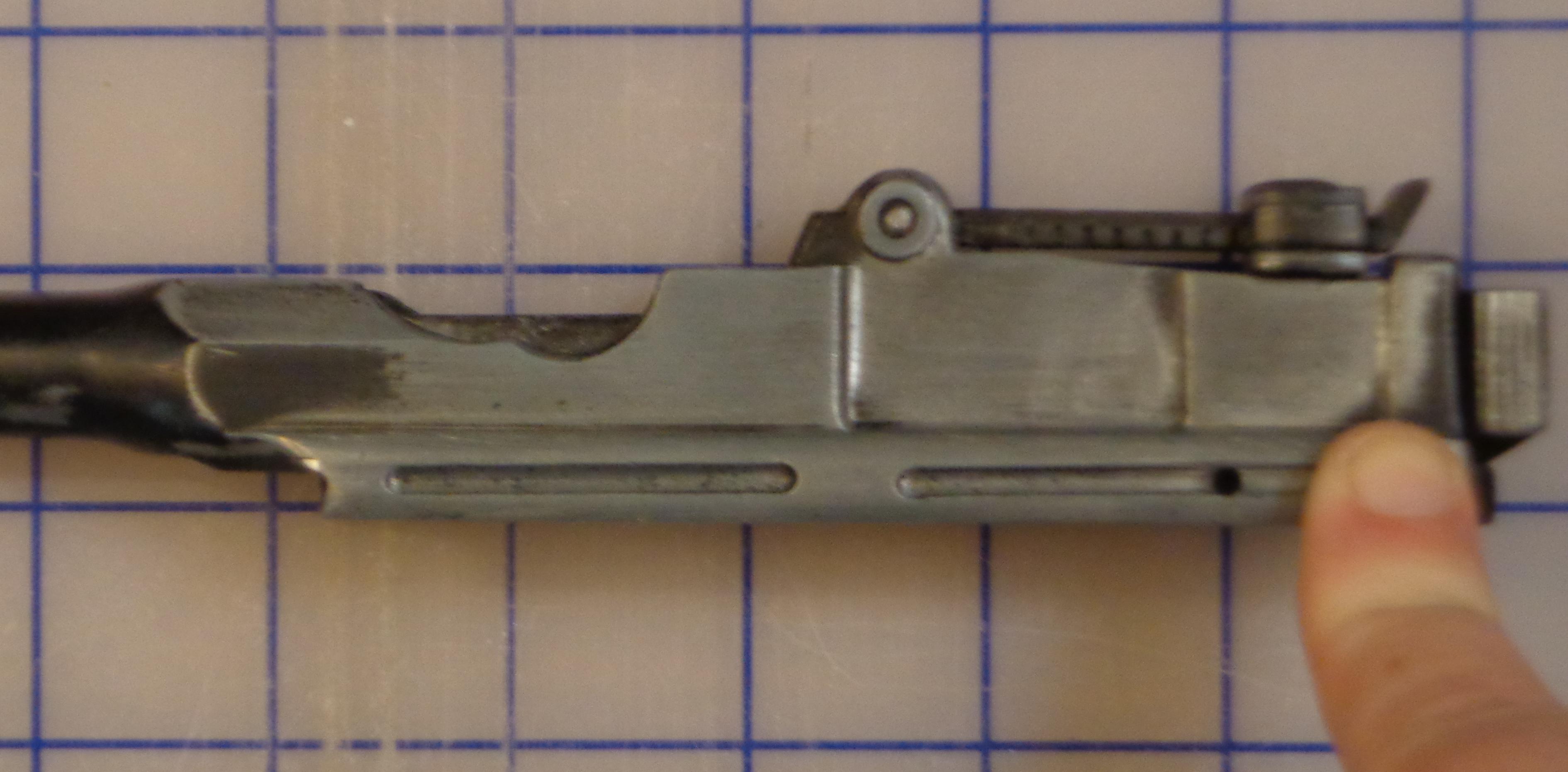

I'm doing that, but my build has been back-burnered while I try to hunt down more info on the Merr-Sonn "scope" plug. I have images and measurements and eyewitness descriptions of unphotographed angles. I know it's a vintage 4-pin CB/ham radio style plug -- but with characteristics I've not seen on any modern iteration. Much headaches. But here's roughly what I've done to my Denix so far:
The biggest thing is fixing the breech so the bull barrel fits properly. The magazine base plate can be approximated by carving the outline, drilling out the "release button" location on the bottom, and putting an appropriately sized pin in there. The Denix hammer is okay, with a bit of work. Depending on how much sweat-equity you want to put into it, you can create the illusion of the back end of the lock and the groove for the stock with careful Dremel and file work. The safety lever needs to be repositioned, which is best accomplished by either cutting off the Denix one, securing the knob to an accurately sized strip of metal, carving a notch for it, and gluing it in place... or buying the real deal and gluing it in place.
Me, I'm intending to get an actual C96 bolt and extractor rather than try to fix up the awful Denix one. I'm also superdetailing my Merr-Sonn, with the aftermarket phenolic grips, the "WM" monogram smoothed out and replaced with the Imperial cog, the sawn-off rear scope-mount post turned into an actual feature, and the blank right side billet plate (where the real C96 is engraved with "Waffenfabrik Mauser, Oberndorf-Nekkar" is engraved with "Merr-Sonn Munitions" in aurebesh. So my Denix cleanup is not necessarily what one should look to for making a DL-44. Here's the last full mock-up I did:

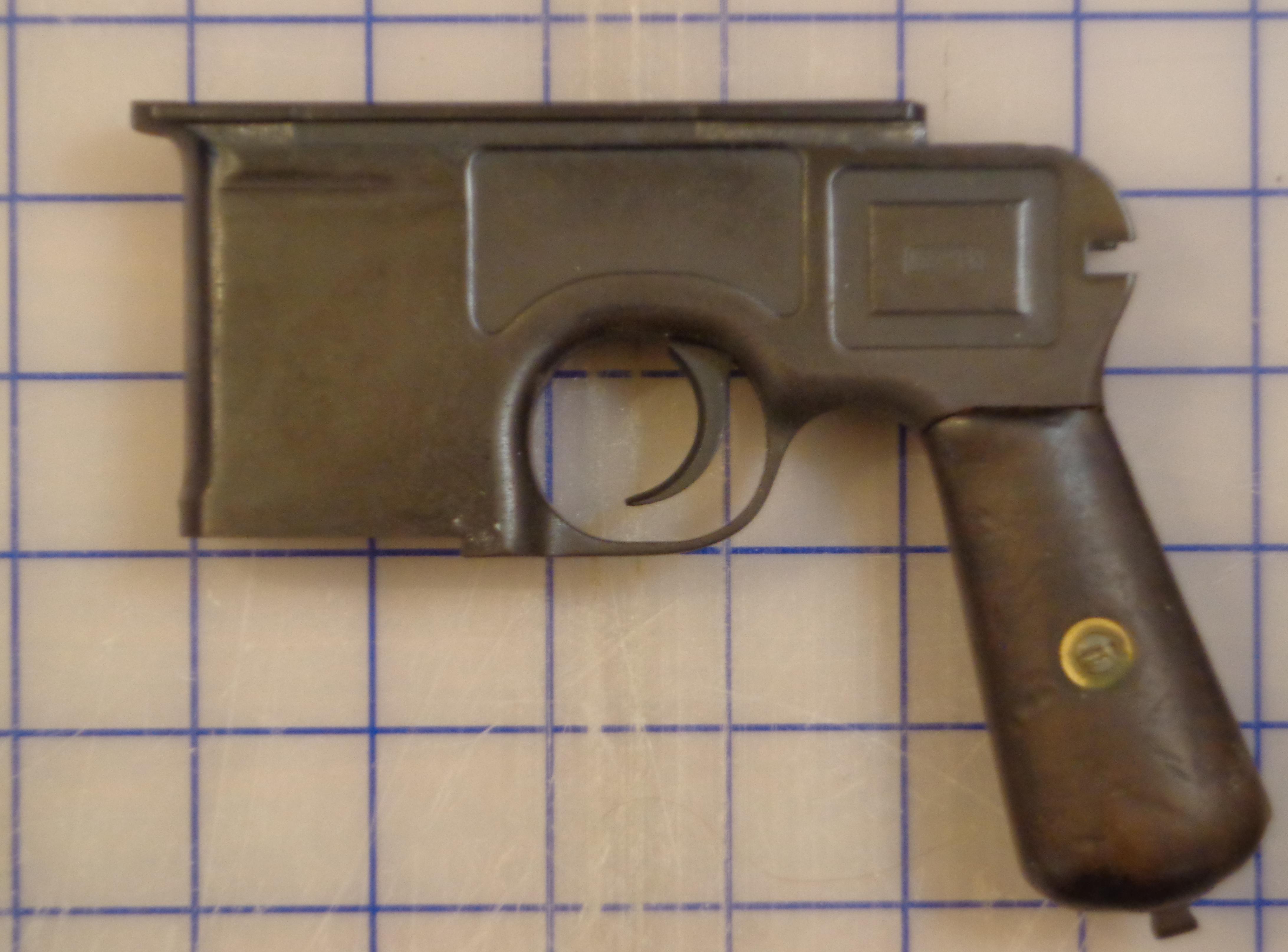

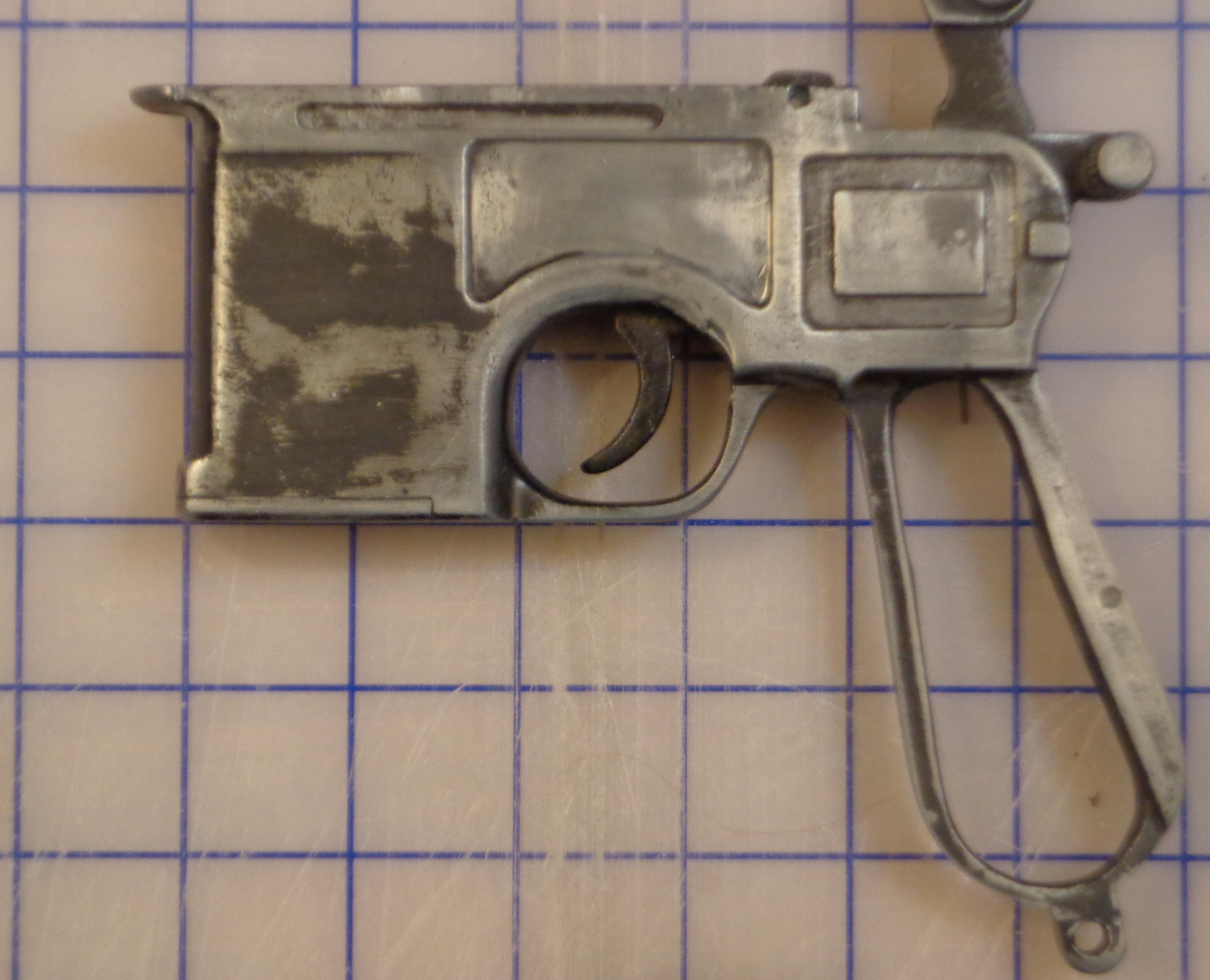

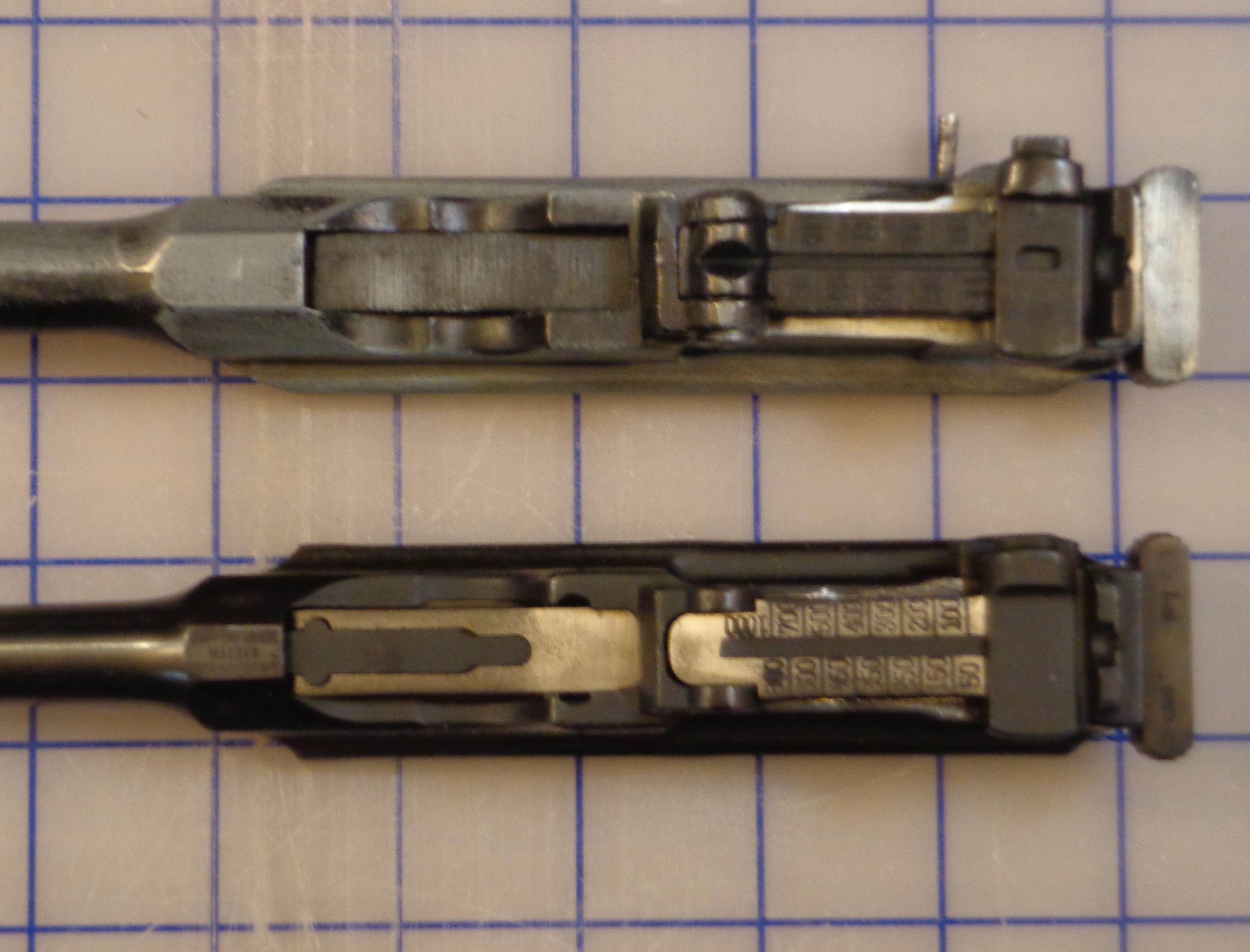

Oh, none taken. *lol* I'm the same. Like I said, I need to get the pics from further along off my camera, sorted, properly named, etc. I admit, the guy I got my Denix from had already done some work, and I'm not sure what all he'd tackled. The trigger and overall dimensions and fit seem pretty good, actually...

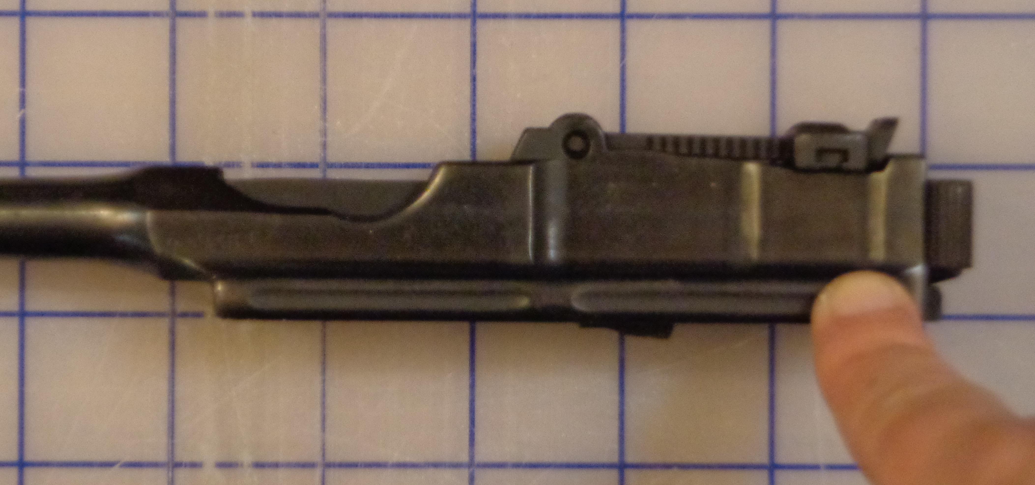

While I have some work yet to do around the loading/ejector opening, the receiver seemed a good enough starting point machining an entire new one seems a bit excessive. (And yes, I know my actual Mauser is a Bolo -- grip comparisons are not happening.)
The most extensive I'm going with mine is the original-parts sight and hardware, and the original-parts bolt and ejector. But I can also see going for an original mag base plate, lock mechanism, hammer, and safety, even though I'm not going that route. I don't feel like carving out that much zinc (already doing more of that than I want to on the right side of the mag, but that's a story for another time).
