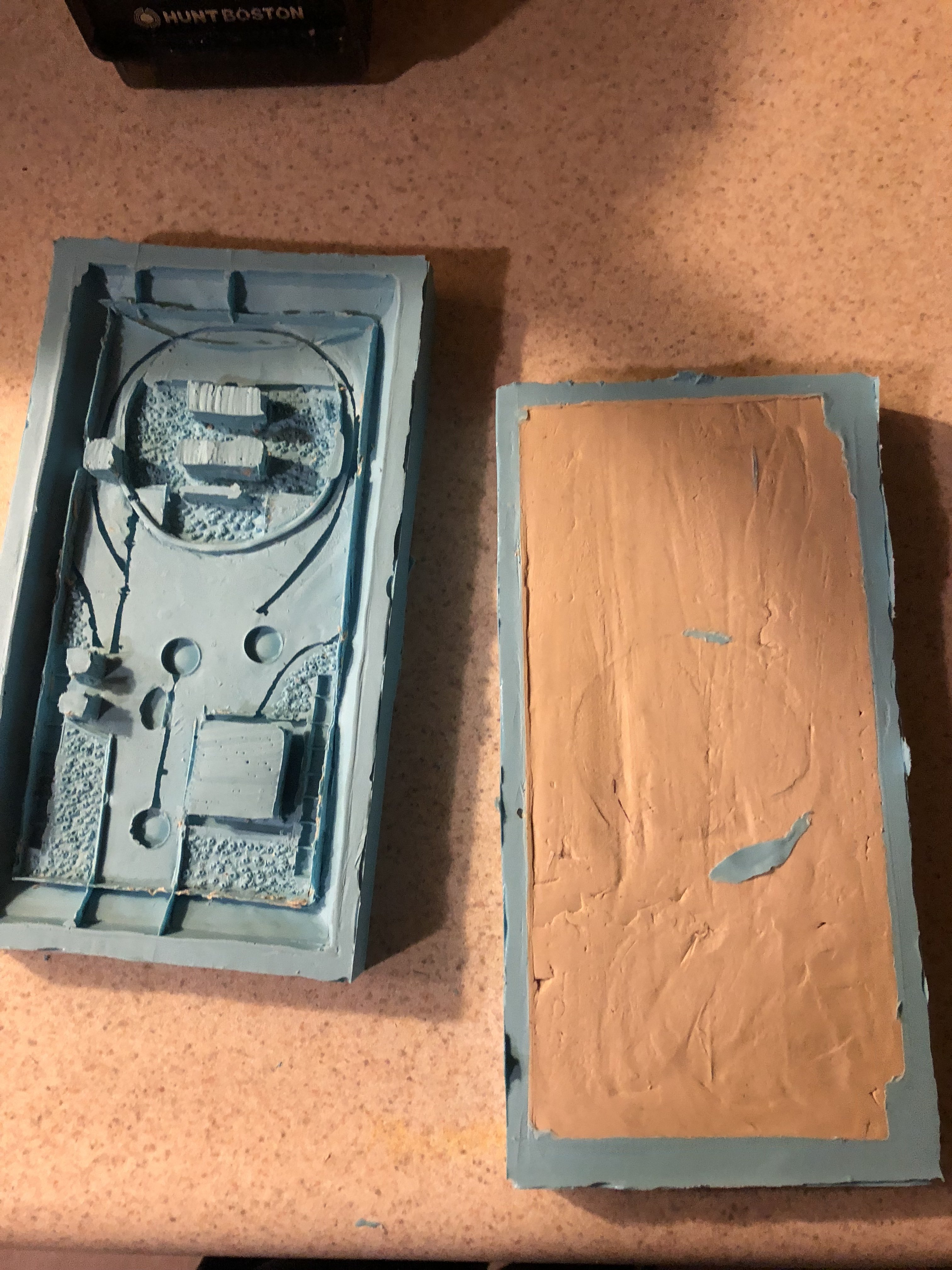

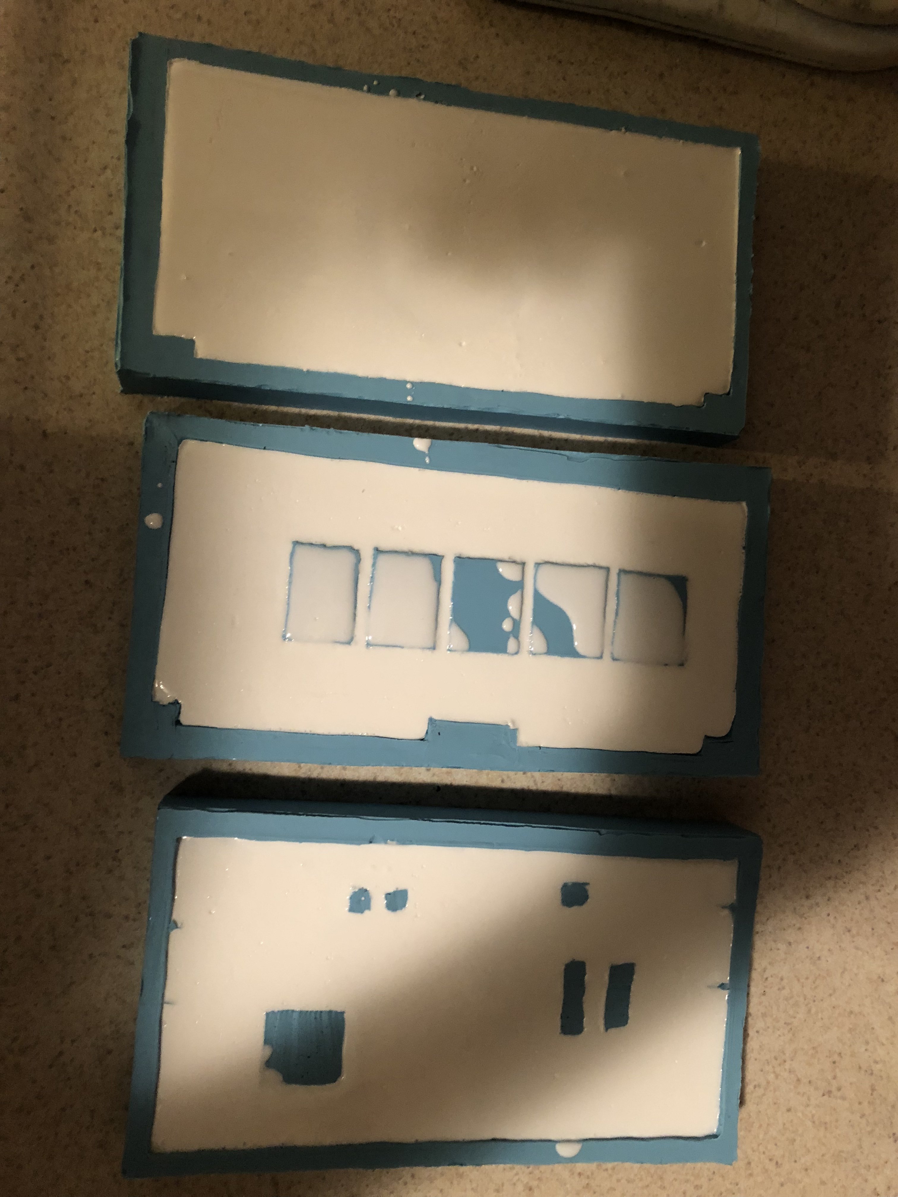

Getting ready to mold right glove then pour latex for both hands once mold is complete.

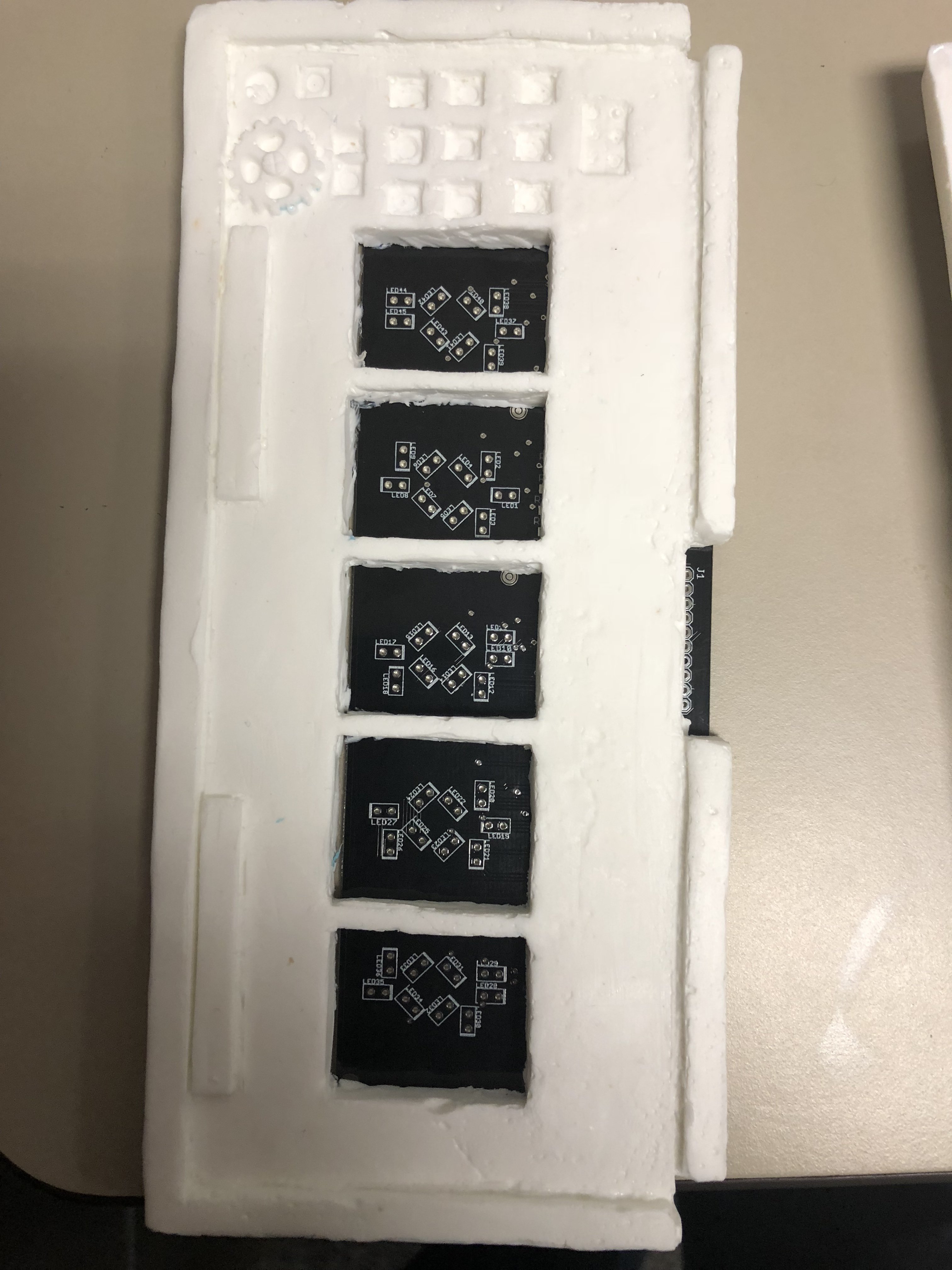

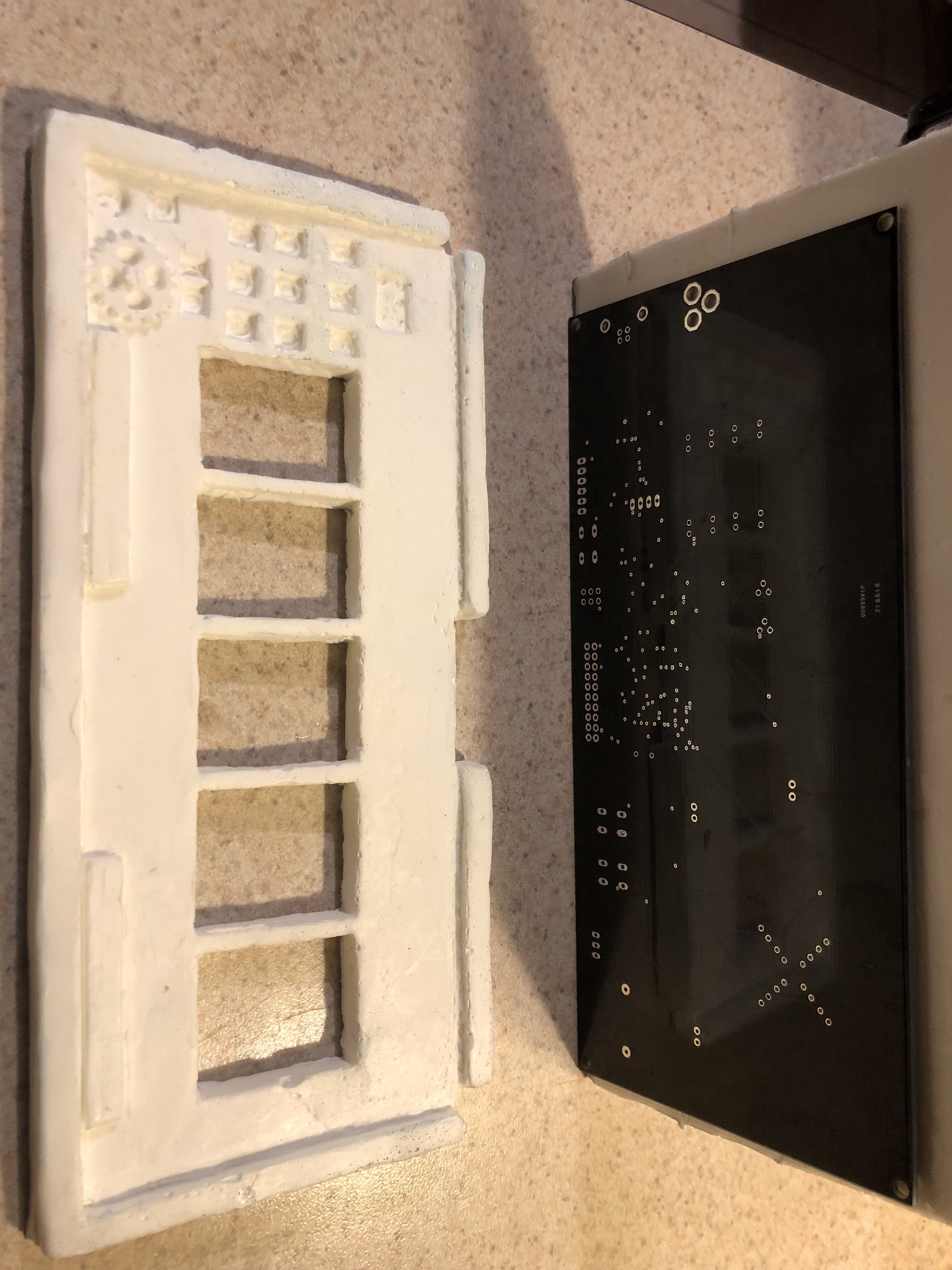

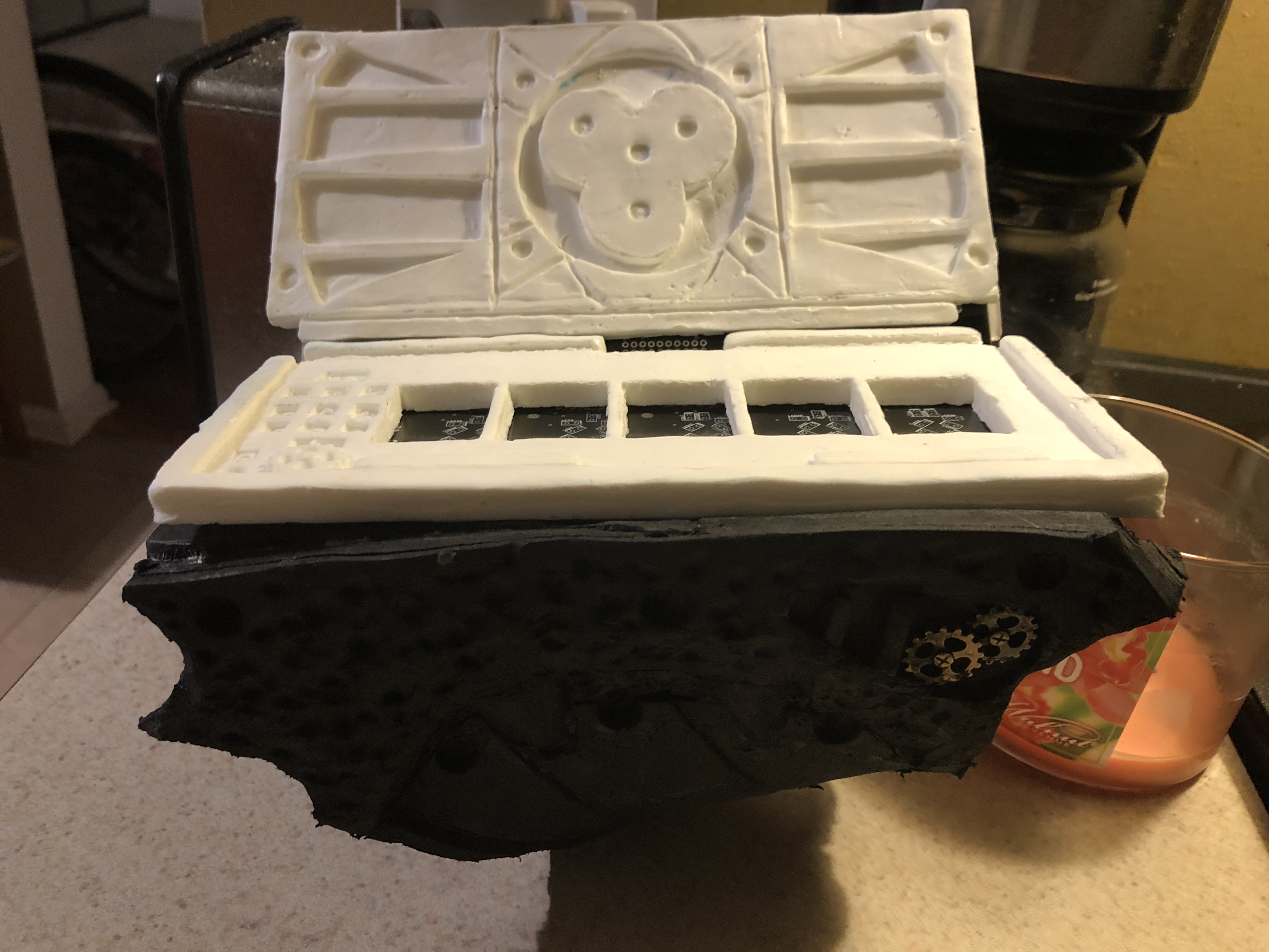

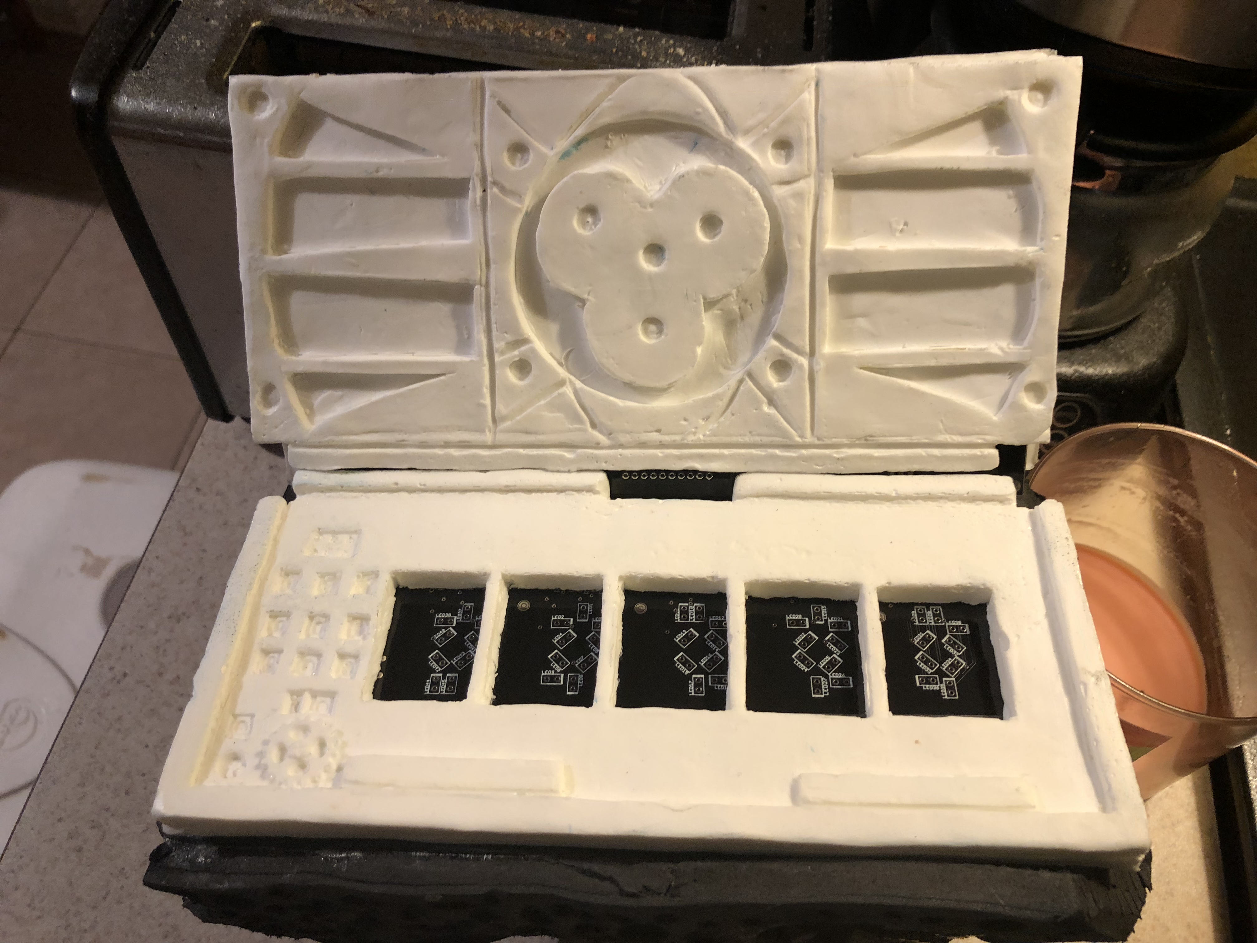

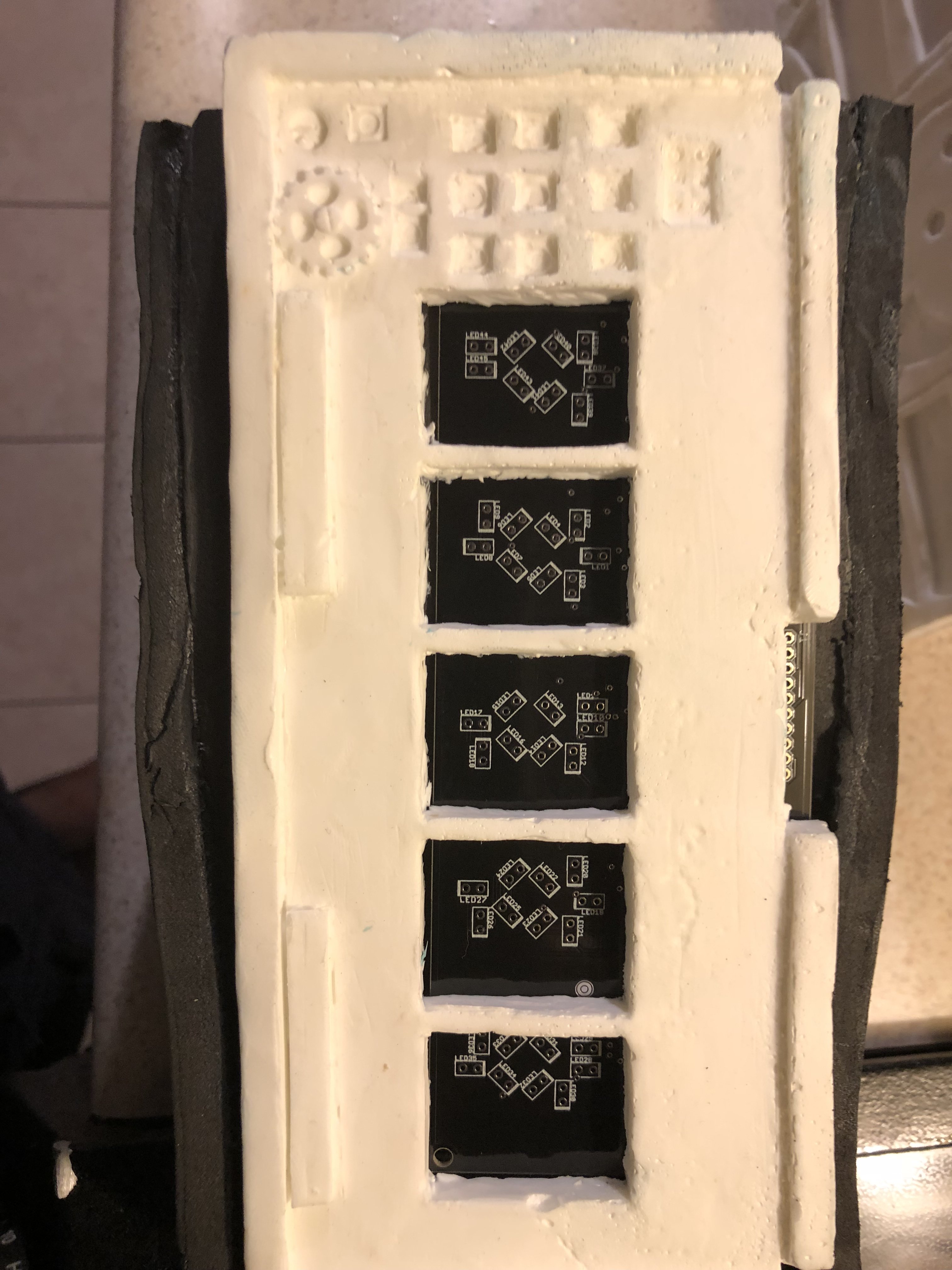

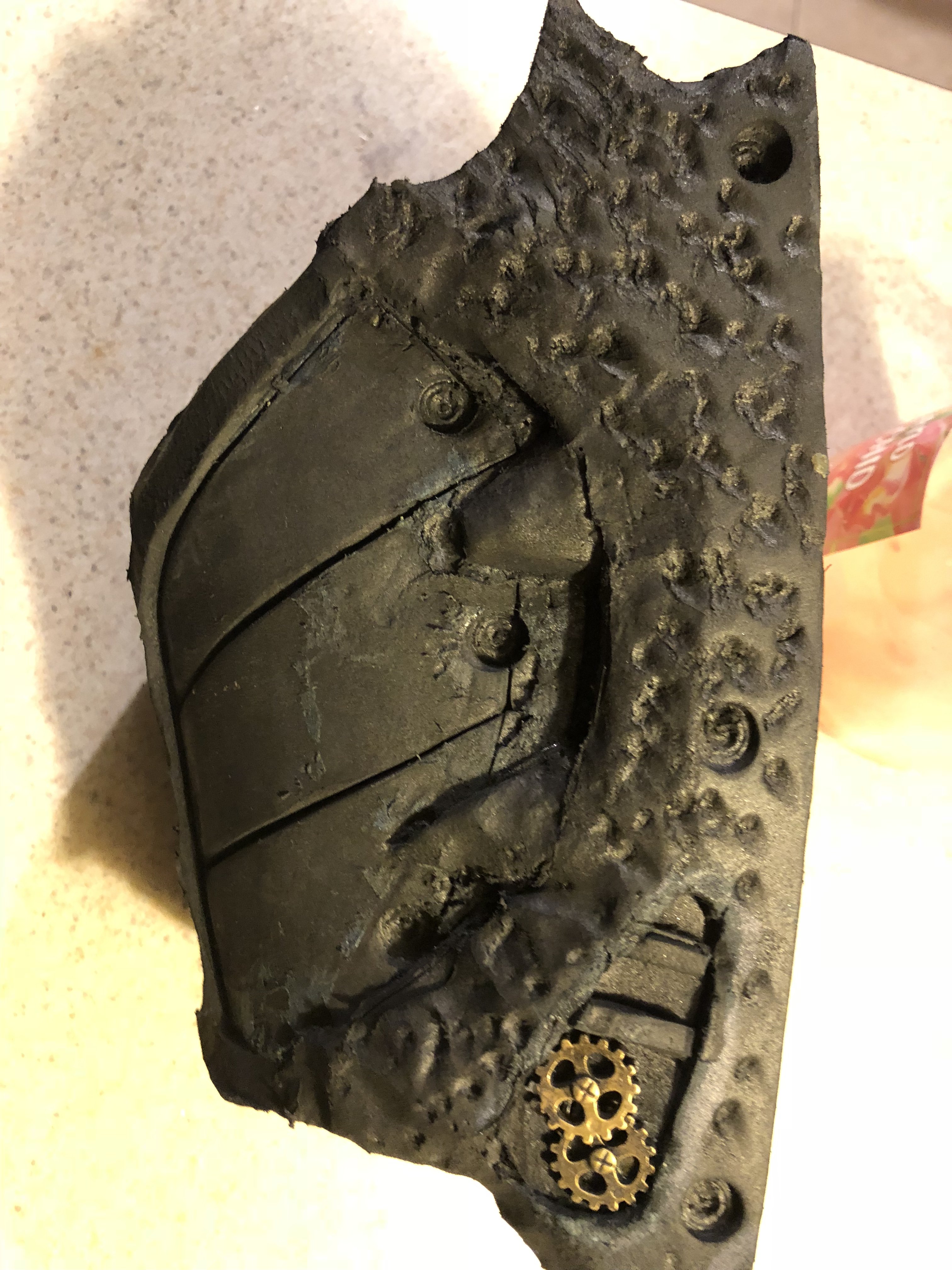

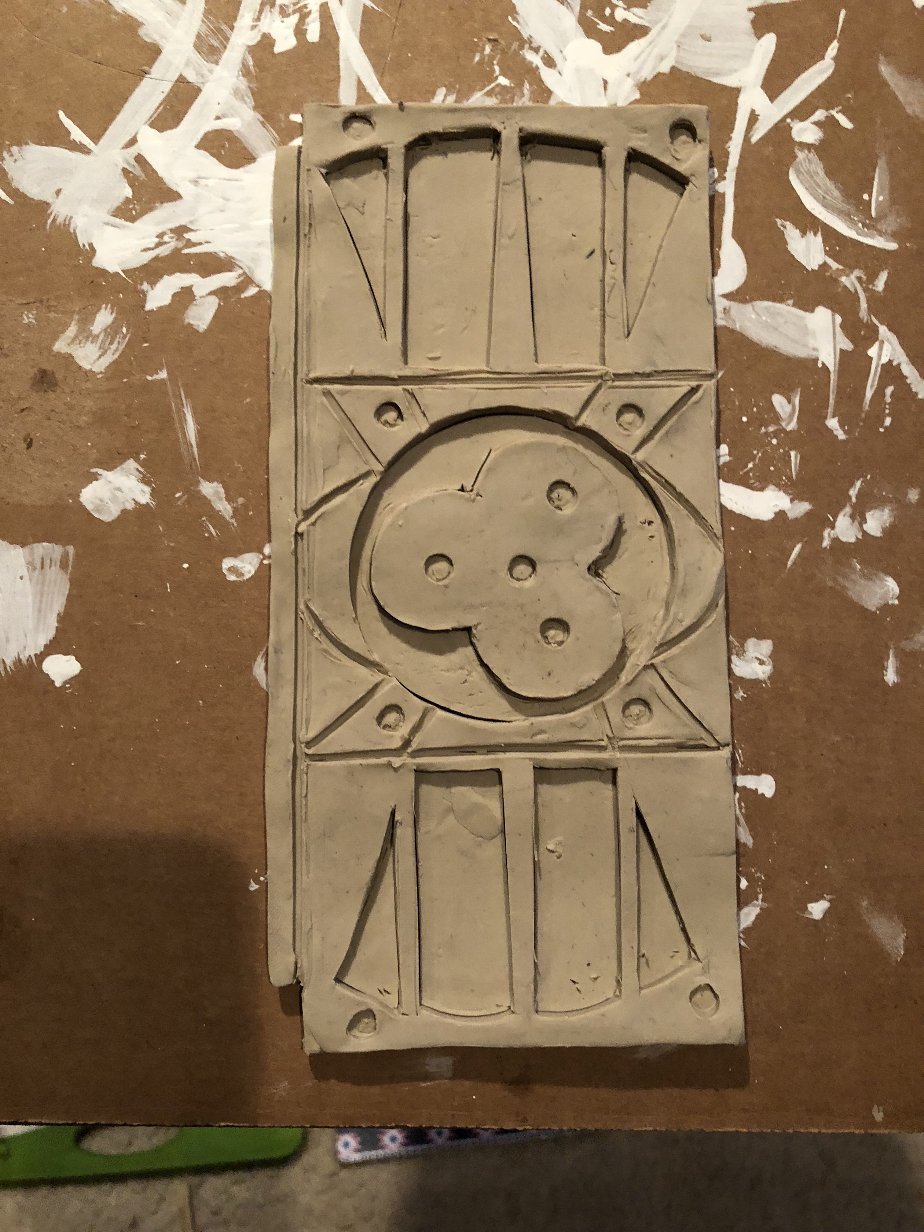

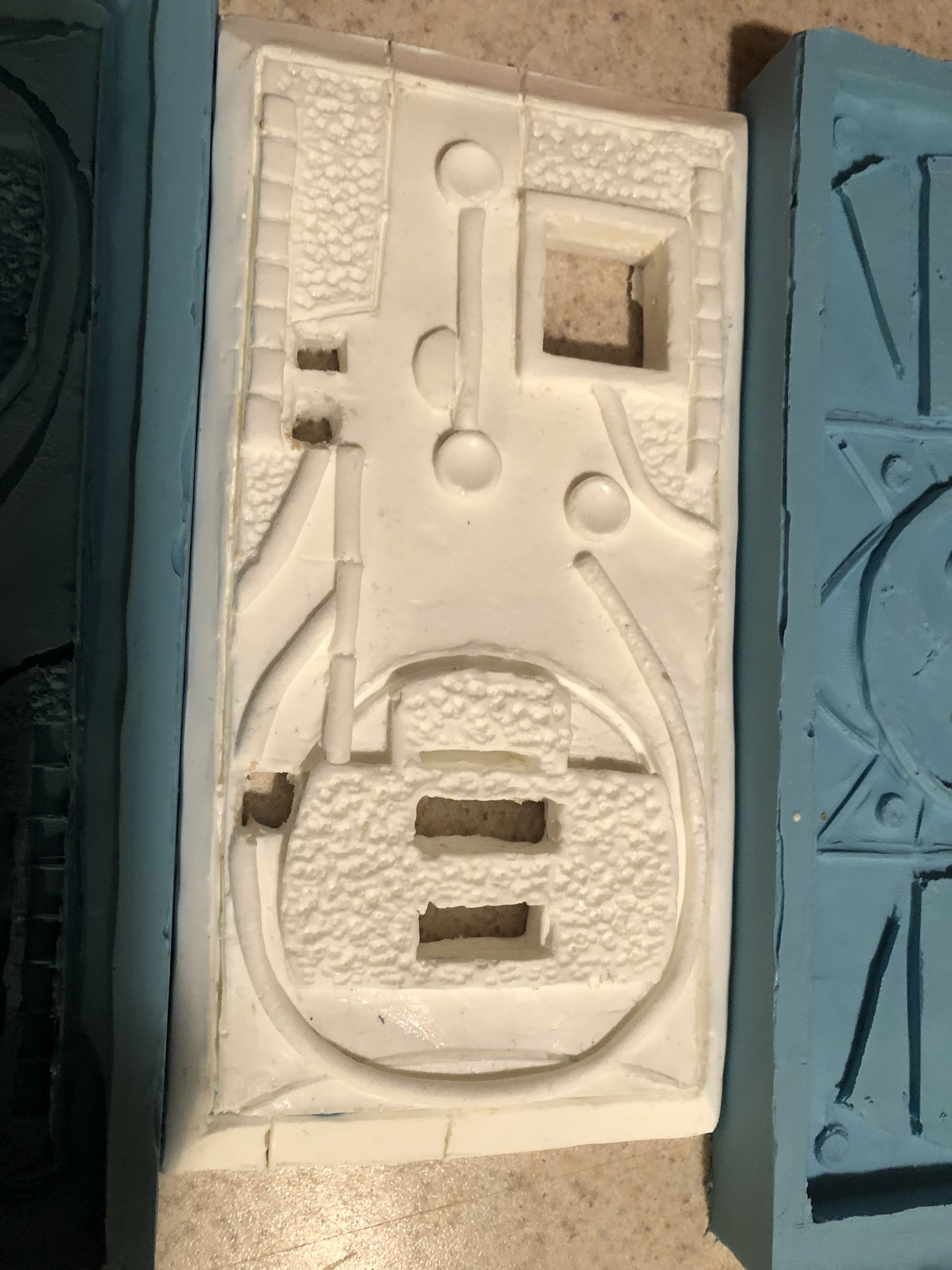

The easy part is complete and some clean up is needed. It needs sanding to reduce some of the weight .The lighter the better . Needs Hinge , complete detail on the actual foam gauntlet .Solder all the parts, test and combine it all together.

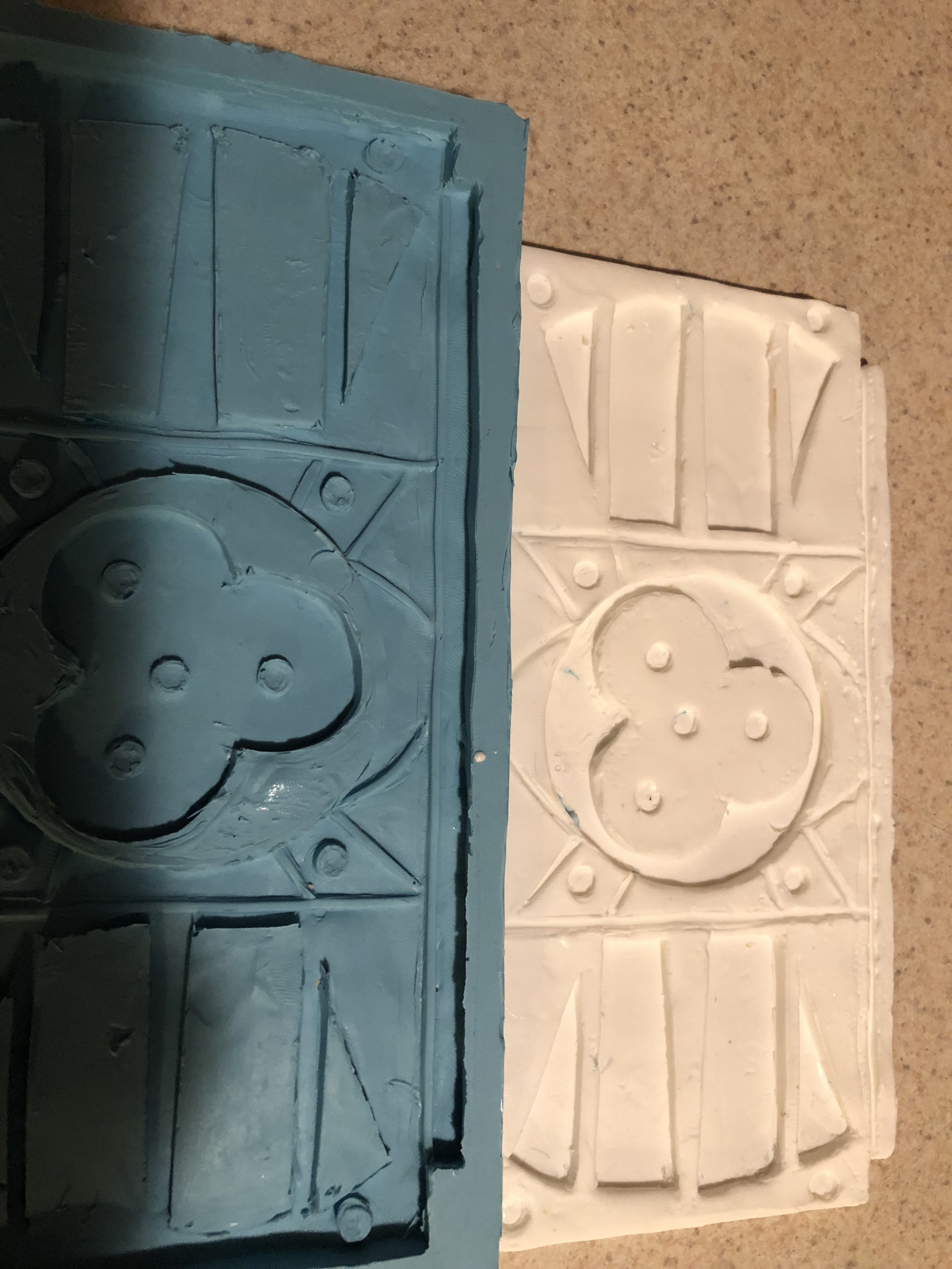

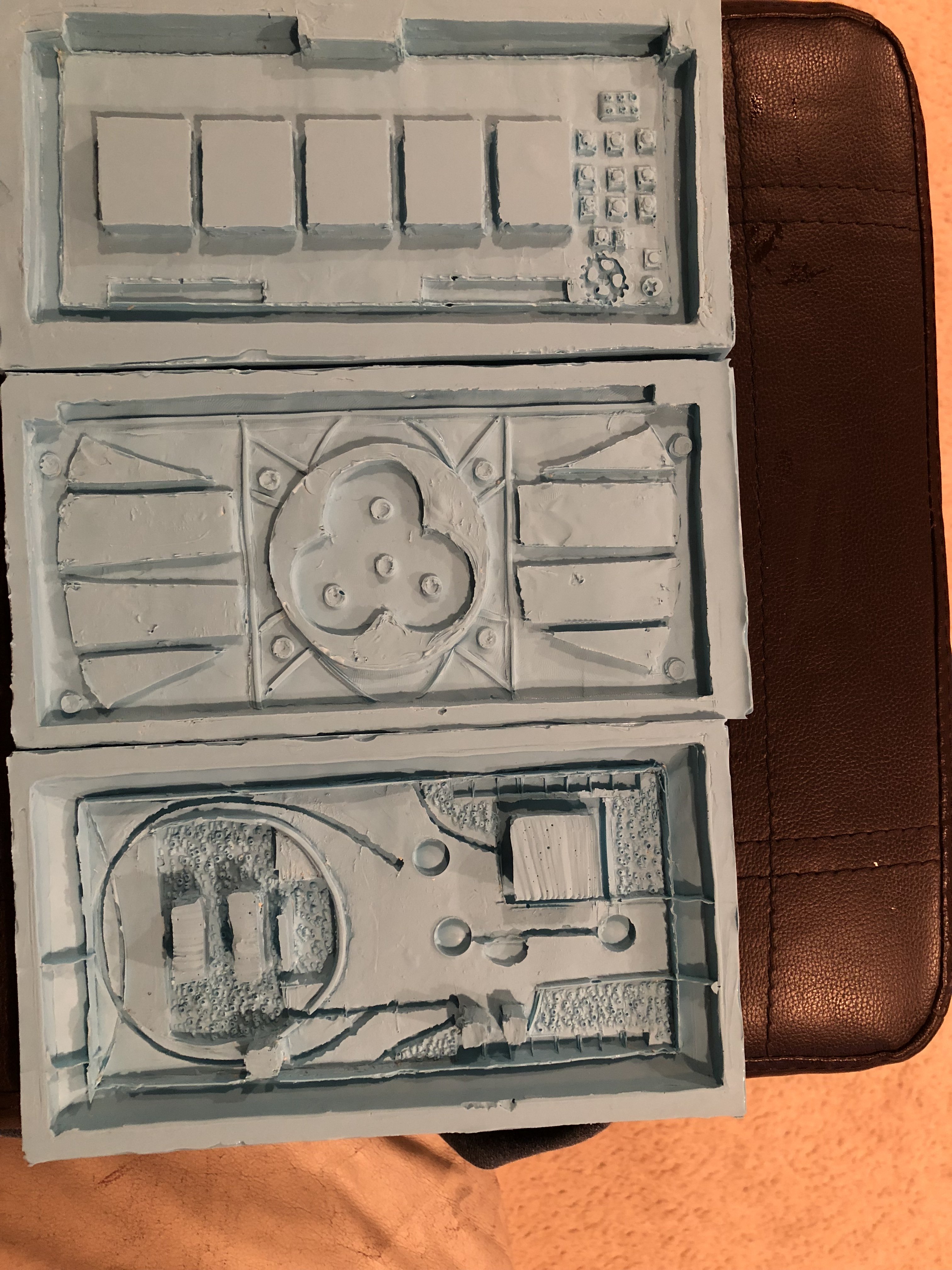

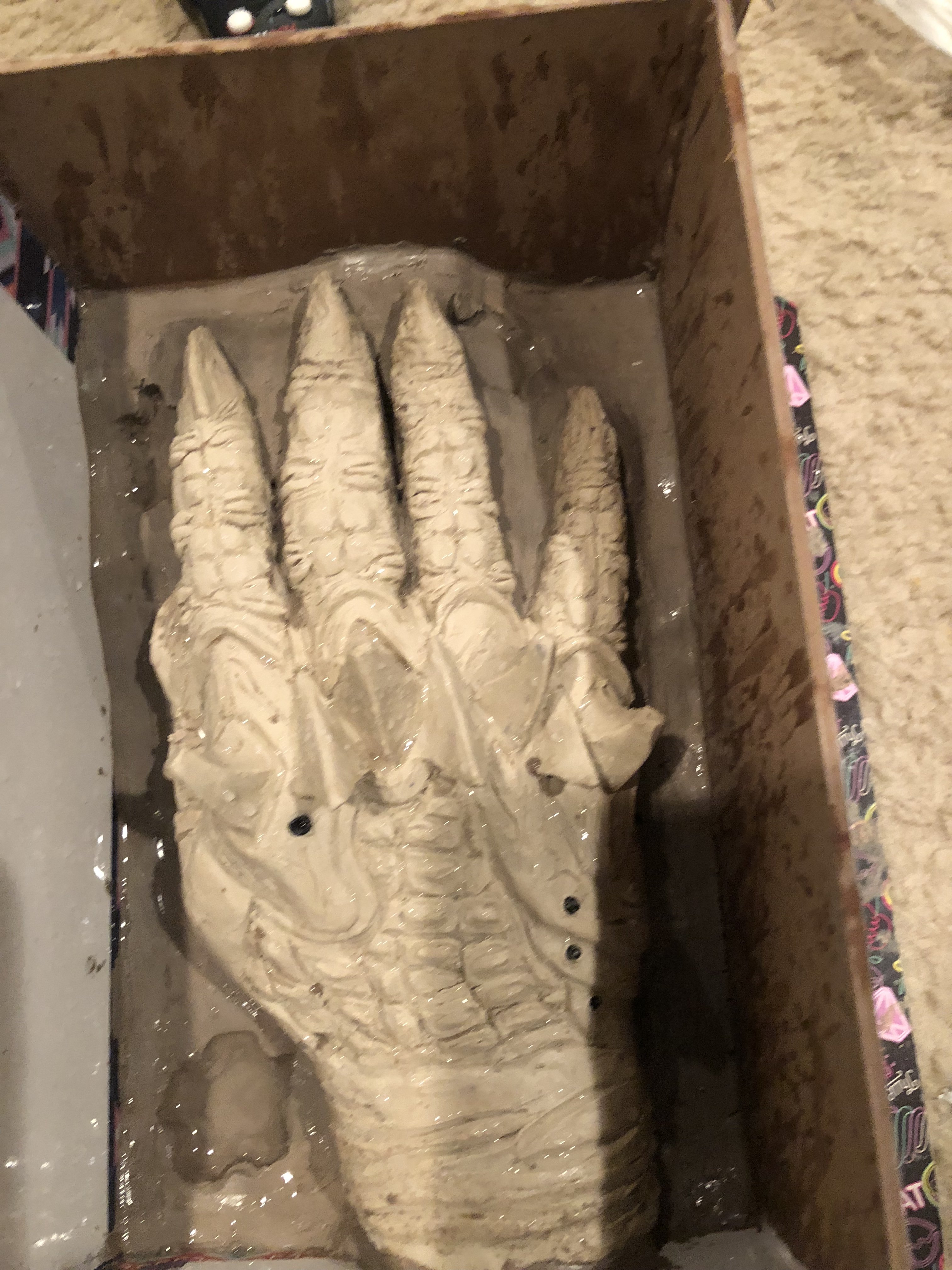

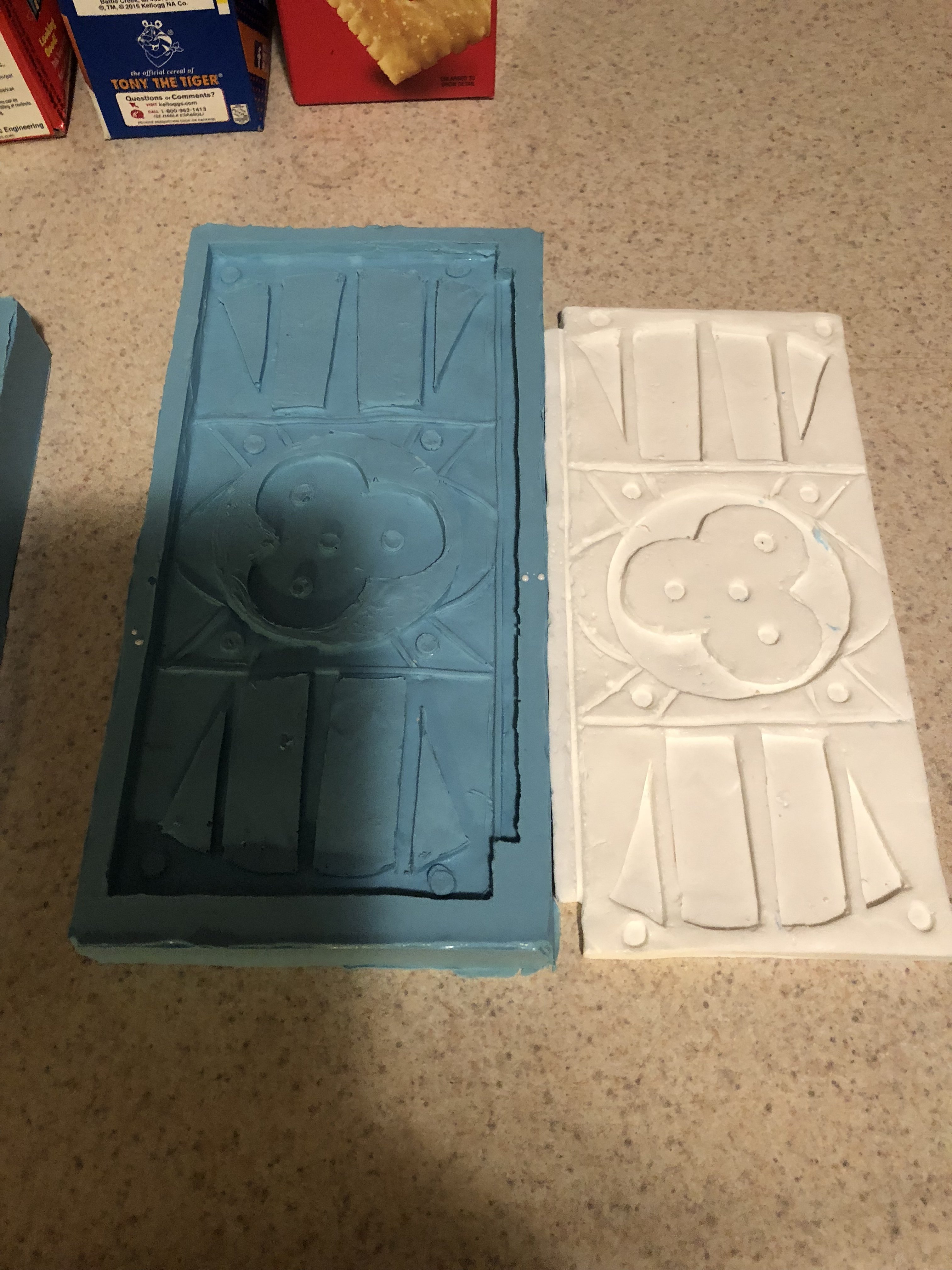

Hey vebo,, I don't understand, first you do a clay model of a template.. then you pour ( what ) into the boxed template.. it dries ( I'm guessing) then you peel it from your clay mold?? Please explain so I can learn this process, it's very interesting to me. ( The blue stuff turns to white stuff?? )
Good work on your build.

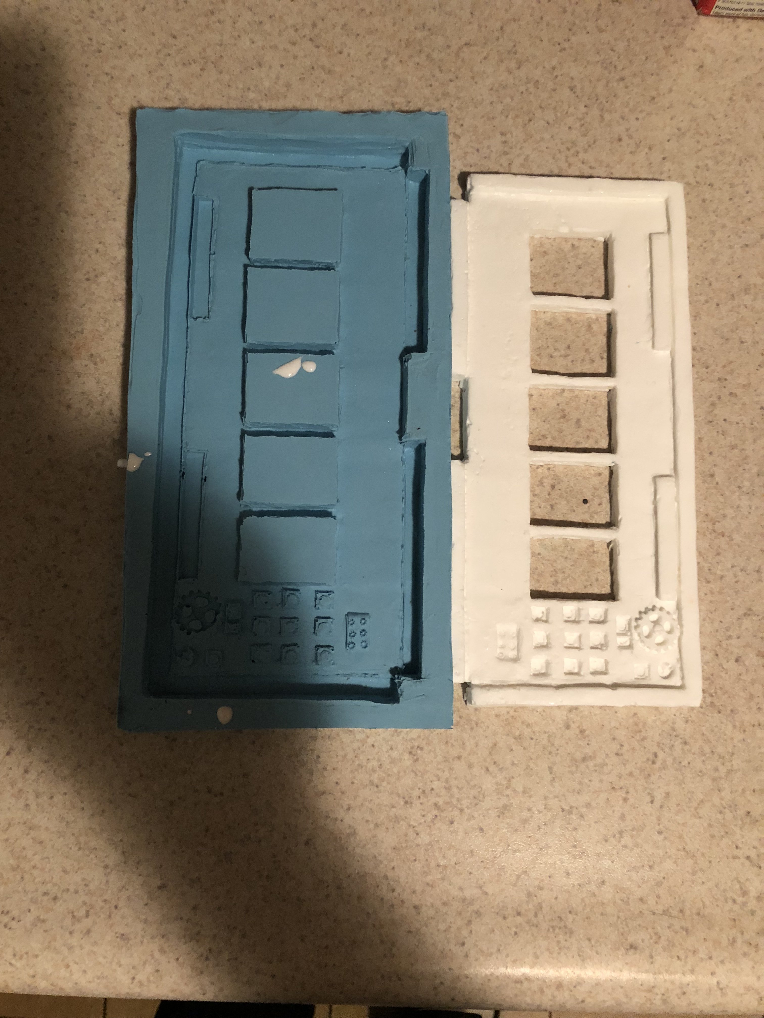

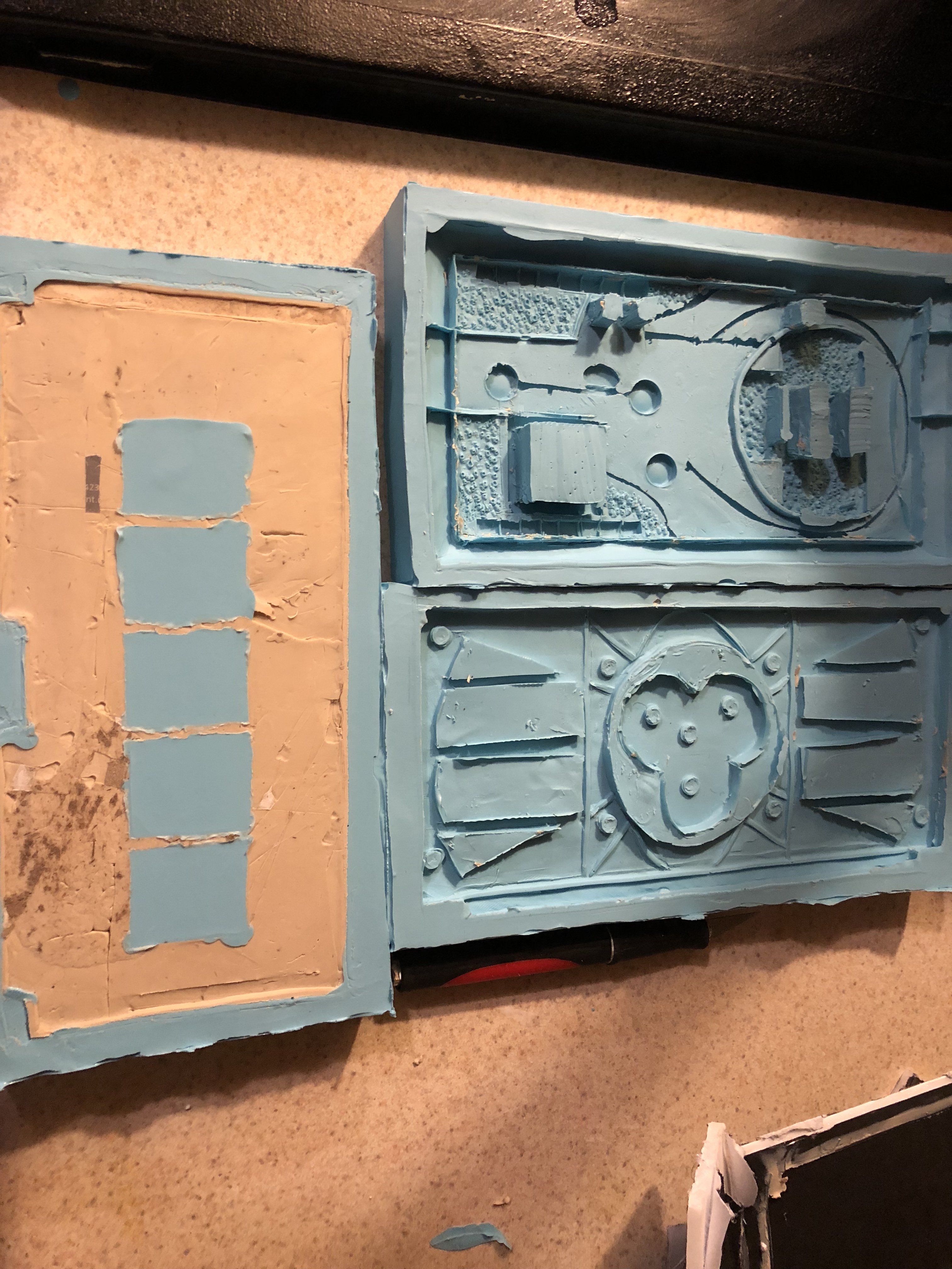

Texas Predator. It looks like he just made a basic block mold. The blue stuff is the mold, in liquid form. After it cures, he cleans out the clay and pours in resin (in liquid form). After that cures, he has his gaunlet lid.
Smooth-on has a few videos on it too.
THANX munson, I wanna learn all of this stuff after my duct tape build of my PREDATOR costume. I wanna do what you guys do, I feel like I can do it.. I wanna try it.

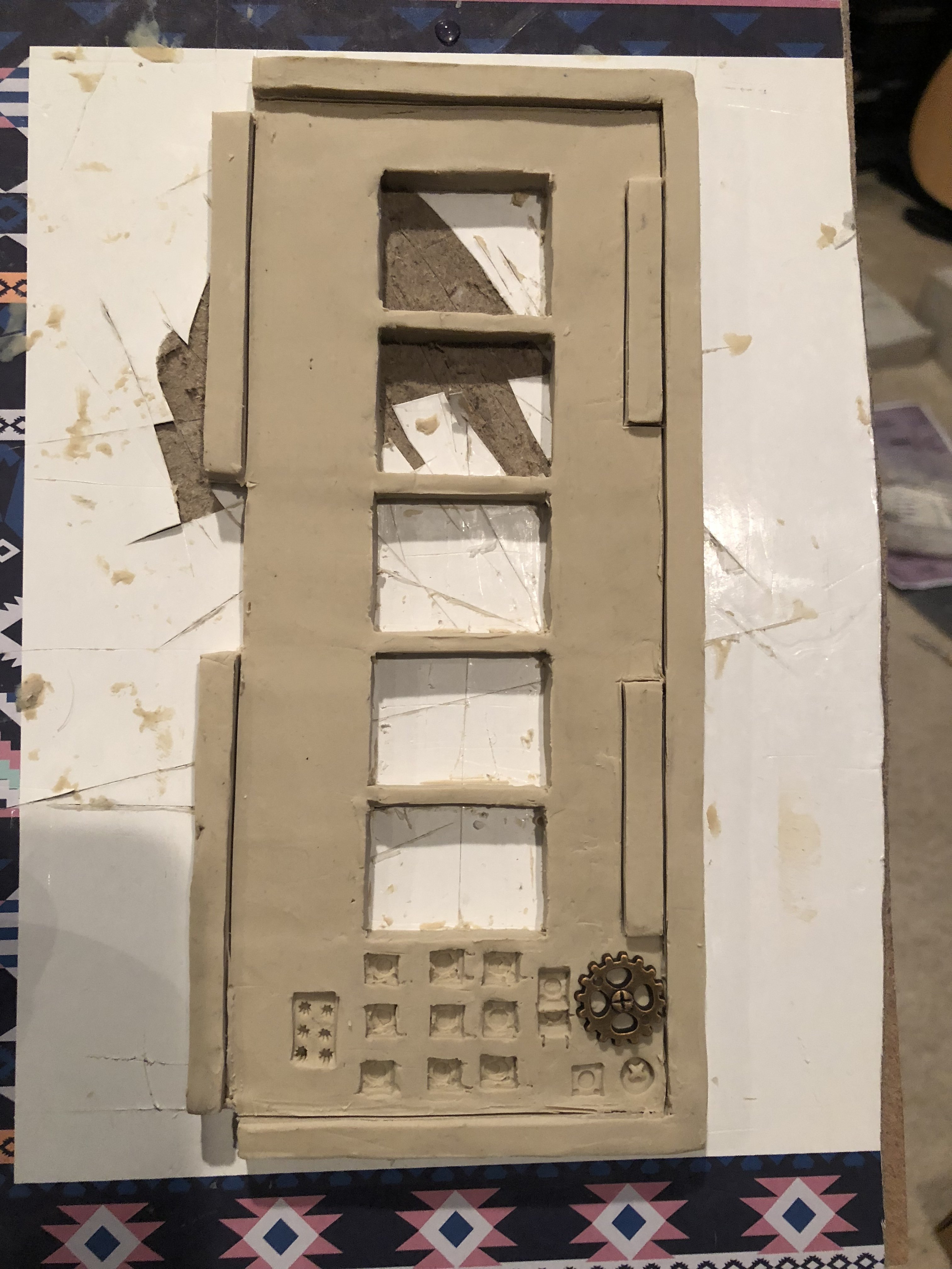

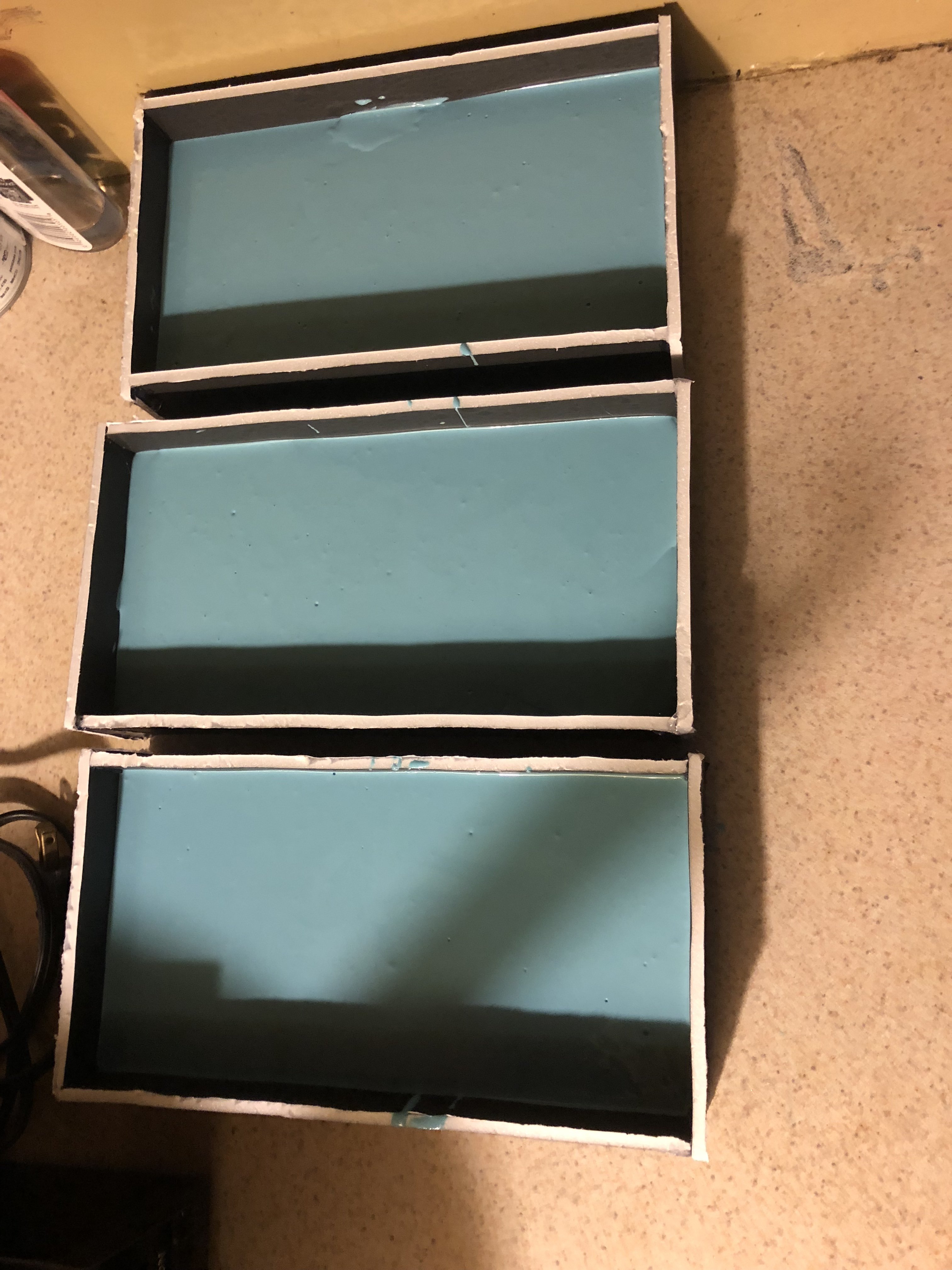

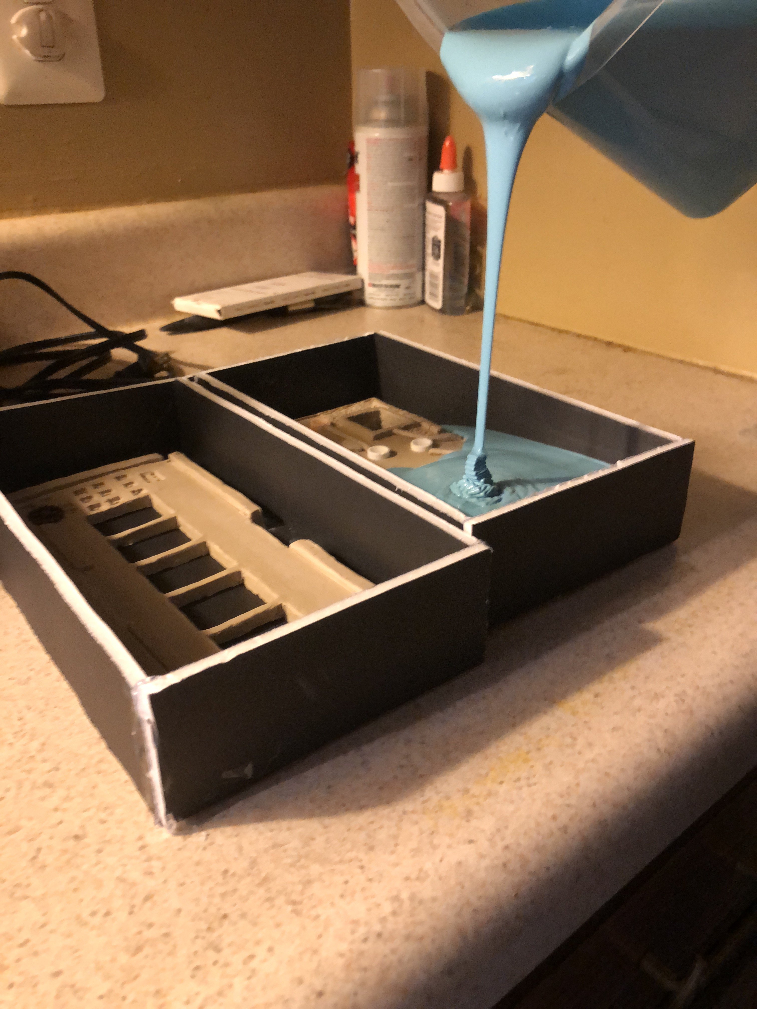

Ok no problem this is for a one piece mold .

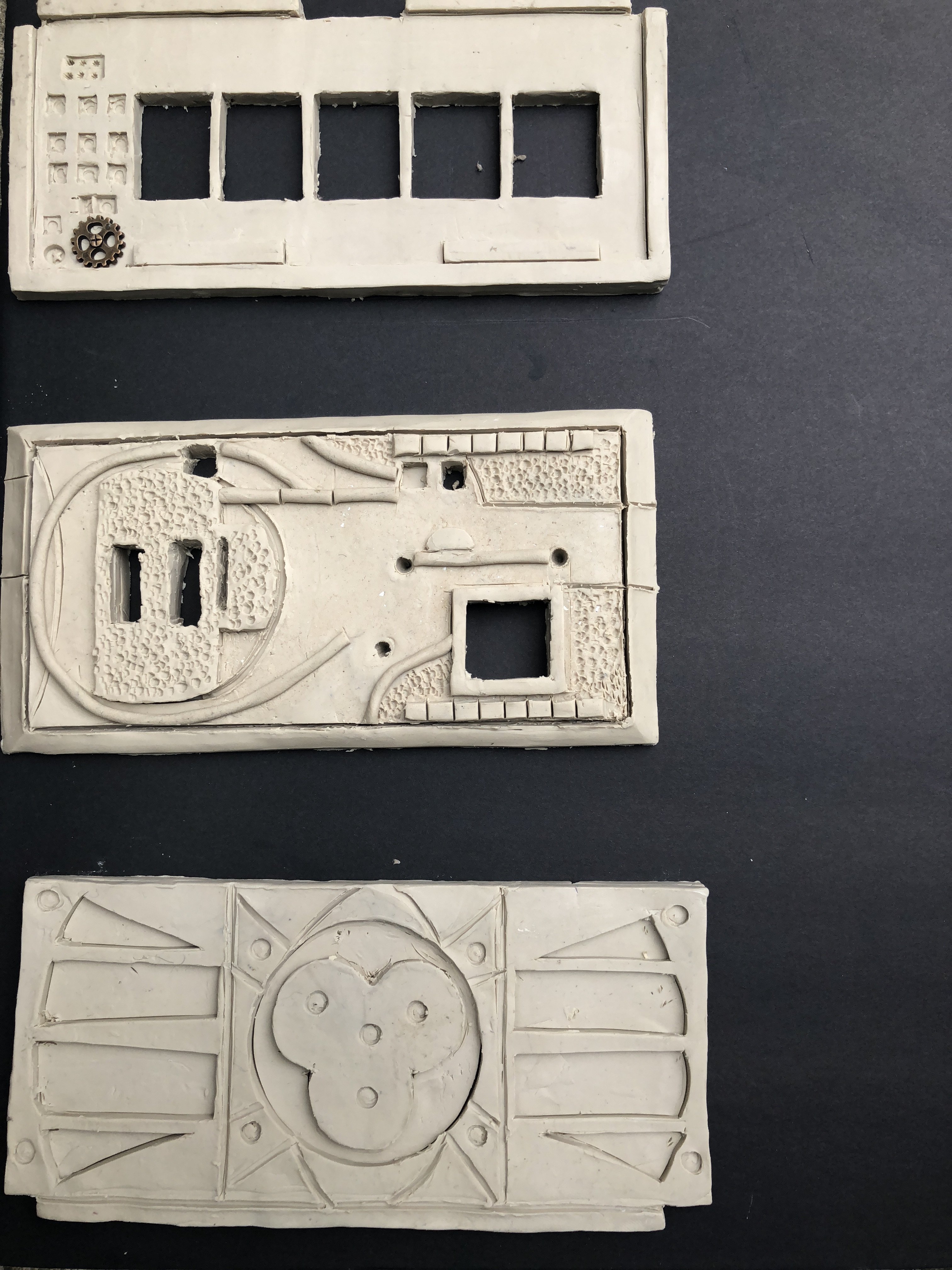

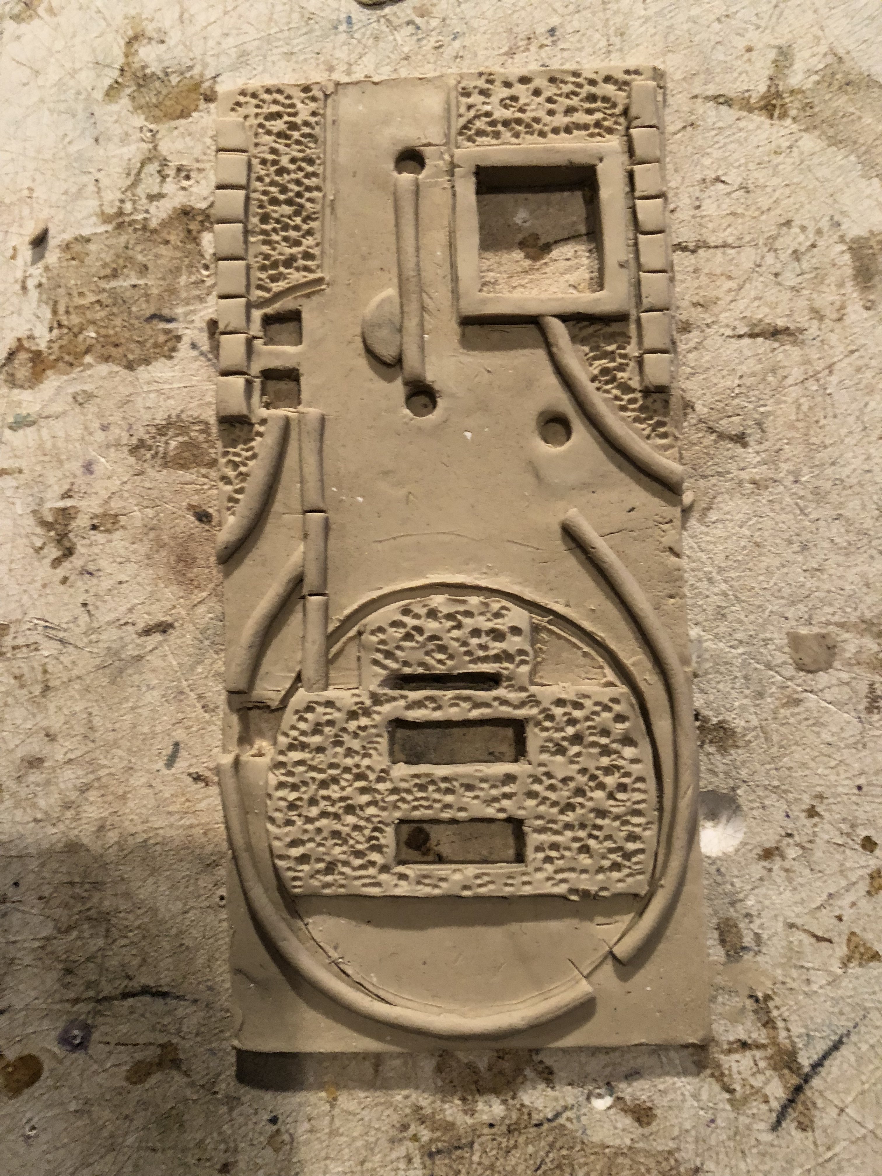

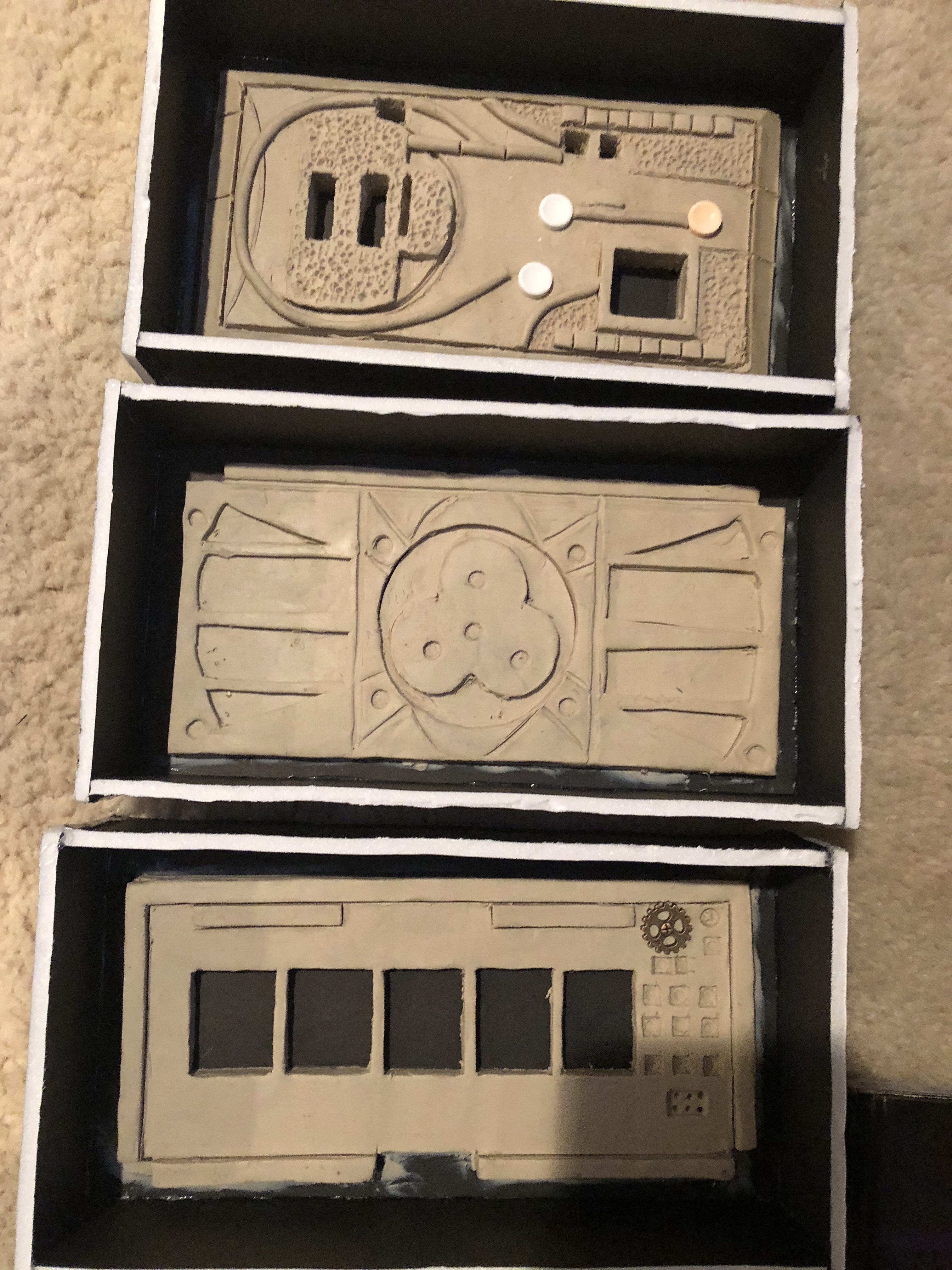

1st — create the clay mold .
2nd -box in the clay mold using foam board Seal the corners using hot glue.
3rd-spray interior of the mold and box with a release agent .
4th - prepare the silicone rubber . The one I used was oomoo 25 from Smooth On. You mix equal part of the silicone and mixed real good. There are math equations to compute the volume . I just guesstimate lol.
5th - pour silicone into the mold box.
6th let it cure completely usually 5 hours.
7th -once it cures remove the foam
board. This produce the negative of your original clay mold .

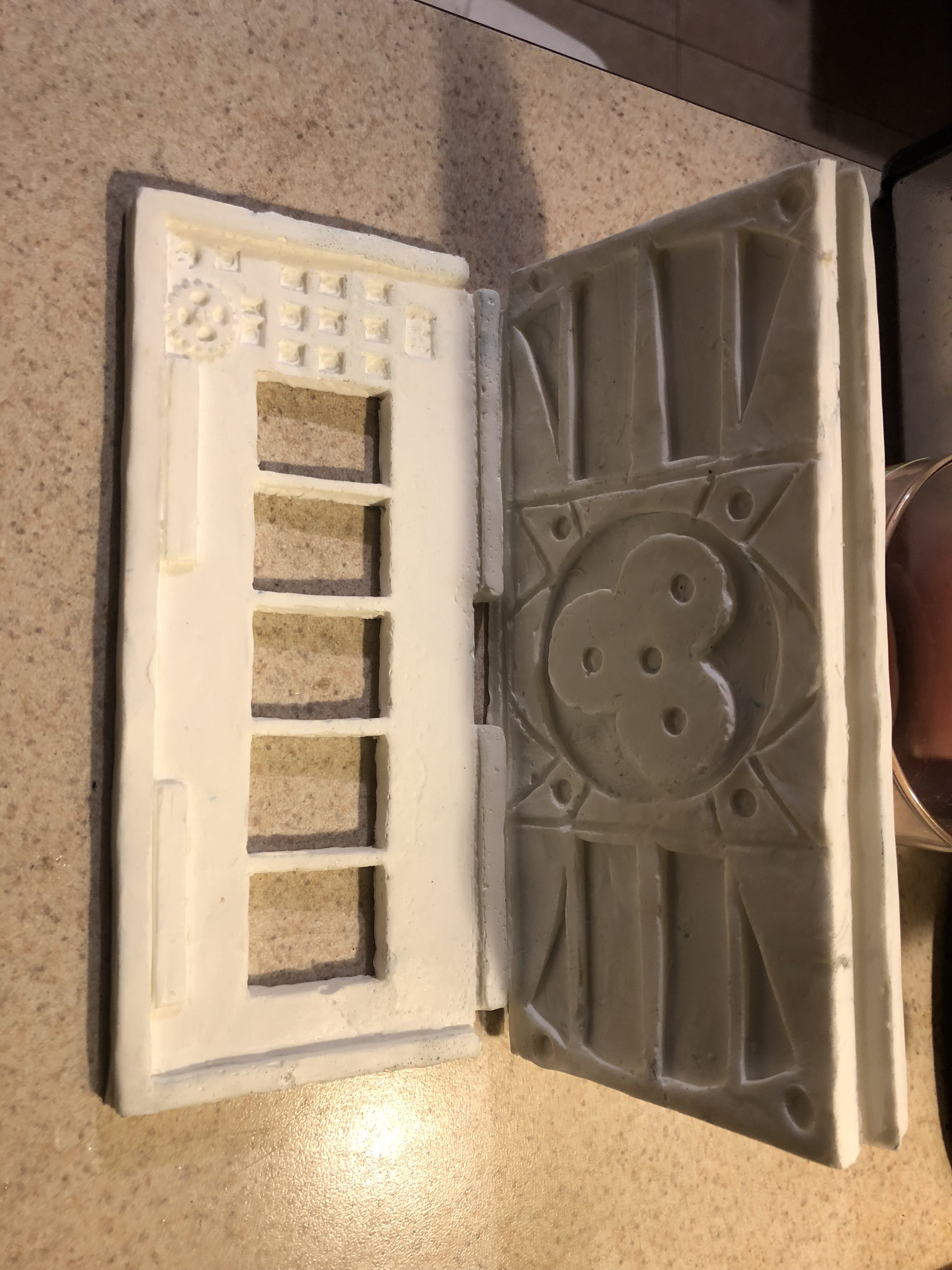

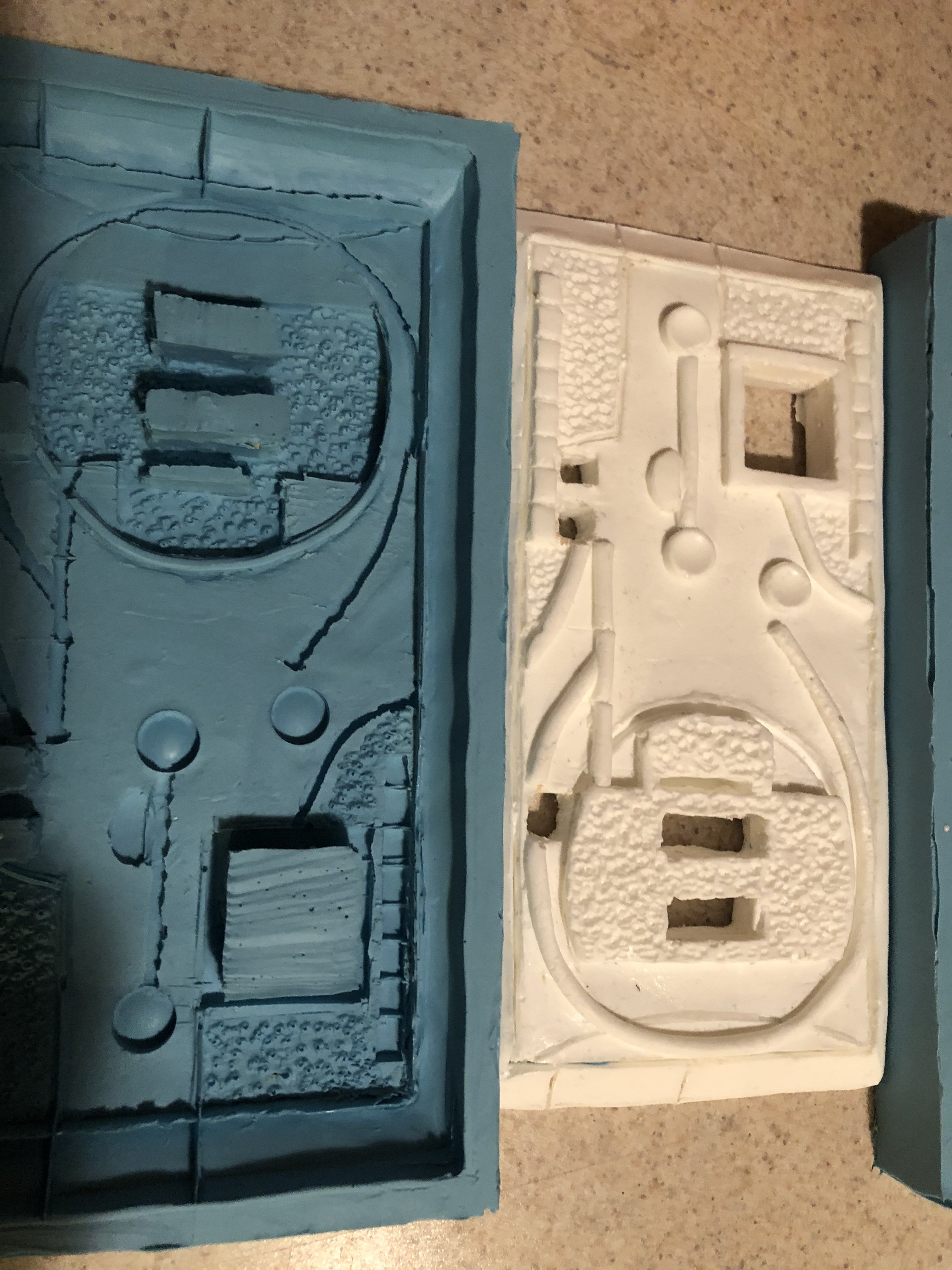

8th—this step the plastic is mixed.Pour water in the silicone mold to get the correct amount them dump it out . This amount will be use to measure the silicone or you can just guesstimate.Whatever the amount is 1/2 will be part A and the other 1/2 will be part B when pouring the plastic . Ex.2grams of part A and 2 gram of Part B . Spray mold release in the cavities of the silicone not too much just mist it . Let it dry .
I use Smooth cast 65d plastic from Smooth On . Pour parts A and B together Mix well then you can add dyes to the plastic then pour it in the mold this turn to plastic very fast .Mix time is less than a minute so you must pour it quick and you will be done.
My video of the Shuriken will show the process as well
Hope this helps

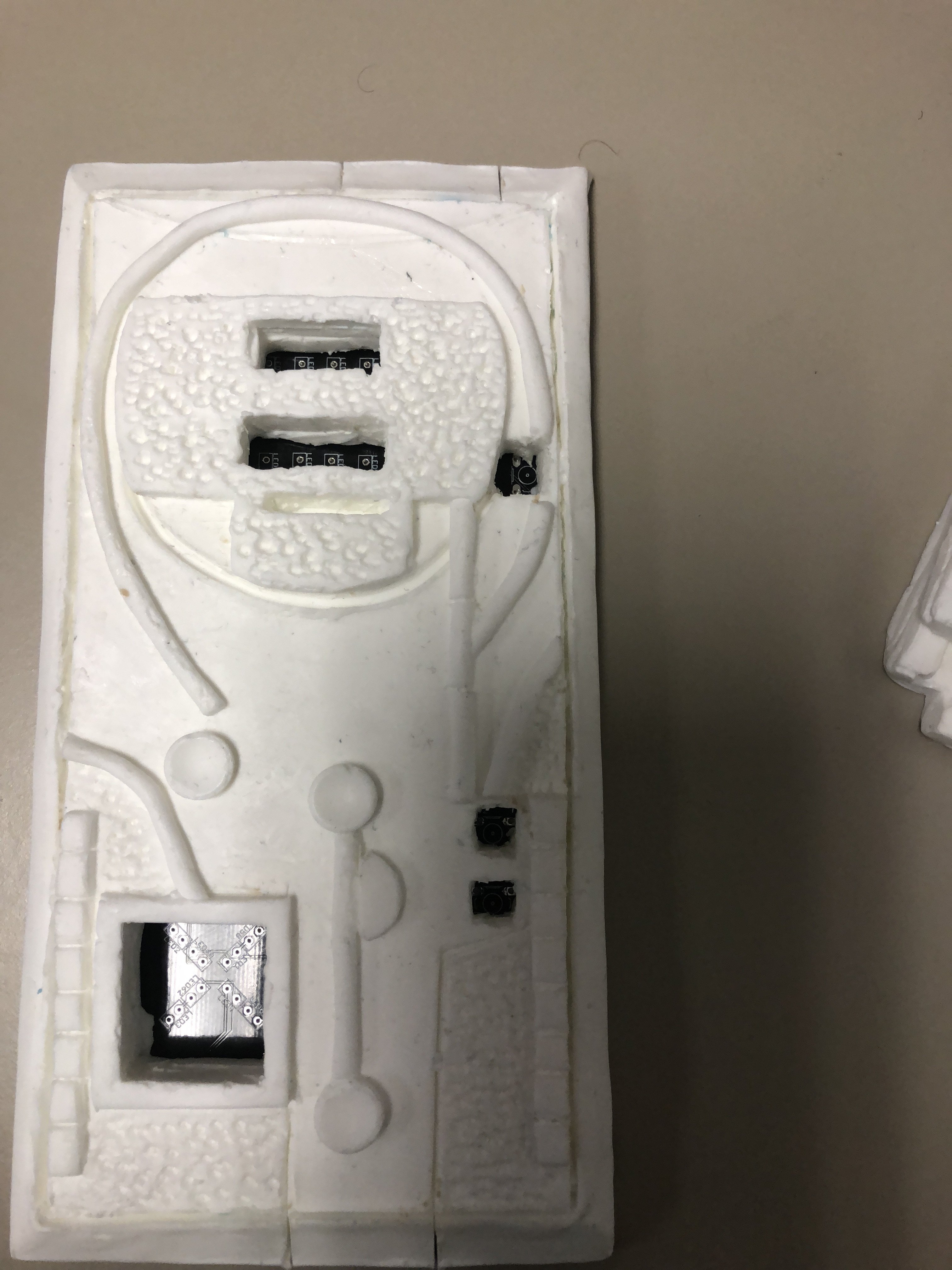

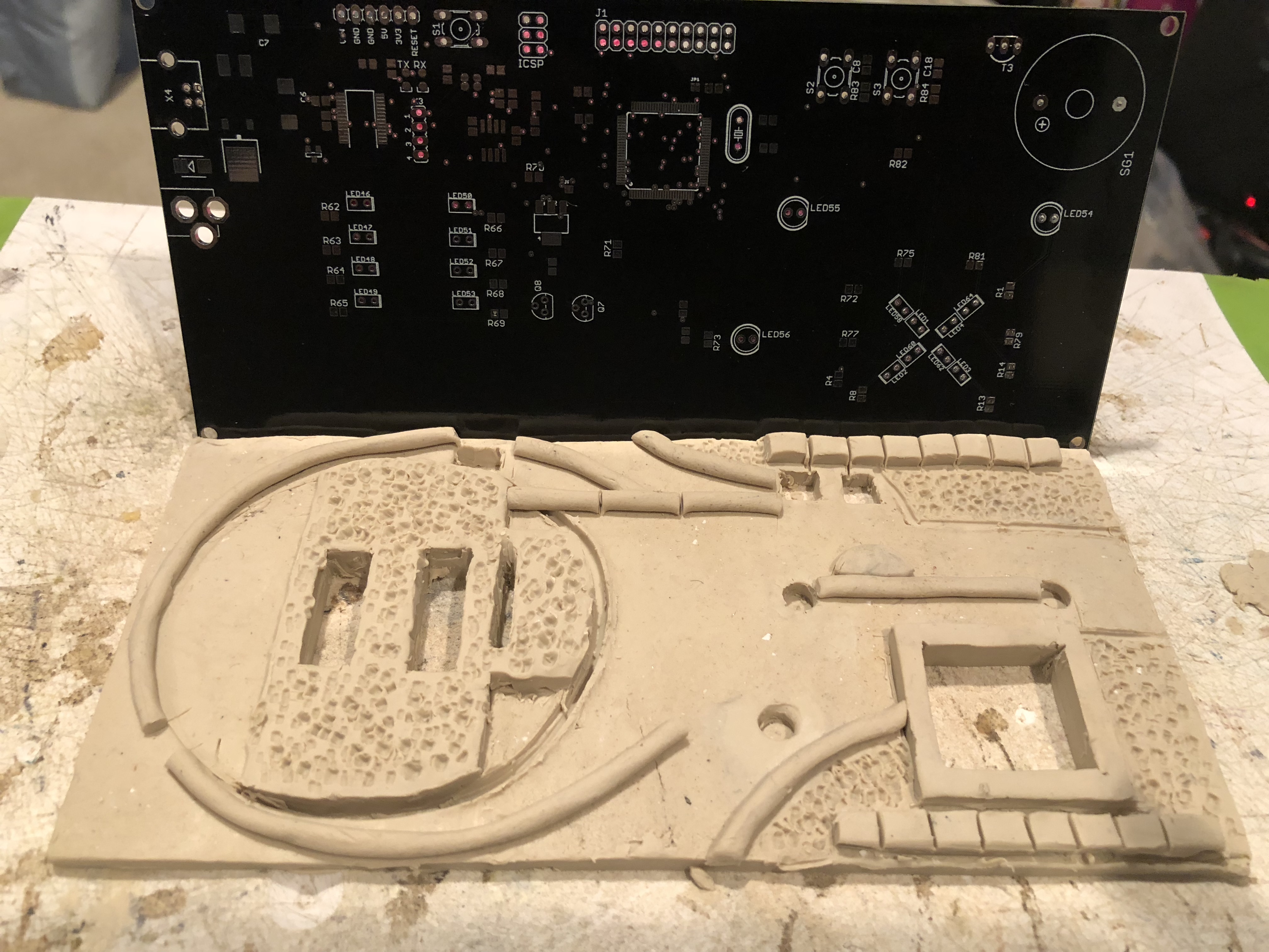

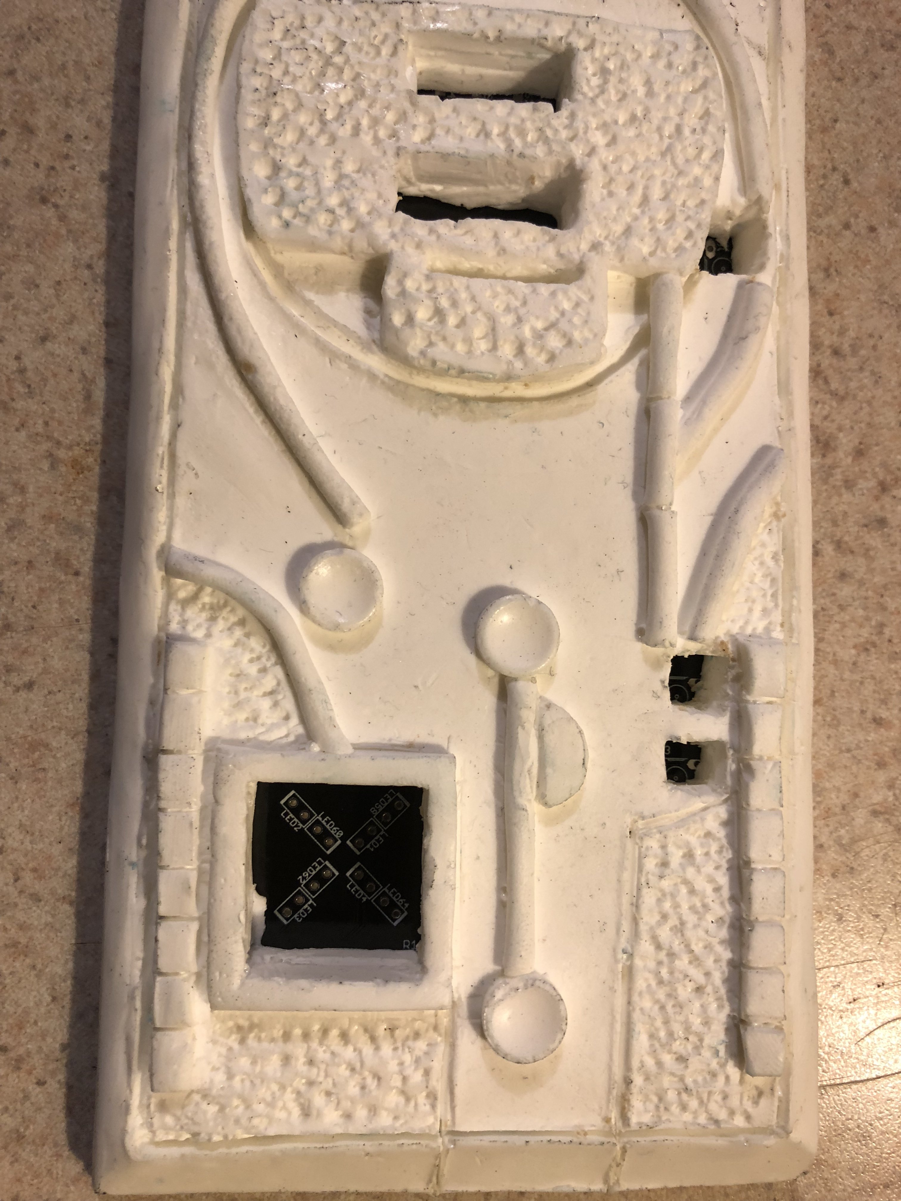

FC50F742-C2A9-4076-82DF-28075B17721F.jpeg 9EBCF4E9-C454-48BA-BD7D-7AD6409FC80B.jpeg 60EBBA0C-4A1C-4447-A2CA-4487A4704671.jpeg CBDAE7C7-20F8-431E-AEAA-987548ED8B19.jpeg D1B5C0AA-929D-4561-B026-D212CFAA72C7.jpeg 138706D9-2FB7-4DBE-BAB2-FFD3697B8BB5.jpeg B4A1E07C-66DA-4632-95CA-1D90BA5D0989.jpeg A19C47C7-9168-4033-8DF8-265F3F413D03.jpeg 0AF944D6-19C3-4AE3-AD7A-FADD21600D03.jpeg I been away for two weeks in Jamaica now it’s time to grind and.put together my Bomb gauntlet . So many parts . Plus I am soldering up the plasma Cannon circuit, and figuring out how to stuff batttery pcb and speaker inside. The plasma Cannon handle is interchangeable from a shot gun to shoulder mount this will be tricky .Few pics of the starting the gauntlet layout
