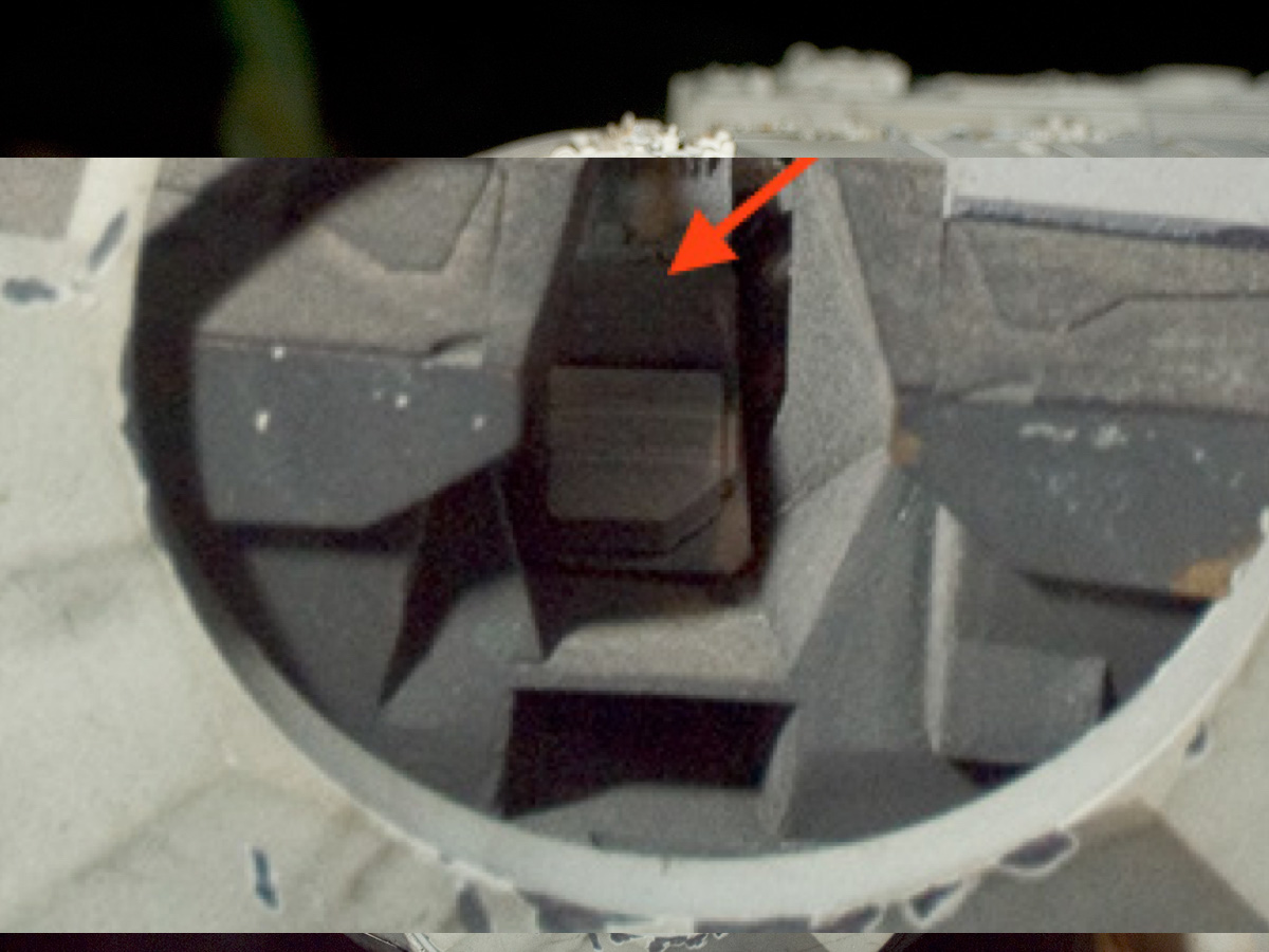

I couldn't help myself and started work on the back wall
Not sure how the little holes and details on this piece could work with 3d printing, since this will be pretty small.
