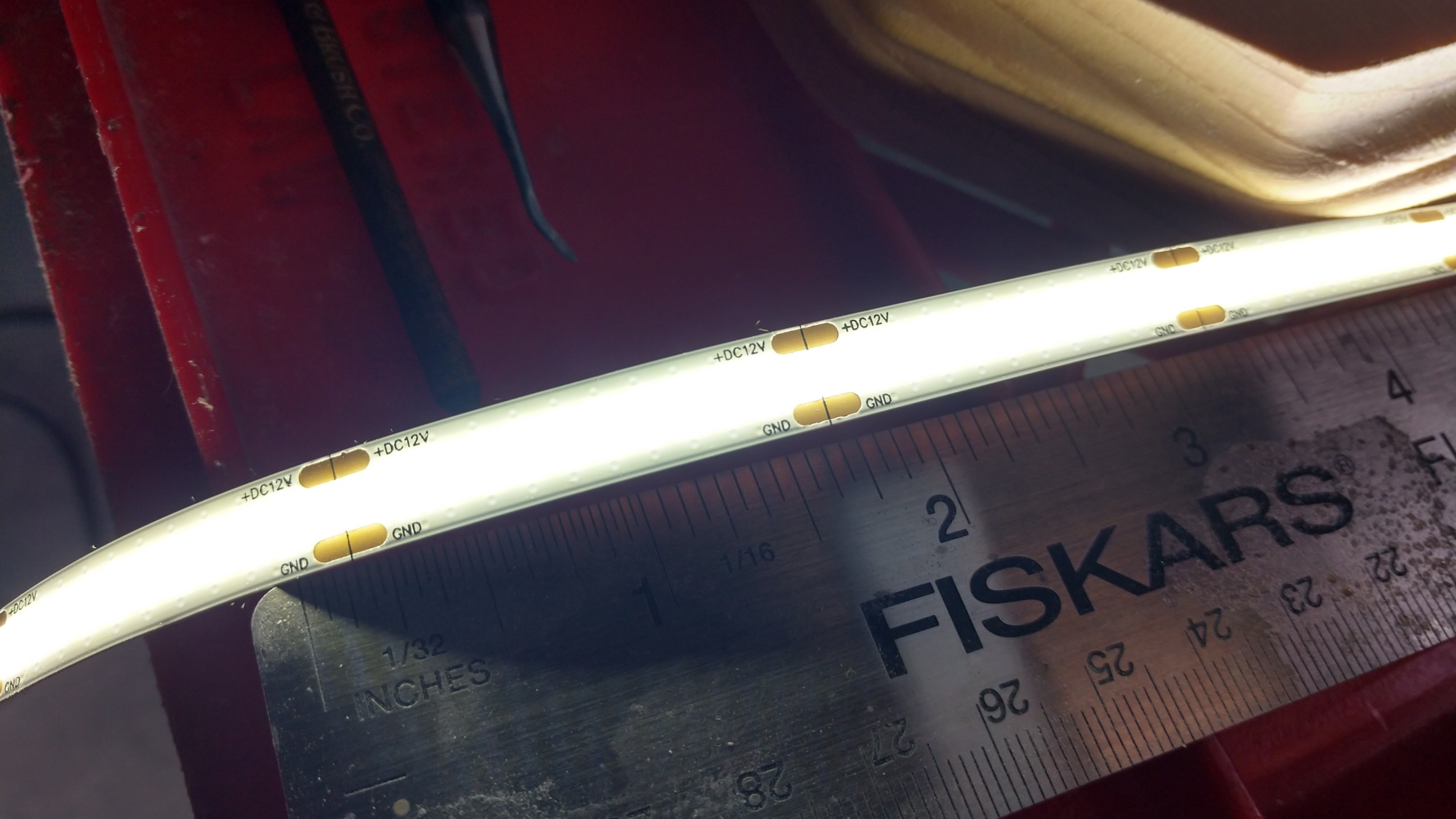

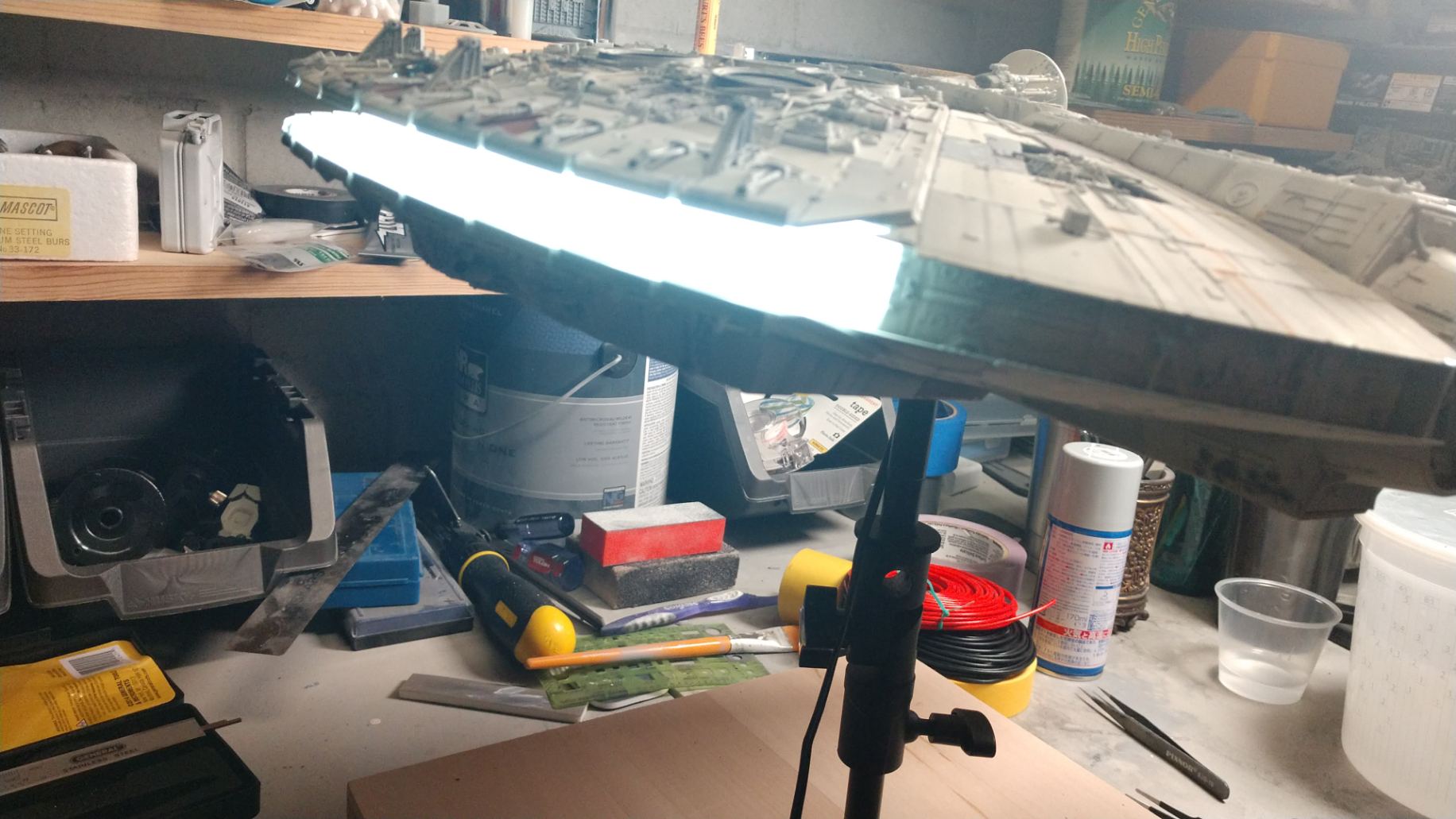

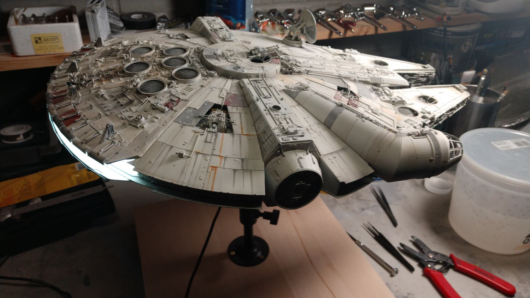

I finally found some some LEDs that work without heat or ugly hot spots. These are COB LEDs and there's no ugly gaps. They are brighter than f too! Glass plexi by Hunk a Junk
