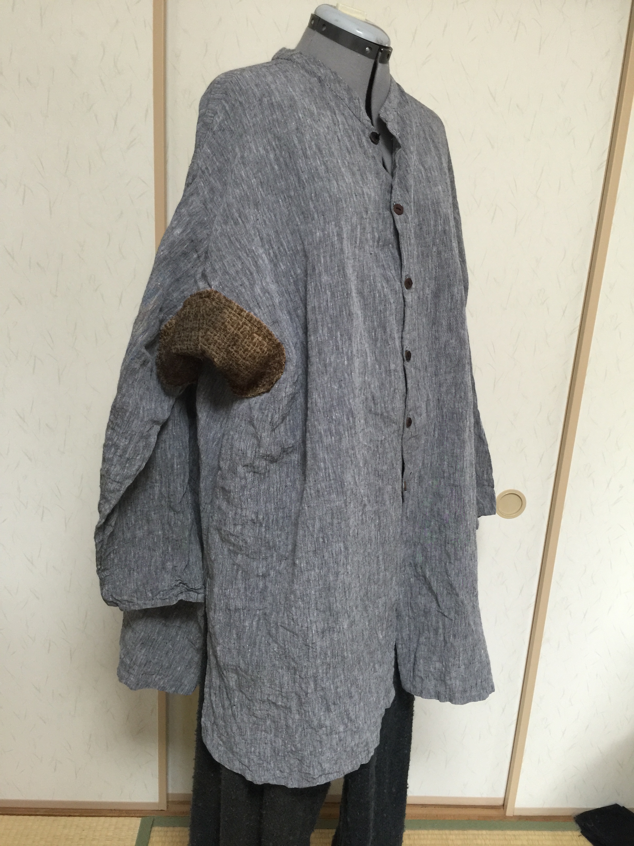

Anyway, from detail shots of the shirt, it's your average t-style tunic with a button down front and slits up the sides. The buttons look like either small wooden ones or leather and the top one has a thread hanging off it. There's a small collar.
For the sake of coolness and because the original fabric looks so wrinkly, I found a nice linen of grey and white threads.
The sleeves are un-gathered, and for my own comfort I put in under-arm gussets to allow for better movement. For buttons, I cut some leather, punched holes in the circles and water-hardened them with near-boiling water until they shrunk down. I'm not going to post pattern pics for the shirt - it's easy enough to find similar styles on reenactor websites.
Lastly, to cover that under-arm gap, I cut two ovals from the brown tunic fabric I'd chosen, aged them with a bit of paint, stay-stitched the edges because it frays like crazy and attached them with a running stitch.

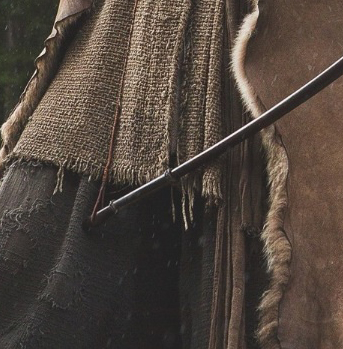

Pants. Like everything Bard has, they are well worn, frayed down to the weave. They have a rough texture but drape well with no wrinkles. Any guess for the fabric content is up in the air - for mine, I looked for something that was textured and close enough.
The pants look like they had a long-dead dream of being dark blue at one point, but age, washing and wear have left them greyish non-colour. We don't get to see how they are fastened, what the waistband is like, which makes it pretty simple. It meant I got to choose all of that. They are big, frayed, dirty, clown pants, lots of looseness in the leg.
My fabric choice wound up being a light wool that was nubbly. Ideally, it would have been a fabric where I could wear away at the knees, fray with impunity and still leave the fabric intact, but what I found seemed similar enough. I didn't think the wool would hold up to the wearing without coming apart. Plus, being wool, it drapes beautifully and doesn't wrinkle.
The original colour was a bright blue. A packet of Rit colour remover later, they were a sad grey-blue, with some odd rusty spots where apparently the fabric was reacting with the heat at the bottom of the pot I was using too quickly. Dye removal is a tricky thing, always, and it was just as well the pants were meant to look pretty bad.

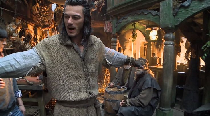

As I mentioned above in the post about the grey undershirt, we only see the full tunic with arms once, when the Guards come to arrest Bard in his house just under 2 hours into the movie. Otherwise, in all the back-stage shots, it's a sleeveless tunic for comfort. The fake cuffs are attached inside the kangaroo coat.
The Cloaks and Daggers books states the fabric is silk, and boy howdy is that type of silk hard to find in such a loose weave. It doesn't seem hemmed, just fraying away naturally at most of the edges.
The pattern is simple - pretty much a rectangle with a collar. It has side slits and of course is kept closed down the front with the lacing. Again, the usual theme of dirty, rough, and aged comes into play, especially around the collar and front, which makes sense as the coat would keep the sides and back somewhat cleaner. My version did have front facing of the same wool and the collar is a double layer, which meant the front edge had double the amount of wool to fray.
I found yet another nubbly wool in a loose weave that would work well enough.
Of course, what makes the shirt Bard's is the wear and tear. None of my edges were finished - a straight stitch was run around all the edges about an inch or so in. Then I sat and began to fray, pulling loose threads out and teasing them free with an awl. I also used the awl to pull some snags out from the wool. I used a large eye needle with some of the threads I'd pulled out to stitch and tied a few strands back into the front of the tunic to hang free.
Ageing was applied with acrylic paints mixed with water and a Febreze bottle. The Febreze bottle worked well for a very fine mist that covered a large area. Extra cuffs were cut and frayed and aged as well for later attachment to the coat.

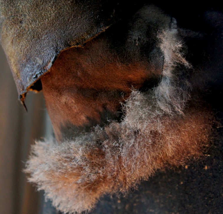

Cloaks and Daggers states it is kangaroo pelts, which certainly explains the odd texture of the fur at the lapels vs the collar and hems. I say hems, but it's just pretty much the raw edge of the pelt, hardly trimmed and with some holes, possibly from the tanning process. Or Bard's job.

Not sure what kind of fur it is - the leather was very, very fine and thin, so much so that it was backed with glued on fabric when I tore out the lining. But it was the closest I could get to the colour and texture of kangaroo. It wasn't enough to line the entire coat. All I wanted was to line the areas that were going to be most exposed - the edges of the coat skirts, the front body, the lapels and the collar.

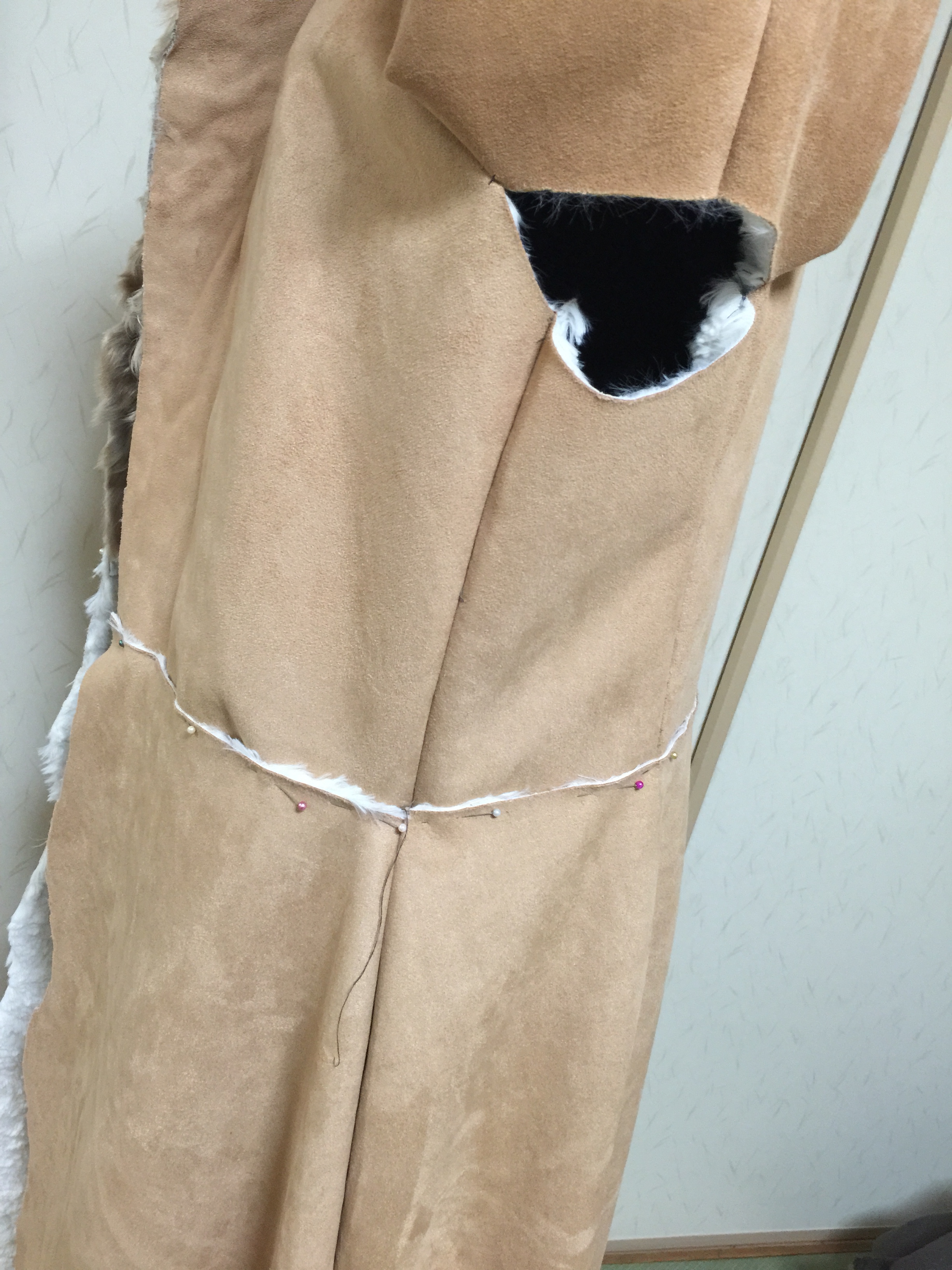

After piecing the fur coat and cutting the pattern for Bard's coat, the real fur was attached on the inside of the coat with contact cement (not ideal but it comes in large cans). I actually glued the real fur on TOP of the fake fur, and then began to airbrush and age the fake fur so it wasn't too jarring if it were seen. I will admit, the fake fur painting is one of the weak areas - all the advice I found about airbrushing fake fur didn't work well with this really fine textured fur. It got a but clumpy, and the colour match isn't the best. Oh well, moving on.
Issues with the contact glue - you can see in the right picture that the surface of the fake suede ended up a touch bumpy after the real fur was applied. It's also not as flexible and drapey as seen in the left picture, which didn't have the fur glued in yet. I decided I'd not worry about the bumps, figuring they could be masked with paint ageing. I also decided I could live with the stiffness.

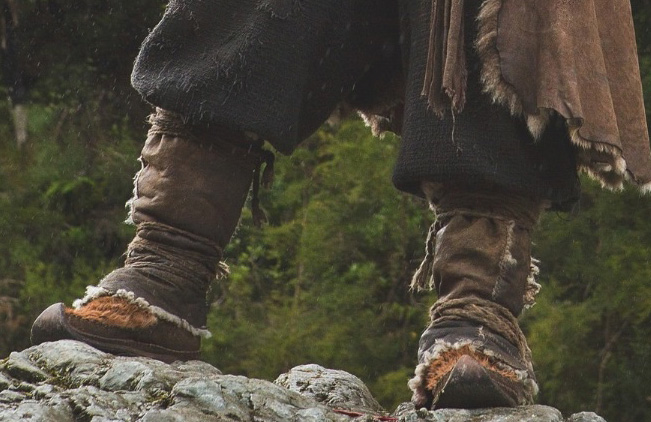

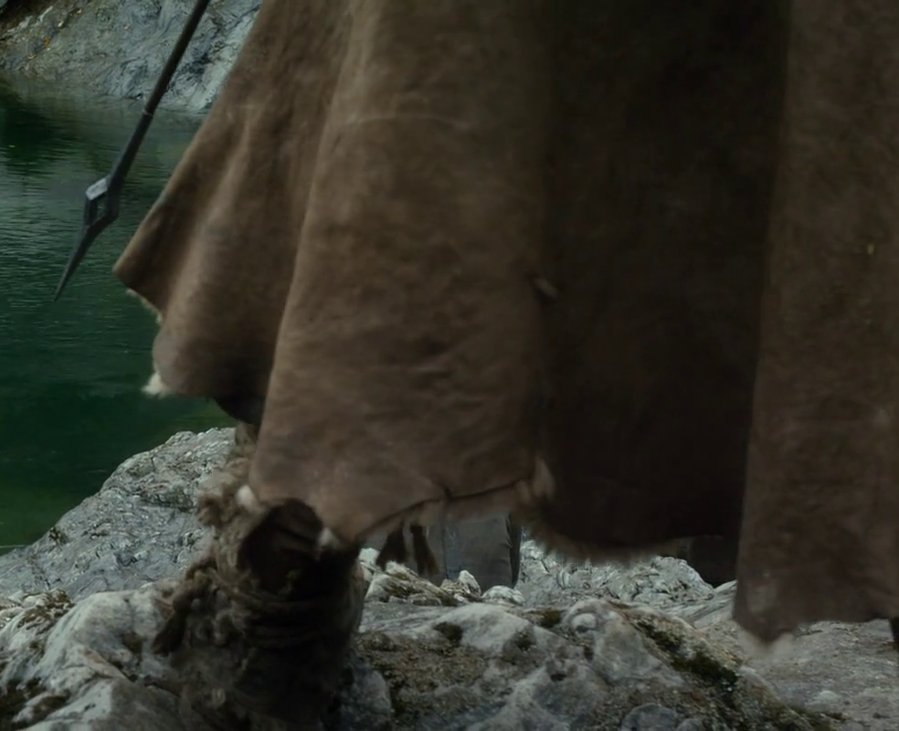

Oh, nice! An actual close-up of the gaiters! I've already bodged together some gaiters, not the best. It is the curse of the costumer to find the detail pics AFTER.
Now, I haven't tackled the boots yet...
Thanks so much!
I can't find the original link to the person i got these from so i uploaded them to my flickr account... They might be of some help to you.
https://www.flickr.com/photos/128405157@N03/sets/72157651778860912/

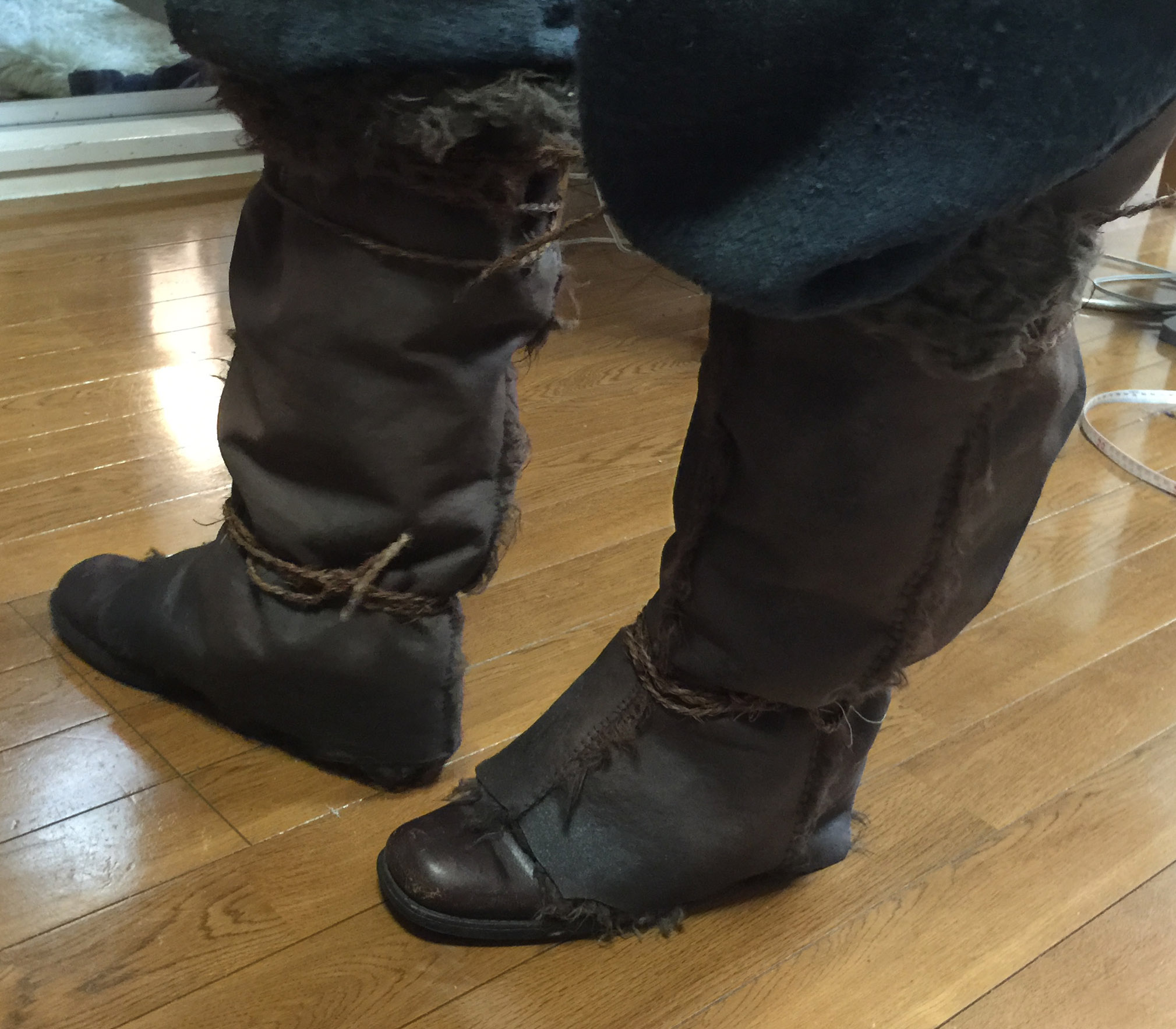

Next - Gaiters
The Gaiters
The gaiters are most likely shearling and put together in such a way it looks as if off-scraps of hide were jigsawed together. I can't quite tell whether they are open on the side and overlap, or whether they are just tubes that fit over the boots and can be pulled on together. Ropes tie them off at the ankle and tops.
I had some odd greyish brown fur-backed fabric from a purchase that was possibly meant for Bard's coat, but wound up not using because it was too dark. Technically, it's too dark for the Bard gaiters as well, but I went with what I had, being both unable to find a. actual shearling, b. a decent fabric-backed shearling look-alike, c. and not really wanting to outlay more money at the time. I may go back and do them over, if I can score a decent second-hand coat.
My pattern is more simplified than Bard's, and I will probably go back and rough up the bottom edge with some jagged cutting. I decided to make my gaiters large tubes. Open-sided gaiters that overlapped would be easier to put on and take off. But when I tested the pattern with overlapping on the sides and tied them off, there was too much gapping. Perhaps I just need more rope. Yeah, I definitely more rope. Thicker rope, too.
The top edge, after I handsewed the long edges so that bits of fur were exposed, was cut unevenly to look more scrappy.
So, thus far, the gaiters are not very screen accurate for a variety of reasons. Couldn't paint-work them lighter over the underlying dark fabric, need to rough up the bottom edges more and get better rope. They are functional and most people don't look down much. Perhaps when I get around to adapting a pair of boots, they will. For now, the gaiters are sufficient - they cover up my non-Bard boots and can pass.

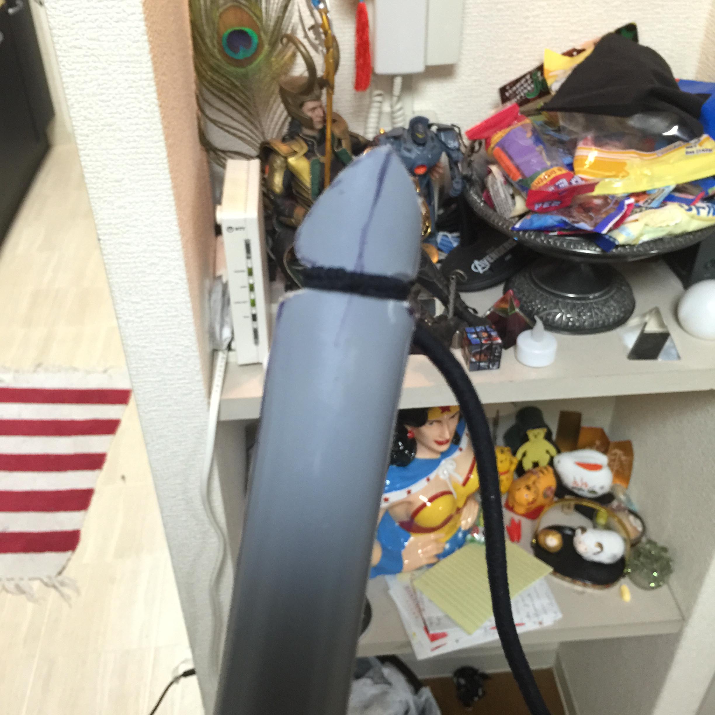

It kind of killed me to make a bow that had to be non-functioning. Japanese cons are really antsy about weapons that could potentially harm someone, and some want props that can be broken down into small pieces to bring to the site so as not to alarm people. Well.
With that in mind, my goals were to A. Make a take-down bow that split in two, B. make a bow that would not, even if I tried, shoot an arrow. At all. Which meant I couldn't allow any flex in the bow at all. So that meant C. To do the action style shots where he's pulling for the stars, the bow would have to be pre-curved.
Other hurdles - I live in a Japanese apartment complex, and the fanciest things in my cardboard box of tools are a Dremel tool, and a jigsaw and drill purchased at Ikea. So, actual verisimilitude was just going to have to go by the way-side. I decided PVC pipe was my friend, and said good bye to the way Bard's bow has the nice round backside and a flat front and thickened at the grip. In fact, if anyone can point out something that can work, from a material I could plausibly find overseas, that'd be grand. Otherwise, this bow was just going to be a painted pipe.
I do wish I had a workshop, making props would be so much easier.
A tutorial on bending PVC pipe without kinking it came to my rescue - tape an end, fill it with sand and apply heat with a heat gun. For my first time, I was amazed how well this technique works. The internet is genius.
The first go-through wasn't bent quite enough, so I worked it a second time. The bow, before bending, was over 6 foot, making it proportional to my own height. It comes together at the centre with another pipe inside that the ends fit over and a bolt and nut to keep it steady.
Witness as well the awesome jigsaw work on the ends, done in my apartment with no worktable, no clamps and a stool, doubtless to the annoyance of my neighbours. This is not a pretty bow. This is a bow made under under conditions that would make a shop teacher cry.
When I had the pipe bent to my satisfaction, I sanded, primed and painted it dark chestnut brown, with some wood graining dry-brushed on in two different shades of acrylic. A last coat of clear varnish later, I was ready to move on to the prettier bits.
