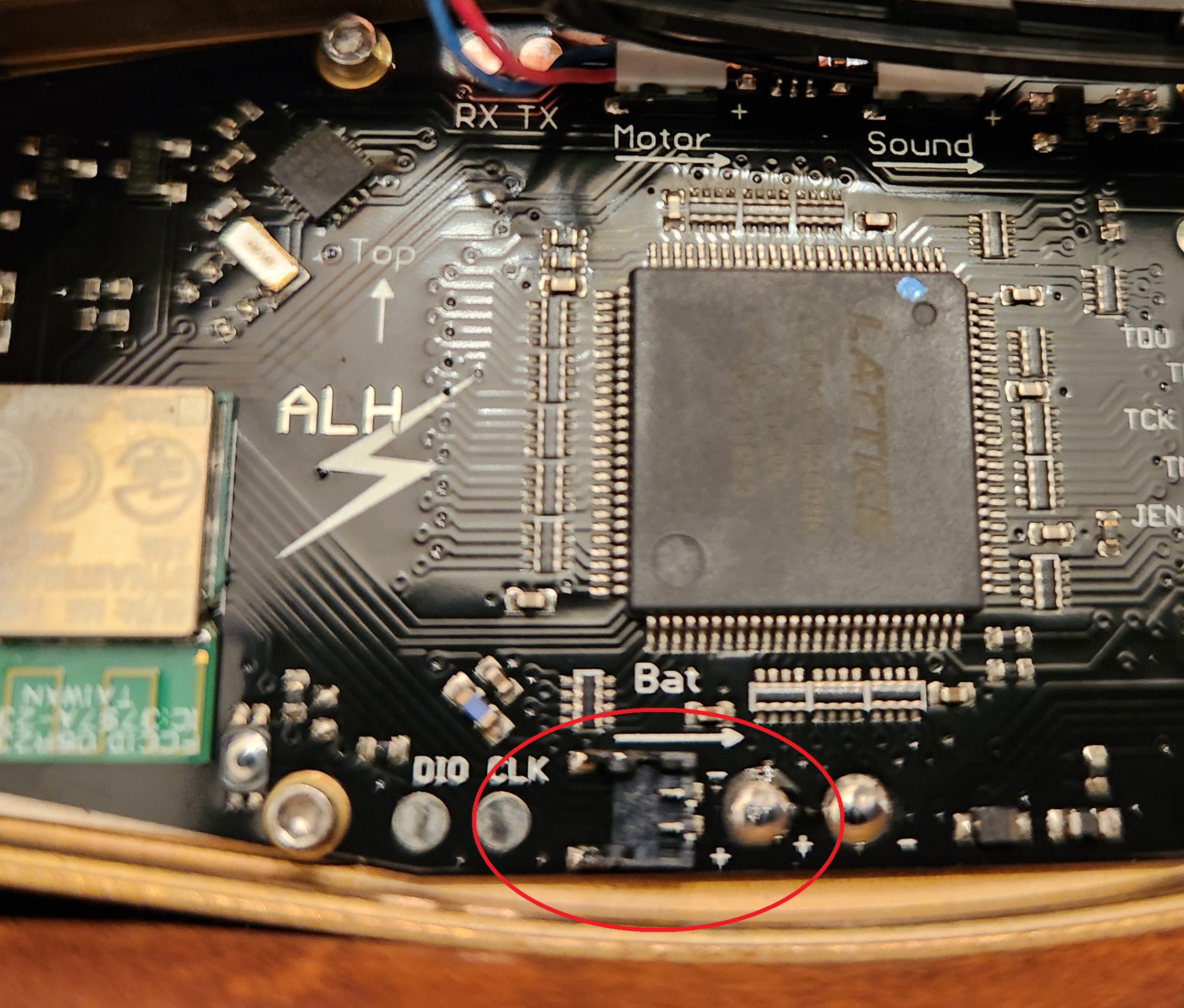

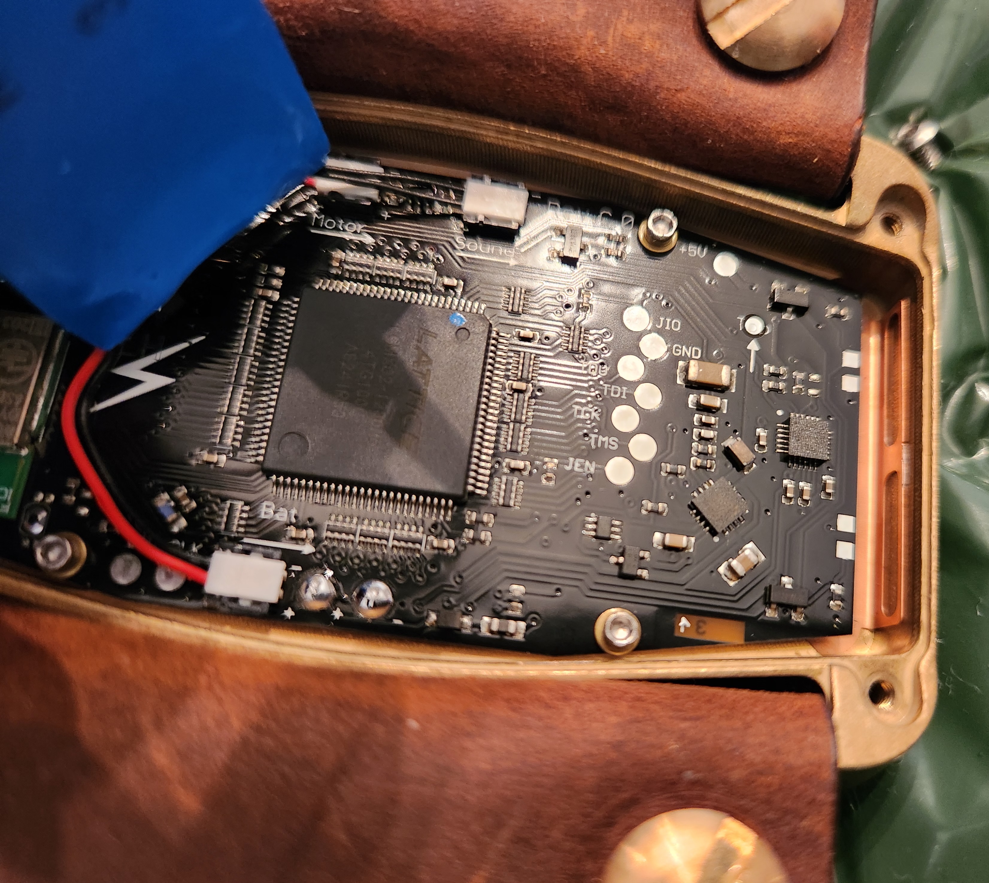

I researched this a bit more and I'm thinking the battery might be replaceable. I've attached a few photos of the inside.

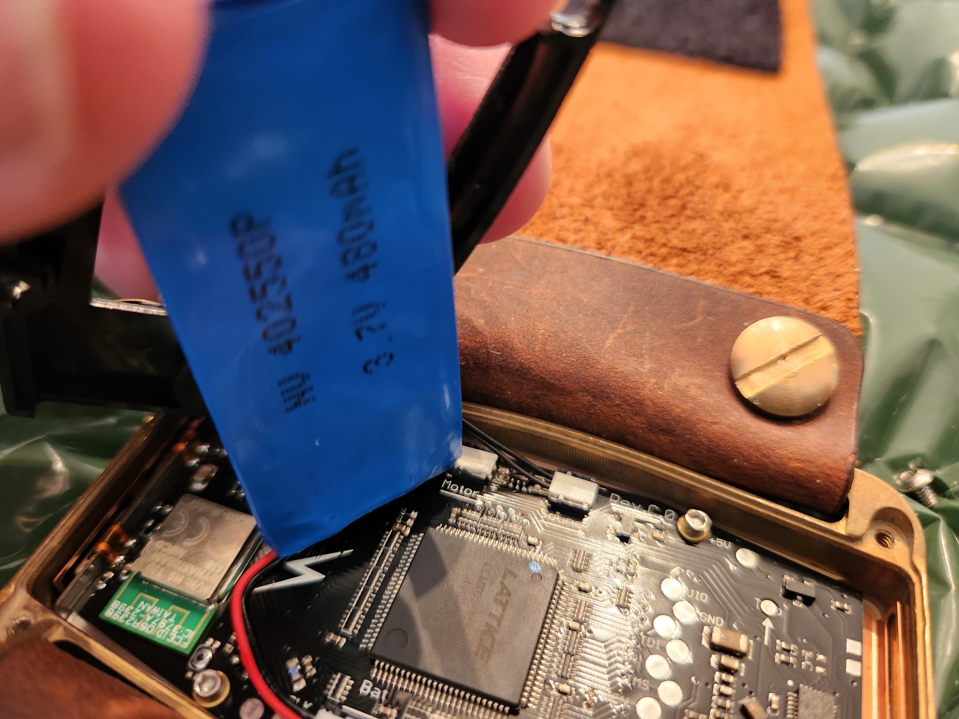

First, I'll need to be able to slide the battery's connector left in order to unplug it, but hopefully I'm not a clumsy oaf (as I've been known to be) and damage any components in the process. Second, I was thinking about replacing it with any 3.7v 480mAh lithium polymer battery I can find as long as its the right size (50mm long x 23mm wide x 4mm thick + a 1mm thick piece of adhesive gluing it to the metallic back of the watch). But then I found the actual battery I believe was used...
...except there's a minimum order of 200 required! All the markings, etc. match up with my picture. (Even the "NV 402550P" part.) So surely there's another way to just buy one.

Not sure how much luck you'd have finding another supplier for that exact battery. Maybe try searching AliExpress or similar for the various serial numbers/codes in that listing. Failing that, just find a 3.7v, LiPo battery that fits in the space.
For removing the plug on the existing battery, use some fine tweezers or similar to gently nudge it out. Take it slow and it should pop out.

As long as the specs look the same (size, voltage, capacity etc) then it should be compatible. The battery won’t be a custom part it will be an off the shelf component that LifeClock sourced from China so as long as it fits and has the same voltage it should work.
The only thing is if the connector is the same - if not you may have to remove the connecter from the old battery and wire it to the new. Shouldn’t be hard to do.

In case anyone tries it, here are a few pointers. The battery will be glued to the inside of the watch back with some adhesive tape. The easiest way to remove/install the battery is to first pry it from the metal back it is taped to, allowing you more freedom to play around without disconnecting anything else. (There is also a plastic frame inside with other components attached which you can keep connected; it shouldn't interfere with the next steps.)

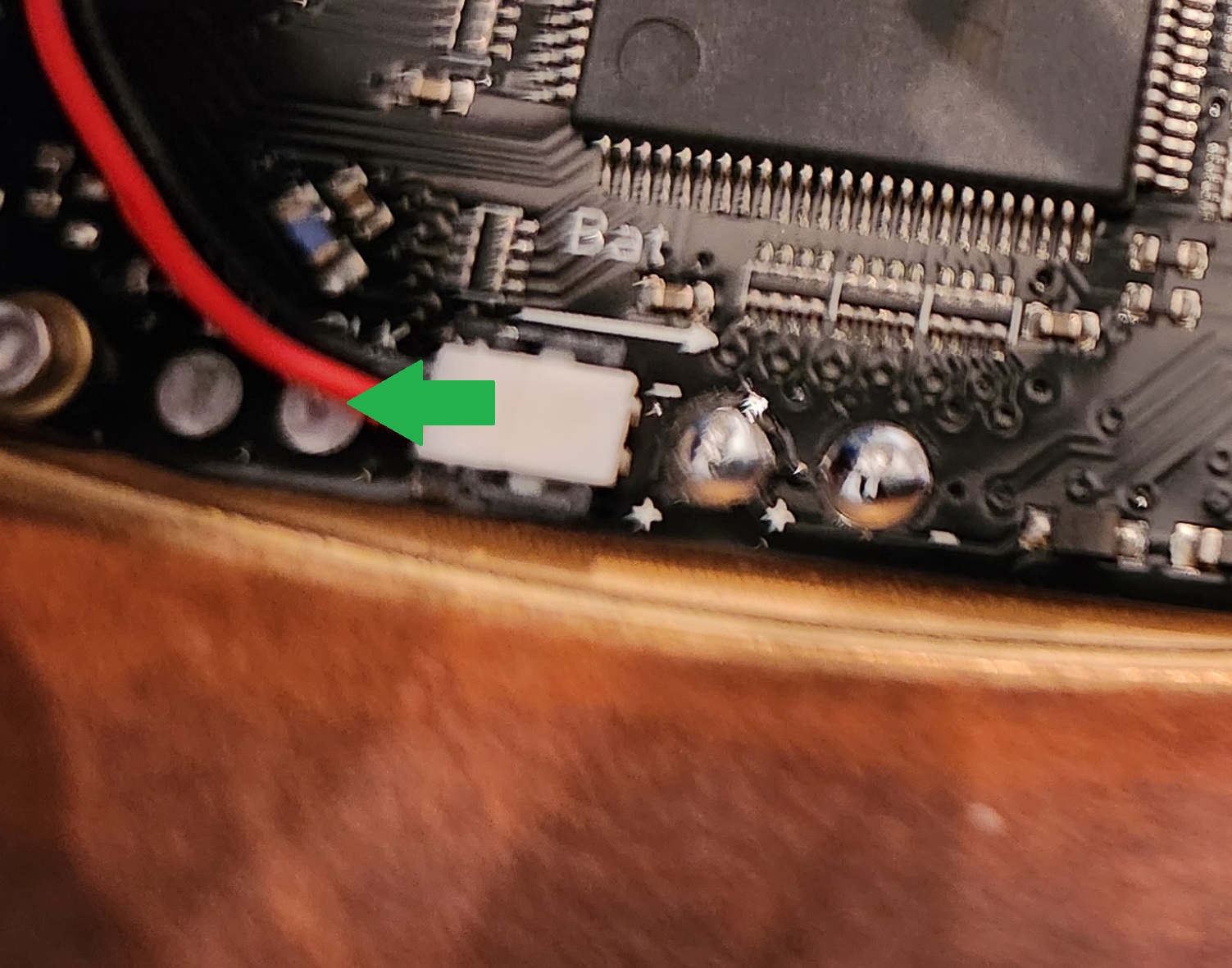

Note the plug for the battery does not actually slide into its designated slot as I originally thought:
Instead, there are tiny tabs on the plug which correspond with little spaces in this slot. The plug actually pulls up out of this slot to remove or is inserted in a downward motion. As long as the tabs line up correctly, it’s very easy to push it into place.

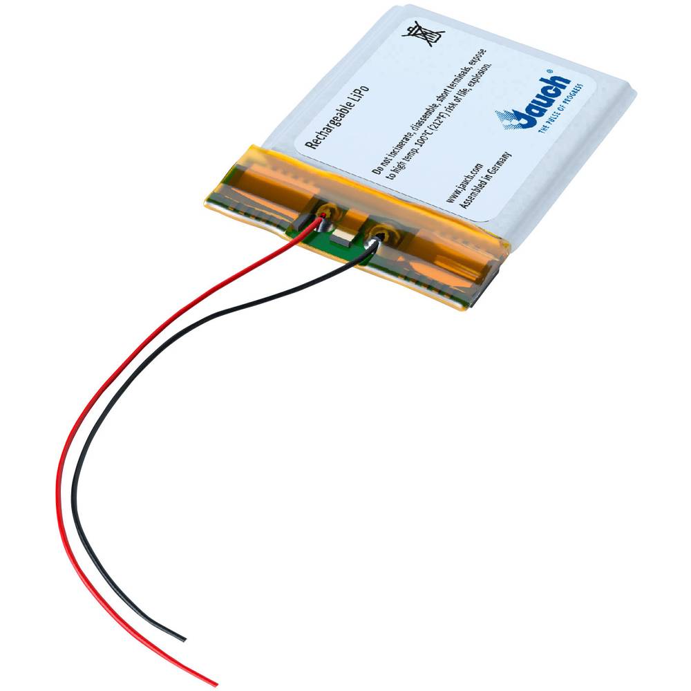

Just wanted to share another update. I purchased a new battery from the link provided by RogueSkynet above:
It's the same battery type and size used in the Lifeclock One. However - the wires are too long and the gauge is too thick to close the back cover. So I had to swap these wires from wires I clipped off one of the official batteries. (I soldered the correct wires to the terminals on the new battery, then - because the terminals are very close to each other - I covered the negative end with electrical tape, then the positive end with a separate piece.)
