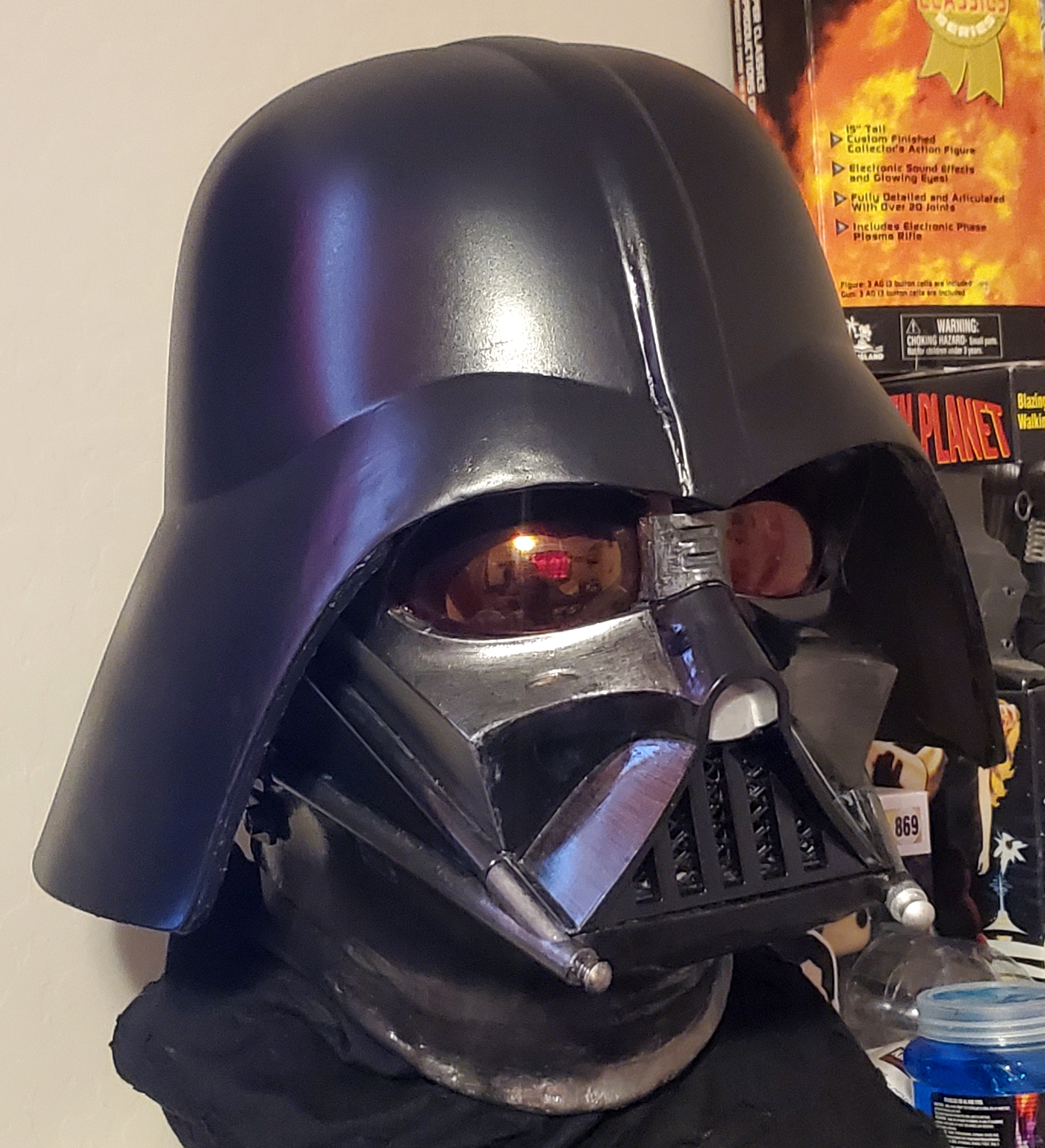

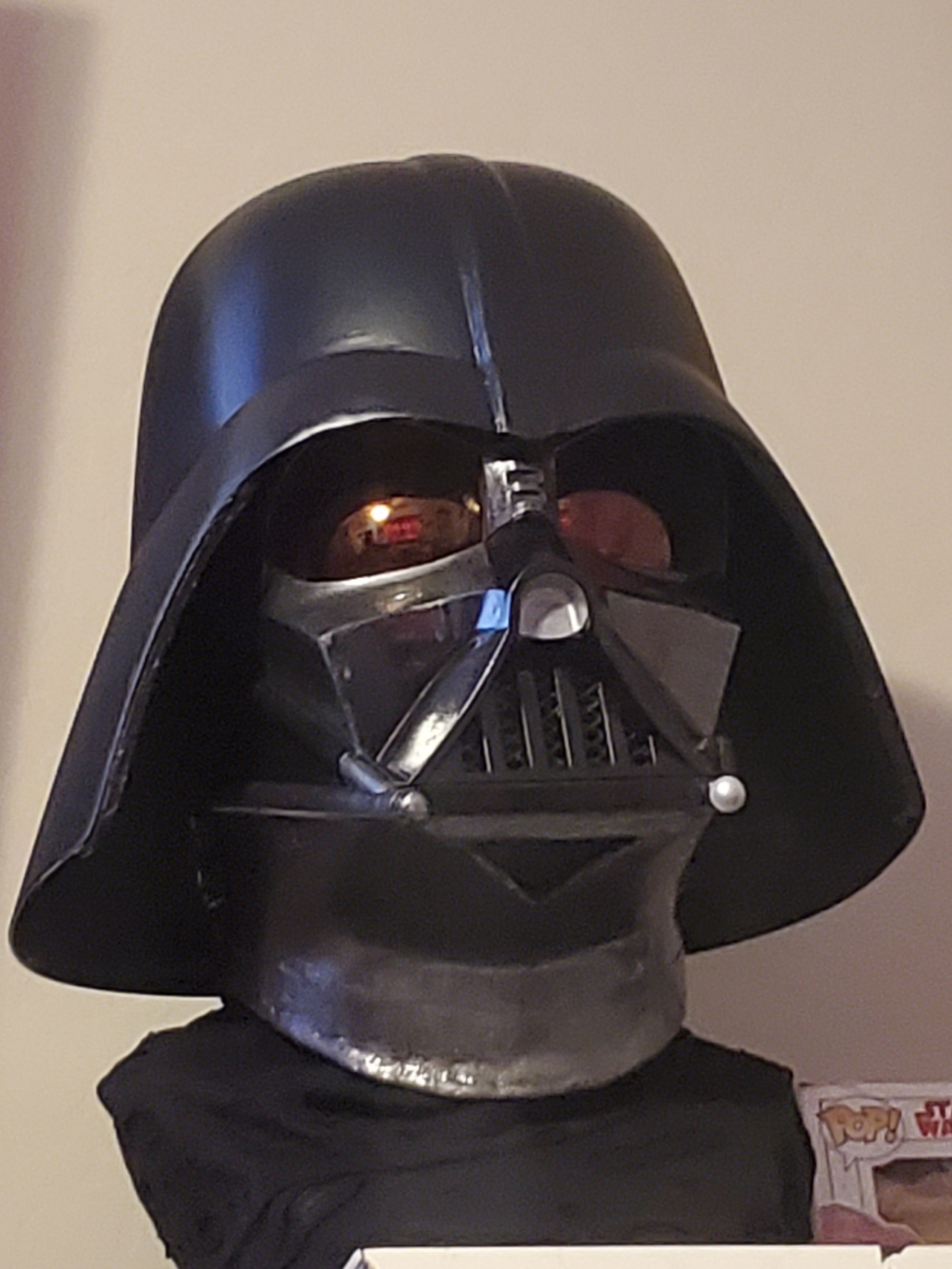

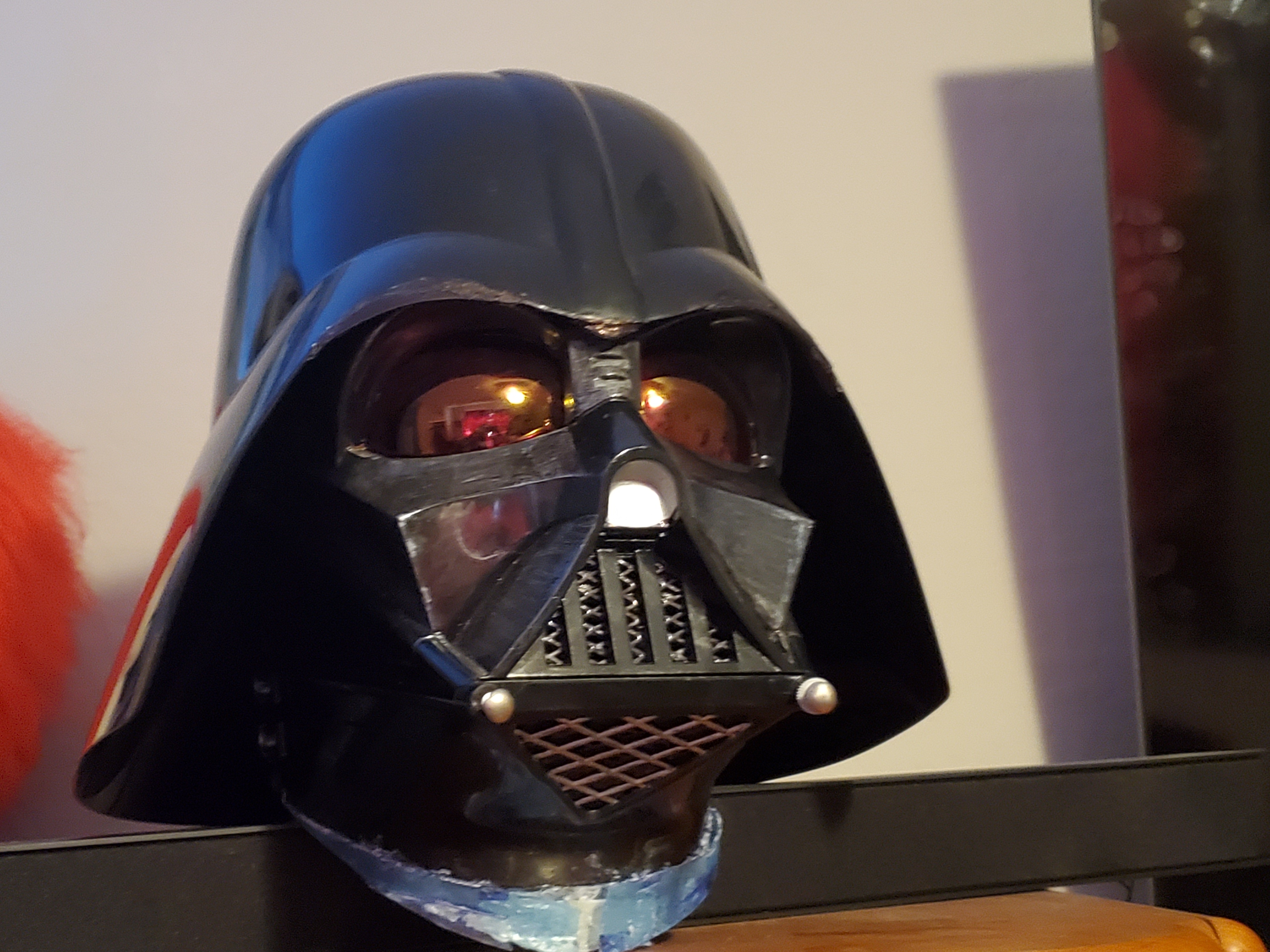

Just completed some finishing touches and it's as done as I can get it.

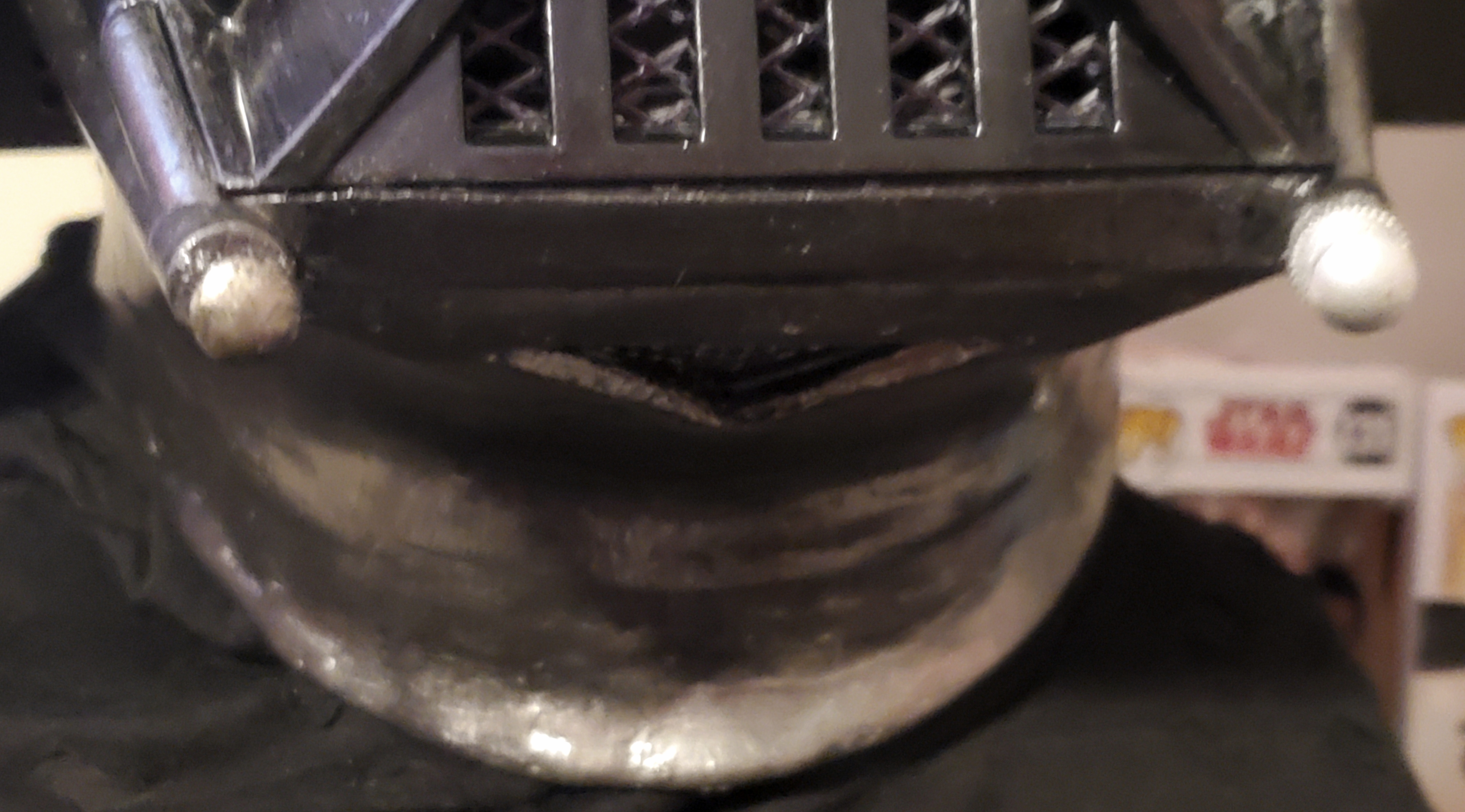

I didn't bother adding the extra material for the neck flange, as eventually this will be setup in an exploded view, similar to those others have crafted, and it doesn't really look bad in that view . Pics on that later.
Here, is final detail in the jaw interior, the backing of the jaw set with some black felt, with extra materiel folded over the top and bottom of the plastic insert,sandwiched between the back piece and the insert.
Completed mask interior and exterior head details.
In the end, it seems to me anyway, that Hasbro may have attempted an amalgamation between ROTS, Empire and Jedi helmets.
So, it seems appropriate to have detailed it accordingly.

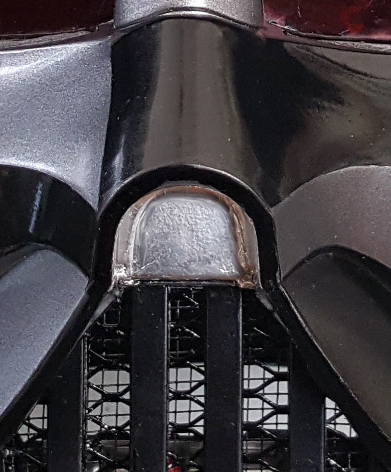

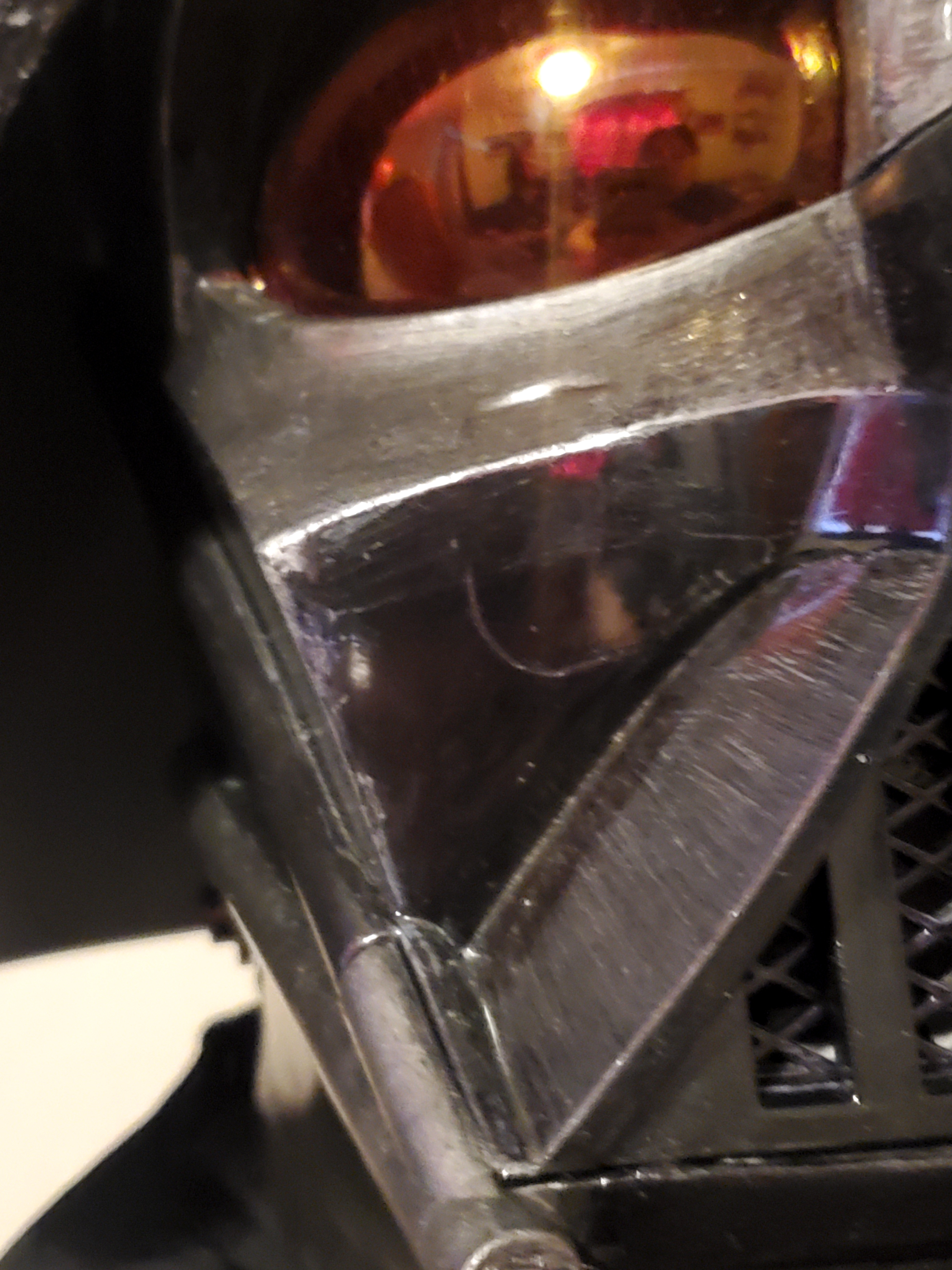

one last pic...had to zoom in a bit on the nose, after using the same foil as with the other metallic parts, it looks much nicer than painted silver.

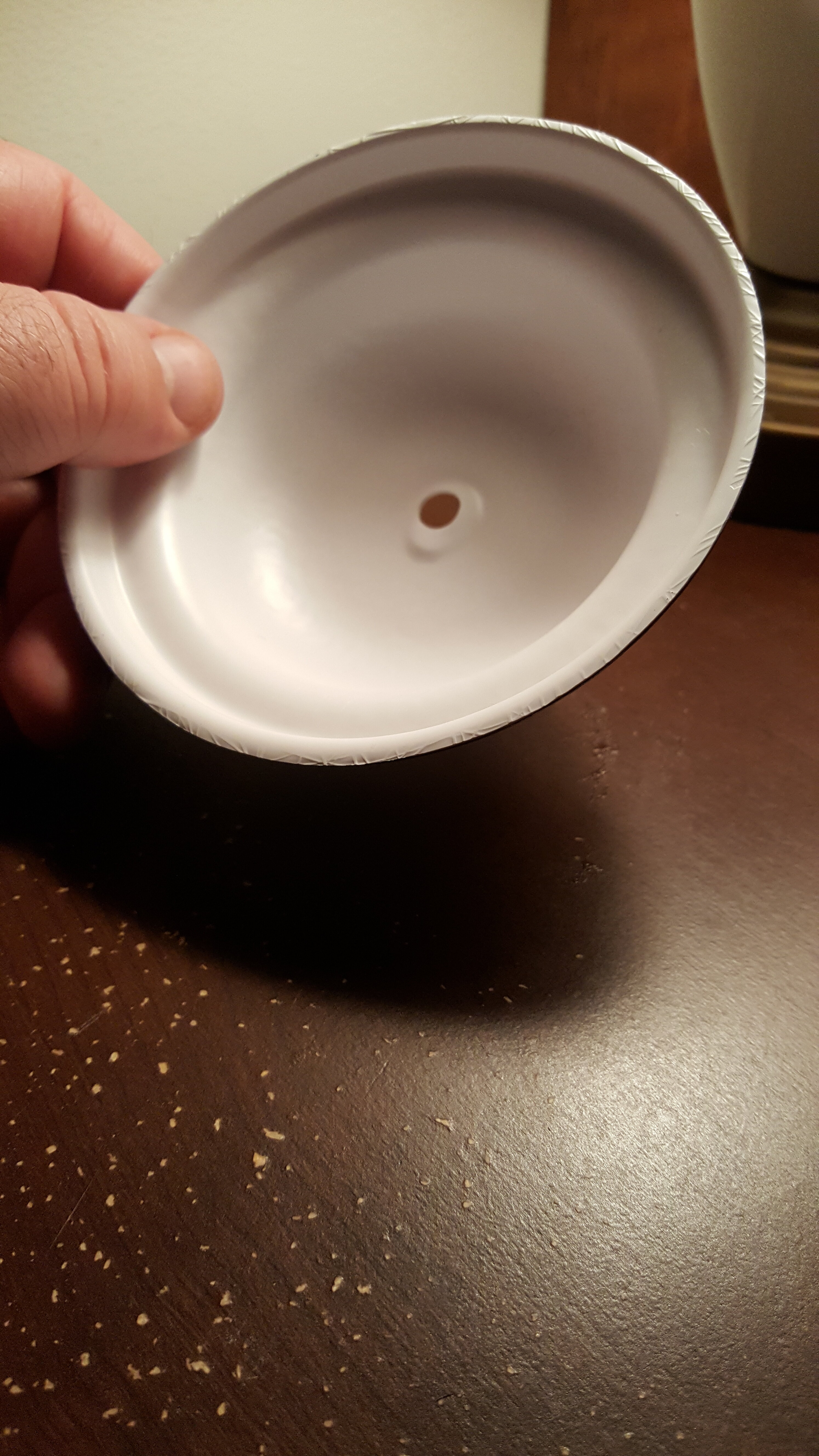

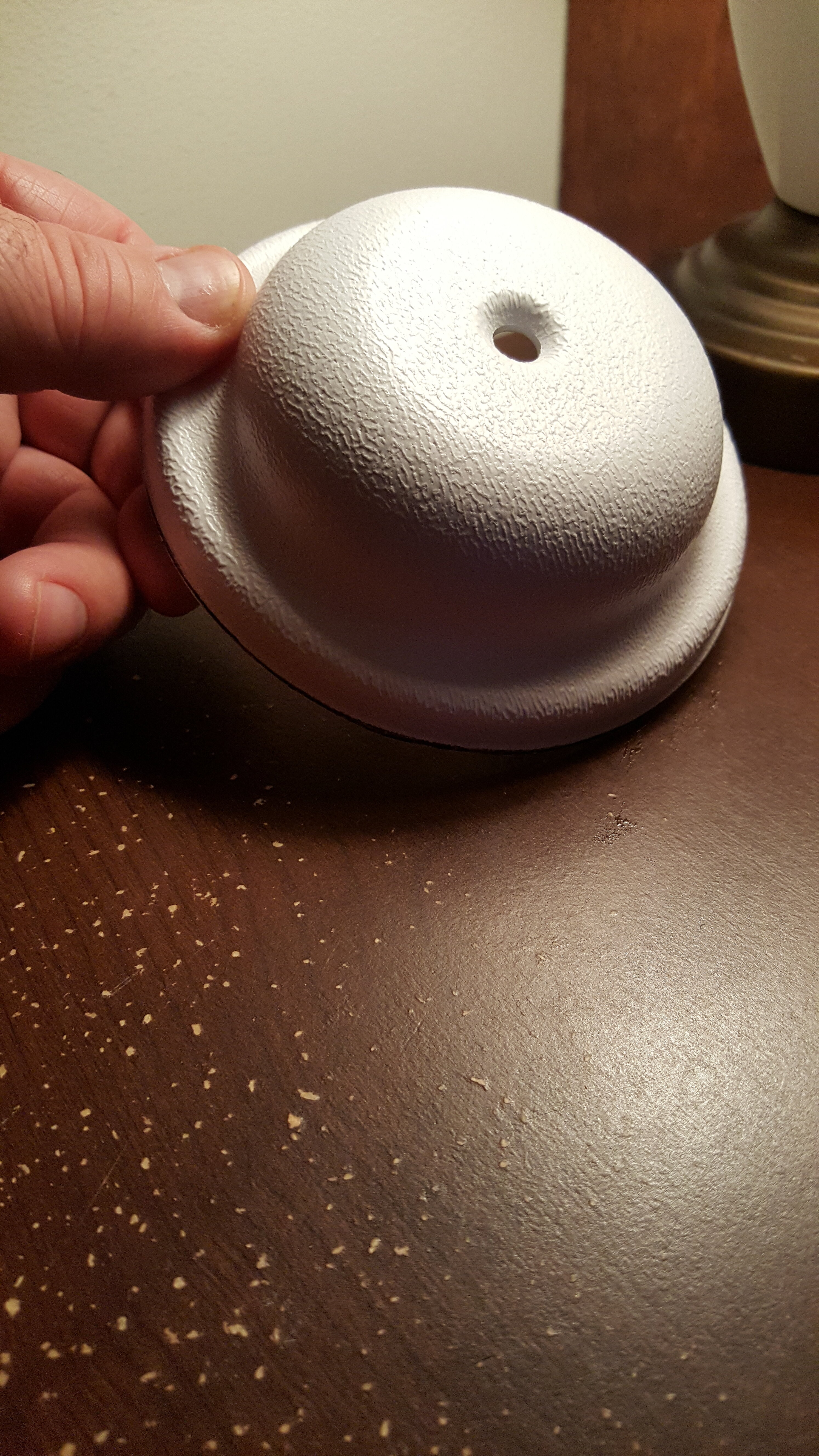

Please help me understand this part. I'm a little confused.
Do you have more pictures and what the part is on top you covered in felt?
I love this!
I don't remember exactly what it's called, but I got it at Home Depot in the plumbing aisle with all the PVC piping. I wasn't paying attention. Was just rummaging until I saw something that might work. Lol
I got two just in case I boogered it up. Here it is.
It's made out of hard plastic and is 4 1/4" diameter.

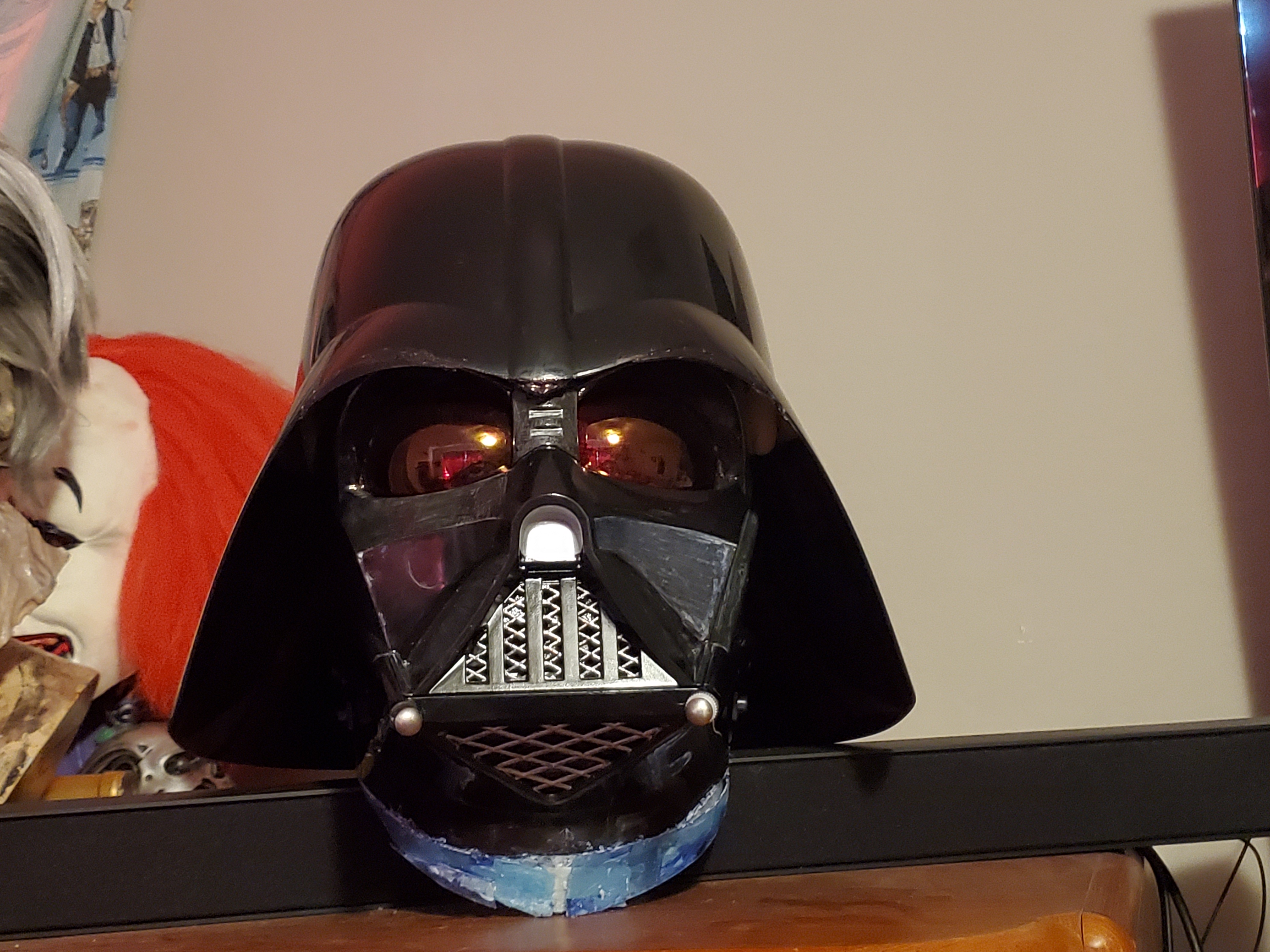

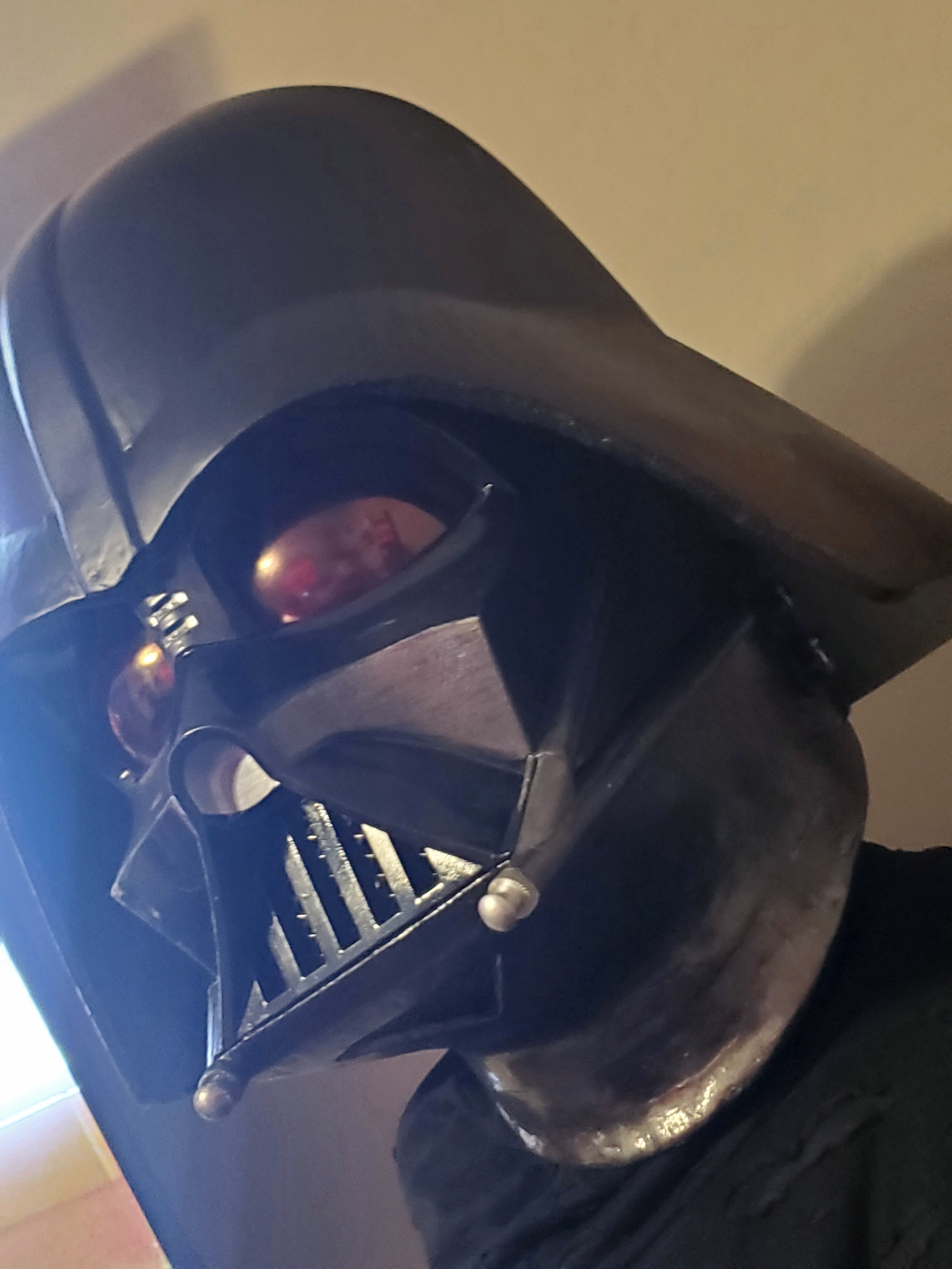

Top half of the face is painted, tusks redone, I stuffed a bunch a padding on the sides of the dome, so when I put it on the head it bunches out to the sides, looking much more accurate without having to resculpt the dome.

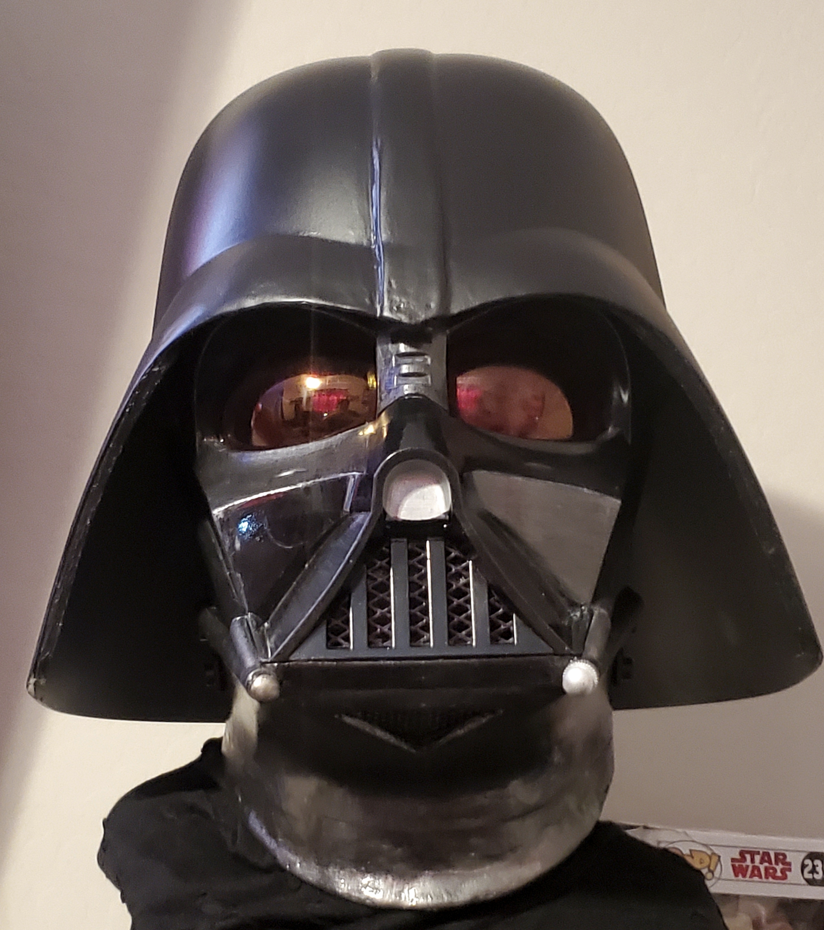

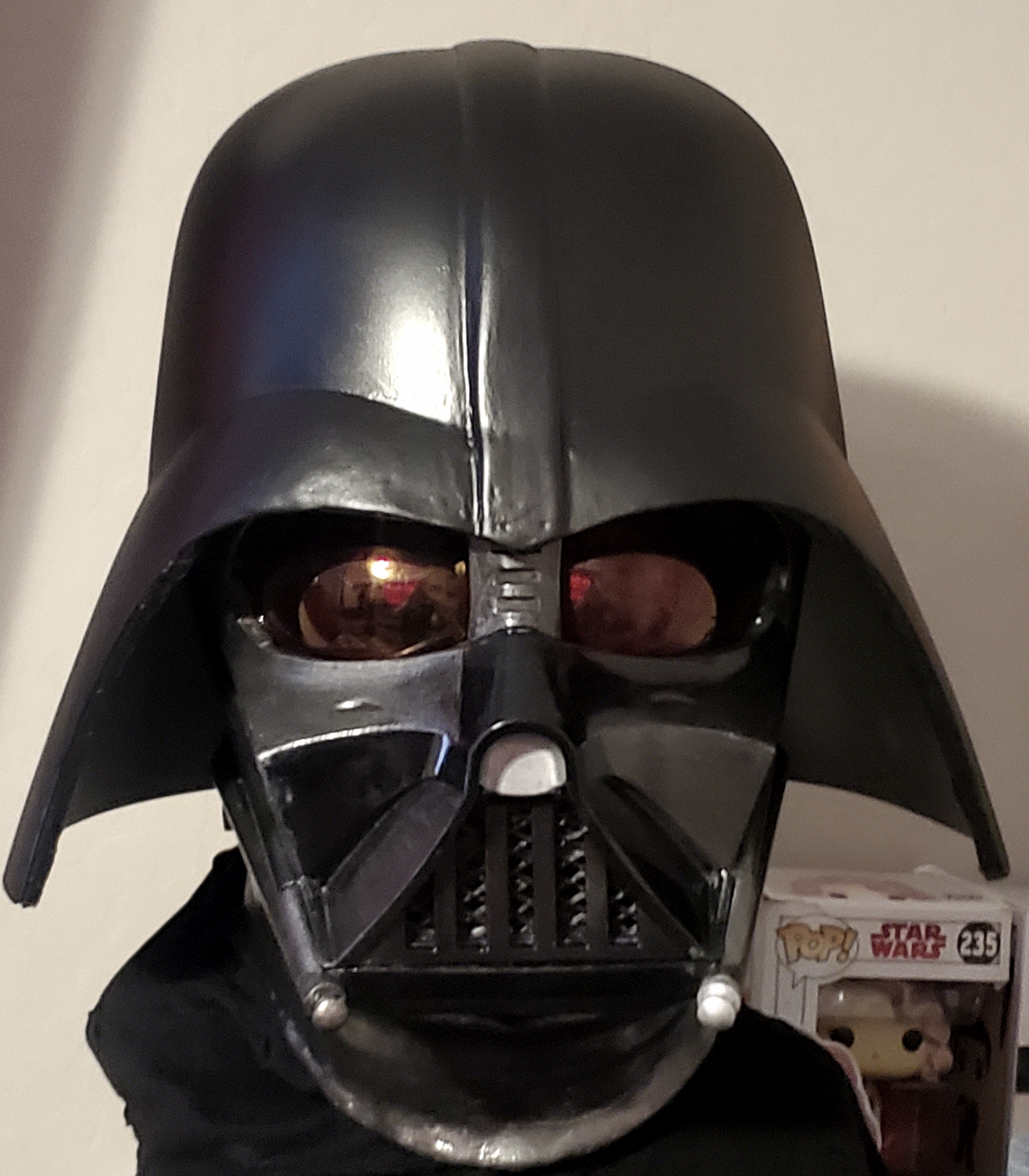

Finished, the exterior at least.
