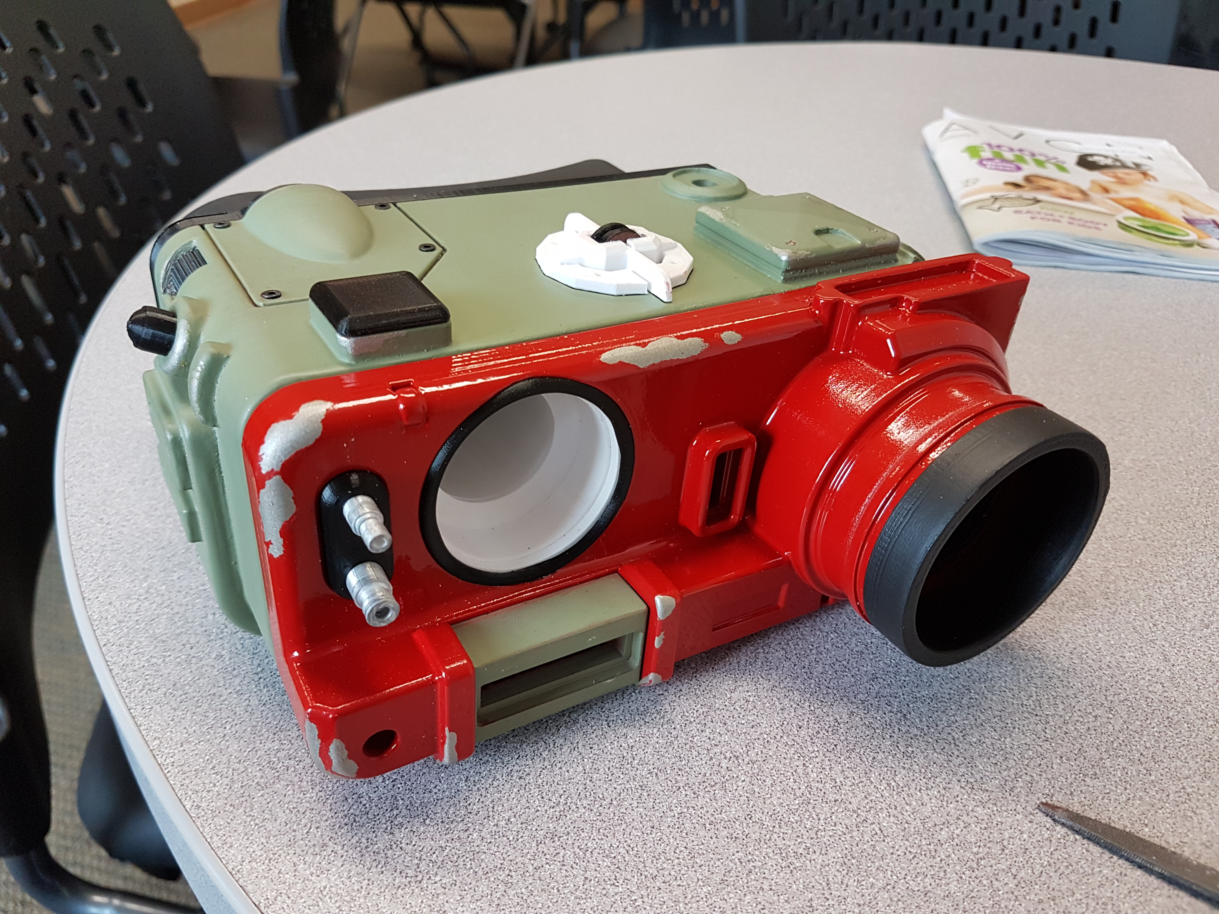

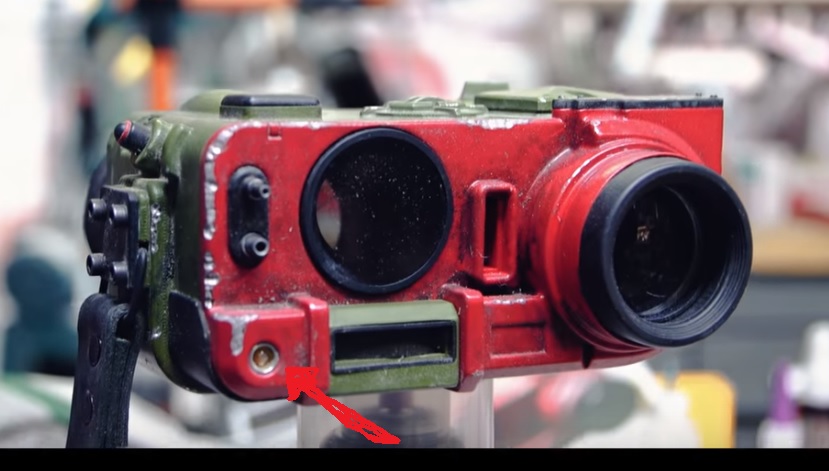

Having watched Adam Savage's excellent one day build on this project, I'm scratching my head what he put in the hole on the front panel referenced here (red arrow)? Thoughts?
In the absence of super high-res still shots of this model, I'm just replicating Adam's close as I can.
@asavage If I could be so bold as to ask directly what you used to fill the hole in the front as indicated by the red arrow?

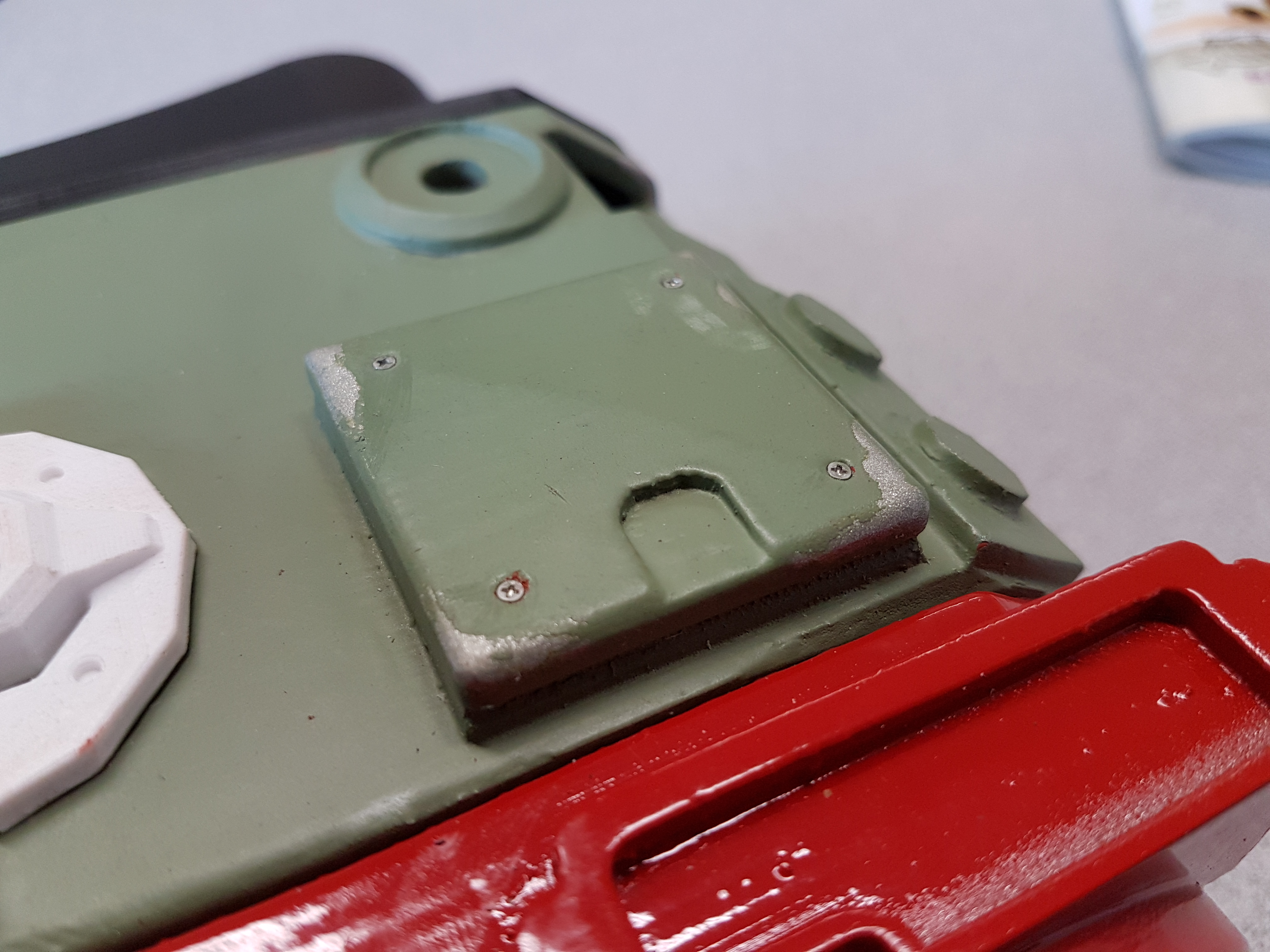

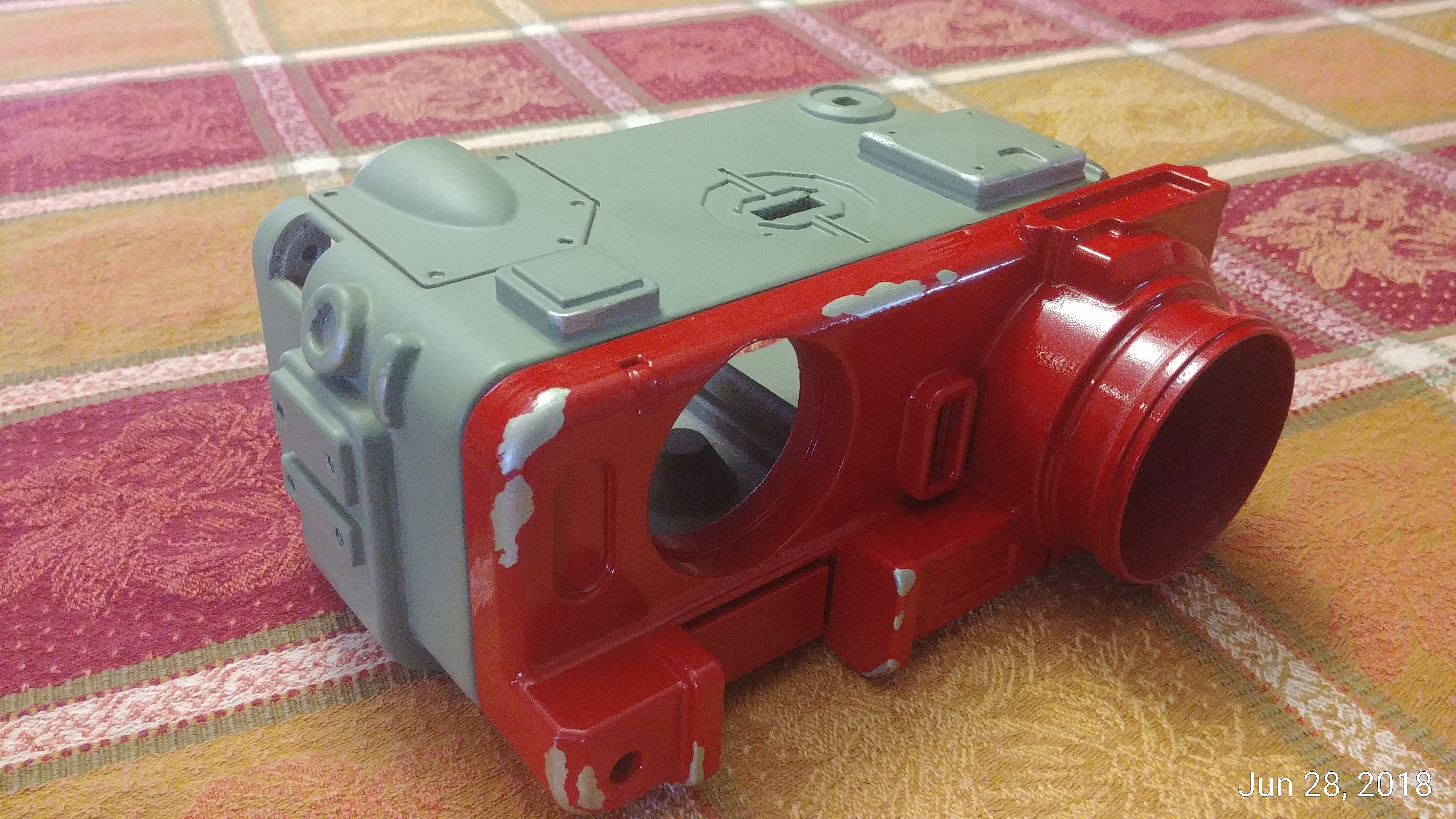

Started on main part painting. I used a different method of chipping/peeling paint off the casing. Sprayed a coat of metallic pewter over both parts to simulate the colour/finish of a casted aluminium part. Then I applied mustard to the high features where I wanted the paint to be absent from eventually. Sprayed my colour over that and let dry. Then I buffed hte areas where there was mustard underneath the paint with a damp paper towel and voila! Looks very much like worn away paint without the aggressive dremelling.
Looks great. What is that metallic pewter spray?
Rust-oleum "universal metallic" satin nickel rattle can
I think the green i chose is too light, gonna have to hunt down something a little more saturated and redo the main casing.
Thanks. The original is actually quite bright greyish olive green in the pictures available. Also weathering will dull things down quite a bit as well. If I do another I would mix colors and airbrush. The red parts are more signal orange. The prop doesn't have a military paint job it is more a search and rescue type.

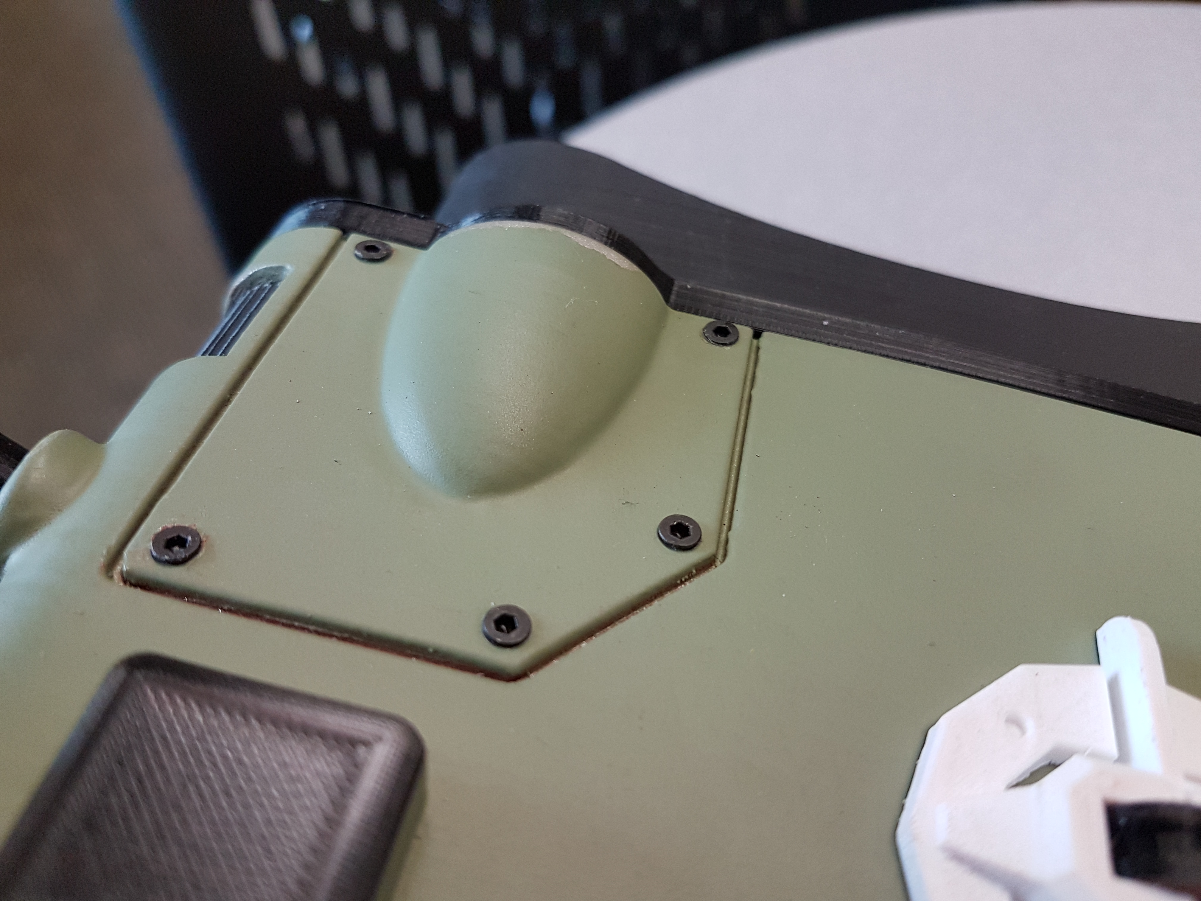

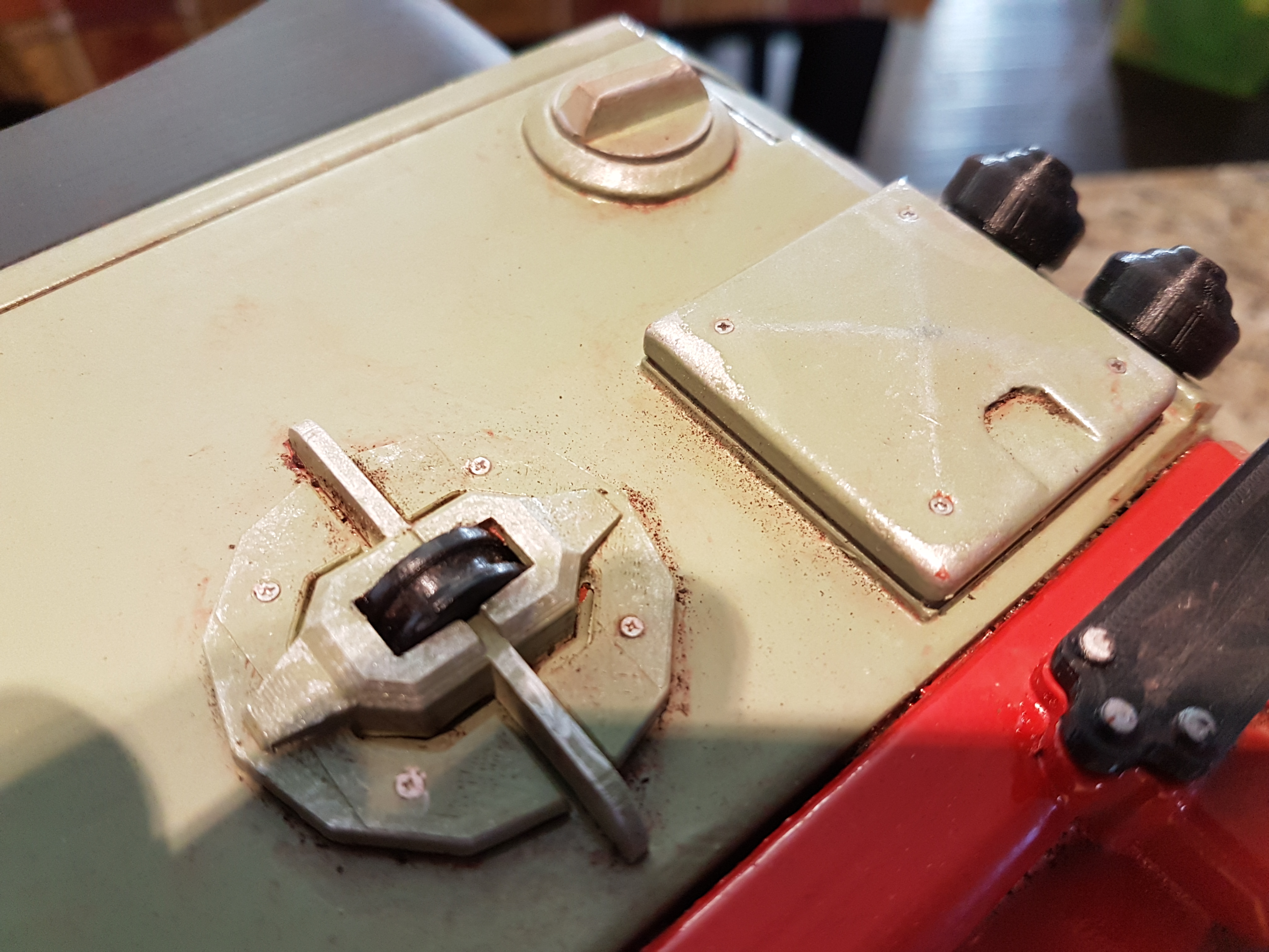

Work is progressing slowly but surely; over my lunch break today I installed some screws and the top wheel greebly.
I think the real screws lend some authenticity to the piece.

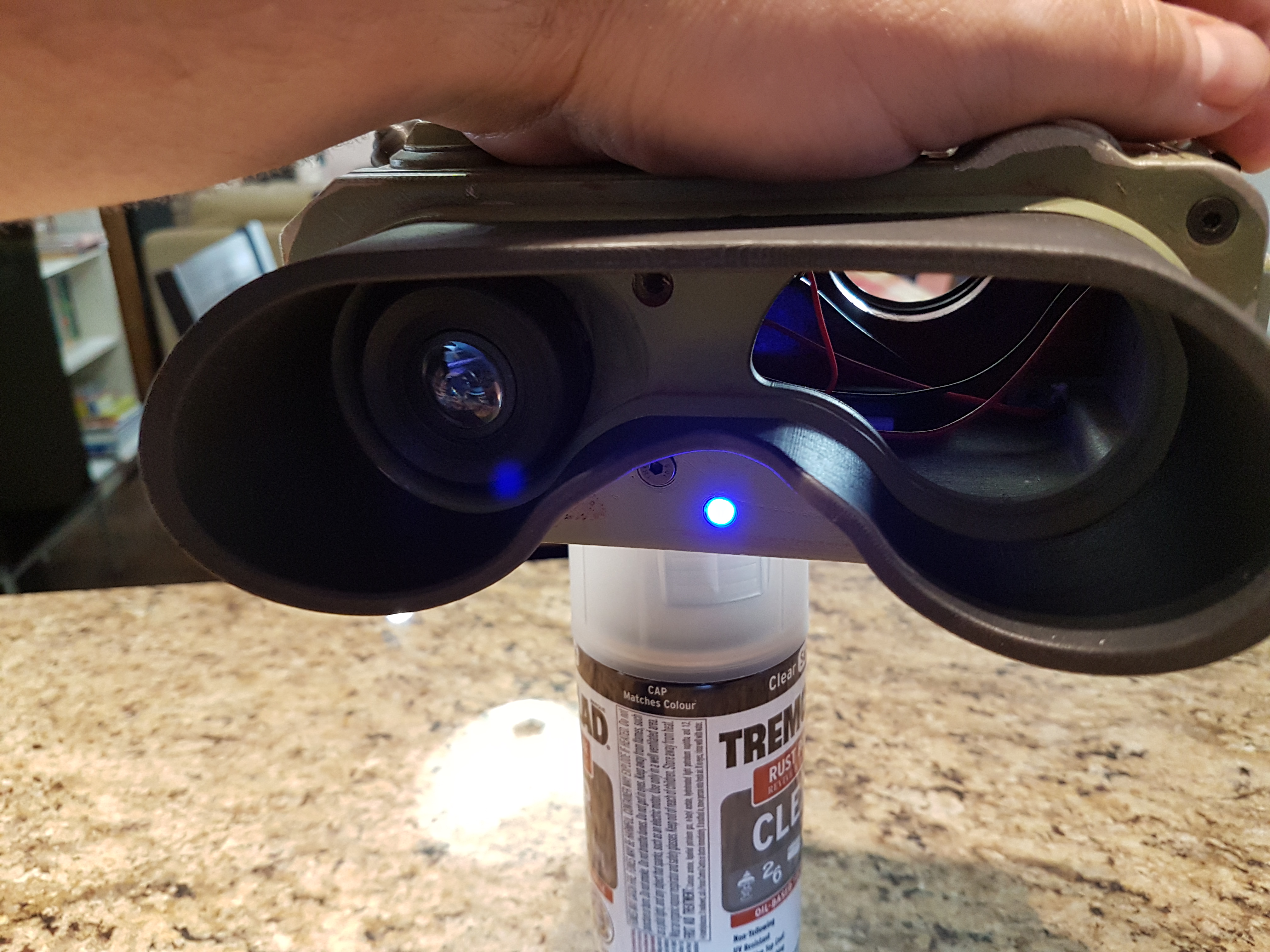

More work done here and there; Friday afternoon off work so a big push to get the greeblies attached, more screws installed and the electronics run. Just need to cut the windows and wait until my battery holder arrives and then it should be done!

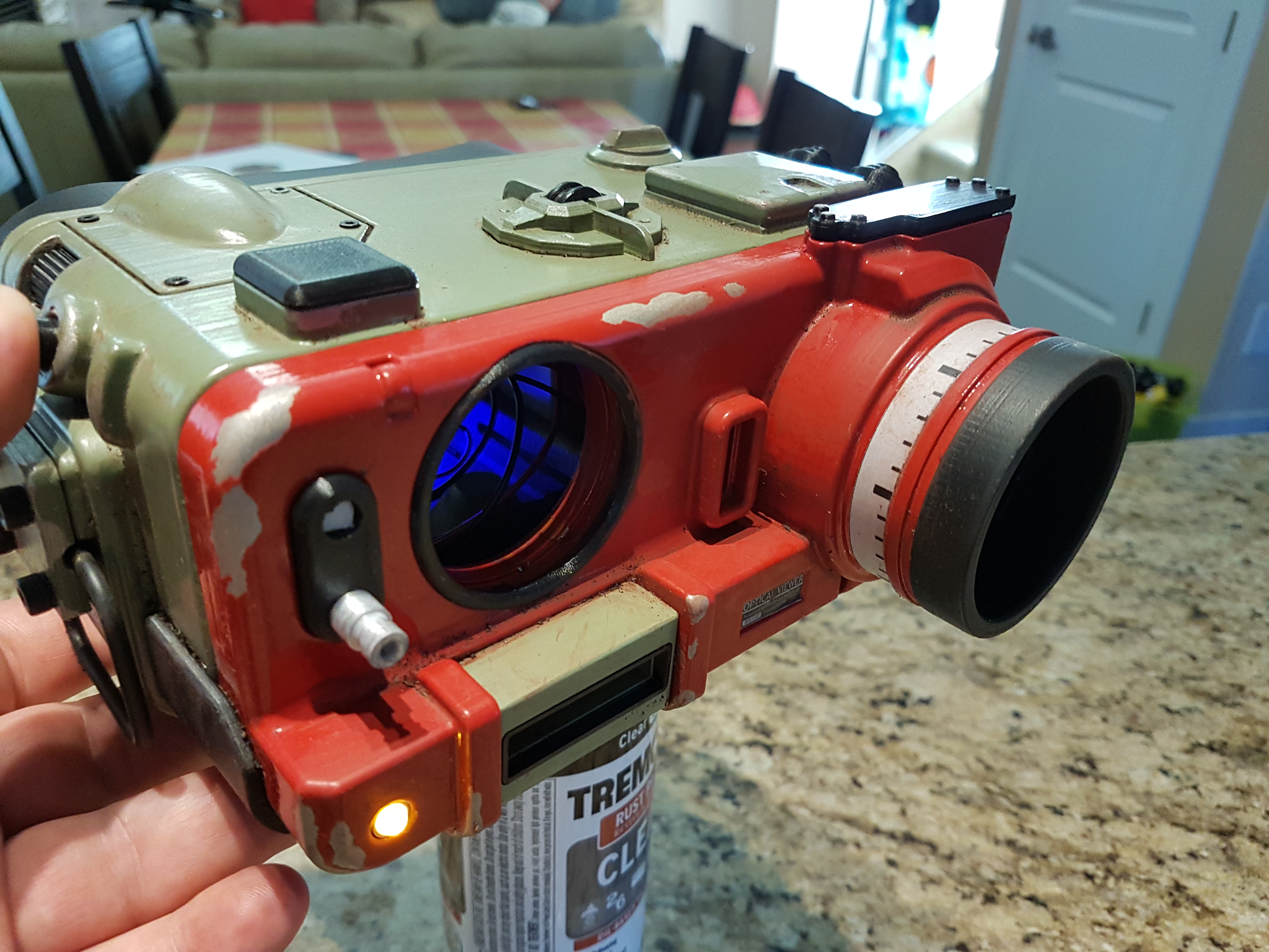

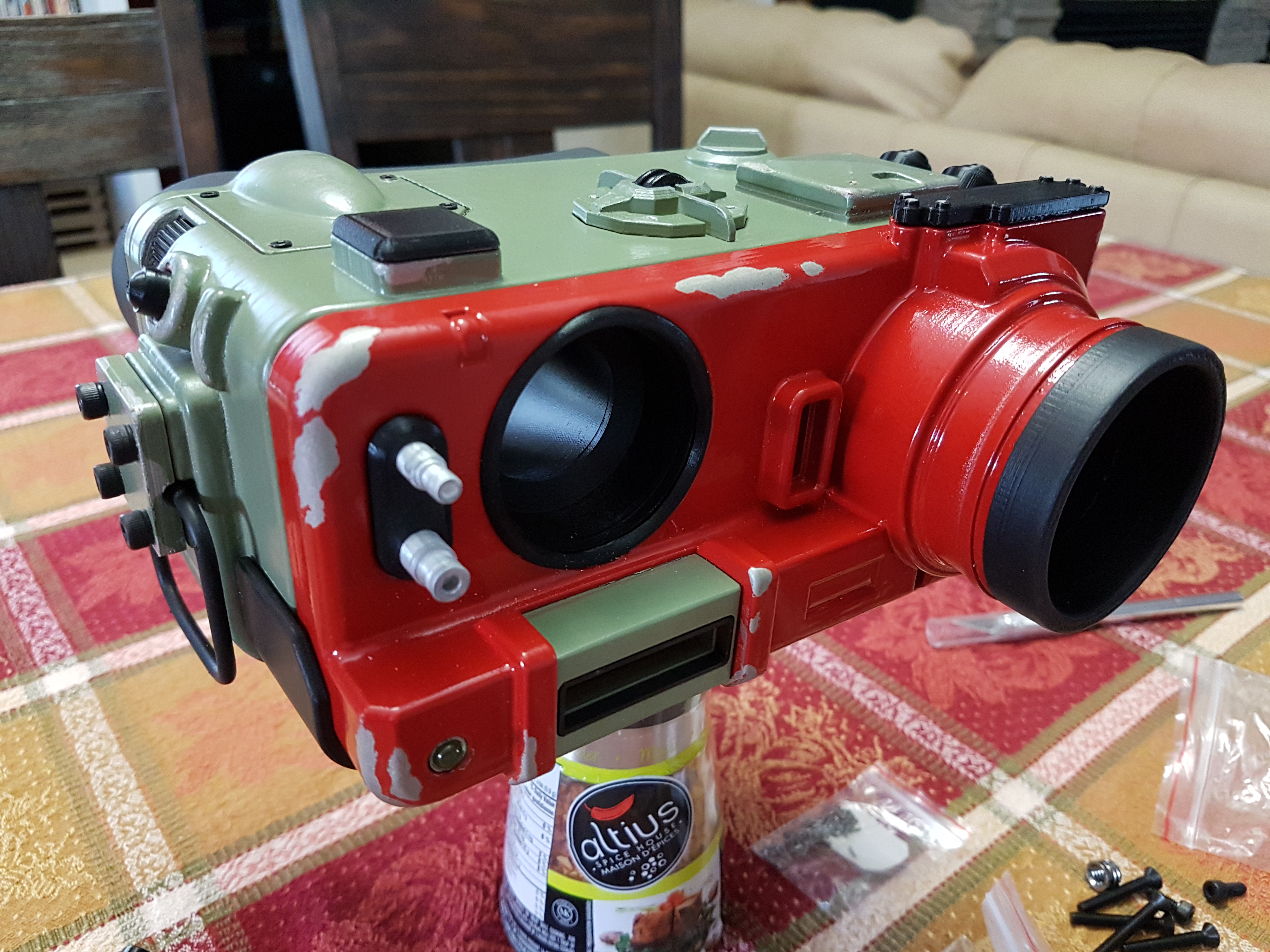

That part that I didn't know what it was installed in the front bottom left hole on Adam's build? I got a very similar look from a 5mm yellow LED and a small bushing I printed then hit with some Molotow marker.
Decals are done, wired the electronics up over lunch, weathered it today after dinner...
Yellow LED in front, blue status LED in back. Ignore missing sensor it fell off in transport today, must have just press fit it instead of gluing. new one printing now.
Then a light weathering job. Brown acrylic paint watered down, and a gentle toss in the garden for some grit/dirt.

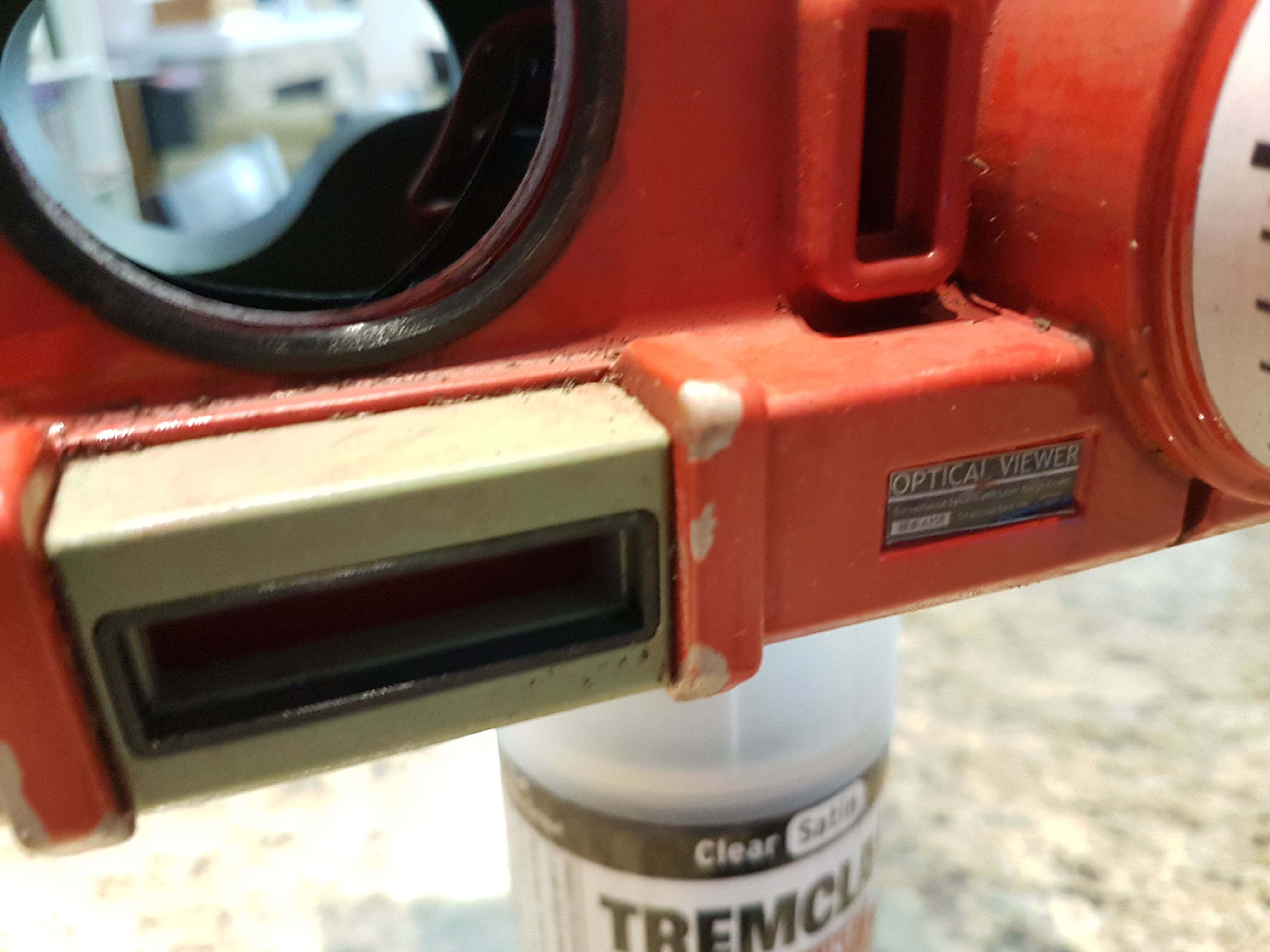

It was a tiny acrylic hemisphere. It looks to me like there's a little lens back there. So I threw that in.

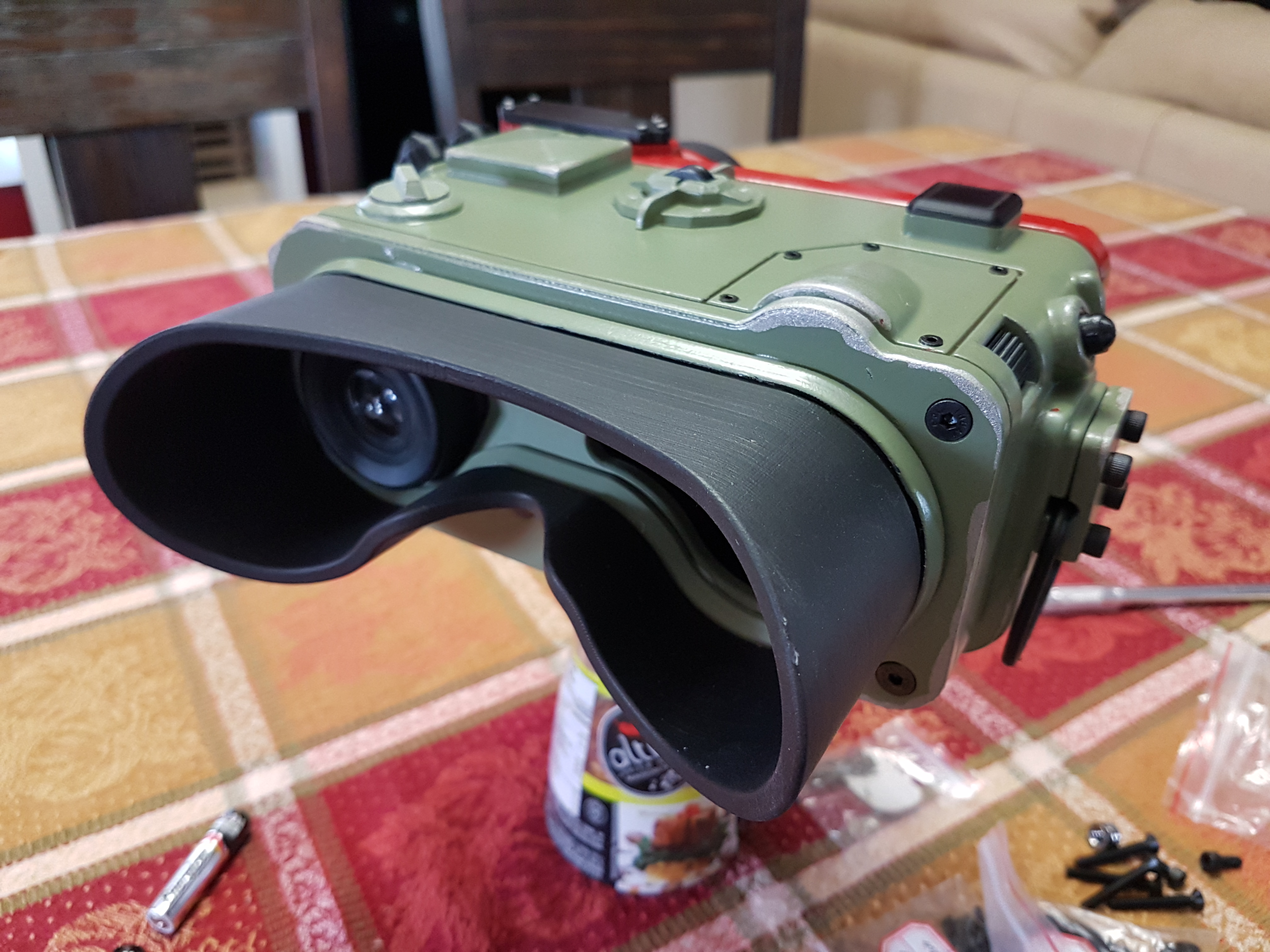

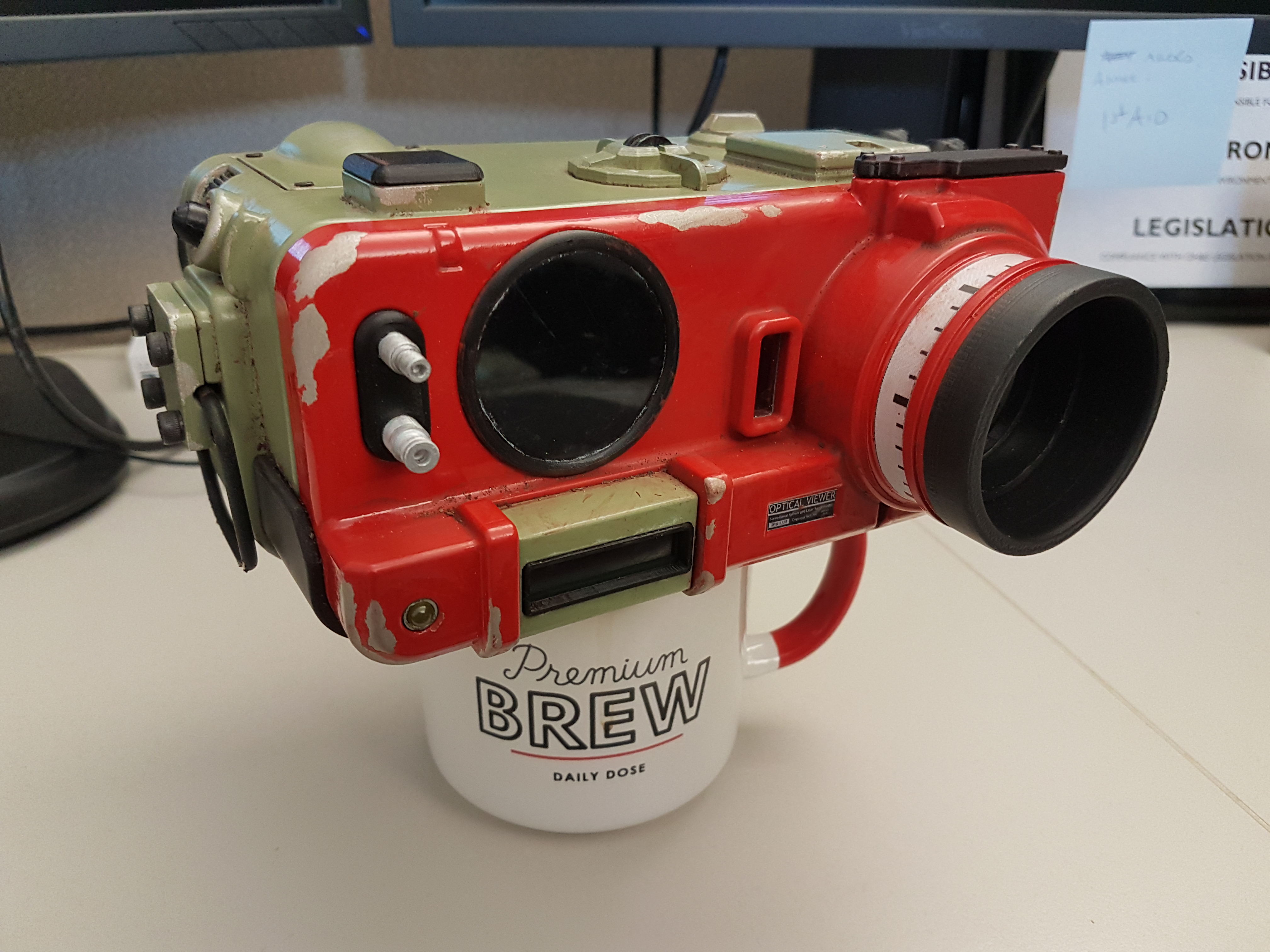

Okay last update!
Got all the windows into place over the past two days. It's been a long build but worth it, very happy with how this turned out and thanks to the OP for the files!
