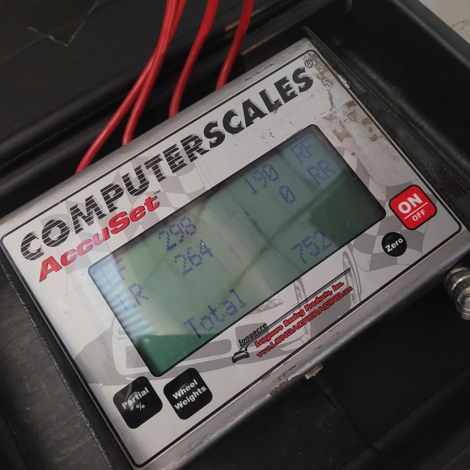

I got the Viper weighed using vehicle scales borrowed from a local racing club. Total 752kg, but likely to reach the ton by the time I've skinned it, put the other wing and gun on, plus a few layers of paint and some extra mechanical accessories.

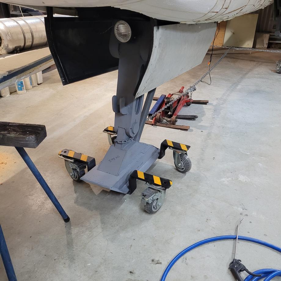

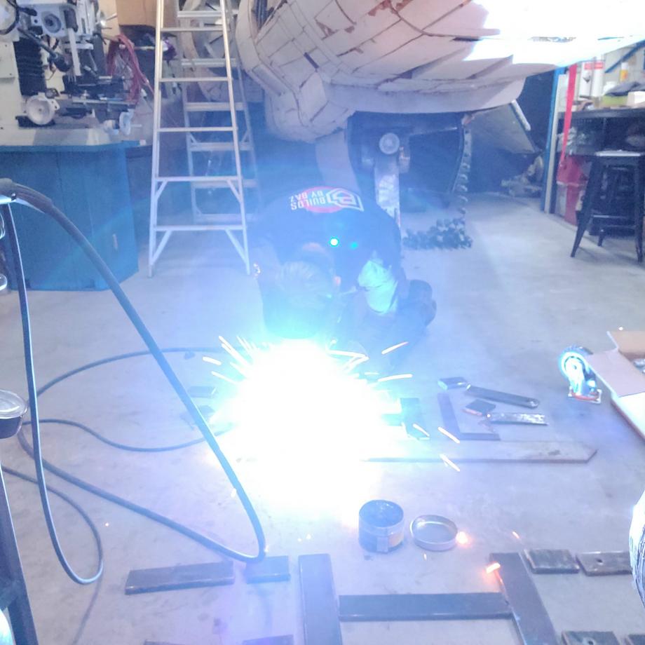

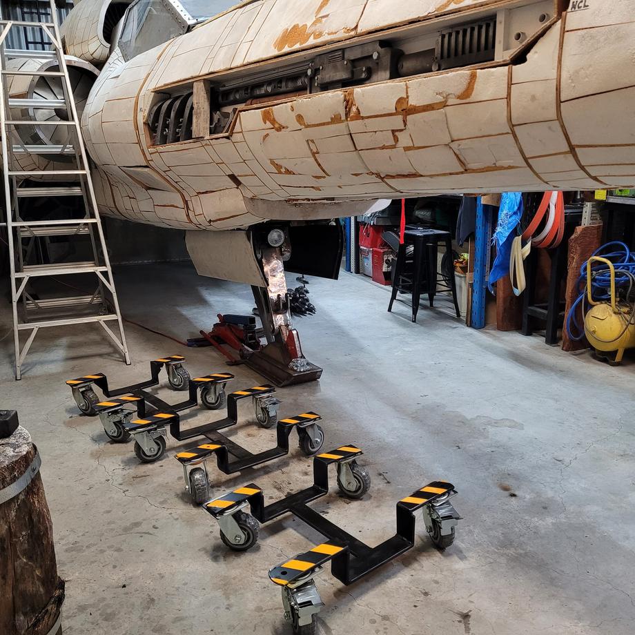

Now I can get to work. I built some vehicle dollys out of 14mm thick leaf spring stiffeners. Each trolley is rated to 800kg+ and has been tested, so well over engineered. Now I can move it around in the workshop and with the addition of some securing stirrups over the foot, I can winch it up the ramp of the trailer, currently in the design phase.

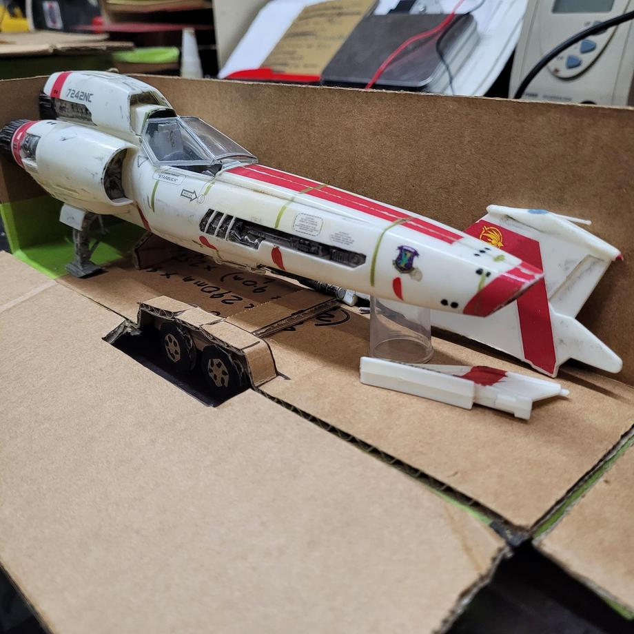

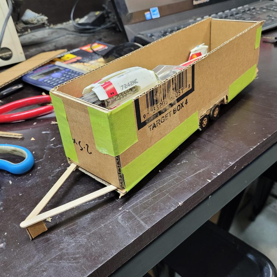

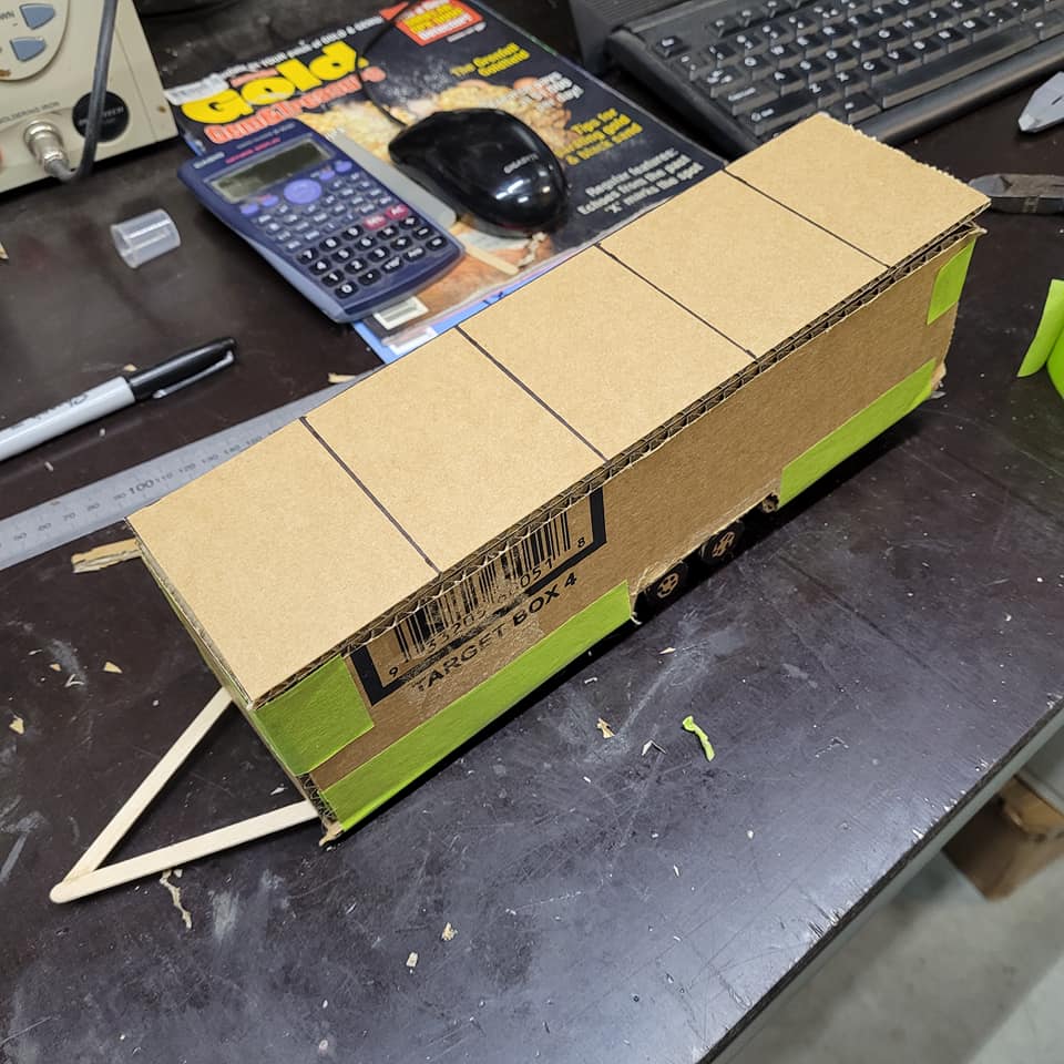

I've made a quick cardboard concept. It may go to three axles and they may or may not have to be positioned further rearward, but that's for the engineers to decide. The roof comes off in overlapping sections, the sides fold down to become platforms. Stabilisers wind down in the corners, bollards and stairs pop into holes and recesses, plus a ladder over the wing to enter the cockpit. There's a lot going on.

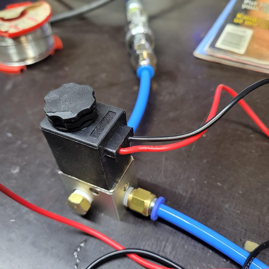

Finally, I got some hardware to test for the reaction control systems (RCS). 8 ports forward and 8 ports rear, from an on board air compressor mounted inside the nose, to be controlled via Arduino, connected to the joystick in the cockpit. These will fire each RCS port individually, picking up a bit of water from a reservoir via a siphon between the solenoid valve and the port.

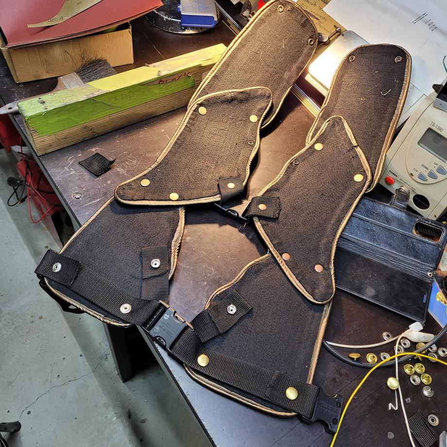

I changed some of the press stud arrangements on the flak vest, so that the bottom straps can unclip and feed through the front belt loops on the flight suit. Colours of the studs are off, I know, but it's hard to get the right ones here. I'll paint them later.

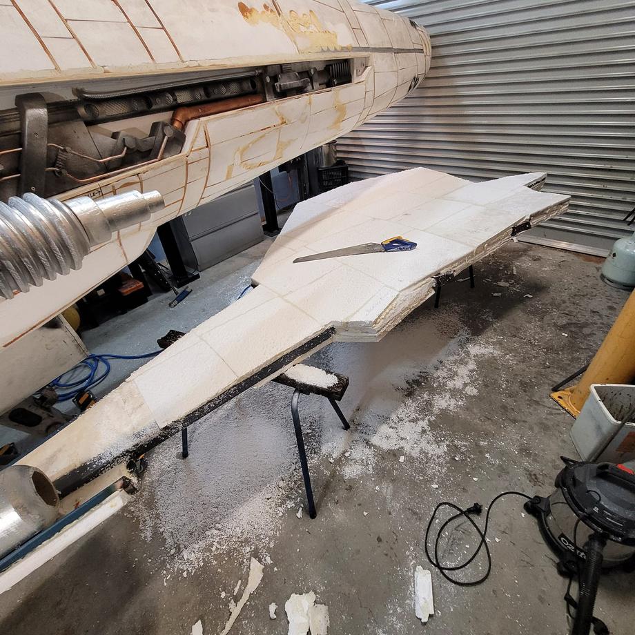

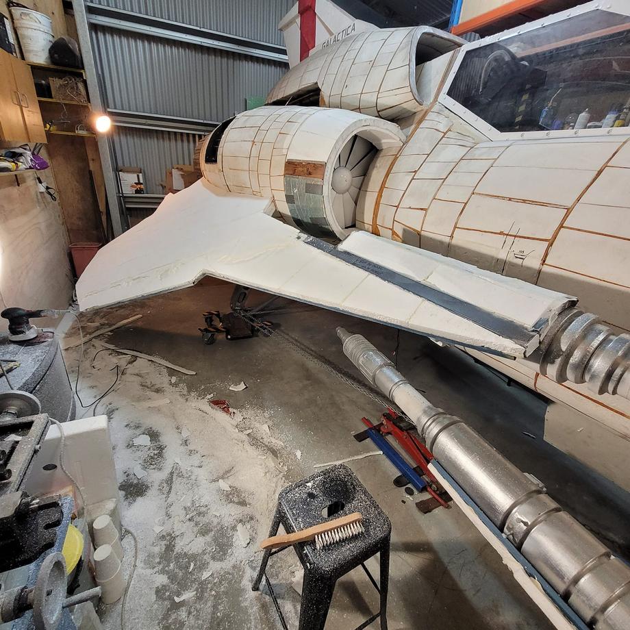

I've taken the port wing off, put the Viper up on it's dolly trolleys and now it pushed around the shed at the slightest touch. The starboard wing is now fabricated and waiting for a block of time where I can do the final shaping and sanding on it. I've also got the starboard wing on saw horses, where I can concurrently shape and sand it's underside.
The landing gear has got a fresh primer coat on it, as the bare steel was starting to flash-rust.
The rest of the ship has been filled in with loose/broken panels, gaps and alignments and sanded in readiness for fibreglassing. All the fibreglassing materials are now here.

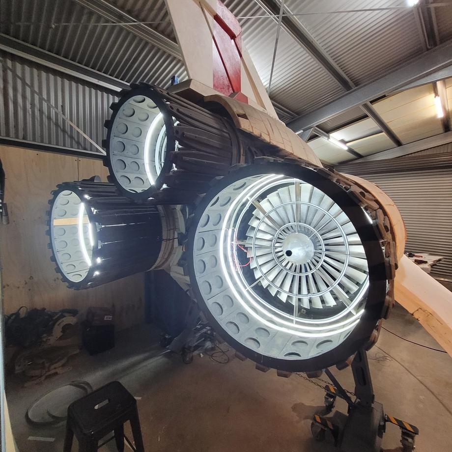

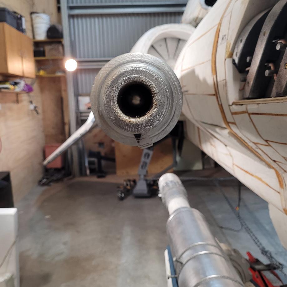

I drilled the 30mm bore in each cannon end and mounted the second cannon. This week I have also been working late nights on electrical and lighting. There is a new 80 amp power supply in the back end to run all the studio and sub woofer speakers in the engine nacelles, as well as the motor drive for the turbines and the lighting in the rear thrusters.
Cockpit instruments are all retro-fit with LED lighting to the instruments.
