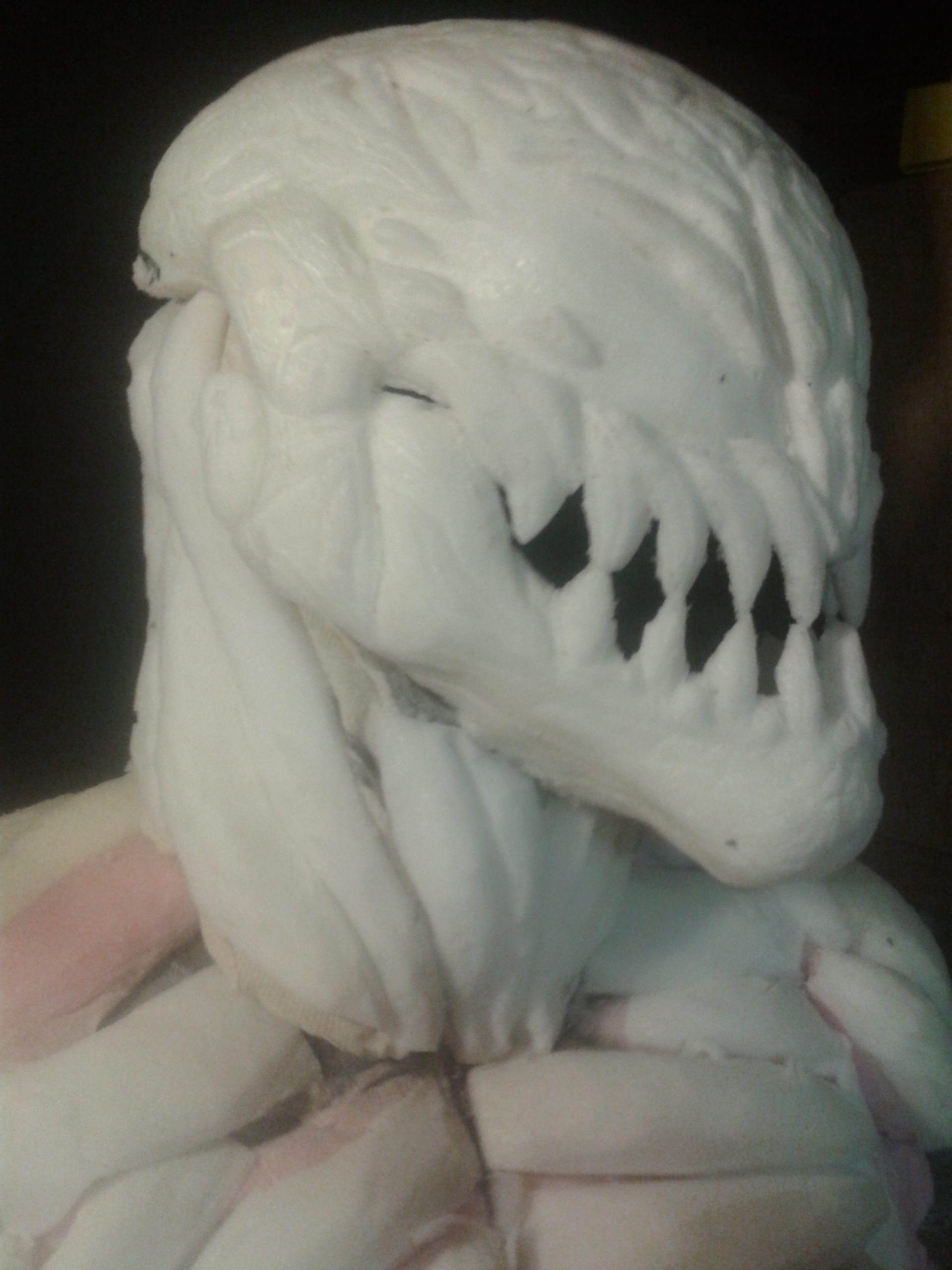

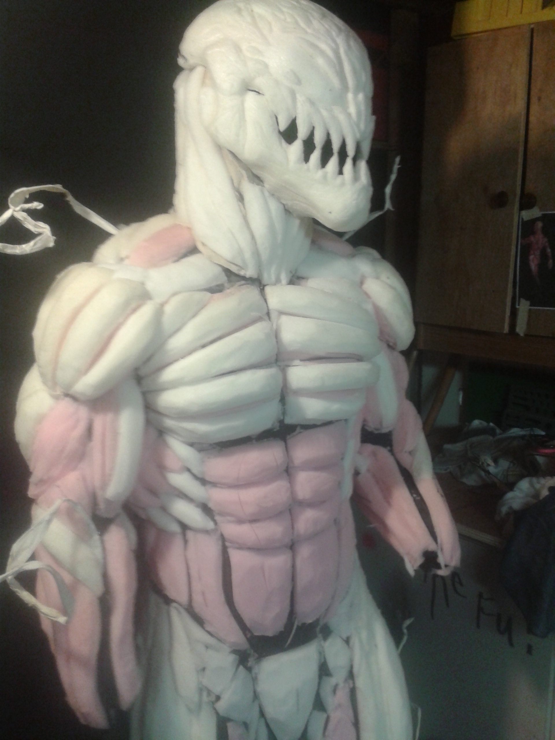

just hands , and neck left to construct then off to skin , and paint.
no its smooth-on expanding foam, thr body is ordinary cushion foam

the neck is complete and hands started. will be done tomorrow and do full costume motion test.
then finially its skin and paint...on track for the weekend reveal....
