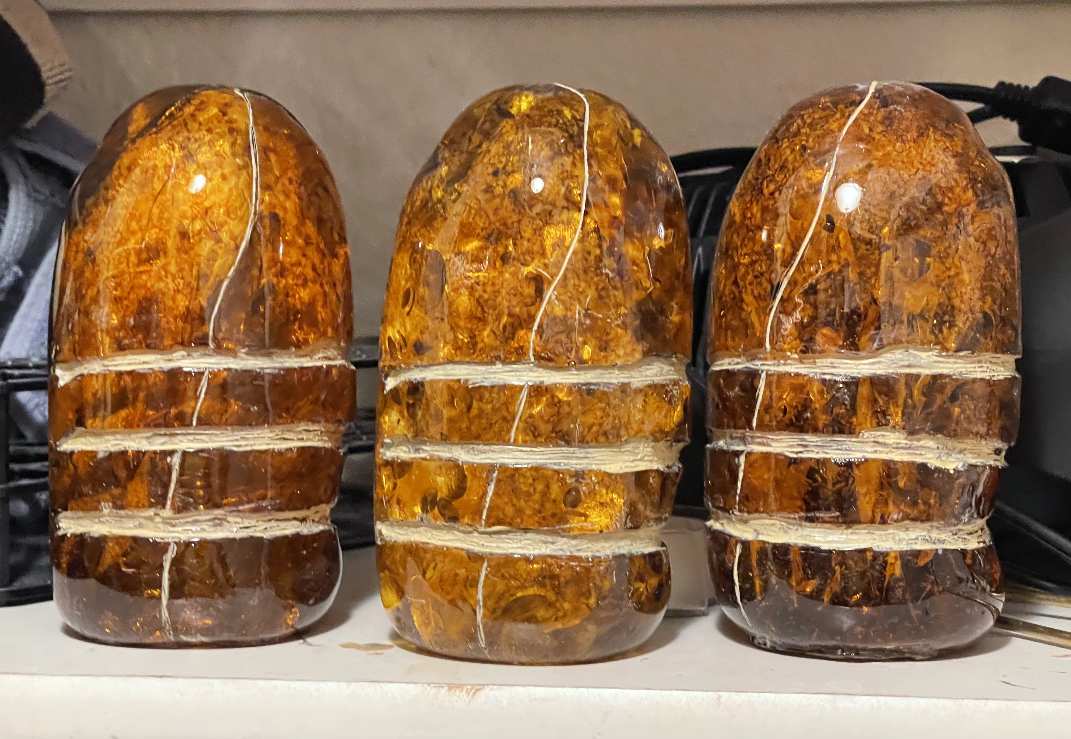

Clear Sankara Stones *update* - COMPLETED!

I had to take a break because of life-things and running out of the special dye my gf was using. it's a pretty big beast to tackle and STINKY but hopefully my trials will help! It's a beast of a project honestly.

I don't want to do a run as it would certainly be hazardous to my health + these are SO unpredictable. I will have some extra for sure, but not many. I still need to sand down and paint all these.
Easily some of the best Sankara replicas ever made. I own two sets of Restaura's, the lighted and village version, and these look spot on. All of his magic plus movie proportions and overall feel.
Thank you!!! Restaurajones is brilliant and helped me (albeit very cryptically) figure out that I just needed to add WAAAAY too much catalyst. It's basically a science experiment. I plan to add lights eventually, but not I'm just working on getting the colors right.
May I ask what resin brand you used please
I got it from Silpak, but you can also use the Polyester resin from what most craft stores carry from "Castin' Craft" but it is WAY too overpriced and the catalyst is sold separate.... and it's honestly a ripoff. I spent twice as much buying the craft stuff than just going to an actual professional supplier.

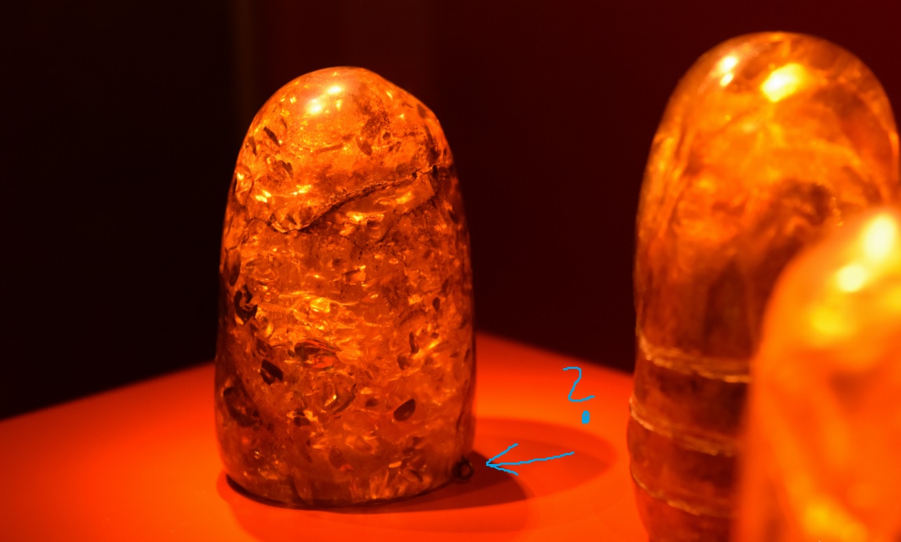

Found another detail on one stone:

Here are a few more pics! You can see they are all pretty different as each one represents a step in the process of me figuring out how to do this.
Some have those coin-shaped flecks, some are much smaller coin flecks and look like ground-up crystals and others have internal cracks which were achieved with taking a blade and cutting shapes from the inside while they were curing.
*Note for anyone else that wants to tackle this: as far as I can tell, there is no gold-leaf in the original stones, I heard Adam Savage mentioning that on a few Tested segments and although the resin creates a similar effect, I don't believe anything was ever added inside the stones other than extra hardener.
The paint my partner did also adds a massive amount of dimension as it is not just a straight as there are layers of translucent dye that is then cleared with "Matrix Clear"
