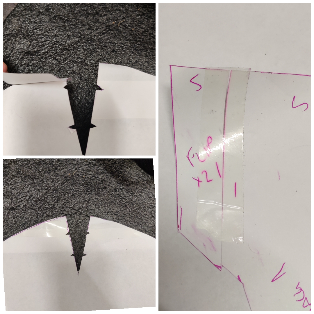

Pull up files on PC.Enlarge to necessary(105%) in your case. Turn PDF file to the orientation that makes this easier,and trace in pencil part of the main part adding on the extra section(make intersecting mark to know where to place.then go over in black Sharpie. Tape to relevant piece,cut and transfer to foam as other joint pieces will be(i.e back plate)
sorry to bother, but what is PC.Enlarge.
another trick: Adobe reader allows to split a page to multiple real pages after rescale when you chose "poster" as the print option. that way you get the stuff printed but you need to tack the pages together manually

If you are not going to purchase/use armorsmith. I am 6ft and 100% was ok length but not circumference on many items. I used this to carry on building for my son who is 5'11 but had to redo everything at 90% and still too big. I suggest you print,trace off your PC monitor a section you want at say 70%;cut it out and place on appropriate area. If it fits use to template on foam(write % on paper template). If it doesn't fit lower/higher the percentage and check again-this way only paper template is waste. I would do this for every bit as the shorter you are it may only affect height of piece not the width-so there is no magic %-you can always cut and add sections with taped in pieces of paper before moving onto foam-hope this helps
