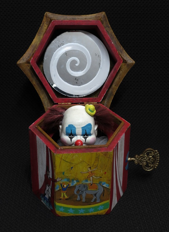

Inspired by ahoudinis build from a few years ago, I though I'd have a go at the music box from The Conjuring.
Everything is made from scratch on this. I've used a musical wind up movement for the head bob, and used a geared
3 volt motor on a tilt switch for the rotating mirror, as I couldn't find a wind up that went clockwise.
Quite enjoyed this one as it reqiures lots of techniques to finish. And it's easy to find a space to display it!
Quite enjoyed this one as it reqiures lots of techniques to finish. And it's easy to find a space to display it!View attachment 1672604View attachment 1672605View attachment 1672606

Thanks very much, your build really encouraged me to have a go. You should finish yours, the painting and ageing is the part I enjoyed the most.
