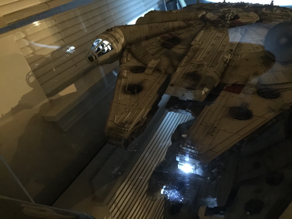

Just picked one up yesterday and she's got the same exact issue with the port side light... If anyone has a extra resistor I would appreciate it as I would like to make her perfect. And yes I know it's a old thread but I thought someone who posted before might help. ImageUploadedByTapatalk1420756346.349956.jpg

Just picked one up yesterday and she's got the same exact issue with the port side light... If anyone has a extra resistor I would appreciate it as I would like to make her perfect. And yes I know it's a old thread but I thought someone who posted before might help. View attachment 423617
