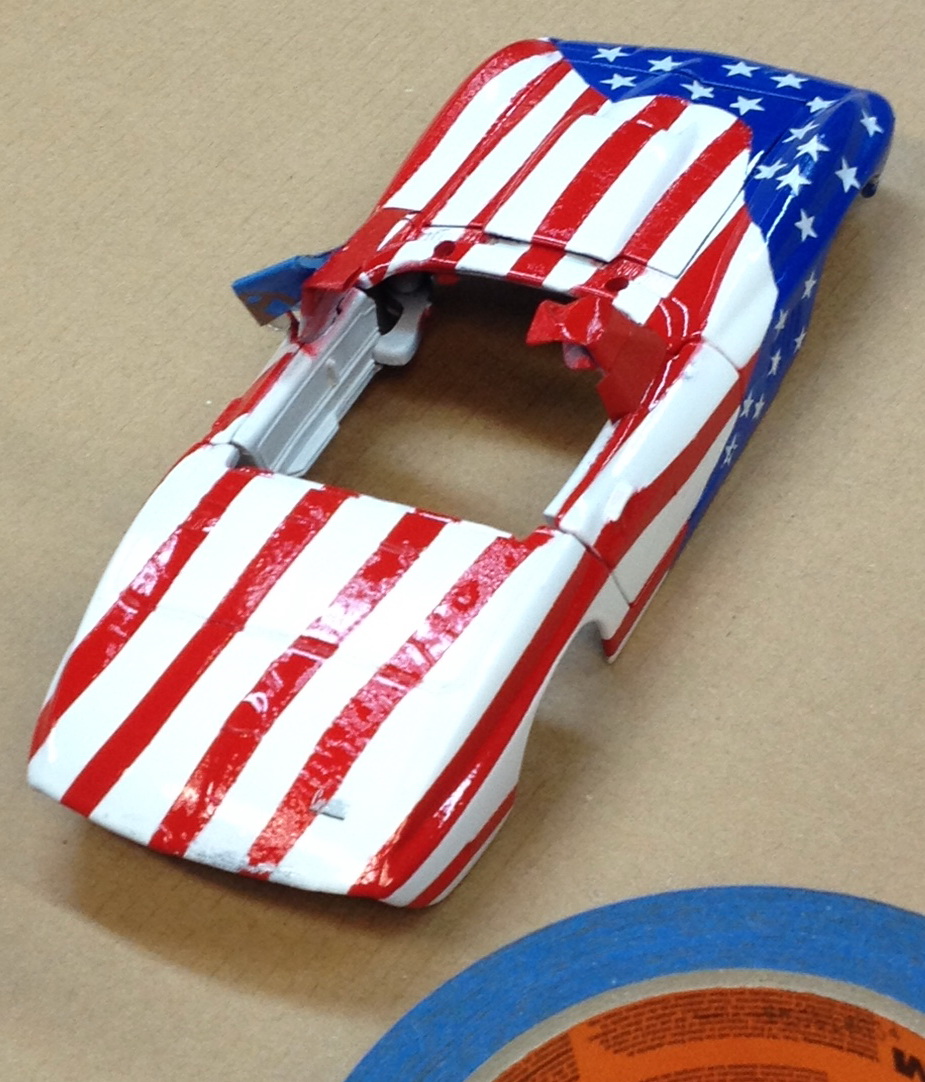

Just curious, why not use a different brand of paint then Rustoleum? Seems like a lot of folks have problems with it.
I actually did consider staying within the Tamiya family and picking up a can of Tamiya red. But Tamiya is not cheap paint, and the Rust-O-Leum I used has a very nice color and lays down well. I'll probably use the same red, then dip the full body into a vat of Future.

Lots of paint leaks...
Most cleaned up off the cured undercoat ok with thinner but some areas I'm just gonna have to sa "ef it" and brush on some white. My sanding of the damaged red paint helped, but I was lazy and didn't sand perfectly. I'd say an overall 60%-75% improvement, which is good enough for me for this project.

...... All was going well after HOURS of masking off the stripes, then hit it with Tamiya Clear which attacked the red Rust-o-leum stripes, essentially ruining the model and requiring yet a third car, plus multiple more cans of paint.....
One issue I've run into with rustoleum (Which there have been a lot) is your exact problem. Out of the can rustoleum isn't a very HOT enamel. Hence the easy runs, sags, weird drying times, etc. Tamiya products out of the can are very HOT lacquers & between %40-%60 petroleum based propellants. Dimethyl ether & butane being the big paint eaters. Along with a high level of Butyl Acetate, which is a quick flash solvent. Chances are the HOT Tamiya lacquer ate the enamel. Look towards acrylics for top coats when using rattle cans for base paint.
Side note ALL Tamiya products in can ARE lacquer. There are NO acrylics in Tamiya cans.
One of my best resources in the world is MSDS sheets. You can look a 2 product sheets side by side & if the components match up in type & quantity. You're good to go!
For modeling products this link has almost all products in existences MSDS's http://www.stanbridges.com/safety-data-sheets. THen check the other off the shelf manufacturer for their MSDS sheets. A word of warning, after reading some of these. You may want to use their product as little as possible. Contrary to belief this can be one of the most toxic hobbies out there.
I always pull my masks right after painting, I do this because I was researching painting walls of my house and that is what pro painters do. They say it makes a better edge because the paint is still wet and wrinkles in tape can create a capillary suction. I also should mention that I don't use cans, I only airbrush. Since doing that I've had no bleeding.
There is a reason for this in the wall painting world. Big one is the use of latex paint. Latex doesn't really chemically bond, only mechanical & basically just forms a skin. That's why it's so easy to peel off everything. So, we pull the tape about 10 min after spraying/rolling to let a very thin surface film form & then pull tape. That way its dry enough to hold the tape line, & not wet enough to splatter paint as the tape comes up. it doesn't have to do with paint seepage under the tape edge. If that happens, it happened as soon as paint was laid down & the tape wasn't sealed well, or wrong tape adhesive for the paint.
Another quickie DITCH Blue Tape, try Frogtape yellow. I have never had a peeling, edge, or bleeding issue with it. Check out my vids, you'll see it's almost all it use. Sometimes you will see blue tape in there. It's only used to tape on top of other tape. Never on a painted surface or for edge/line work.
Excellent post...
