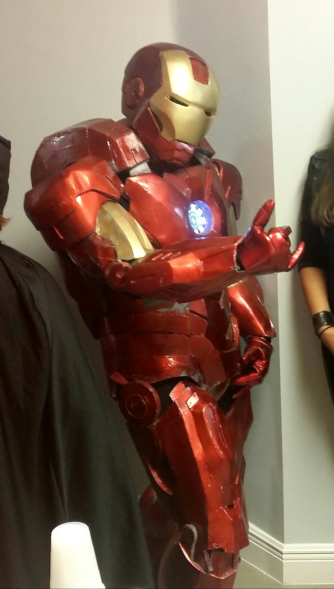

Can you tell me what you did to get it to look like that? I built a suit from glass and bondo but want to try foam and that piece looks amazing.
build in raw foam, seal it (there are loads of choices as sealant), black primer, then silver base coat, then candy red, then used dmg look with black and brown tones. dry brush silver on certain edges and then clear cloat for finish

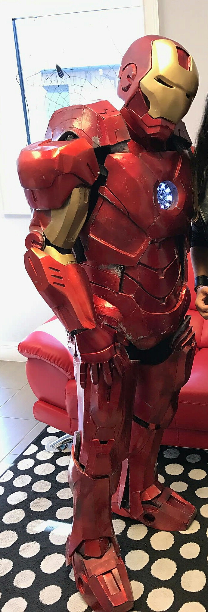

i know not many post here anymore but this is where i started my journey so i thought i could update. made some modifications to my suit, rebuilt the lower half out of foam. just wanted to post and maybe get some feedback on what or how i could improve it even further. any advice would be appreciated. thanks 20161101_135257[1].jpg20161103_051411[1].jpg

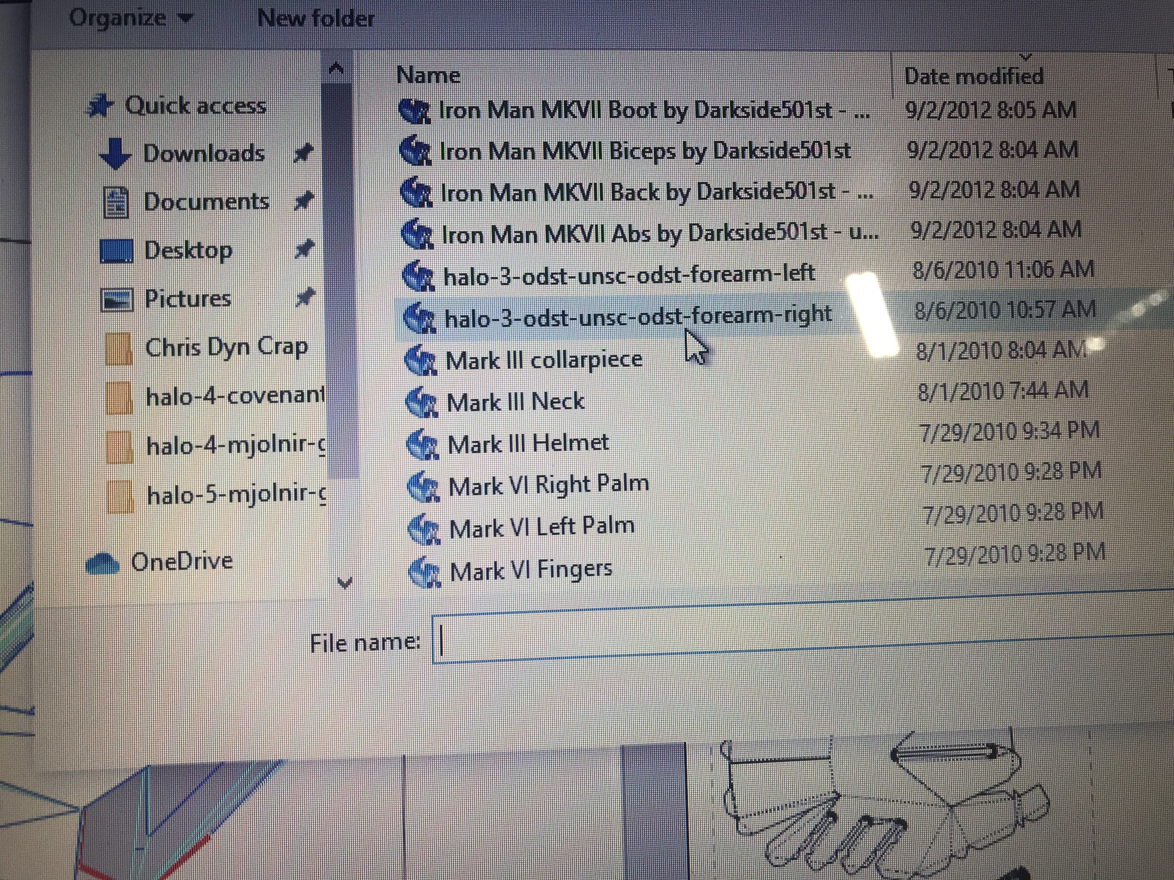

hey I'm using your files to create iron man mark 7 armor and I am confused if the iron man MKIII and MKVI named files are just modified for MKVII my main concern is the palm link doesn't work that you modified
I just got into cosplay and stuff if you could post a new link I would appreciate it a lot hope to hear ASAP. Here is a picture if you don't know what i mean. Thanks!

I have no idea its not my file the computer is shared. Thanks for the info I just saw the design was more simple. My palm part is in 3 different parts and that one was all in one. It looks easier to build that one then the current one any tips for me?

Is that supposed to be the Iron-man mk7 palm? Nothing about that resembles the Iron-man palm. Search within the forum for the appropriate file.
Look for Zabana, he is the artist who created the file for the gauntlet.
Ask for the file but be sure to credit him for the file.
When I downloaded the file I got some miss matching Mark # files I noticed it really wasn't looking right any helpful tips like where I can download the correct files for these parts. I really appreciate the help. Thanks so much!
