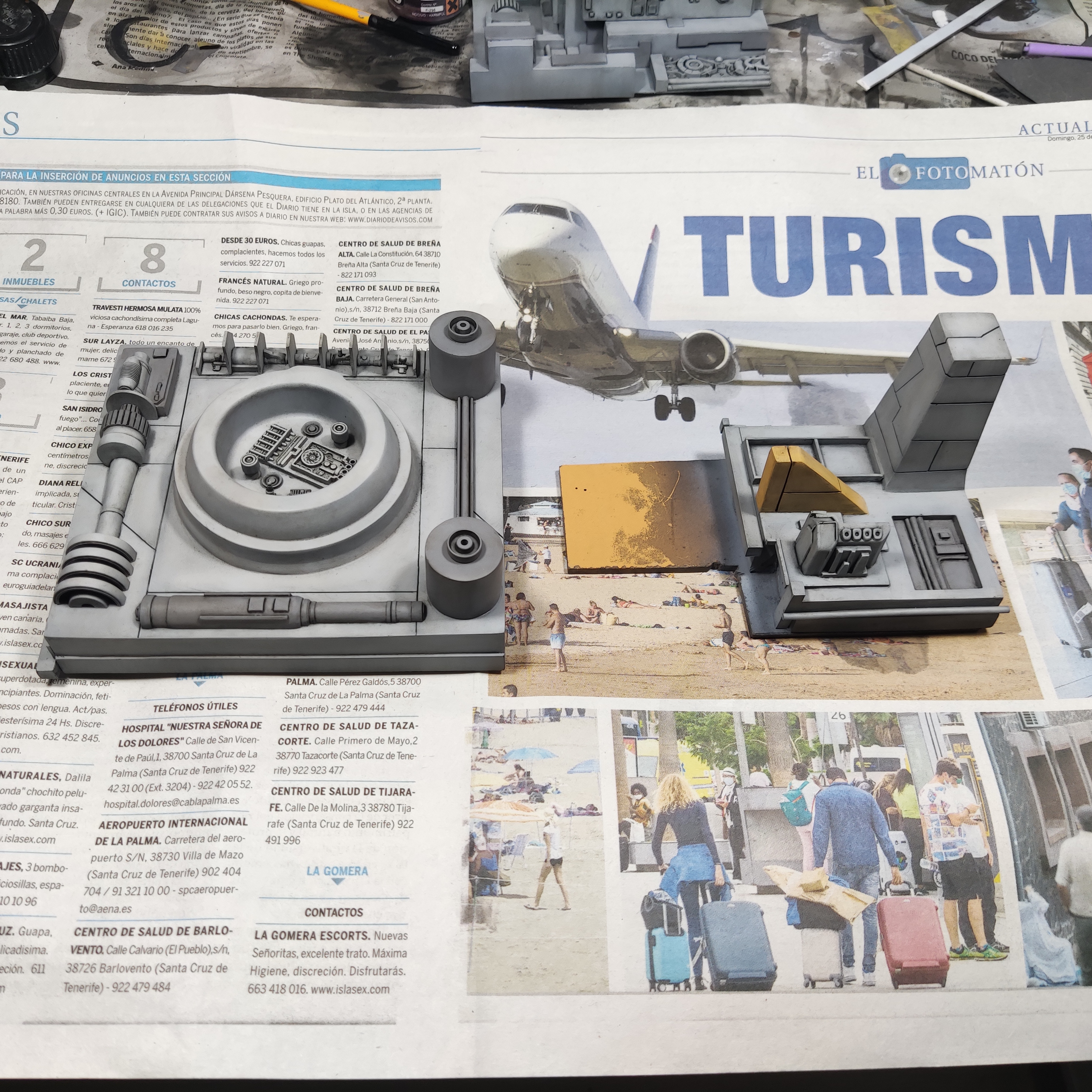

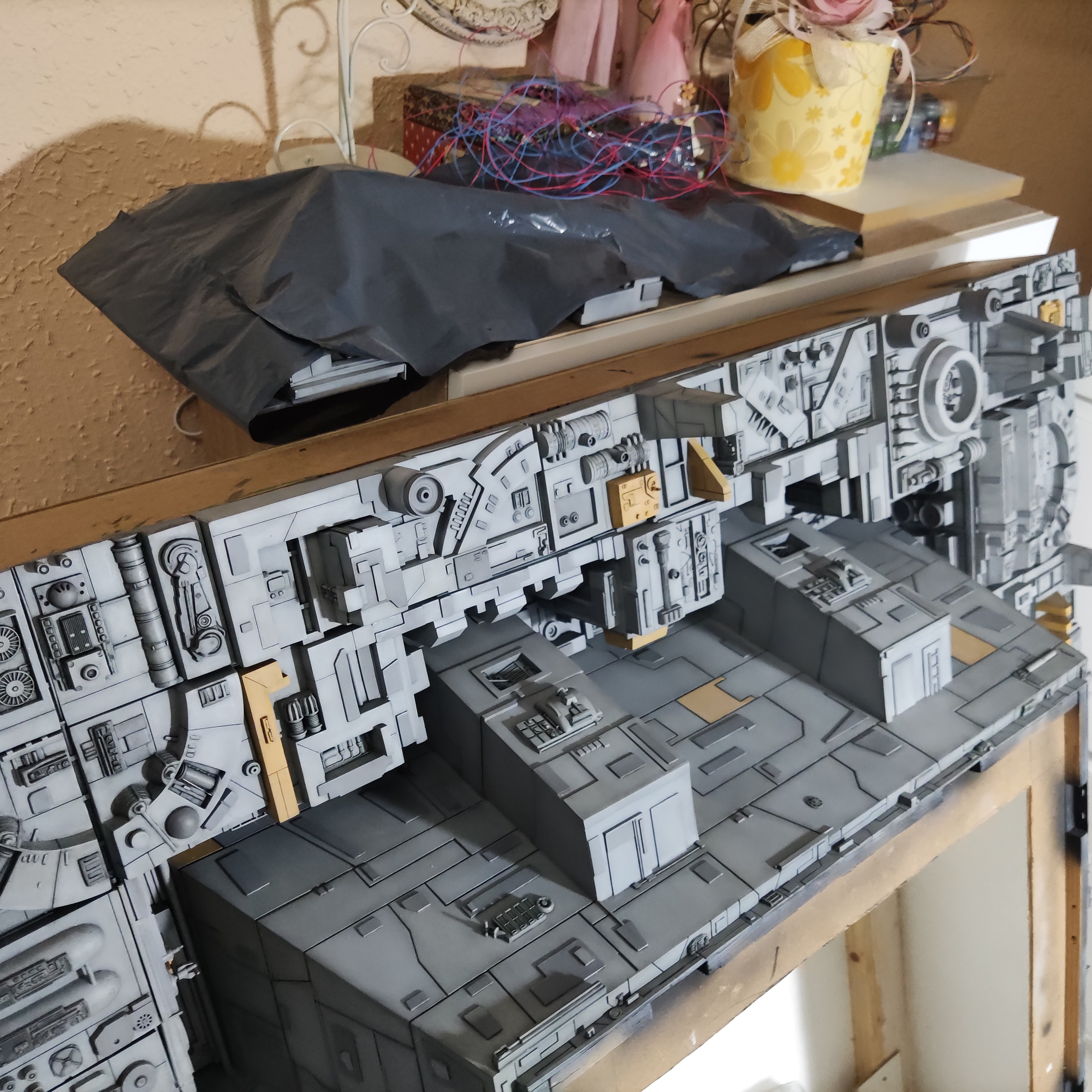

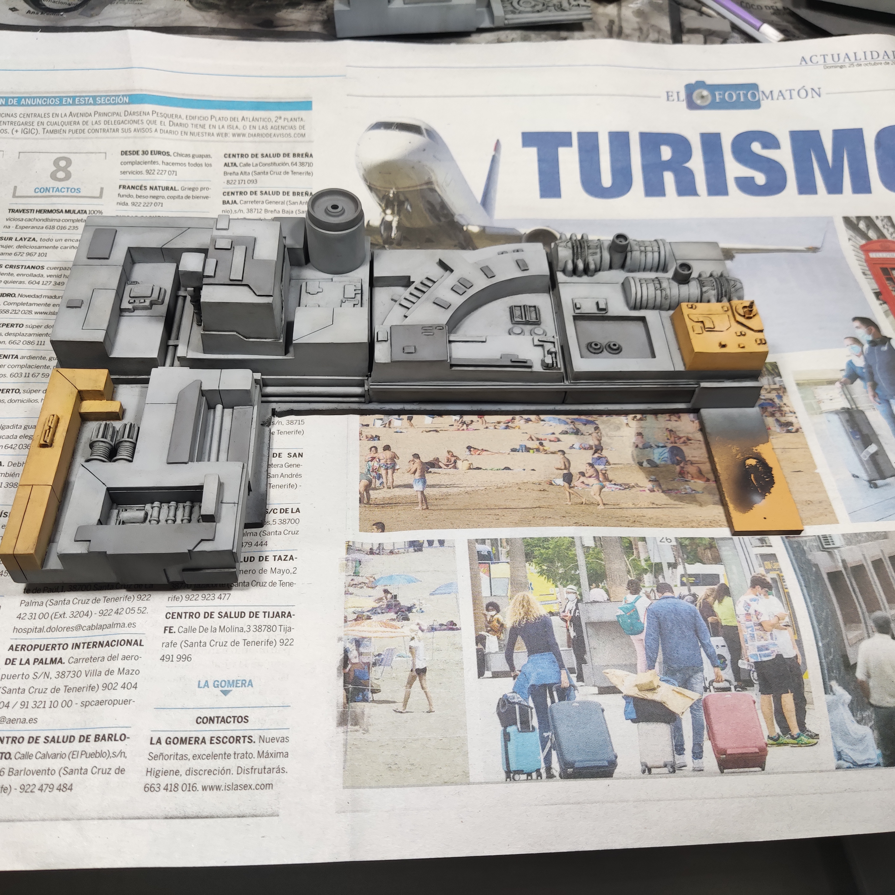

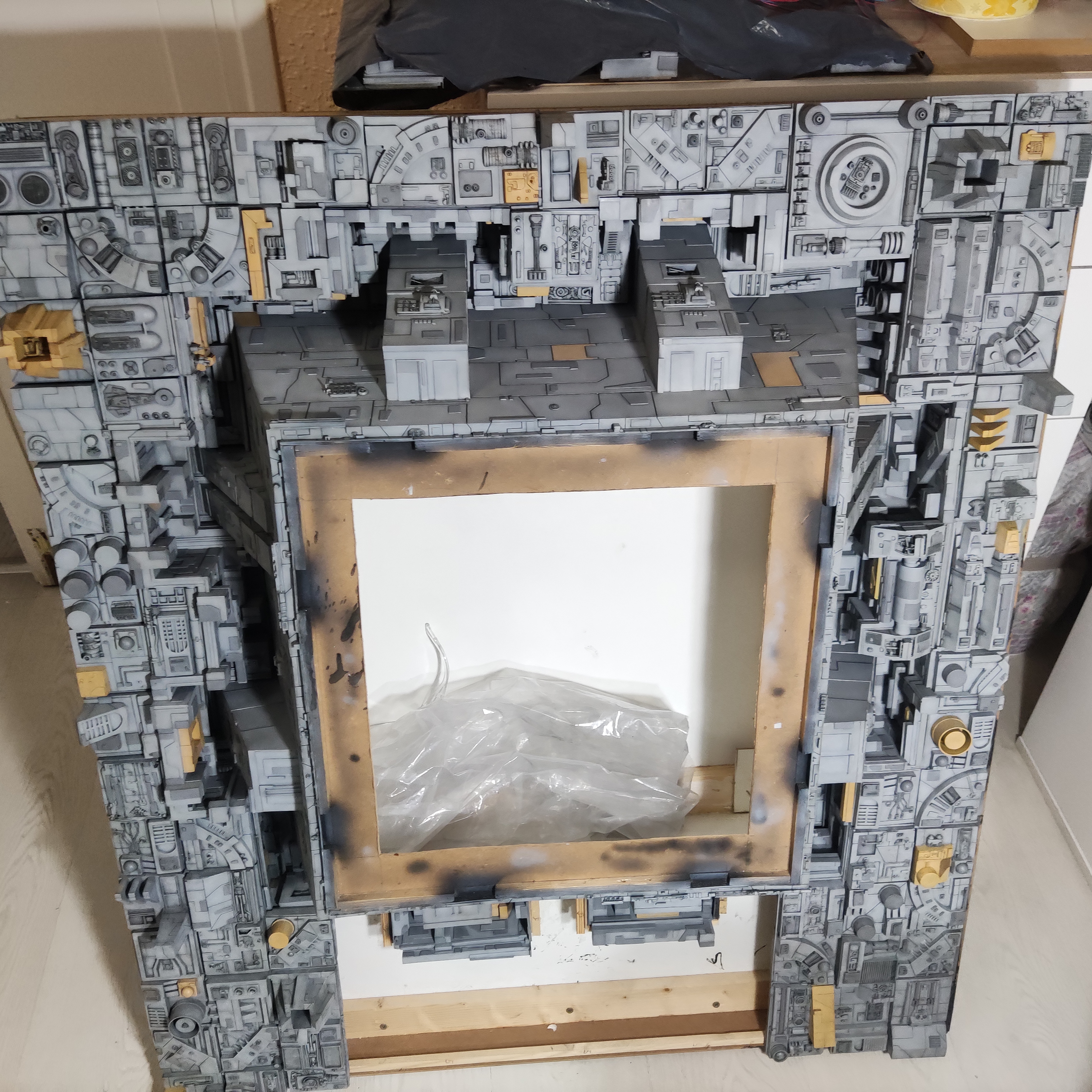

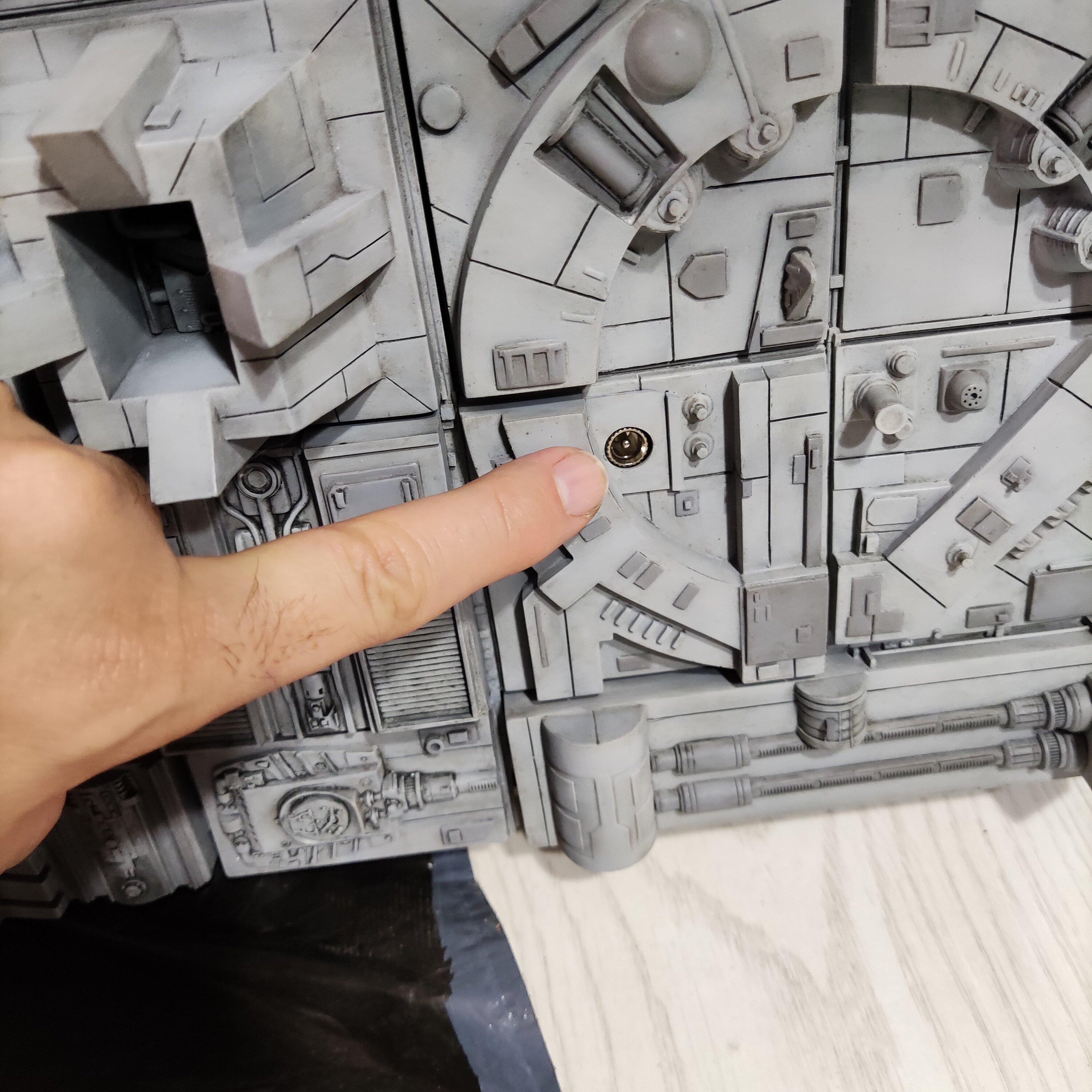

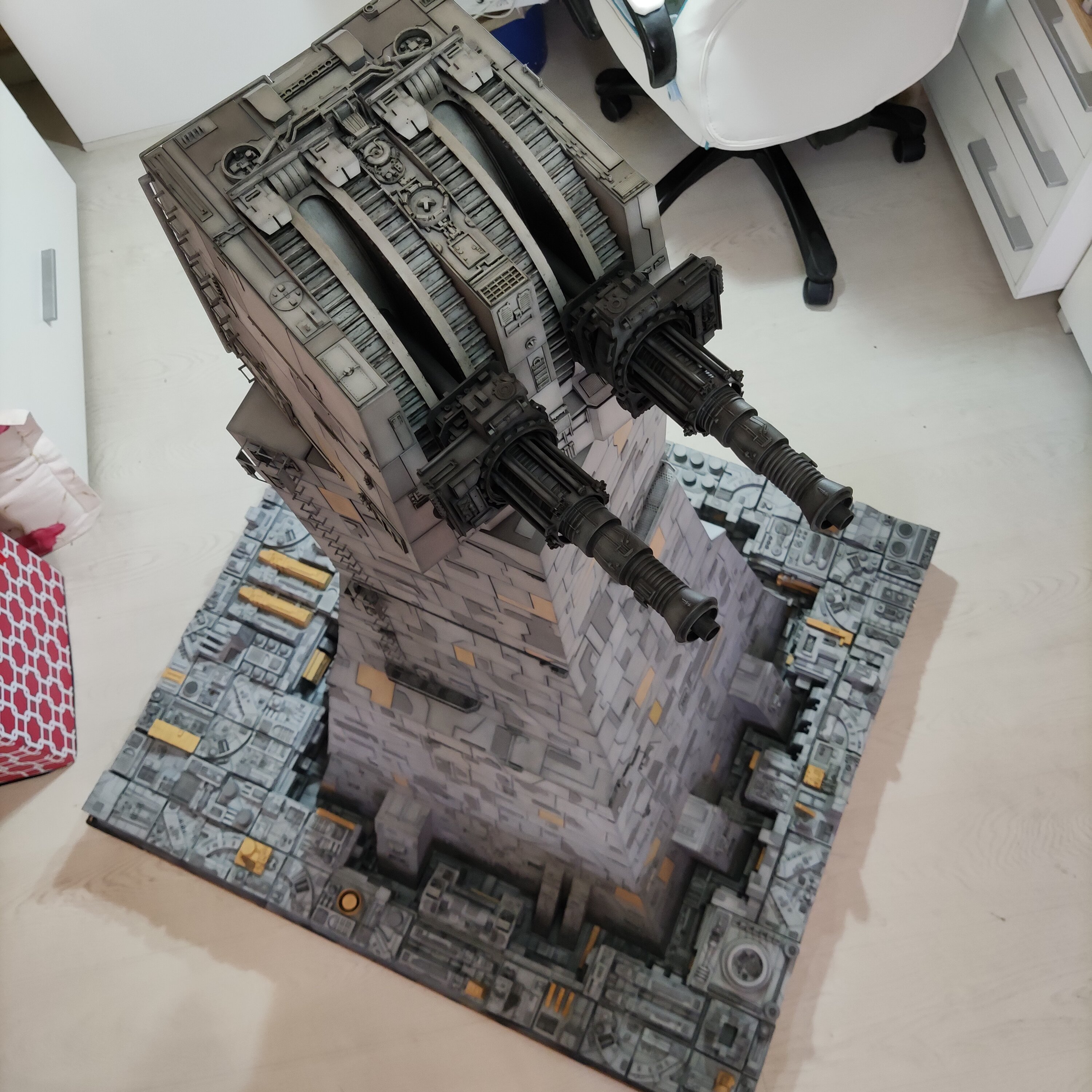

Well, all the modules are already in place!!, so technically the tower and surface is all finished.!. :D

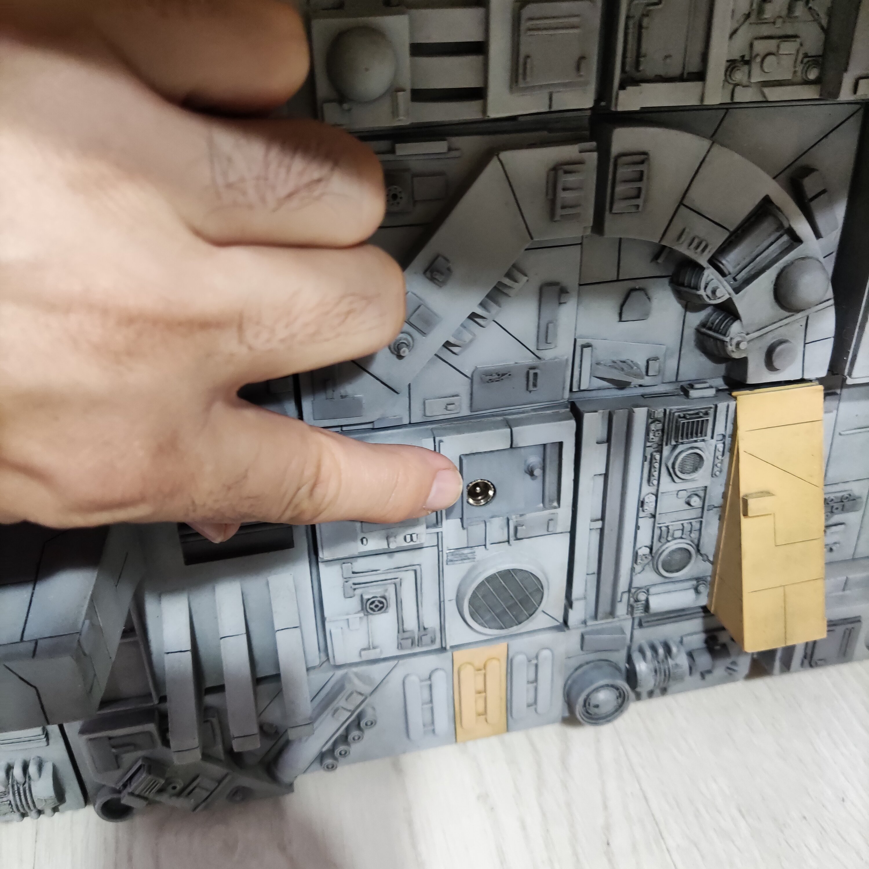

It only remains to place the lower module (already finished) once I solder the cables to the connections where the ships are located
All sides of the base will be covered with black plastic sheet
Thanks gedmanc66! :D

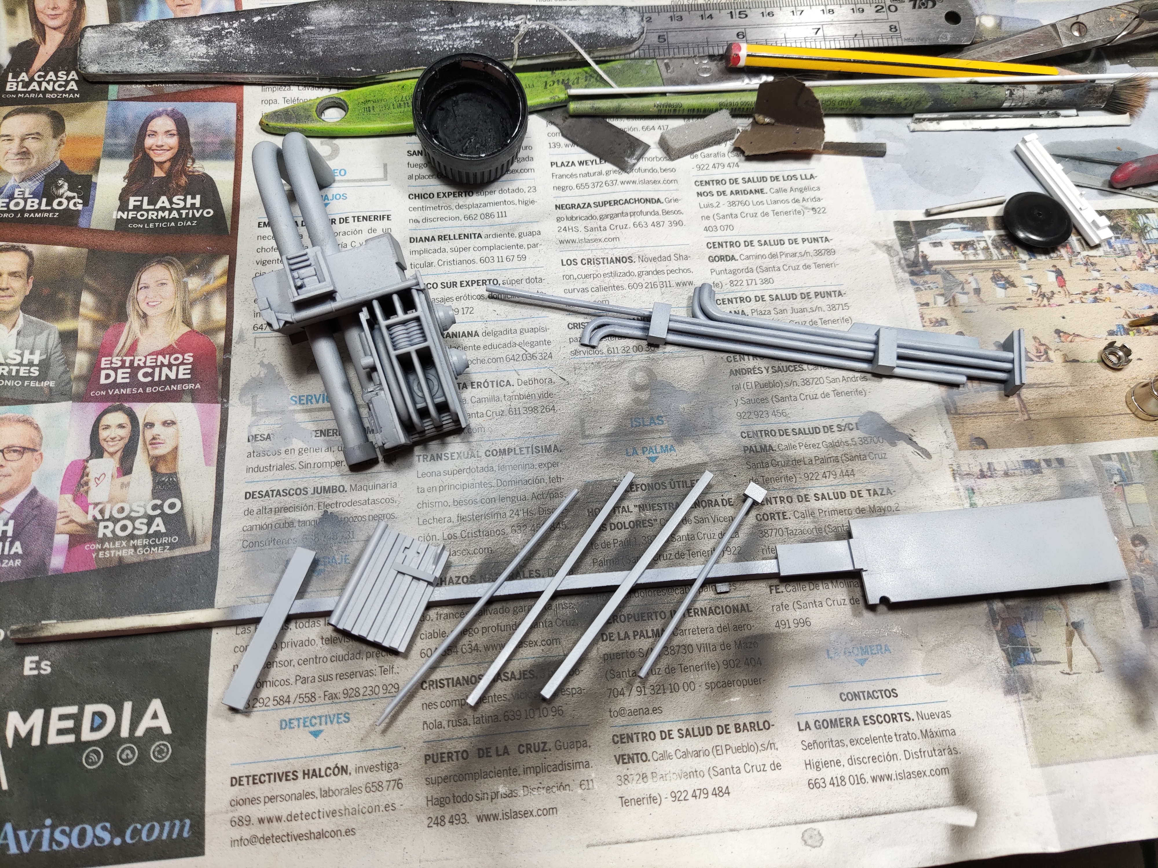

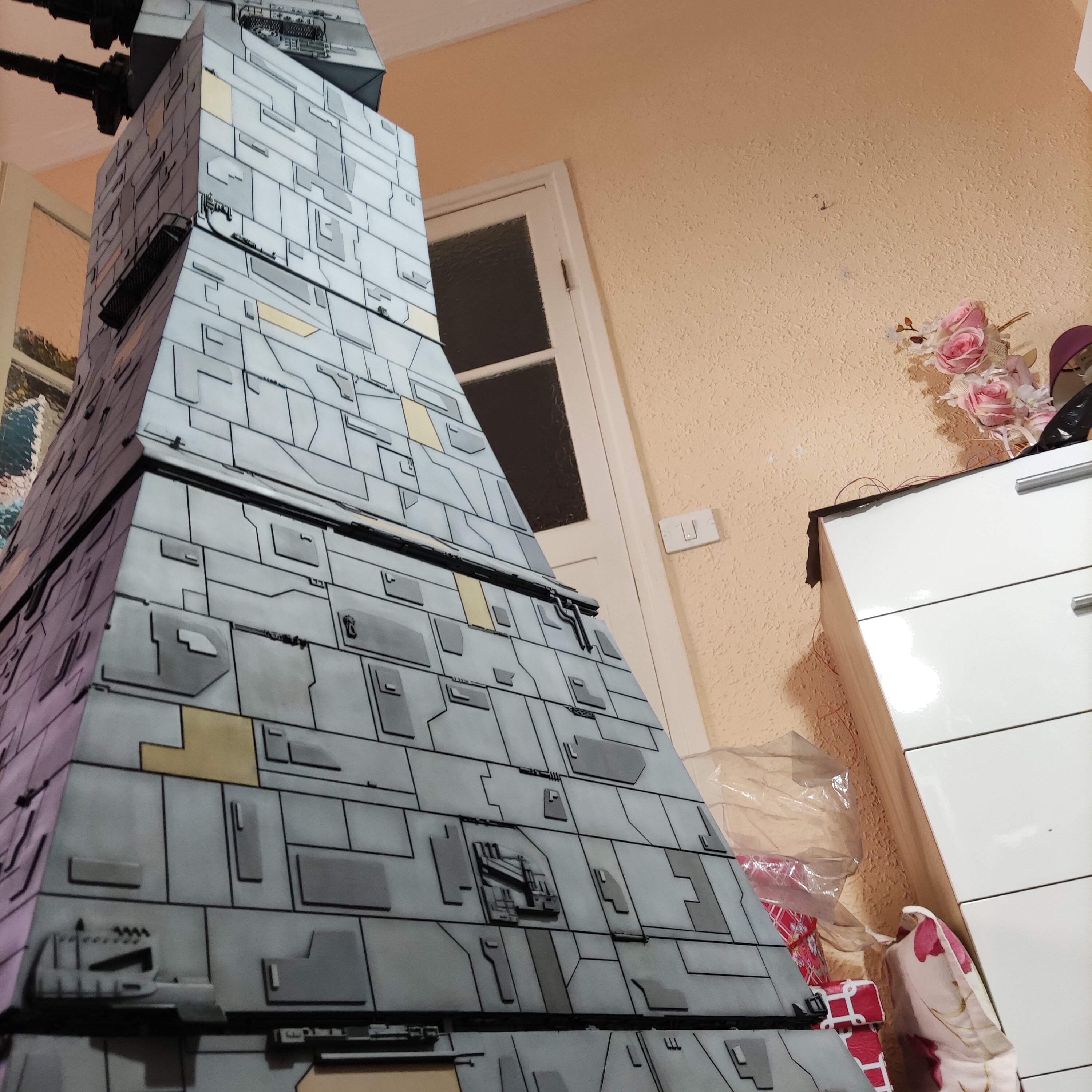

I will put photos all assembled next week. First I have paint and weather some pieces that must be assembled once everything is in place, because in the places they go they could break if they were attached to the large modules when i put them

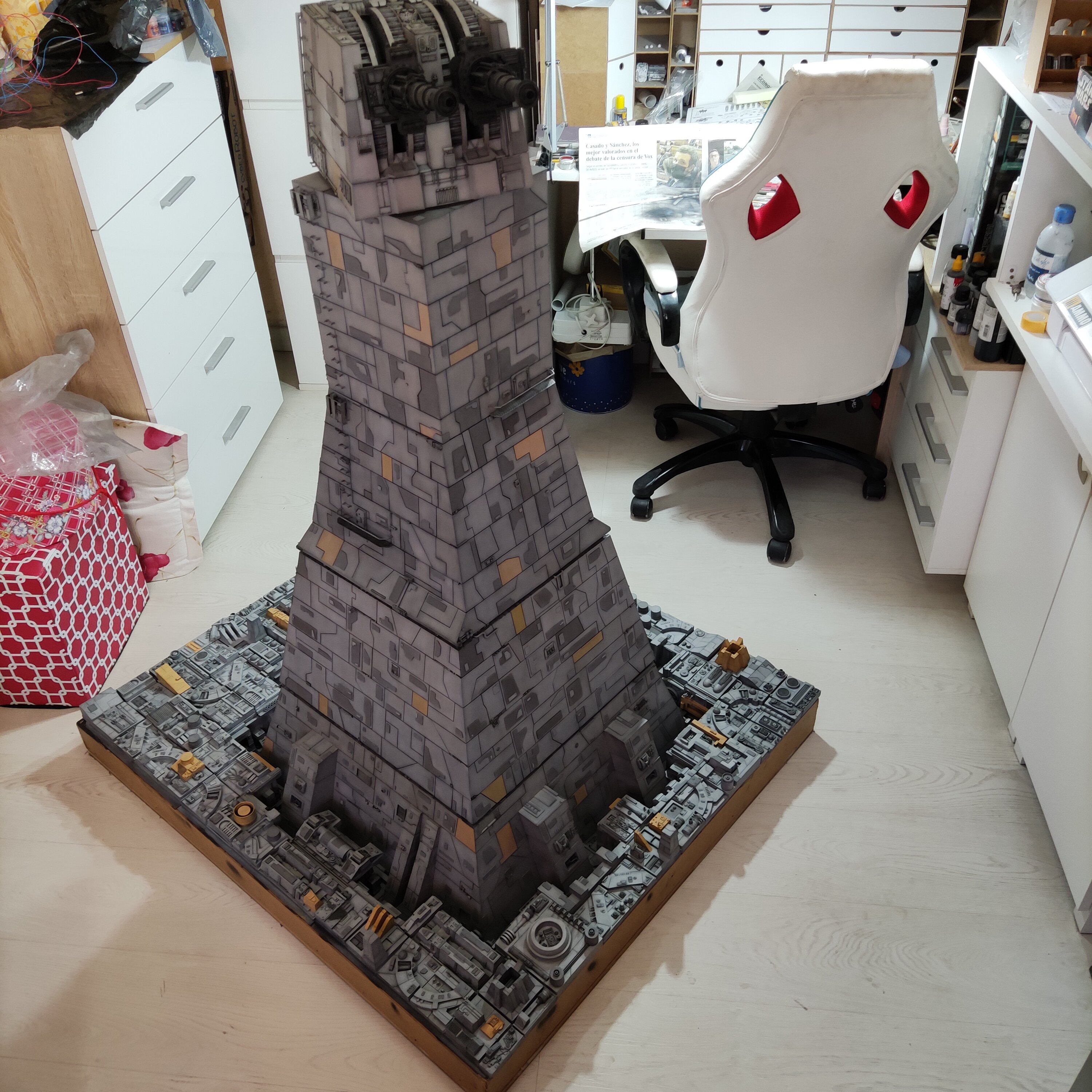

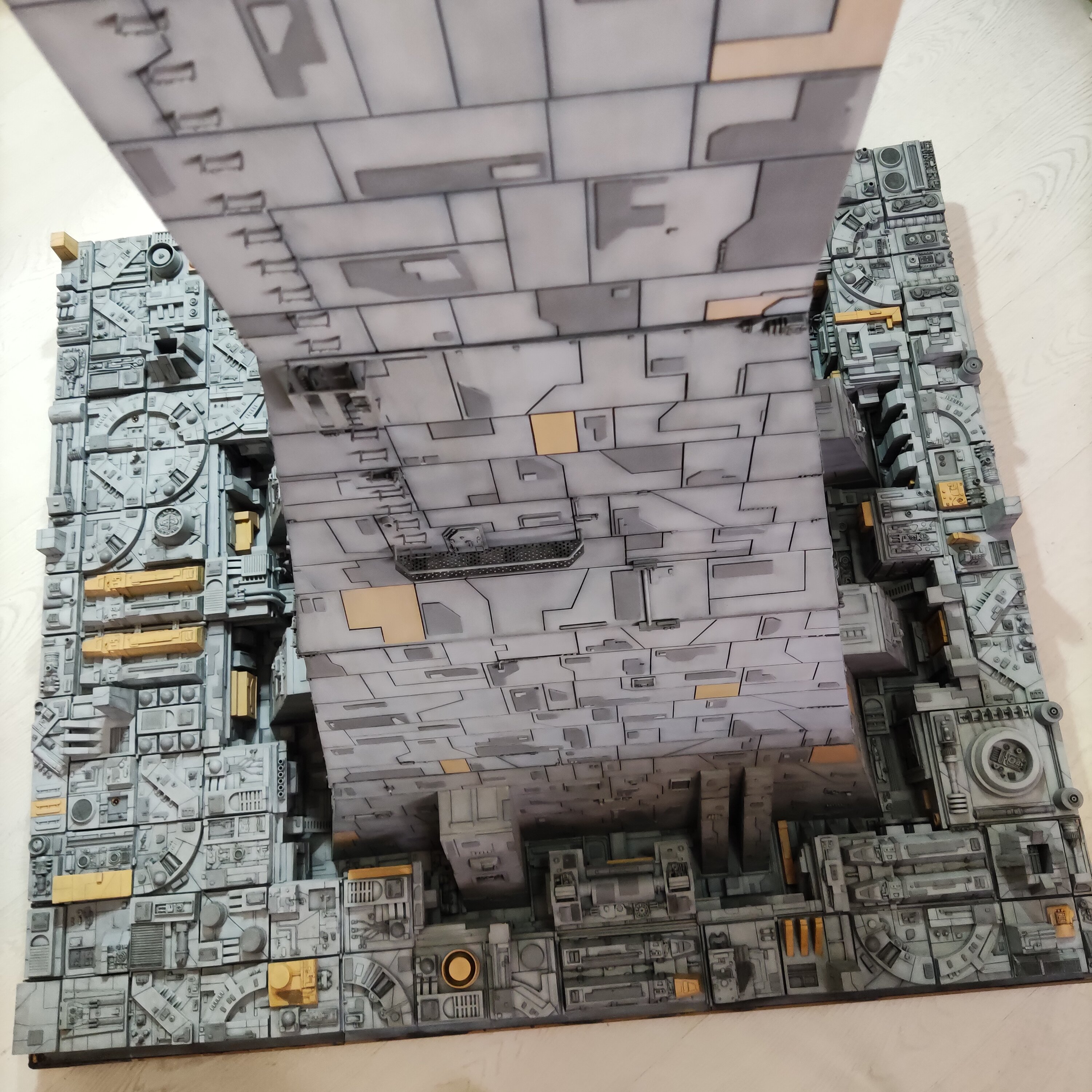

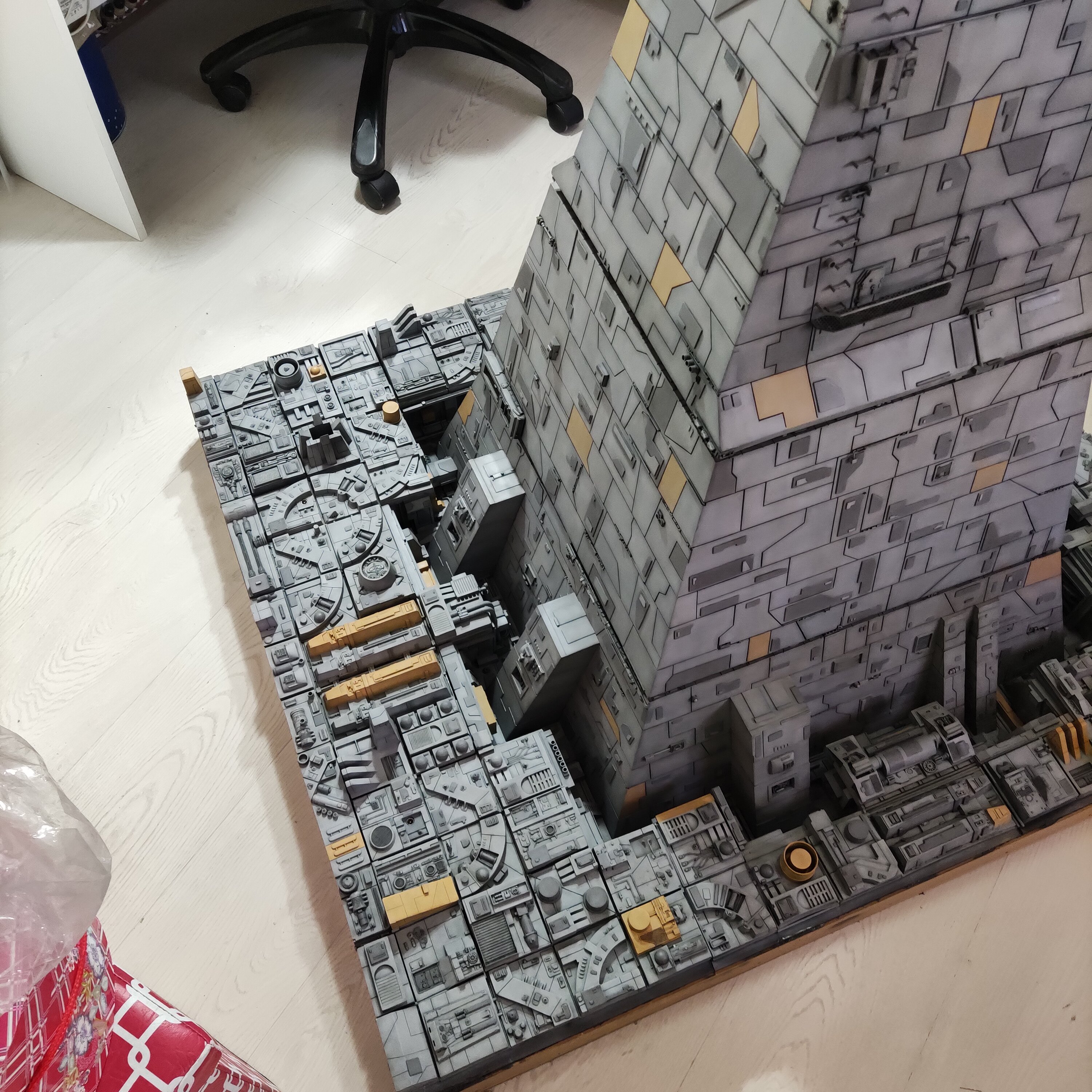

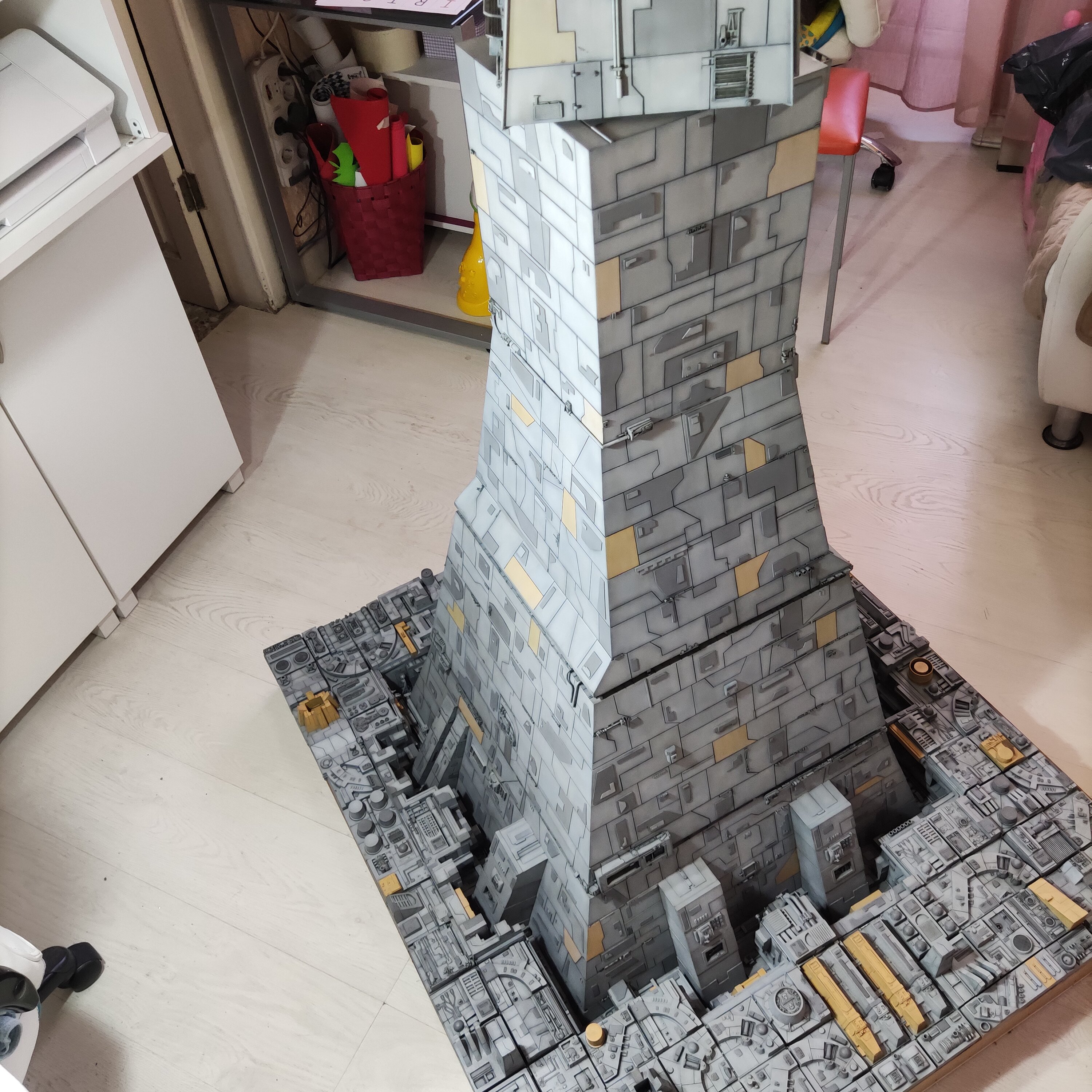

Finally, all the tower and surface is finish!!! :D:D:D
The only thing left is to put the LEDs in the small holes in each section of the tower, but that will be the last thing, after finishing and lighting the ships as well.
I also have already made the connections on the surface where the Ties Fighter would go

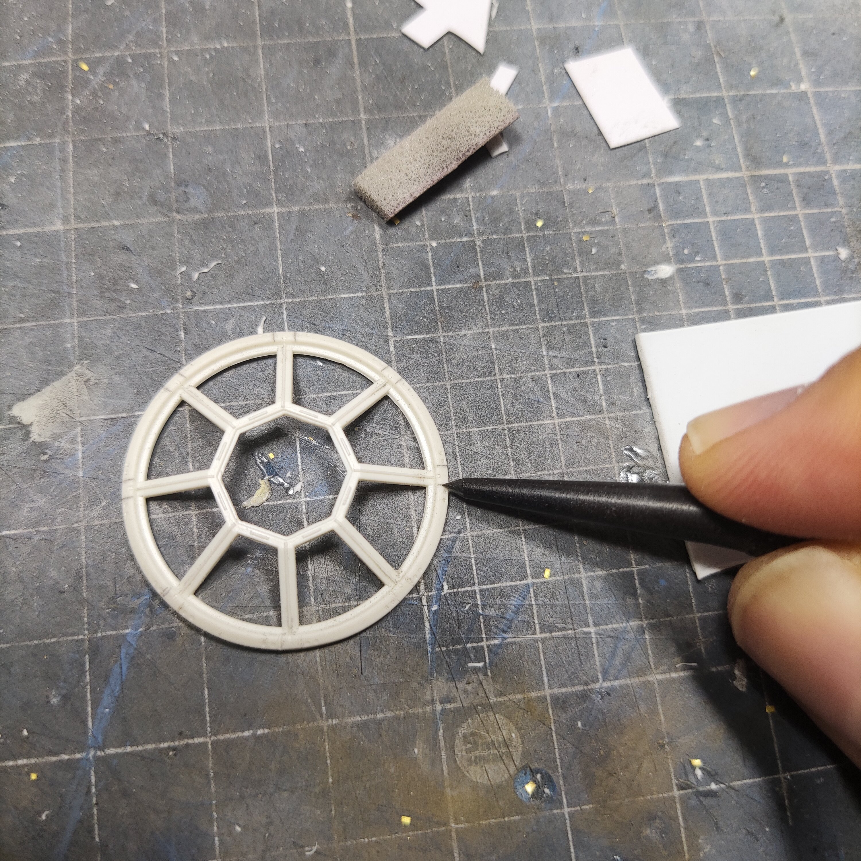

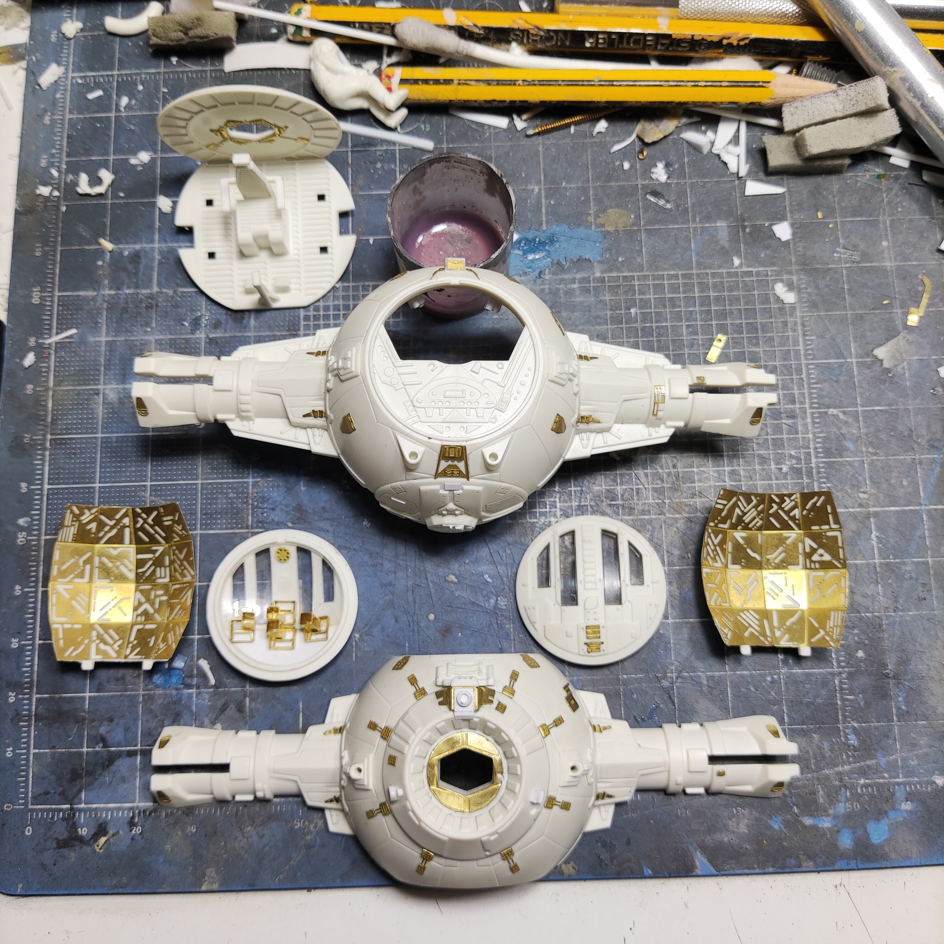

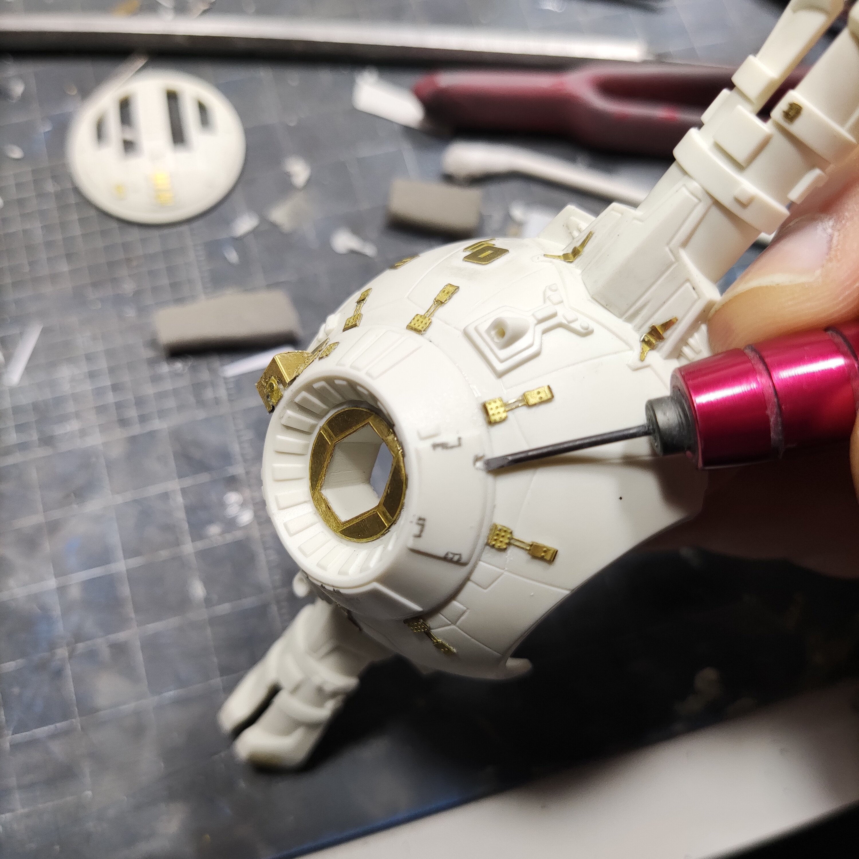

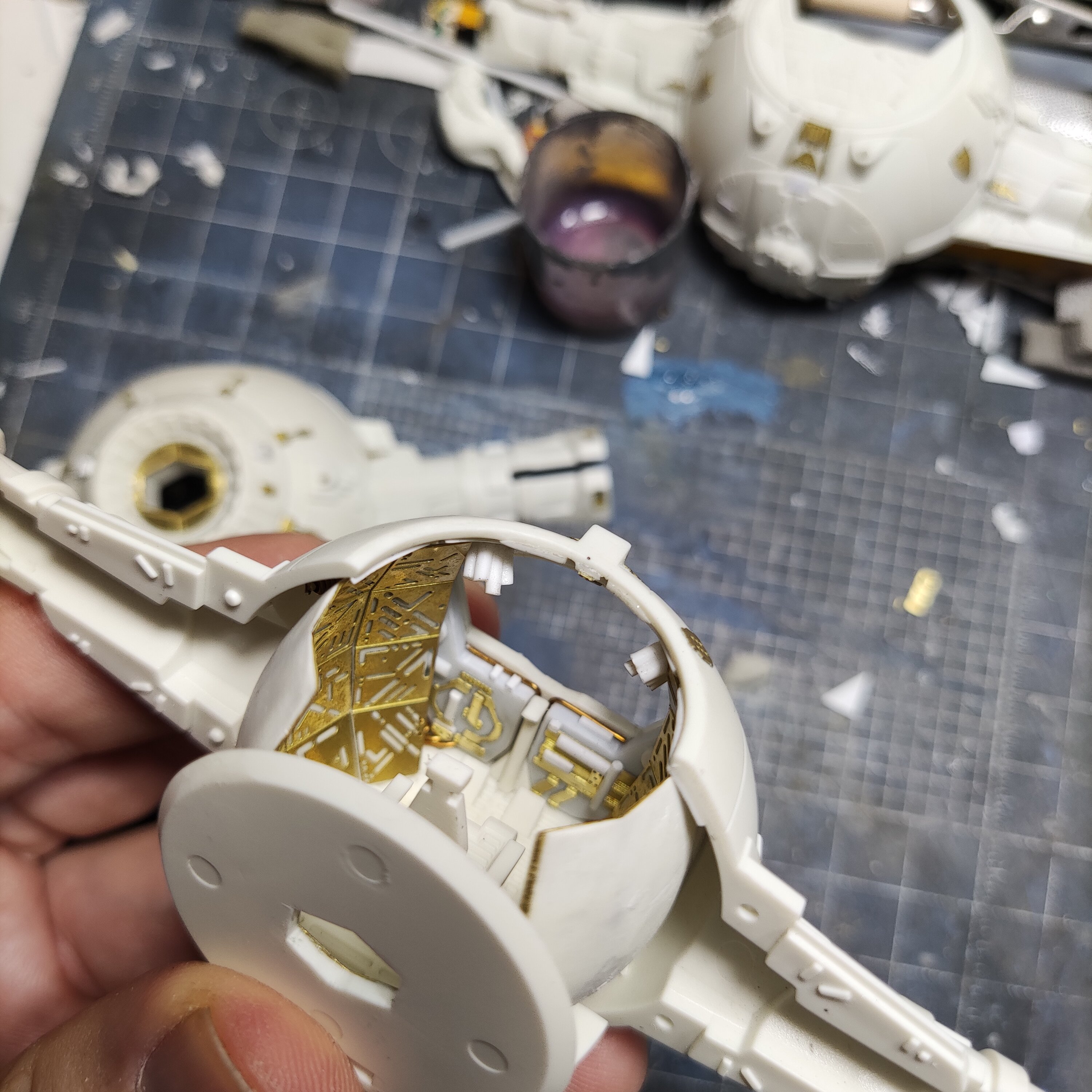

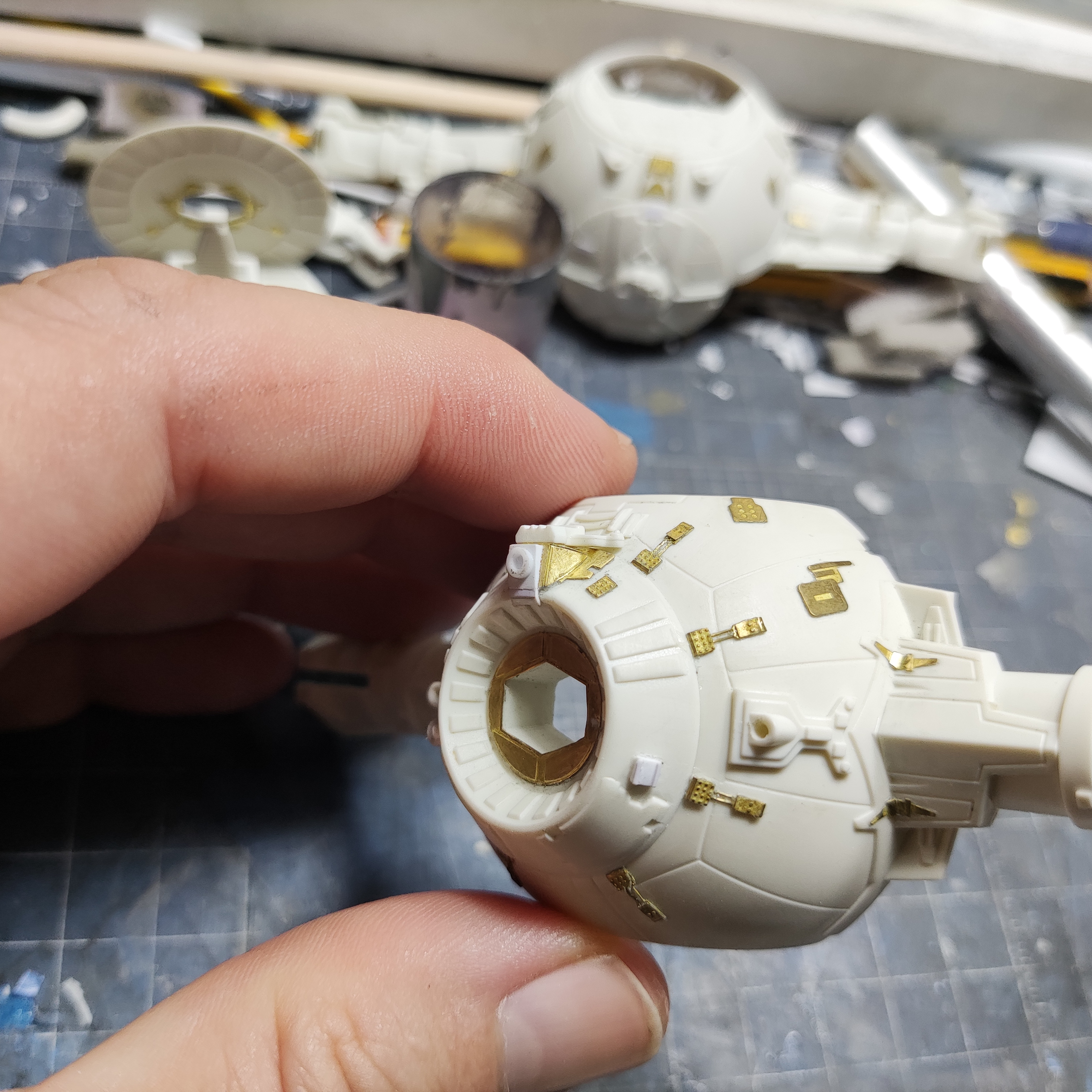

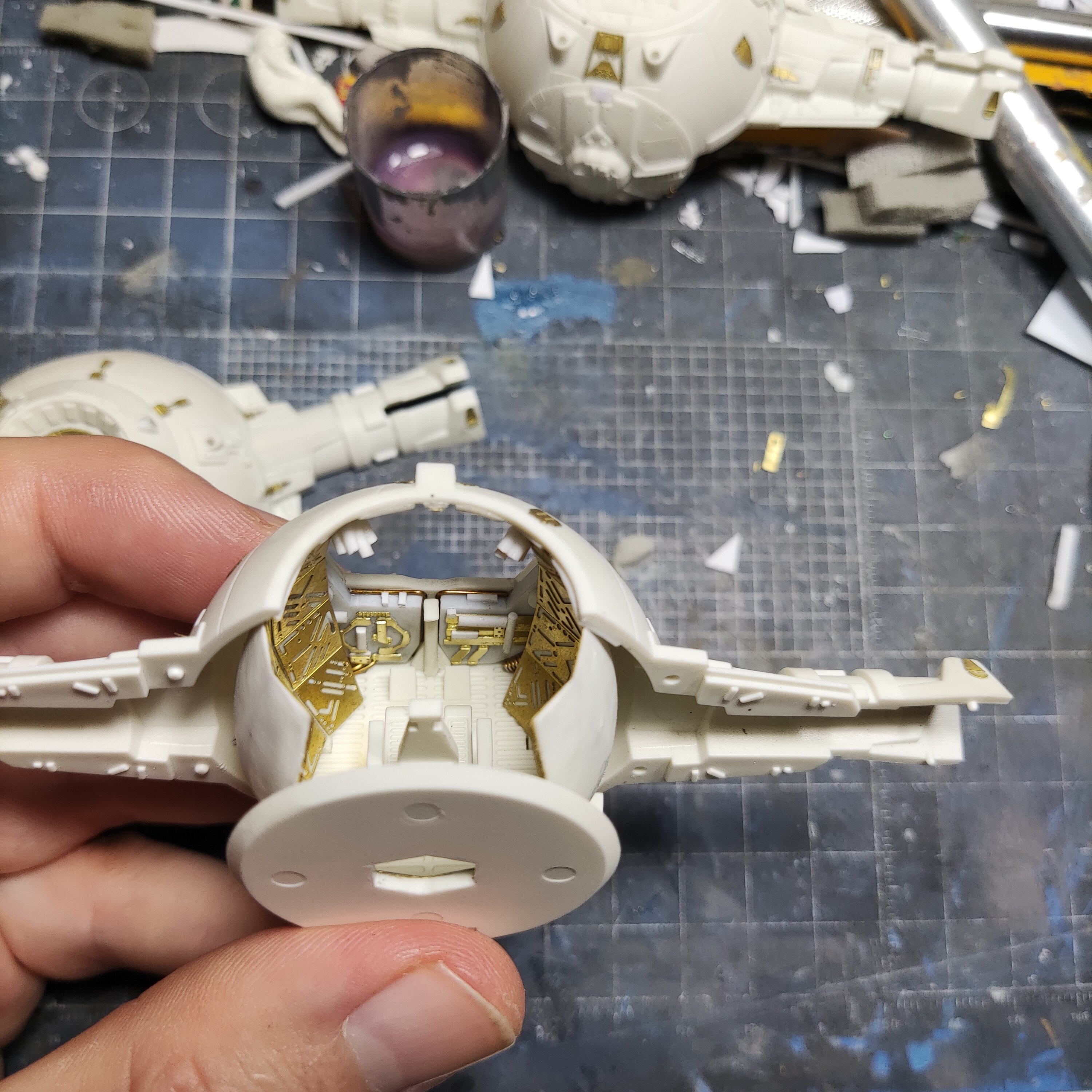

I have been working a lot on the TIES Fighters, they take a lot of work to make them more faithful to the original model.

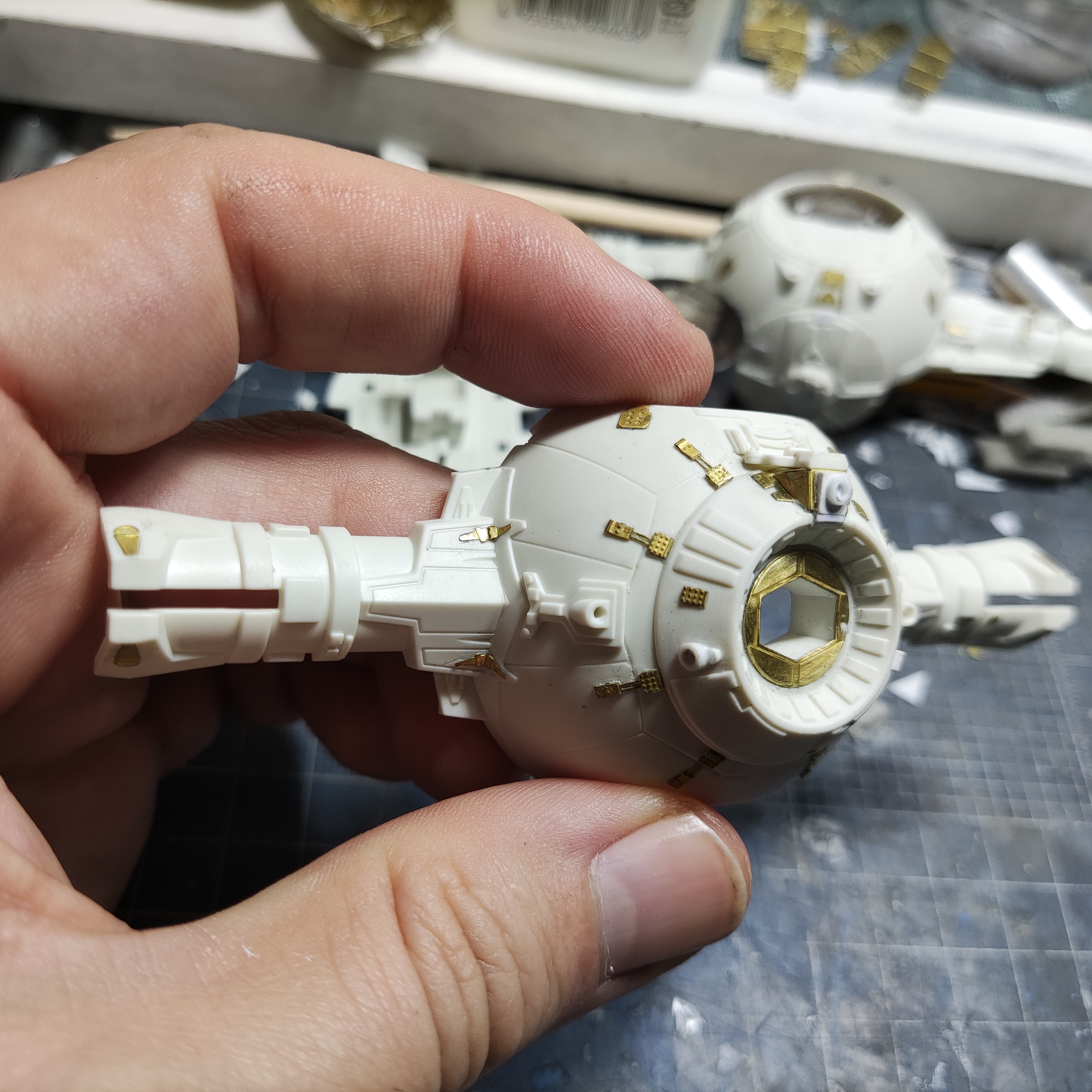

Photo-etched parts help a lot in the detail, but even so, I have had to make small pieces for details and vary in shape others of the model itself, which are made incorrect.
I will put photos soon, as soon as I have all the photo-etched in place. it's 2 TIES Fighters, so the work is double.

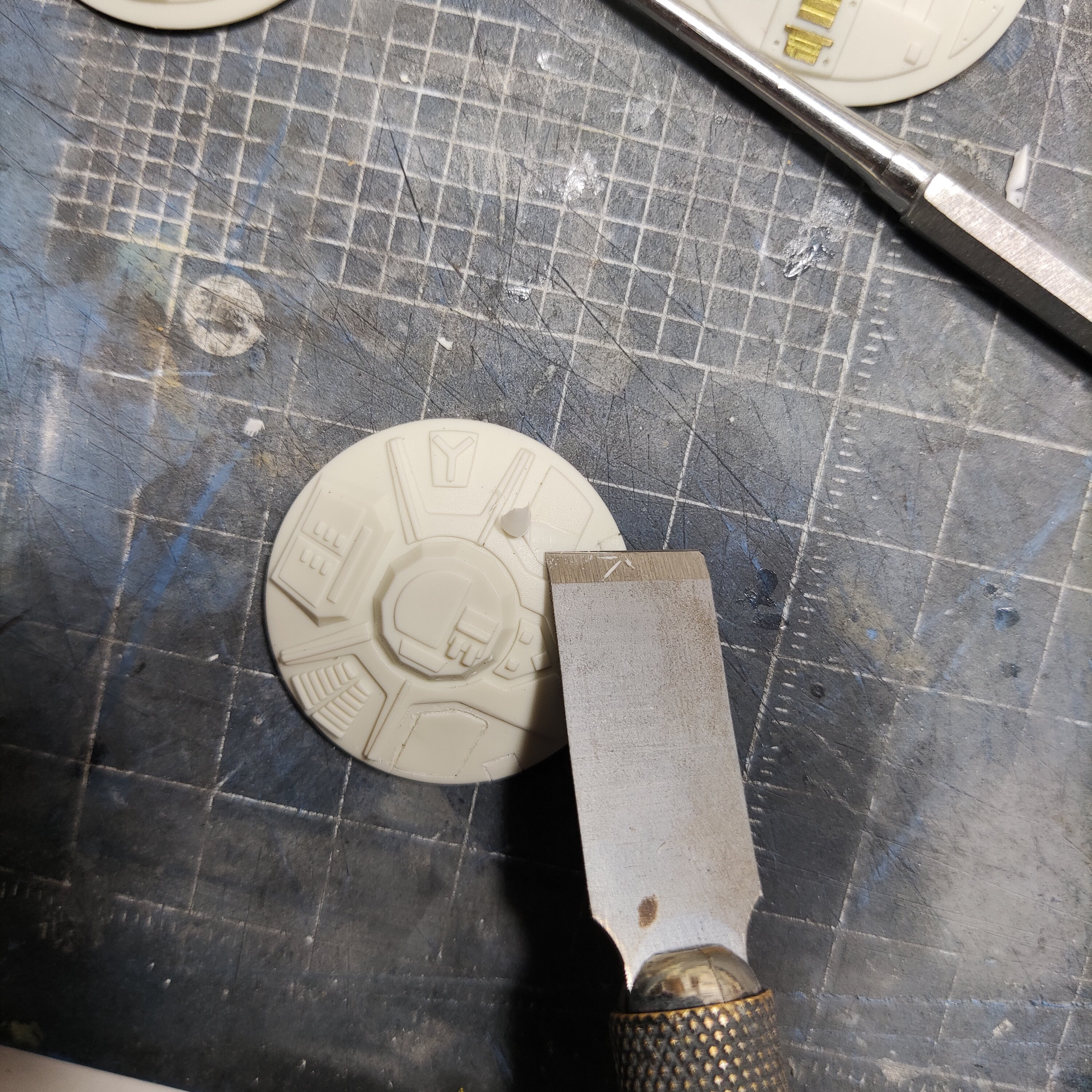

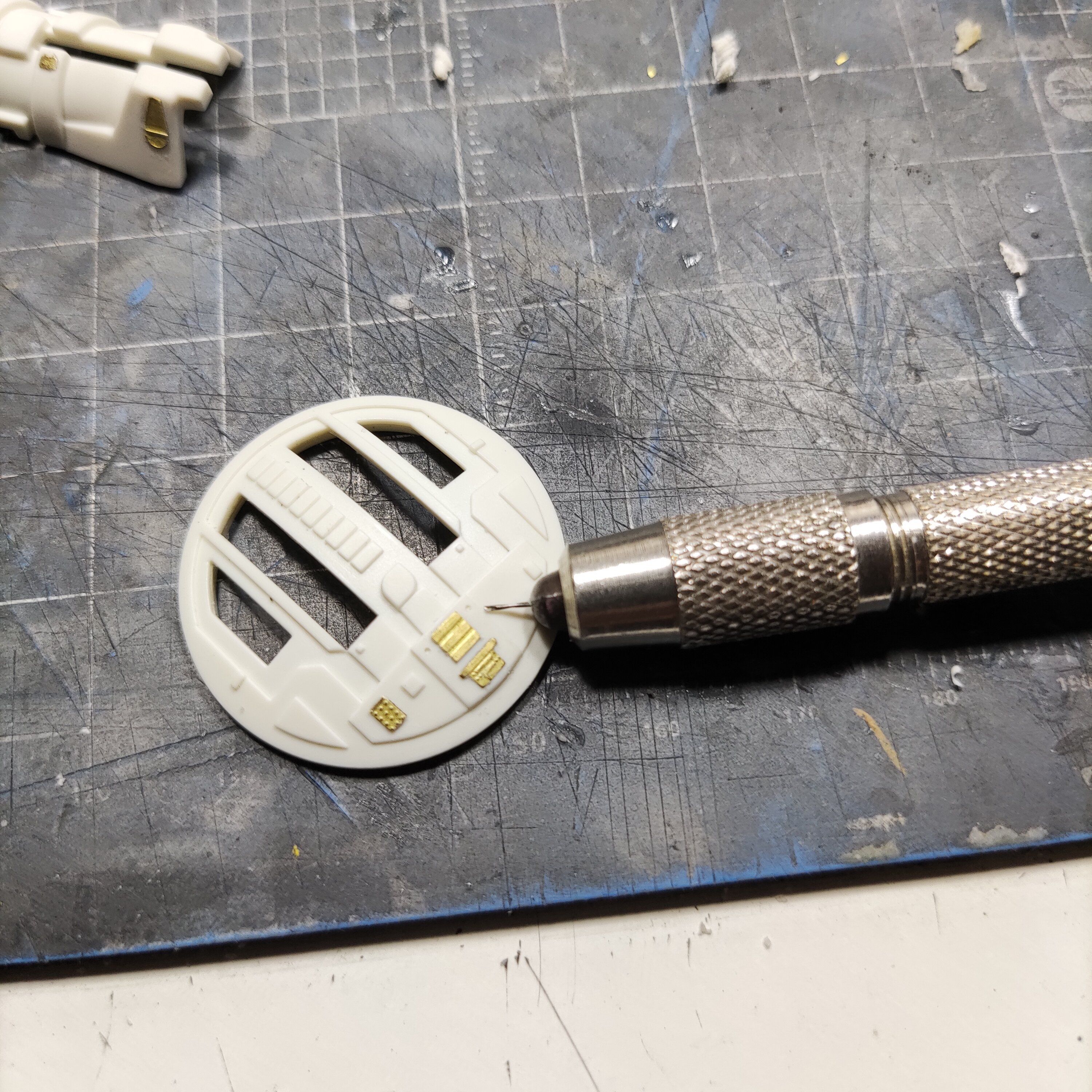

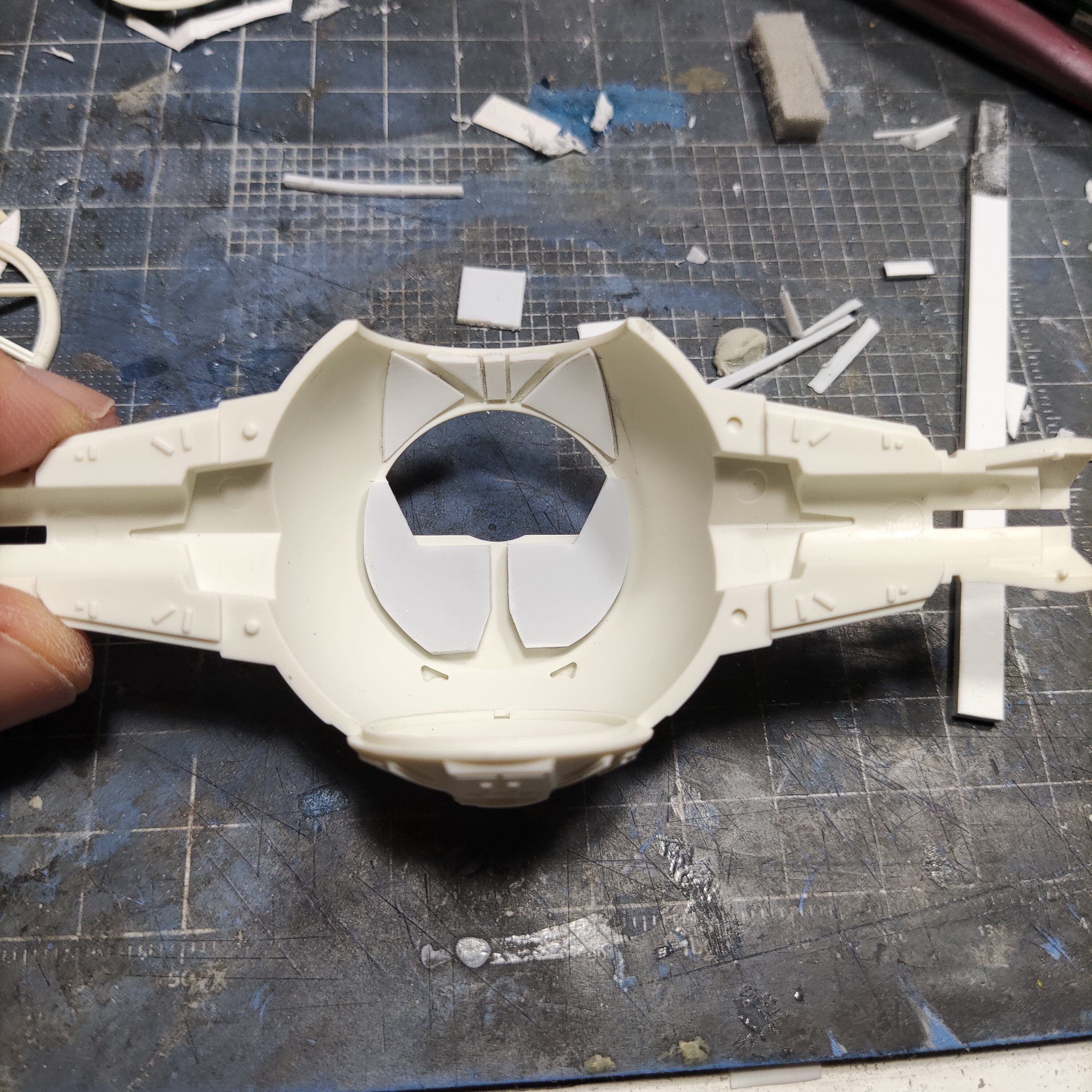

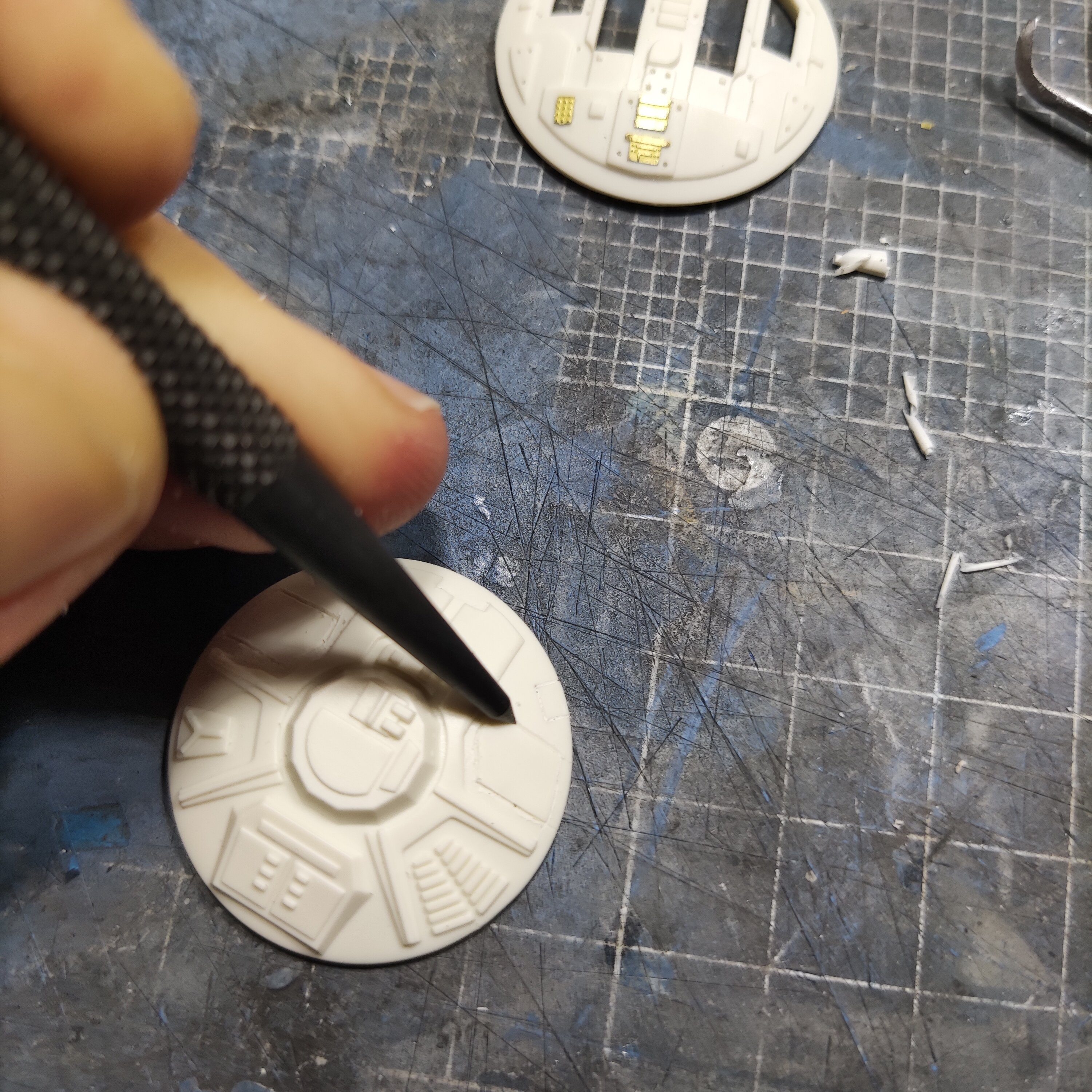

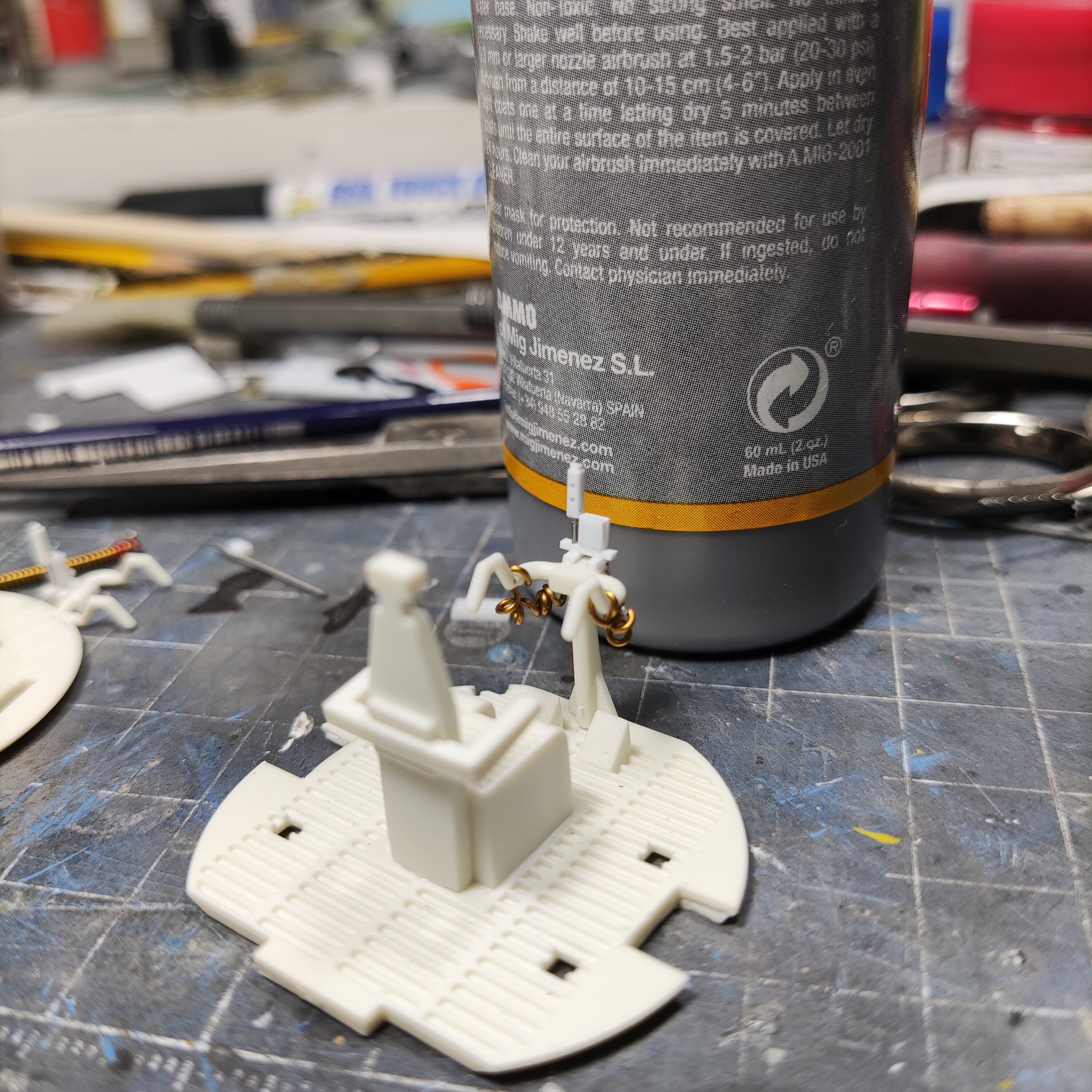

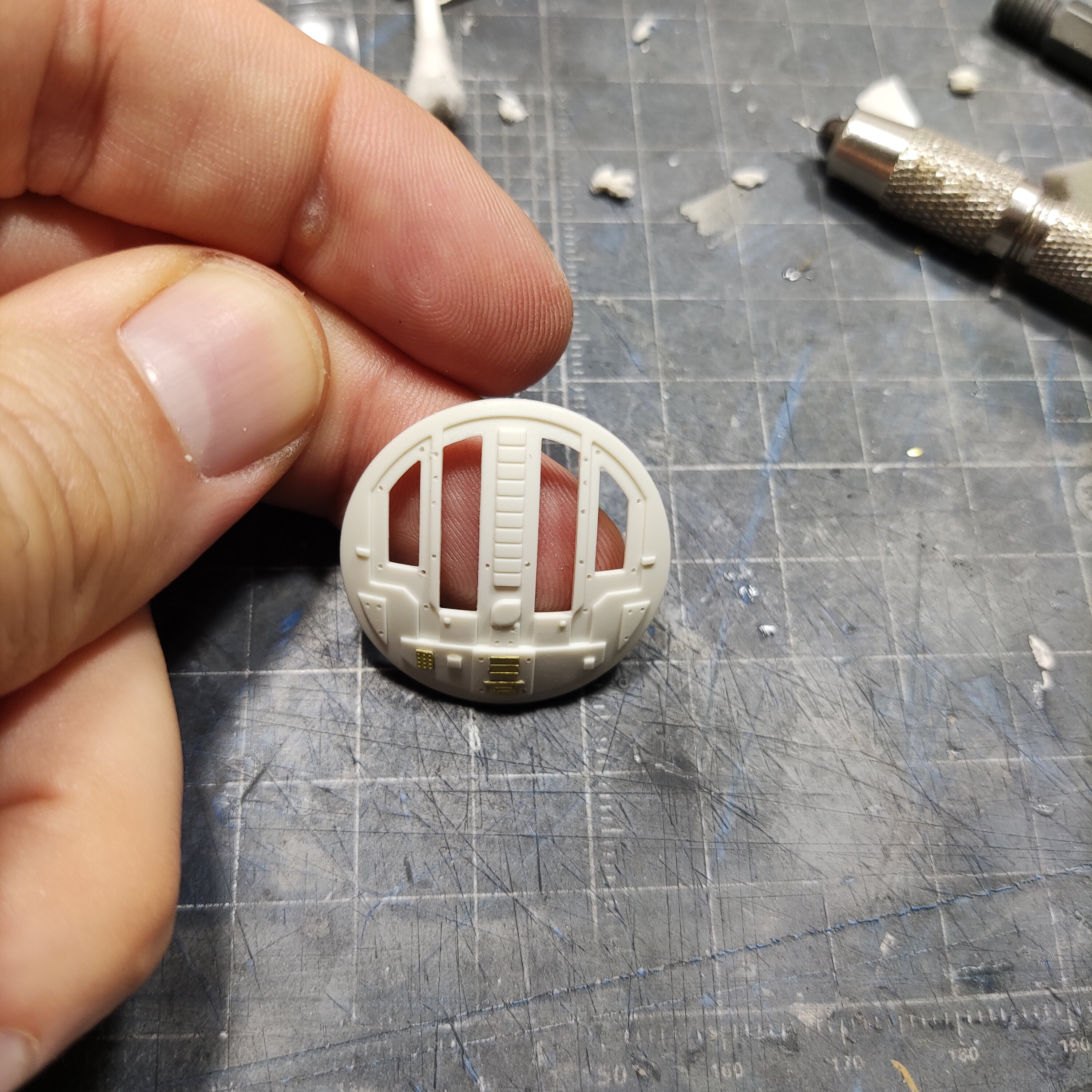

The work on the TIES has consisted of making small holes (0.3 mm) in the fuselage that the original model had, placing photo-etching, making shapes with a punch in some pieces, paneling lines and sanding some panels that were dimensioned and are flat in the original model. I have also had to make some small pieces in plasticard of which the model lacked.
I have had to do all this 2 times, since there are 2 TIE fighters

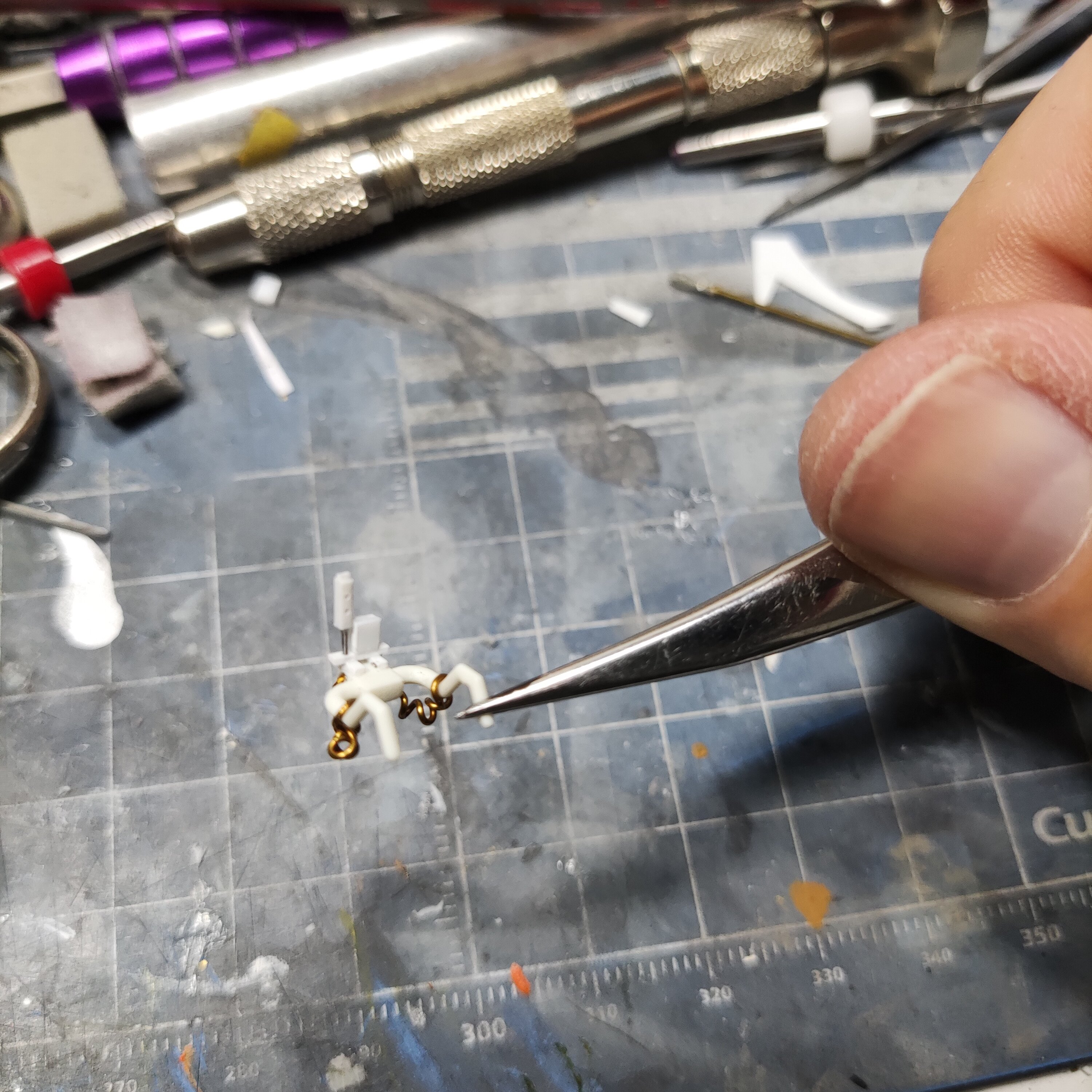

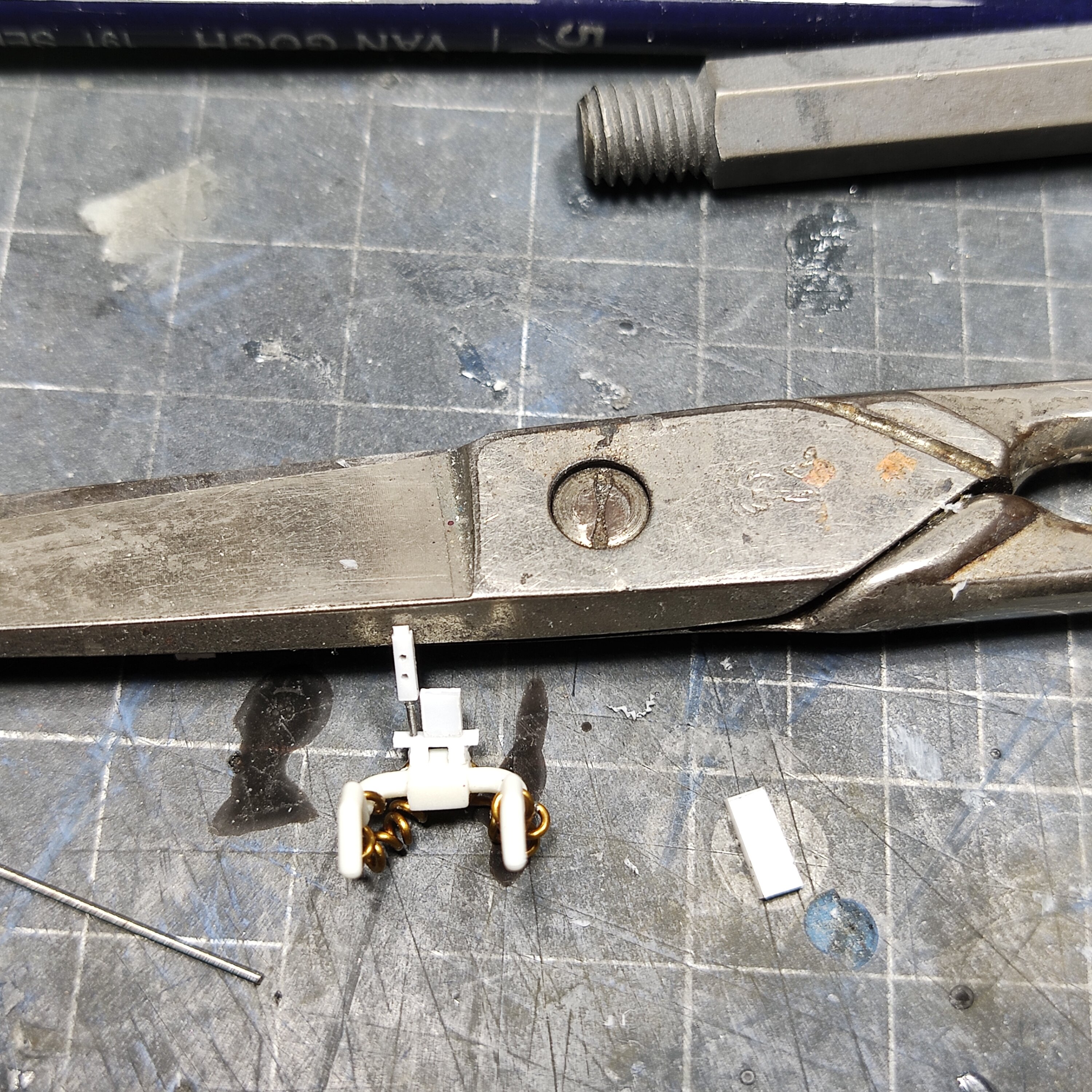

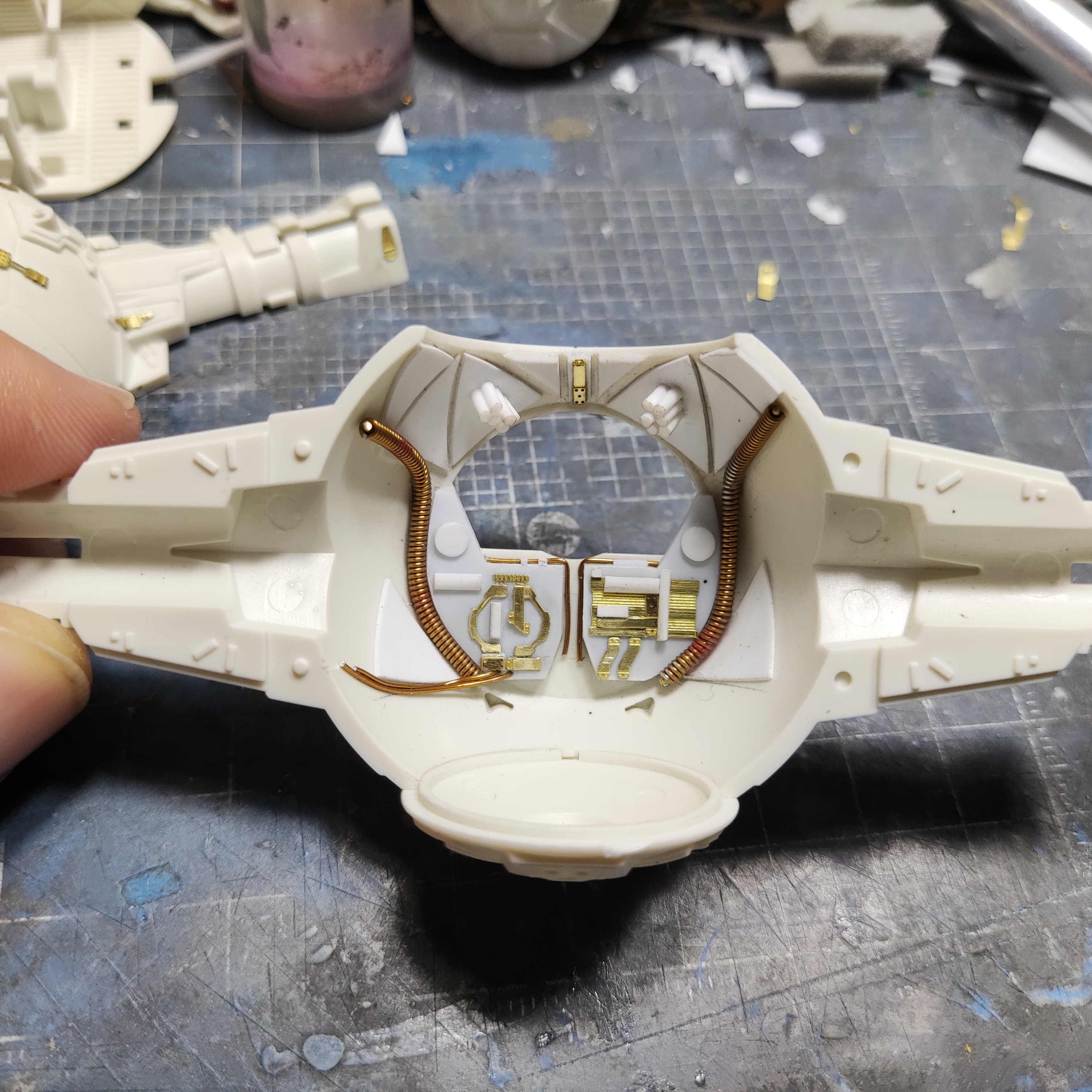

In the cockpit I have taken the liberty of making it to my liking, since in the movie you never saw the front panel. I still have to detail the pilot control joysticks
