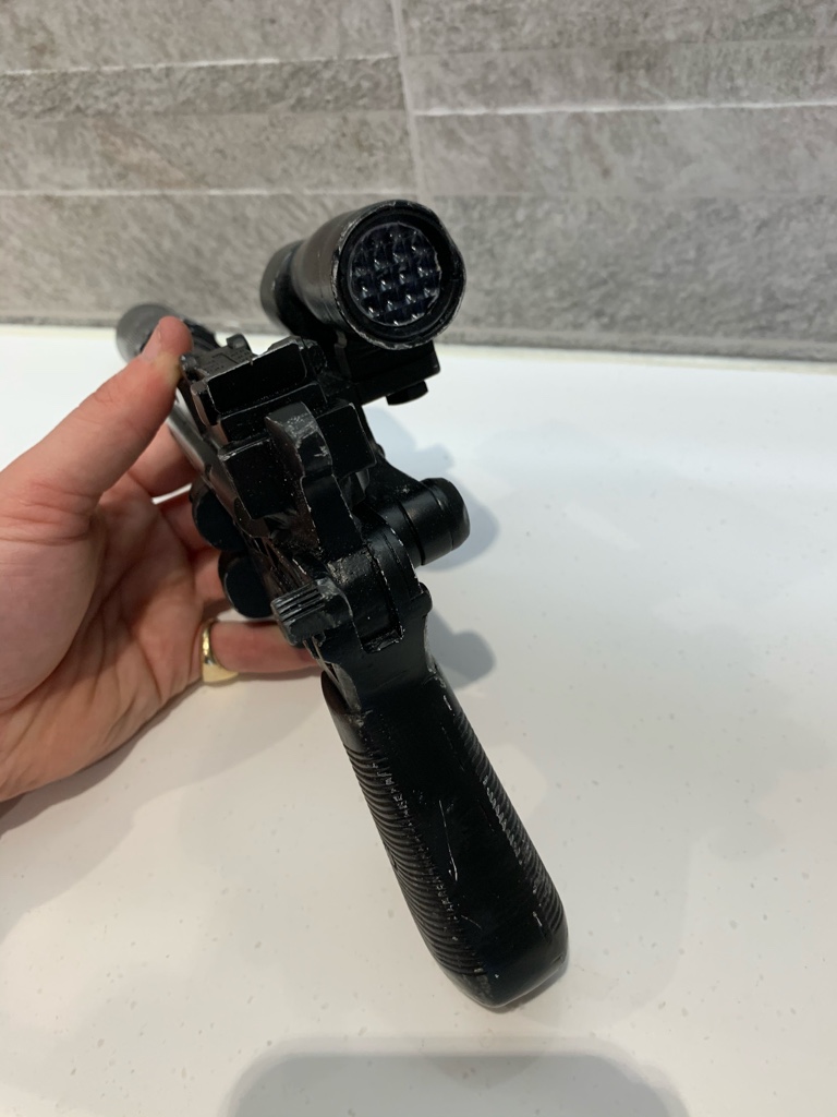

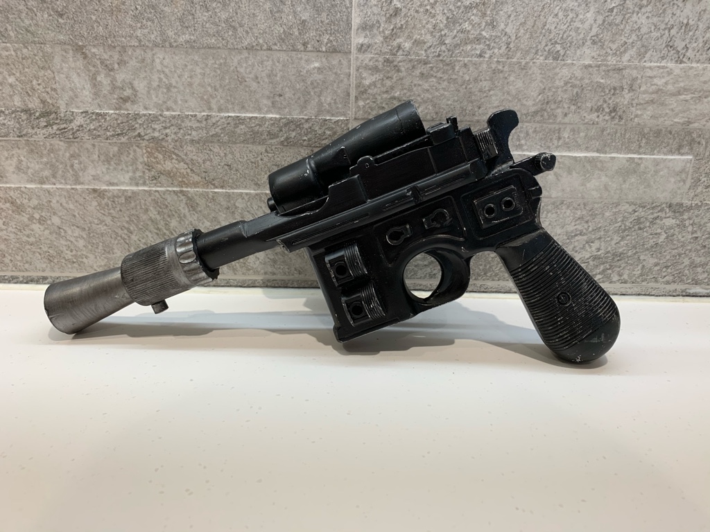

Another build: Resin ESB Stunt
I heavily modified a resin Dagobah Blaster I had to make this resin stunt, trying to match the images of the PropStore Blaster. It was a fun build where it didn’t matter if it looked crap!
I didn’t know you did this?! Did you get the resin cast or make it yourself?
It’s a resin dagobah cast kit I had that I very very heavily modified to give it the resin stunt look. Modifications mainly involved a lot of putty to fill in the crisp details and much sanding and file work. White primer followed by black coat which I could then chip away at.
What did you use for the piece of glass in the scope?
