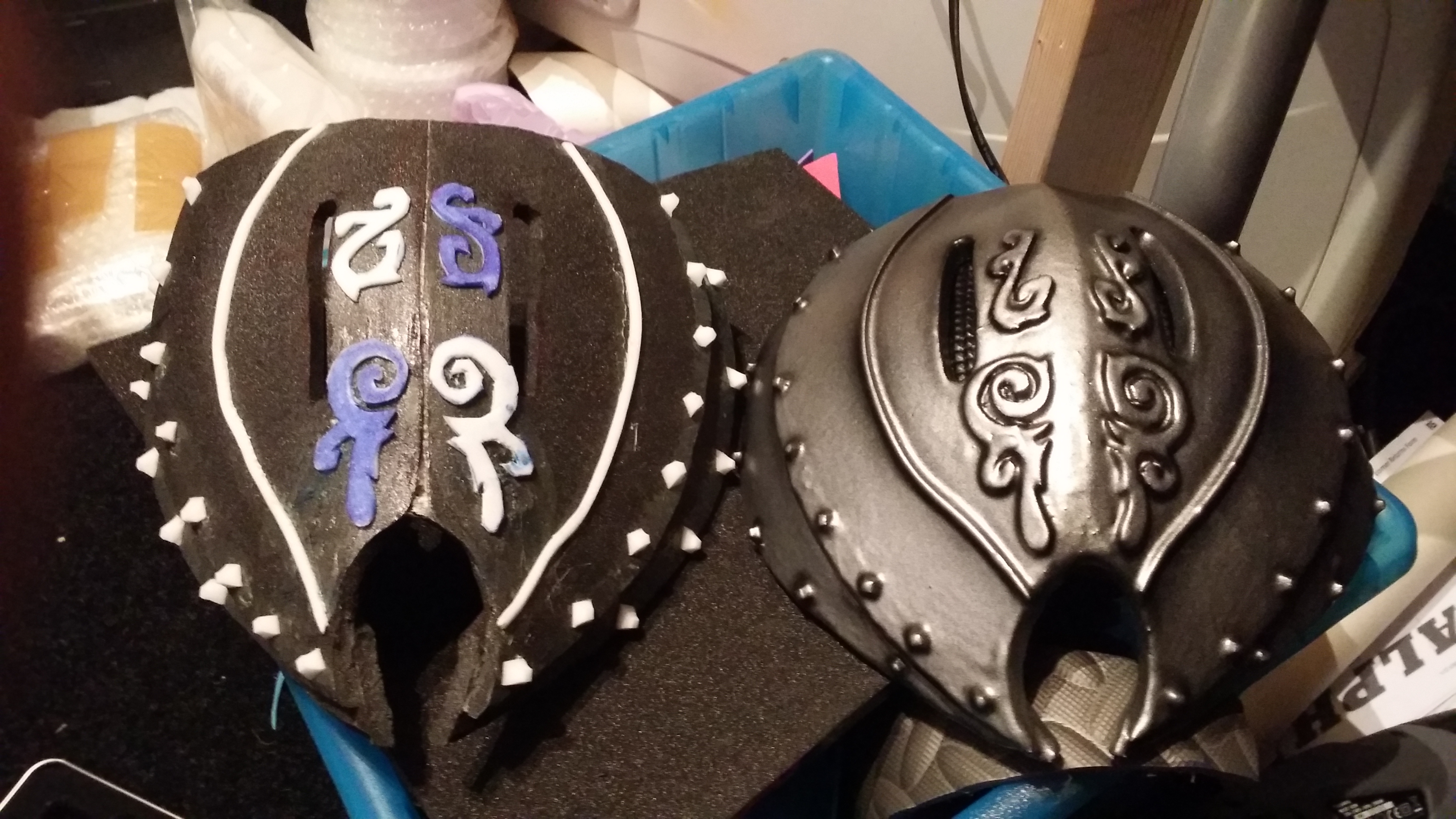

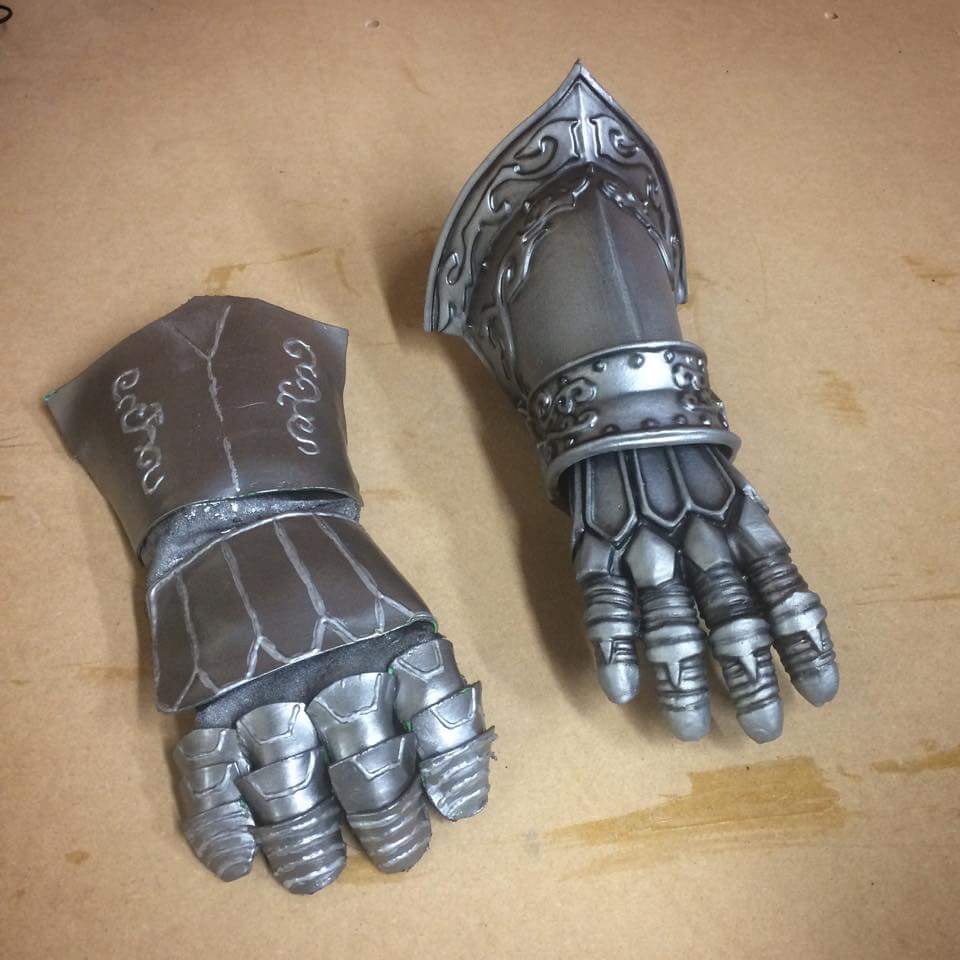

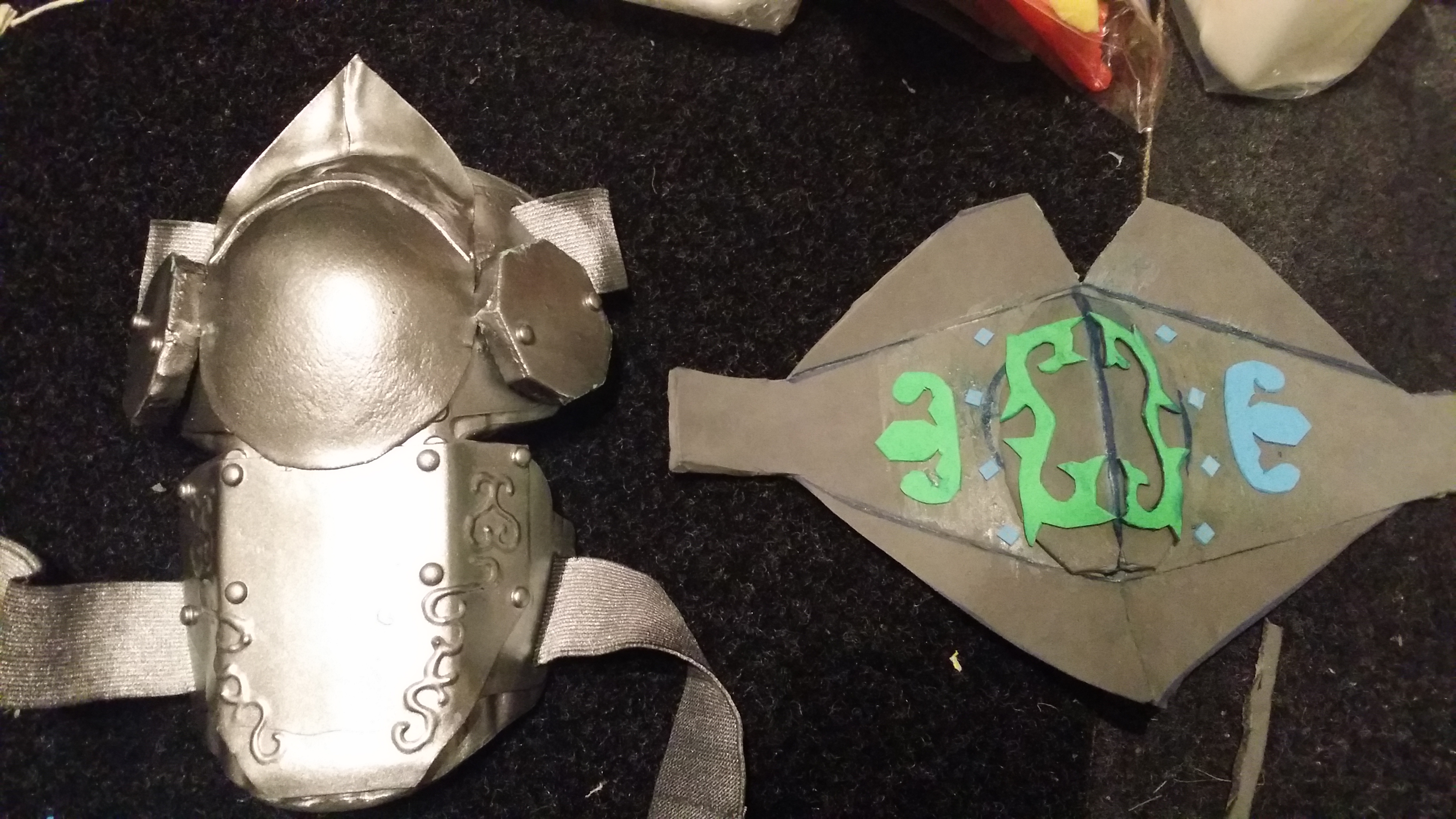

Old gauntlet vs new

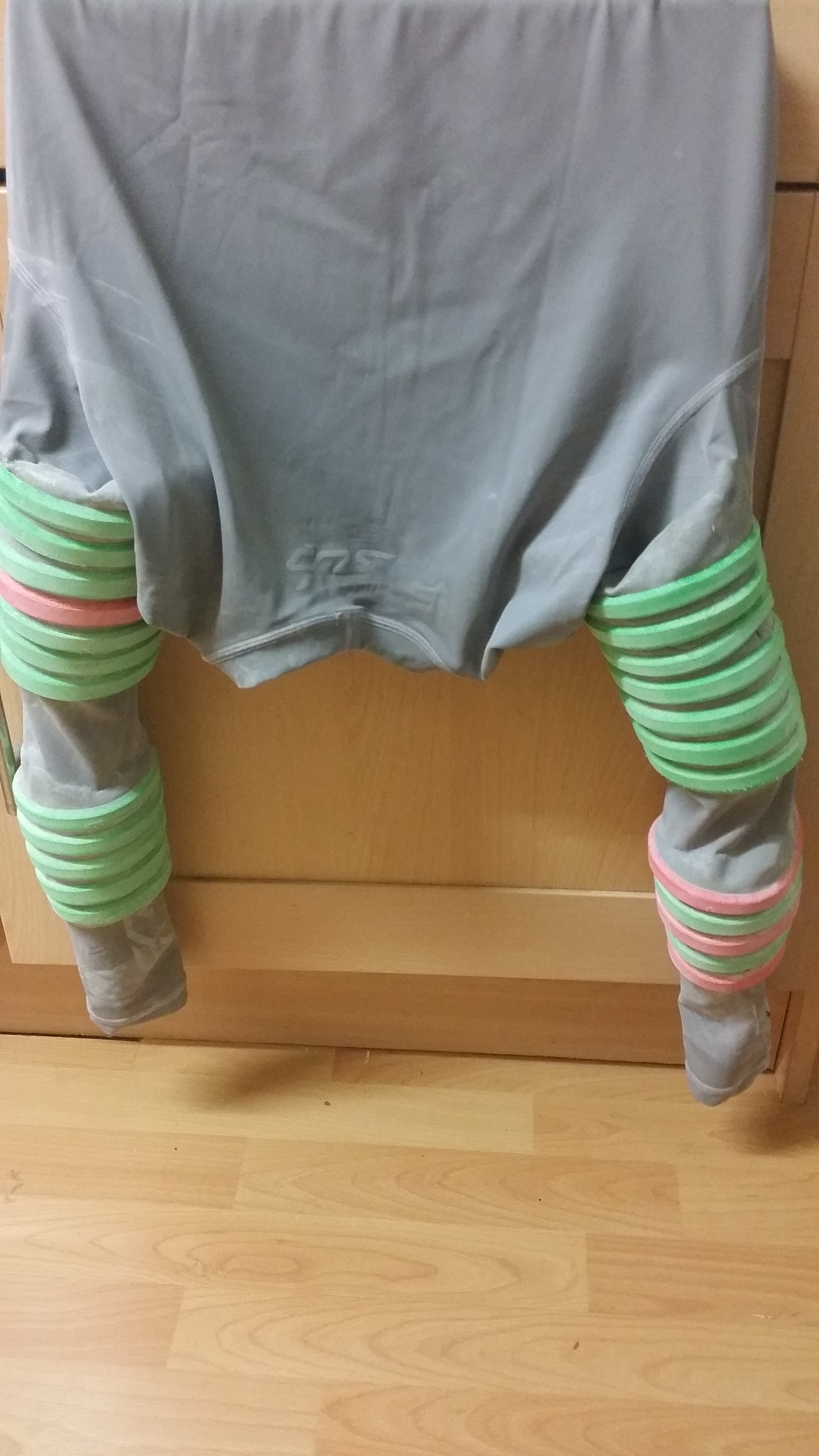

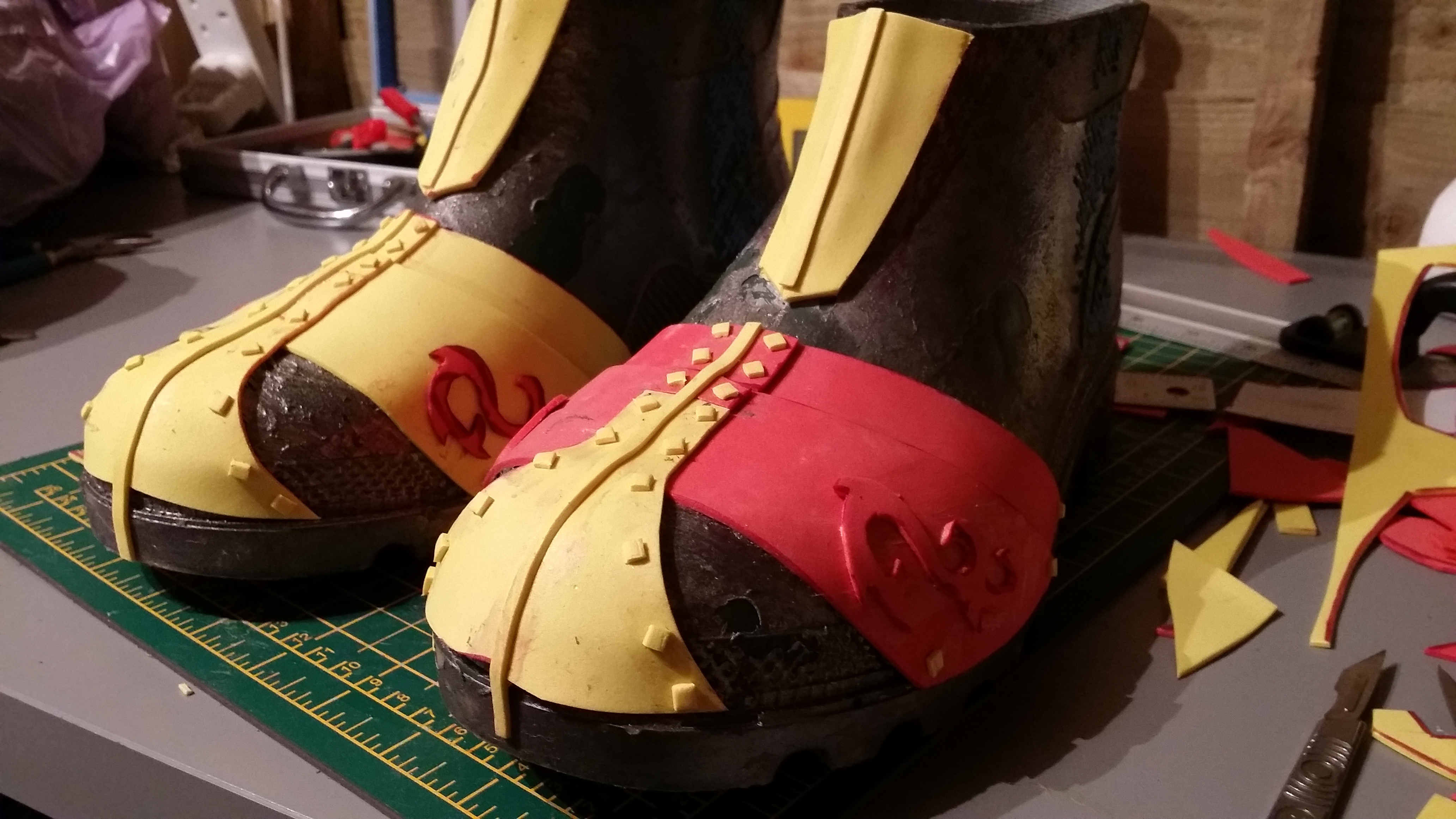

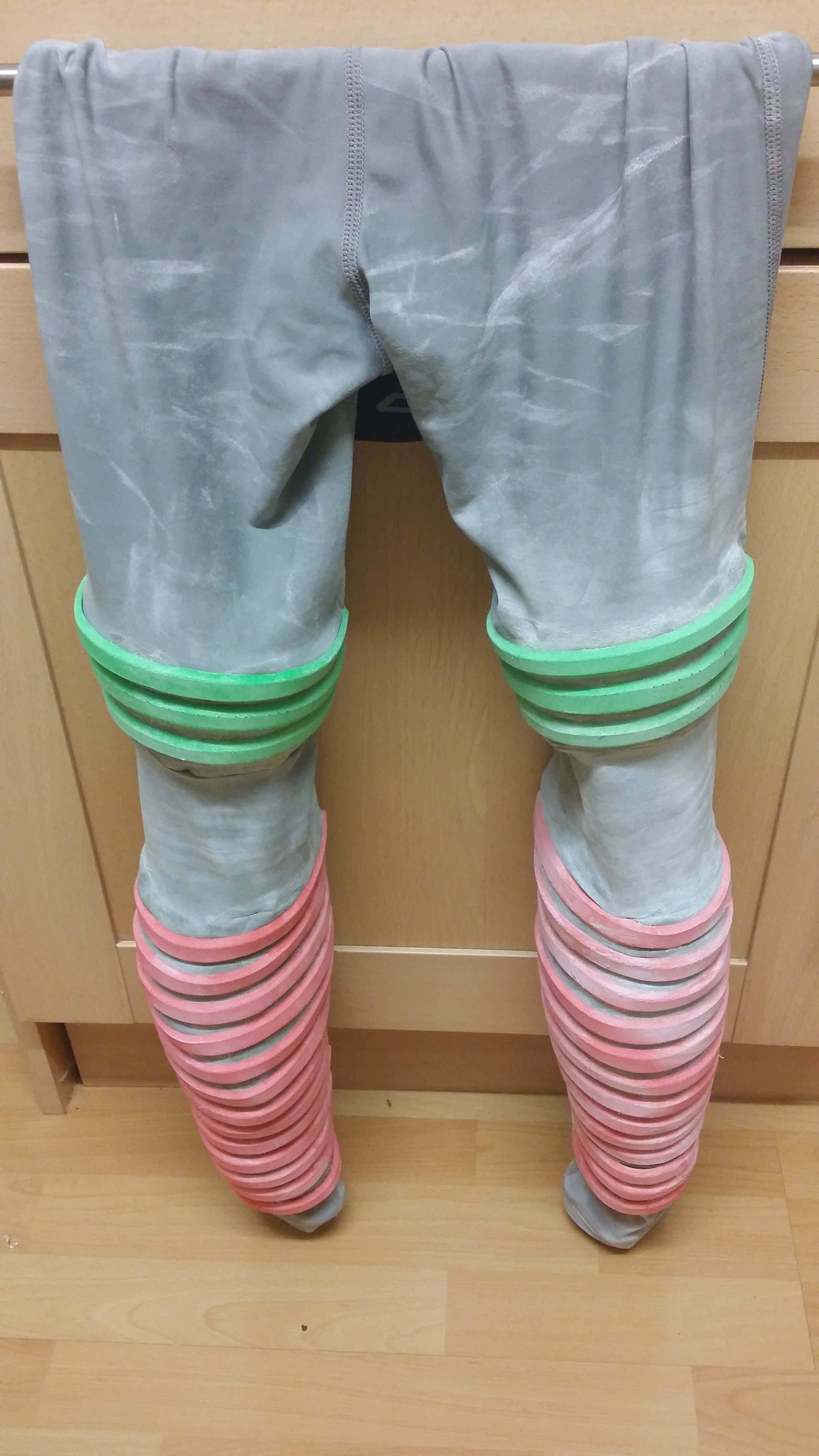

New boots. legs and knees awaiting latex
Still need to do 1 full arm (shoulder, bisep, tricep, elbow, gauntlet), latexing, airbrushing and a few modifications to my suit.

I have upgraded to LD45 Plastazote from floor mats / EVA etc. I would advise anyone to update if you can as it is amazing to use compared to EVA. Also research your glue! If you are in the UK like me there is only 1 way to go and that is Alpha Thixofix http://www.thegluepeople.co.uk/index.php?main_page=product_info&cPath=6_7&products_id=17
Seriously I have tested everything including the UK allowed Barge. This stuff beats them all hands down. Thin coat and wait for it to dry before sticking.
Also, upgrade to medical scalpels and throw away all your crappy craft knives. You only need 1 stem and the blades are stupid cheap and stupid sharp. Bin them when they go blunt.
Everything is basically LD45 foam build, then covered in a glue wash (thinned contact adhesive), then 2 layers of black latex (4 for boots), a dunk coat of latex, then 1 layer of latex + powdered silver, then air brushed to get the detailing to pop (as latex can be a bugger to stop from pooling).
Then you would normally apply a coat of polish (roofing primer) but this will take 48 hours to dry and the Manchester con is on Sunday so I won't be doing that lol.

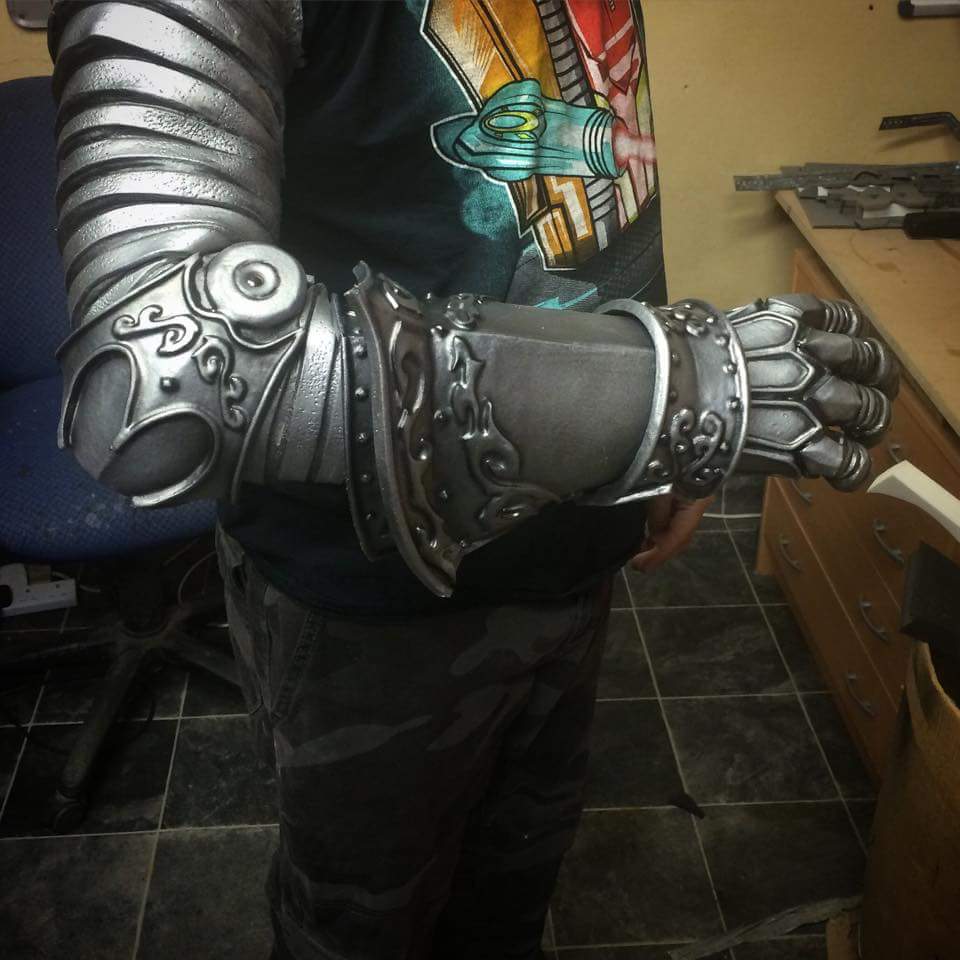

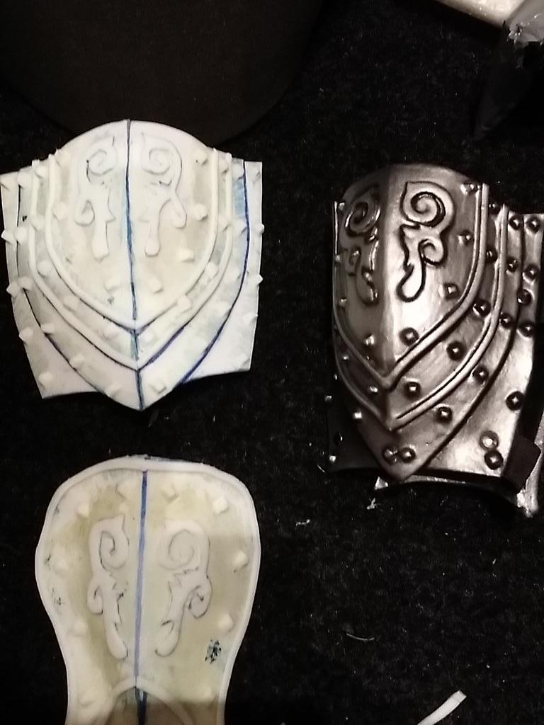

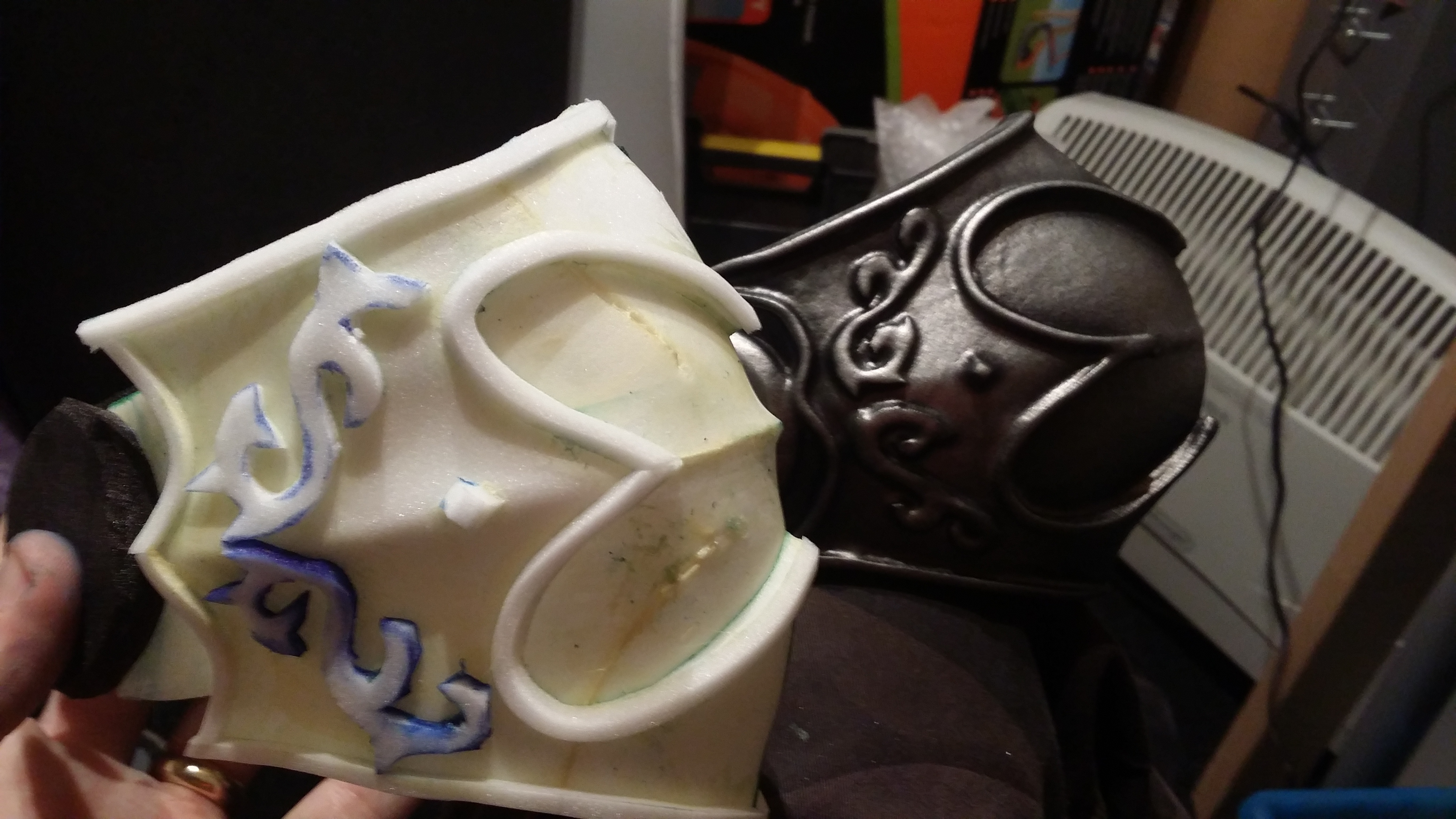

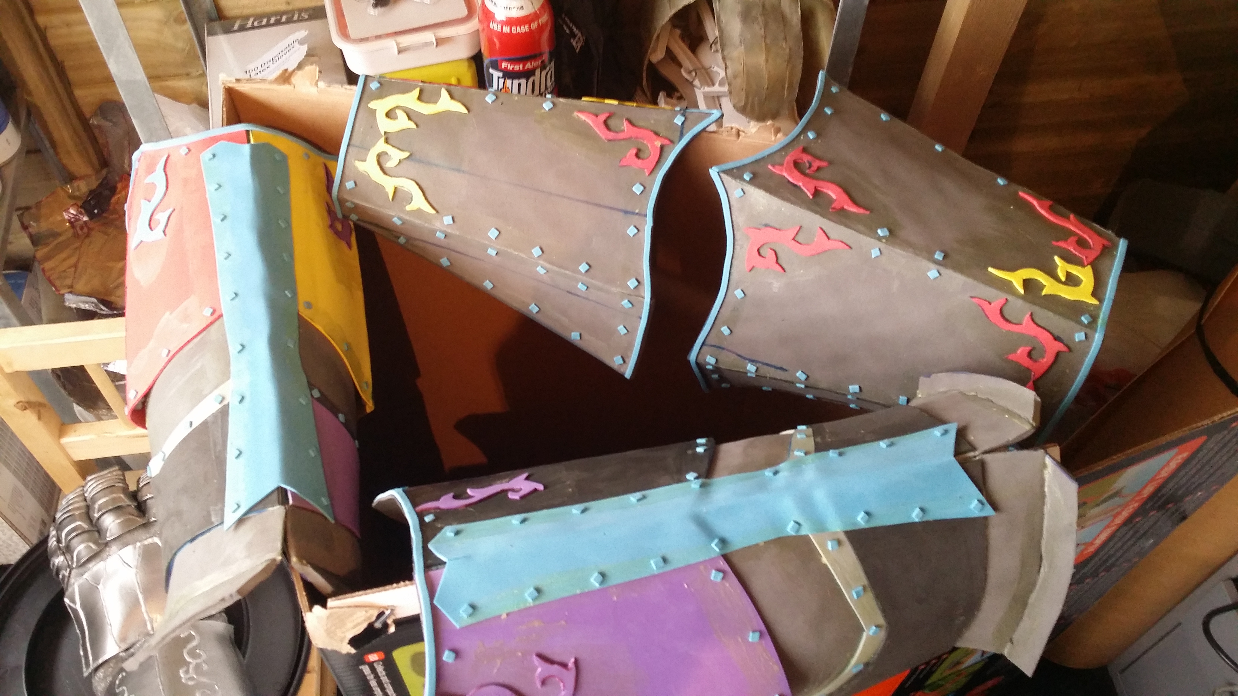

Last night was all about the bicep and tricep.
Tonight I will complete the other gauntlet and do the shoulders.
Tomorrow night I will do the glue and 1st latex coats.
Saturday I will do all the remaining latex coats, airbrush and fix everything together with rivets, elastic etc.
I'm listing all this for my own sanity, going to be a mental few days ahead!
