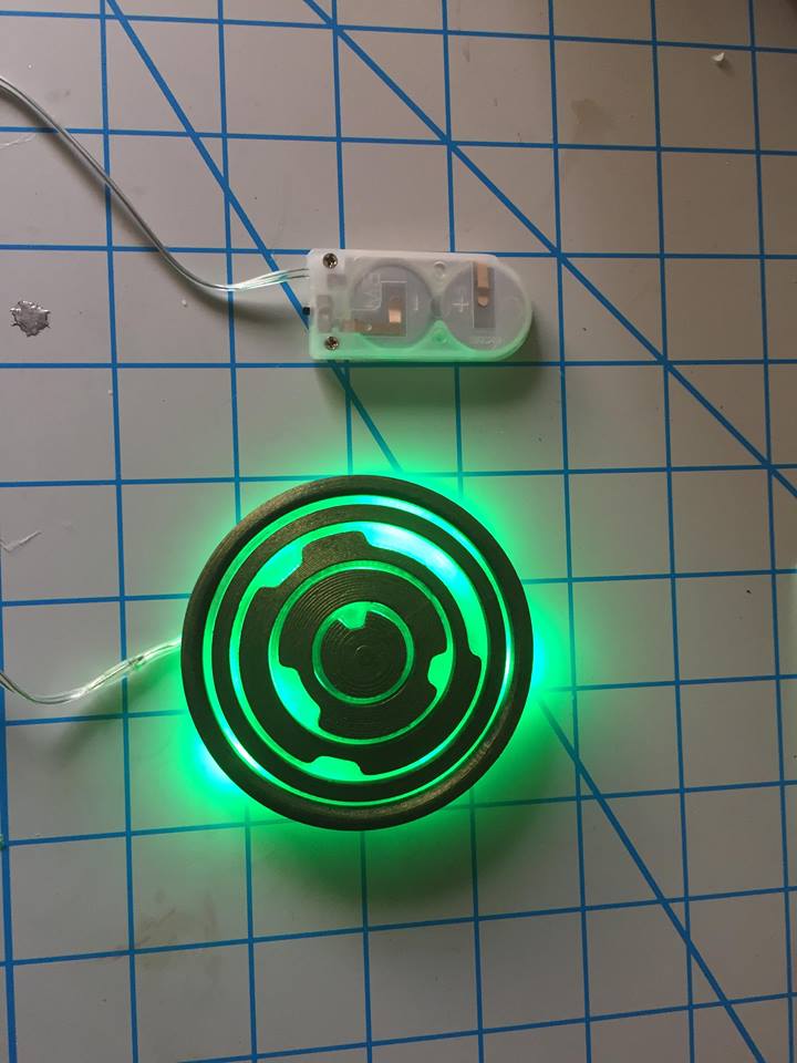

You've tasked me with creating some accessories for your unique take on Doctor Doom. I've modeled, and will be printing and installing green led's in these "chest discs" and "buckle".

FAB! I'm so excited to get these and add them on - your work is always so awesome and is the perfect addition to my suits. :)

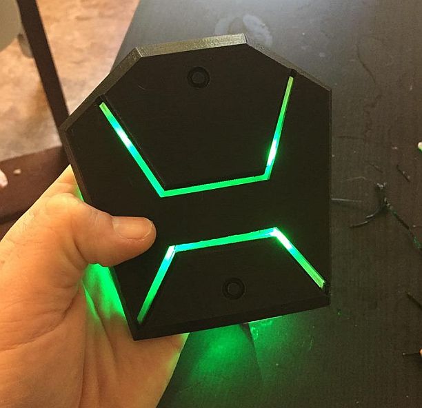

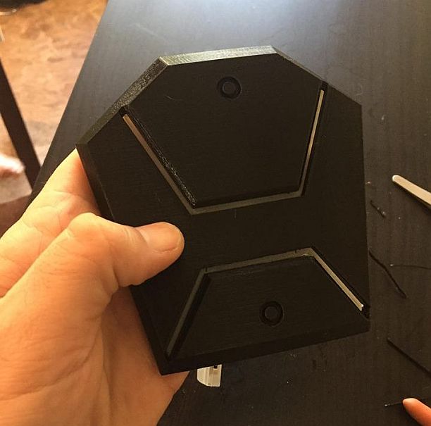

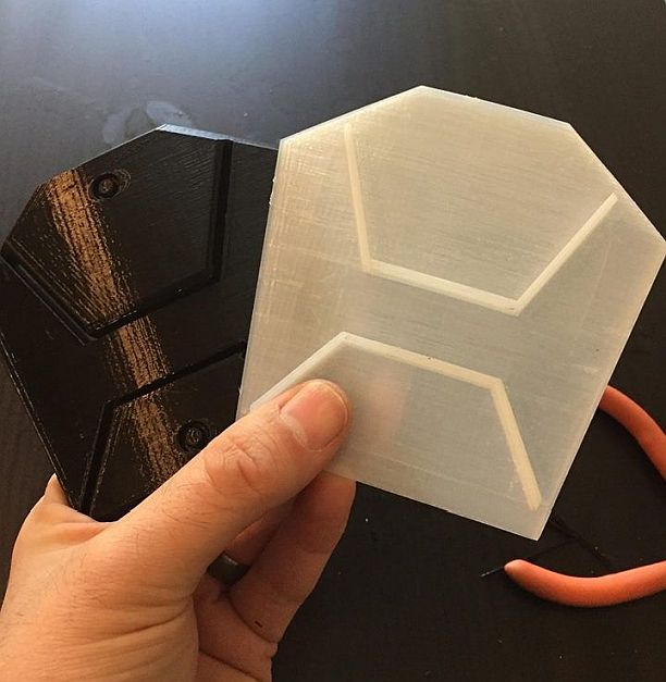

I got these images yesterday from Graphic Jordan and had to share them. These are the rough prints and test fit for the buckle. He's making the back sections in translucent filament and the outer sections are solid. When they are put together and the leds are installed in the back, the translucent sections will glow.
The cape discs will be done in the same manner and, I believe, are being printed today. :)
I'm so excited to see these pieces progress!
Glad you like how the greeblies are shaping up. It's been a lot of fun. Once I get em all installed and painted up, they'll have the honor of sitting with the rest of the amazing costume you've constructed!

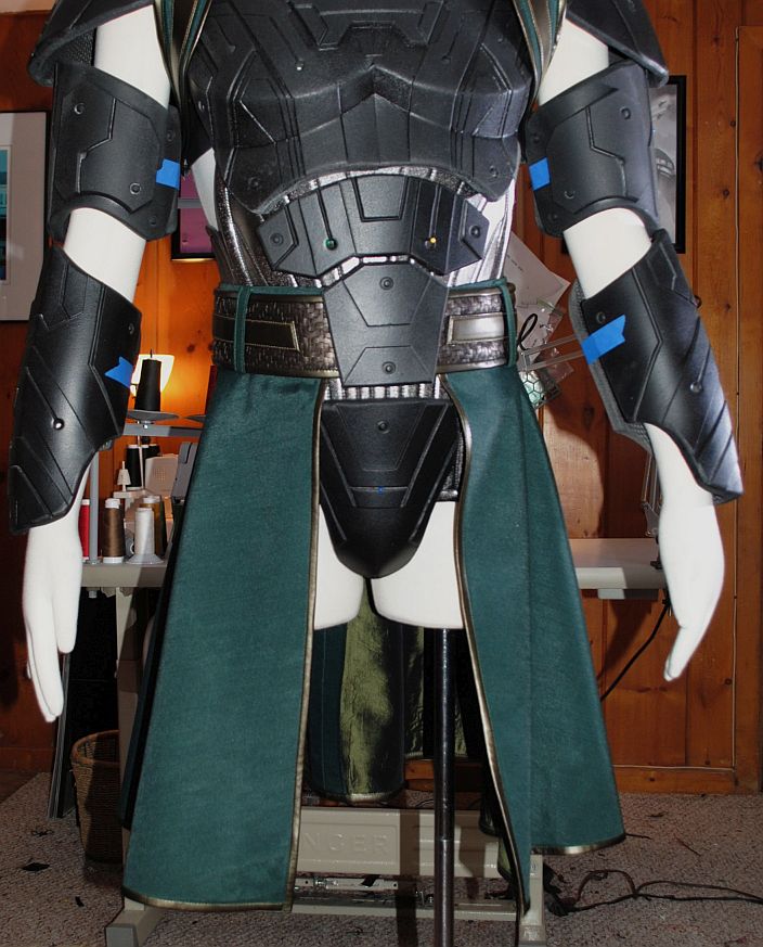

While the hardware was in progress with Graphic Jordan, I got to work on the belt and the foundation for the cape.

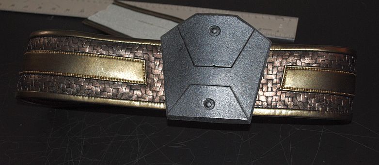

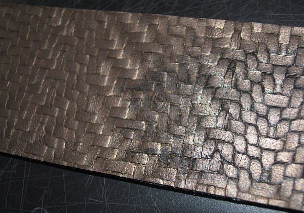

The base for the belt is being made of an embossed faux leather in a copper color. I wanted to tone down the rather flat metallic look of the material, so I used a sponge to apply matte black paint and then buffed it off with a damp towel. This left the black in the crevices and only highlights of the bronze on the surface.
I then bound off the edges with the same detail fabric as the rest of the pieces and added a detail stripe to the center of the belt and test fit the foam version of the buckle to it.

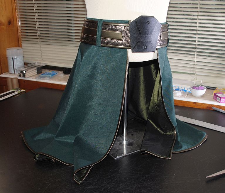

The next piece to complete was the skirt piece that will extend from the belt and around the back to the knee. This piece was constructed as a half circle drafted to frame the belt buckle. It was made in the same green linen and taffeta as the hood and edged with the metallic faux leather.

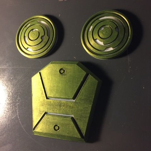

By the time these pieces were done, I had an update on the hardware. The pieces had been painted, the lights attached and were only awaiting final finishes before being sent to join the rest of the costume.

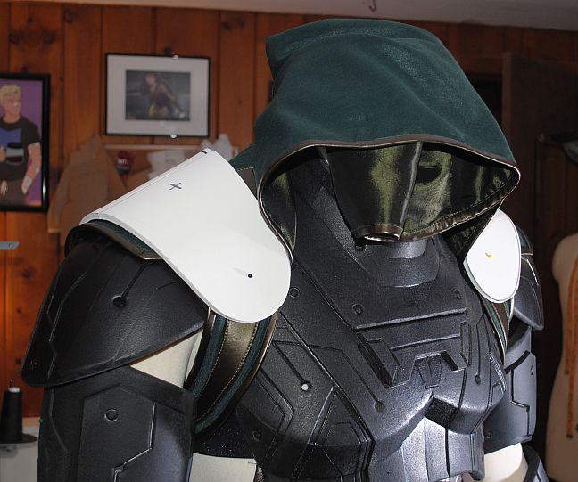

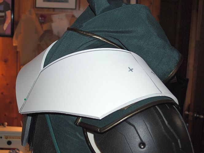

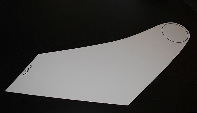

At this point, I wanted to get started on the base for the cape. The cape needs its own foundation as it will carry a lot of weight and have to support a lot of movement. I decided to create a foam foundation for the cape that will hold it in place, support it over the shoulders and keep it in the proper drape over the shoulders.
I made a basic pattern out of poster board that worked with the vest and armor.
The piece was then cut from foam and shaped to the rest of the costume.
This piece will be covered with the cape fabrics and the actual cape will be built on top of it. The plan for the cape is to build it in sides that are permanently pleated over the shoulders and then connect to a center piece that has the fullness for all the movement I want. The concept is not unlike the Thor cape.

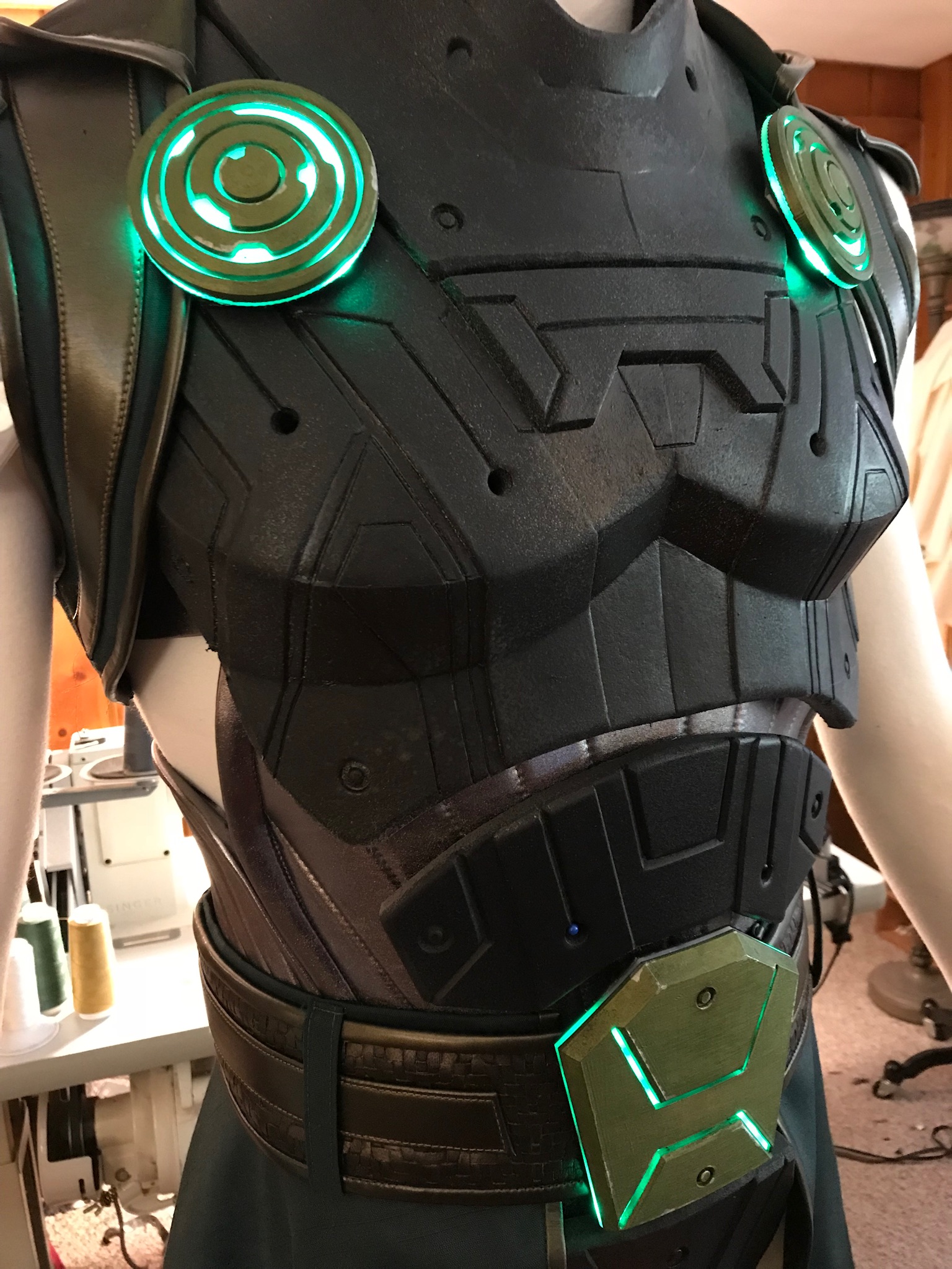

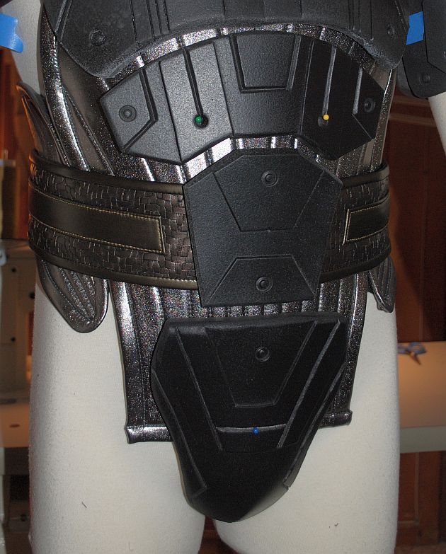

Lots of projects going on and traveling all last week, but I did get the hardware from @Graphic Jordan and got a chance to test it up against the rest of the suit so far.
So so excited and happy with these - he really is brilliant! I now really need to get the armor pieces fully coated and some paint on them to get an idea of the full effect. Here’s hoping the mad Atlanta Spring weather will cooperate with a few dry and reasonably temperate days to work with. Also, still deciding on the cape concept. Miles to go...

It was my absolute pleasure to create these accessories for your amazing Doc Doom costume. I cannot wait to see color on the armor as well, it's all going to tie together so well. :)
