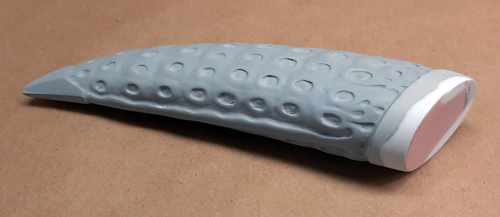

I decided to go back to square one and start again with a spare casting of the original crysknife, since I had significantly altered the shape of the knife during the first go-round. I got rid of the collar, reshaped the "hump" of the blade a tiny bit, as well as the blade/grip transition area, and modified the buttcap.
Deciding what the angle on the buttcap should be was a bit of a challenge, since its appearance changes throughout the scene, depending upon the knife's orientation relative to the camera. So it was best guess, basically.
I also grafted a piece onto the sheath pattern and corrected the angle of the collar.
So I got those sorted and they were good to go.

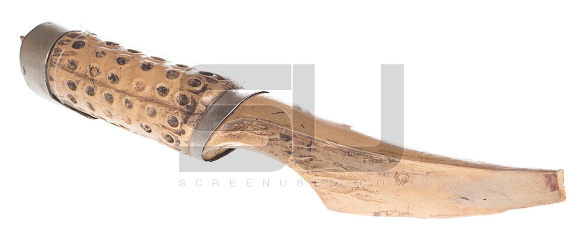

Right after the revelation of the YouTube video, I also happened upon a pic of a screen used crysknife that had been auctioned off a couple years back.
My friend found the rest of the photos in the set and a google image search led to the archived auction page:
Dune - Fremen Crysnife
Those pics confirmed that the triangle on the buttcap definitely needed to be thicker. And in all of my staring at pics and watching of video clips I came to the conclusion that the blade was short on the casting that I got from my friend back in 2000 (which I had suspected for a while). Using this pic, which is of an alleged "blood FX" knife from the production...

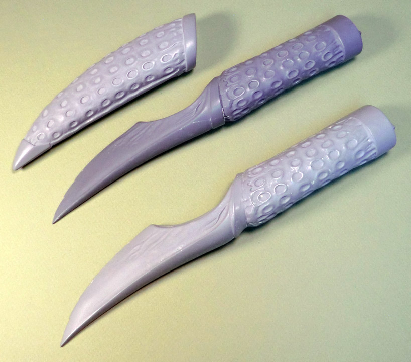

...I scaled it up and confirmed it:
So I grafted a piece onto the end of the blade, did some reshaping, and rectified that discrepancy.
So then this one was good to go as well.
Anyway, the patterns shipped out this morning, so things are in play...
