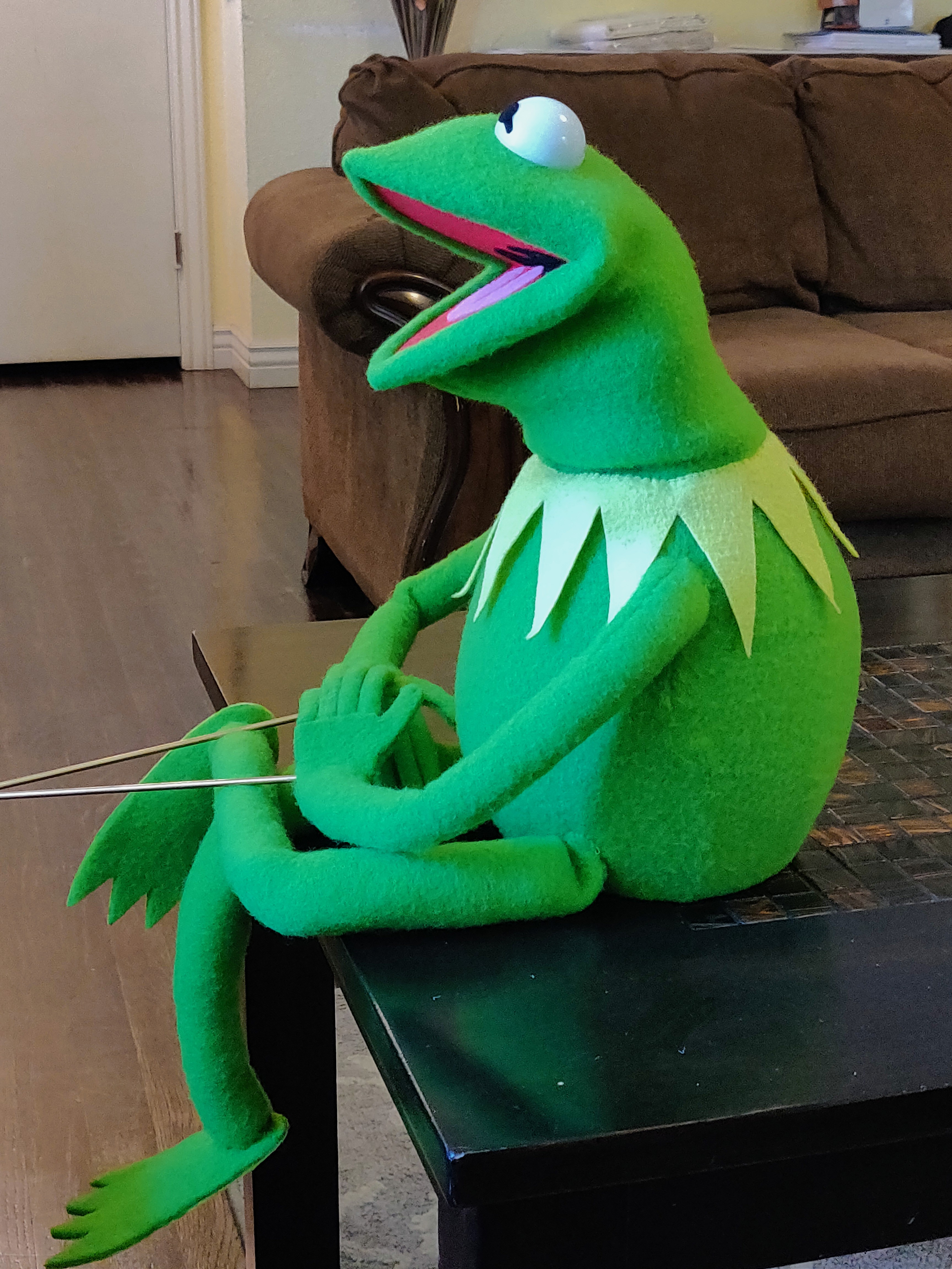

ecl's Kermit the Frog Puppet Replica (later builds, using my newest patterns)
I used stik glue for my prototype mouth-plate adhesion. (Ha)

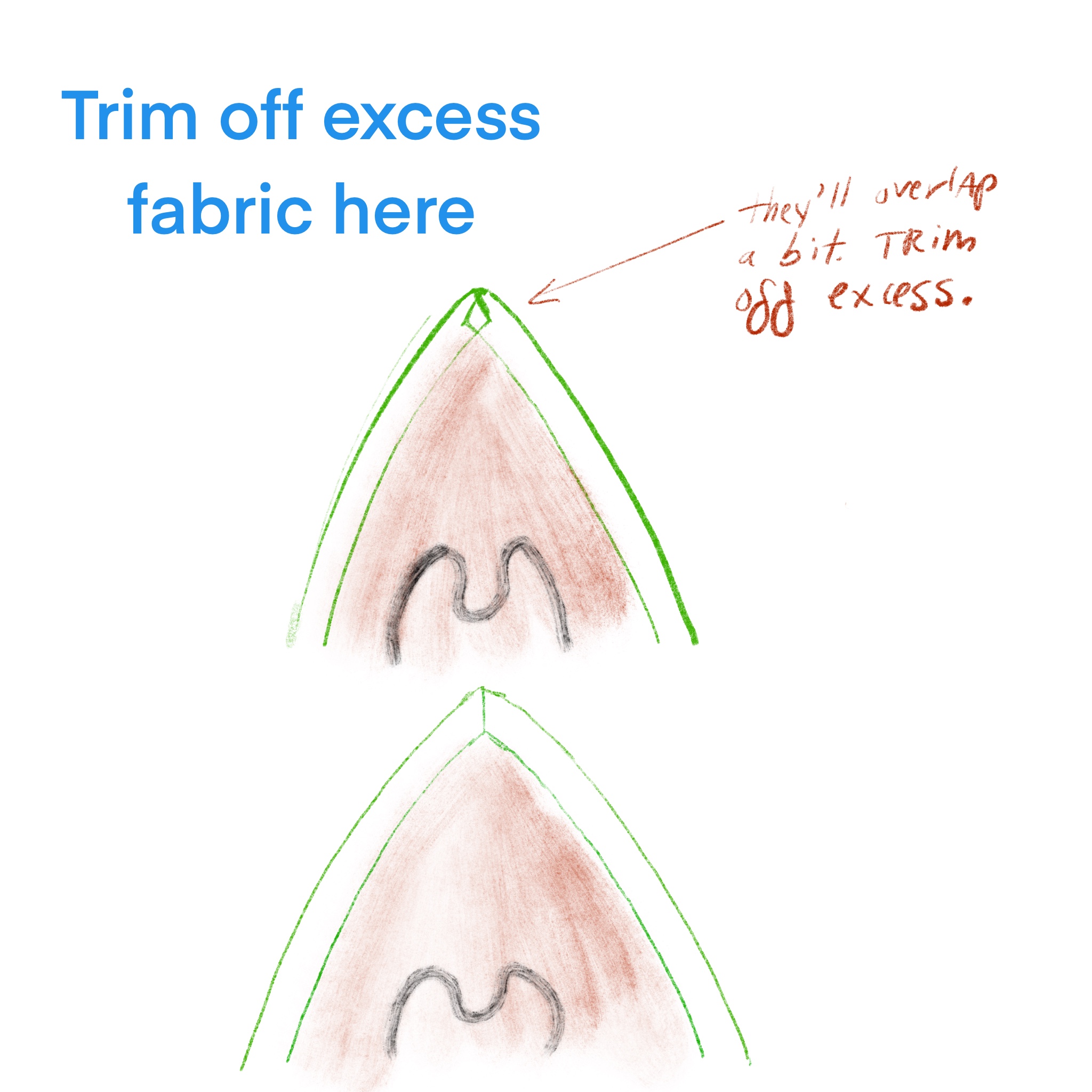

ECL, your builds are the best out there, bar none. I'm finally starting to attempt my first Kermit, but I have a question about the mouth gluing: when you ladder stitch the two sides of the head together, do you leave a little space at the tip of the mouth unstitched, or do you sew it all the way to the tip of the lips? Thanks so much for your help!
Thanks! Much appreciated :) And that is a great question! I leave about 1/4” or just a touch more unstitched; it’s easier to glue that way, and to get it to fit just right. You can still trim that area afterwards if necessary. It’ll overlap a bit, naturally, so trim it like below:

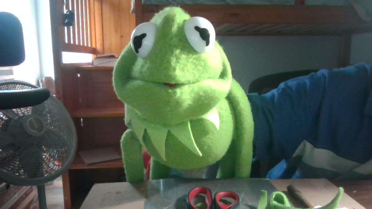

Just finished my second Kermit build on the left. Thanks again ecl for your help and guidance. After my first one i had learned so much and wanted to give it another go. It took me a bit longer to get this one done as I wanted to take my time and try to get this one right. I am pretty happy with it as of now. I am sure I will start to see all the little things that will make me want to start another soon.

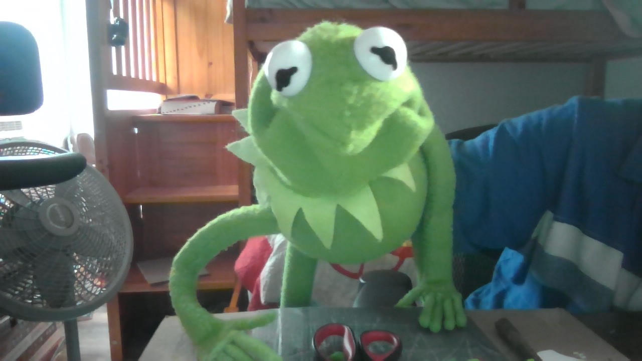

Here he is alone.
He’s wonderful! It’s always an interesting experience building more than one; each time is a unique experience and he’ll just keep evolving! The shape of the body looks really clean; that’s one of the biggest challenges when building a Kermit.

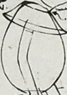

Question, is the top of body parallel to the bottom or does it tilt forward a little? Its hard to tell in the photos. Or is the the collar sewn at an angle?
Thank you I'm going to start forming up the body today. I can see what your talking about in some reference photos. He has a flatter chest down to a belly and a nice curved football line to the back. This illustration shows it pretty well too. Another question, when you measured around 7.5 inches for the body height. Was it from the front or the back?
Chad
I had measured that from the front; although, the body sizes seems to vary a little, so if you’re working around that range, it should work fine!
