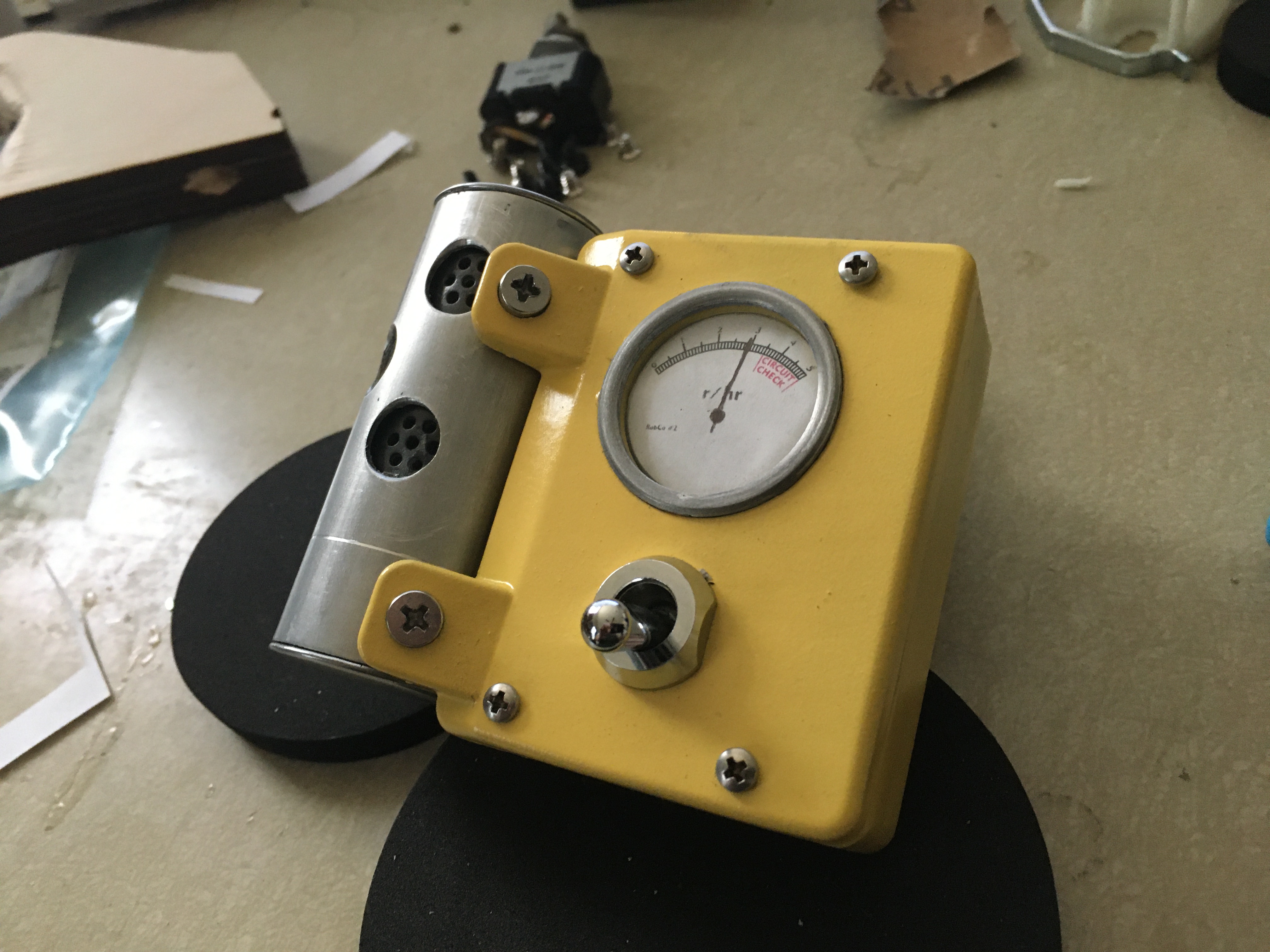

Here is my static version based on your model and parts list.
I think that if you increase the tolerances just a bit on the printed parts it will be easy to assemble even with cheap consumer SLA printers. I had to do a fair amount of sanding to get the glass to fit and also had to drill out the screw holes to a larger size to keep the plastic tap screws from splitting the resin. You may also want to add some support that runs the length of the interior of the back of the case on the left side near the opening as the gap encourages some warping inward and it makes fitting the top slightly more difficult.
Awesome stuff thanks for the model and instructions
Looks pretty good, nice job on the yellow color. Although I did put the cylinder flush with the bottom edge.
Yes ya, that is why I always warn the parts aren't designed for at home printing. I am surprised though that you had tolerance issues with resin, perhaps it shrunk while curing.
I accidentally said the opposite of what I meant before. The tolerances are too tight, the model prints great and it's exactly the right size, but being exactly the right size is a problem because the parts fit too snugly. Its a materials issue, the resin is likely a lot less flexible than the nylon you used as a result its more difficult to flex the part to get the glass and the bezel in. Same idea with the screws, the resin tends to crack as the screws push deeper into the material.
