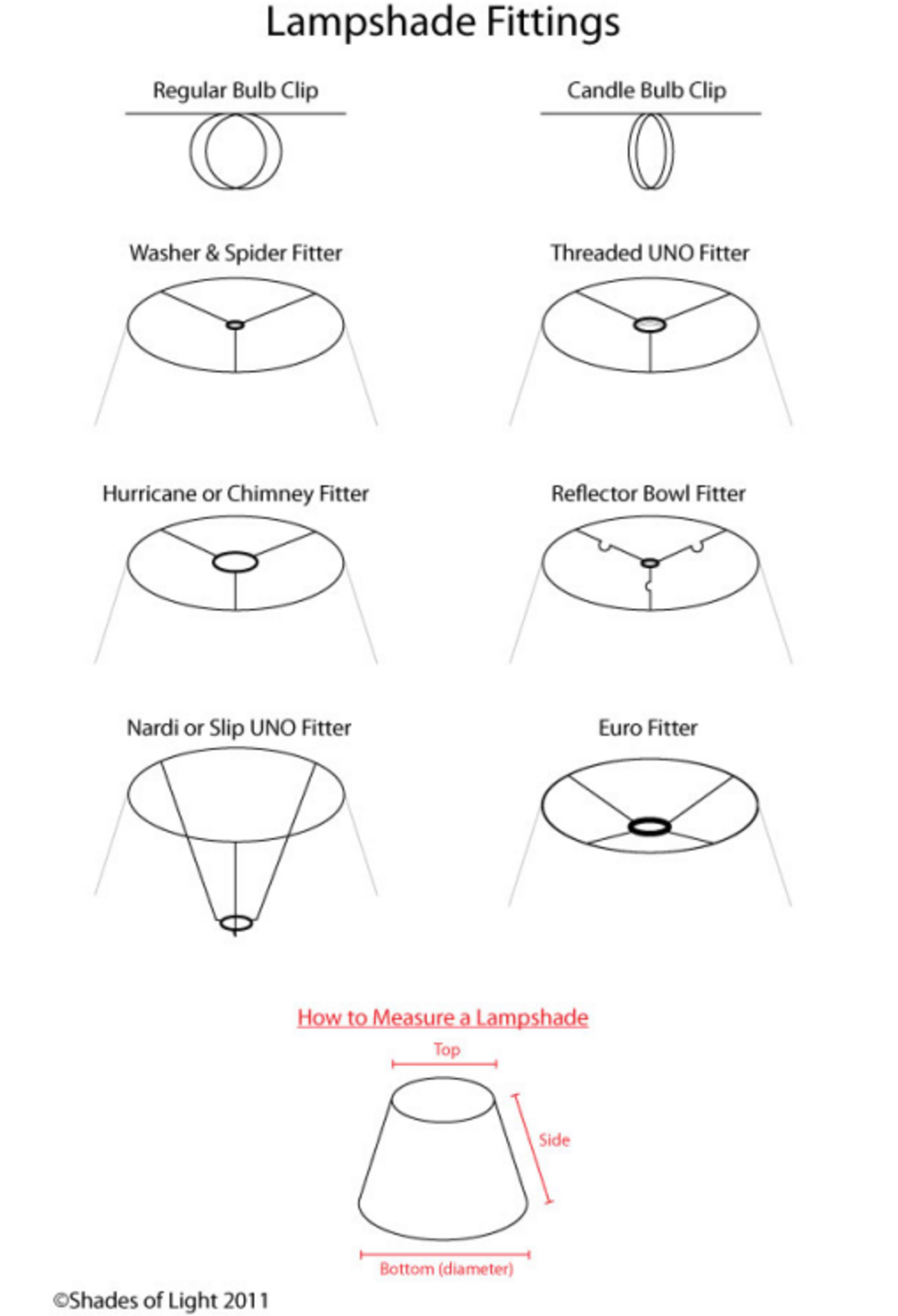

Make sure when you order it, the artwork is UPSIDE DOWN. I had to remove the wire framing because it is designed so that it is on the BOTTOM, but you need it on the TOP.
