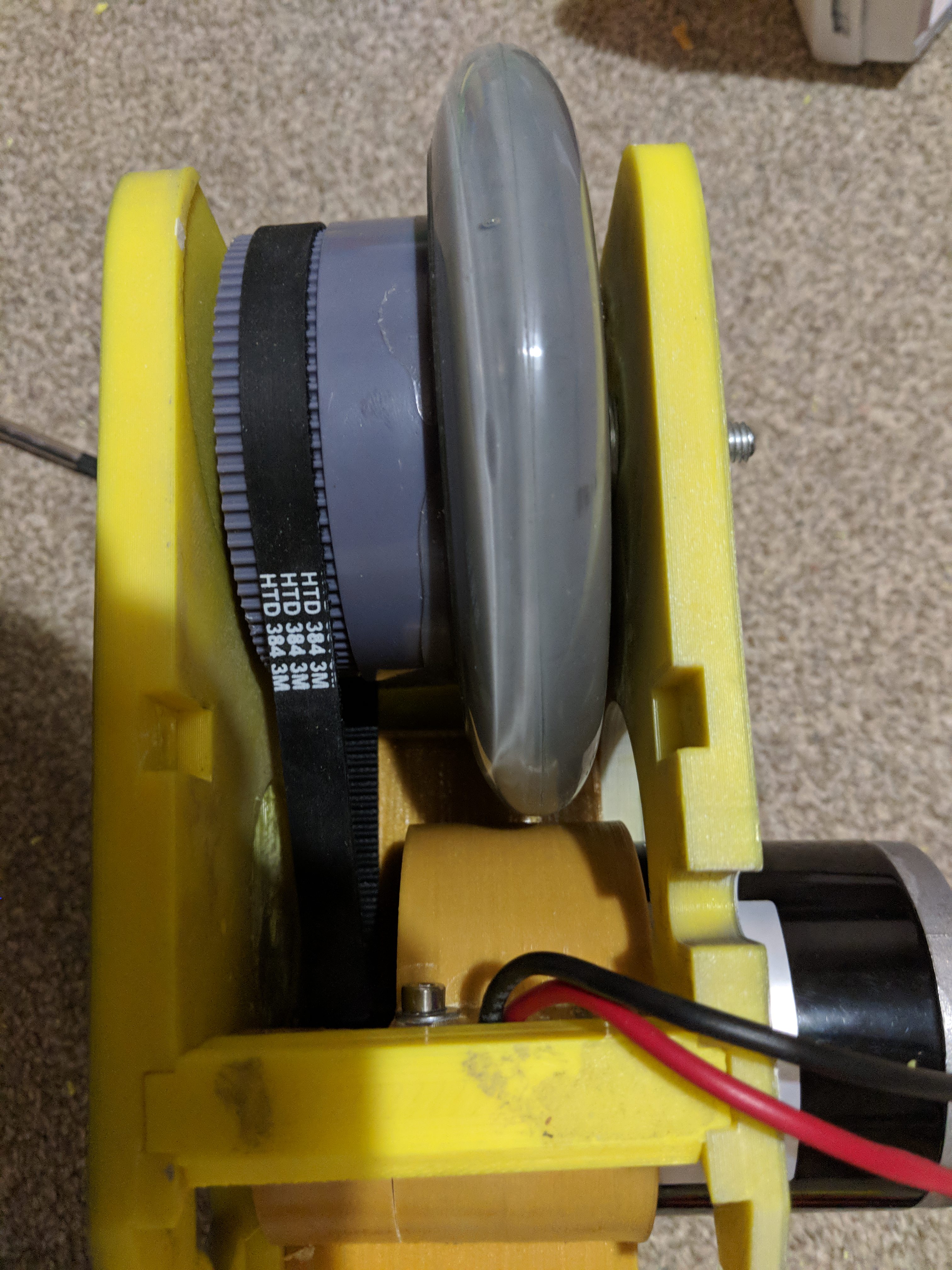

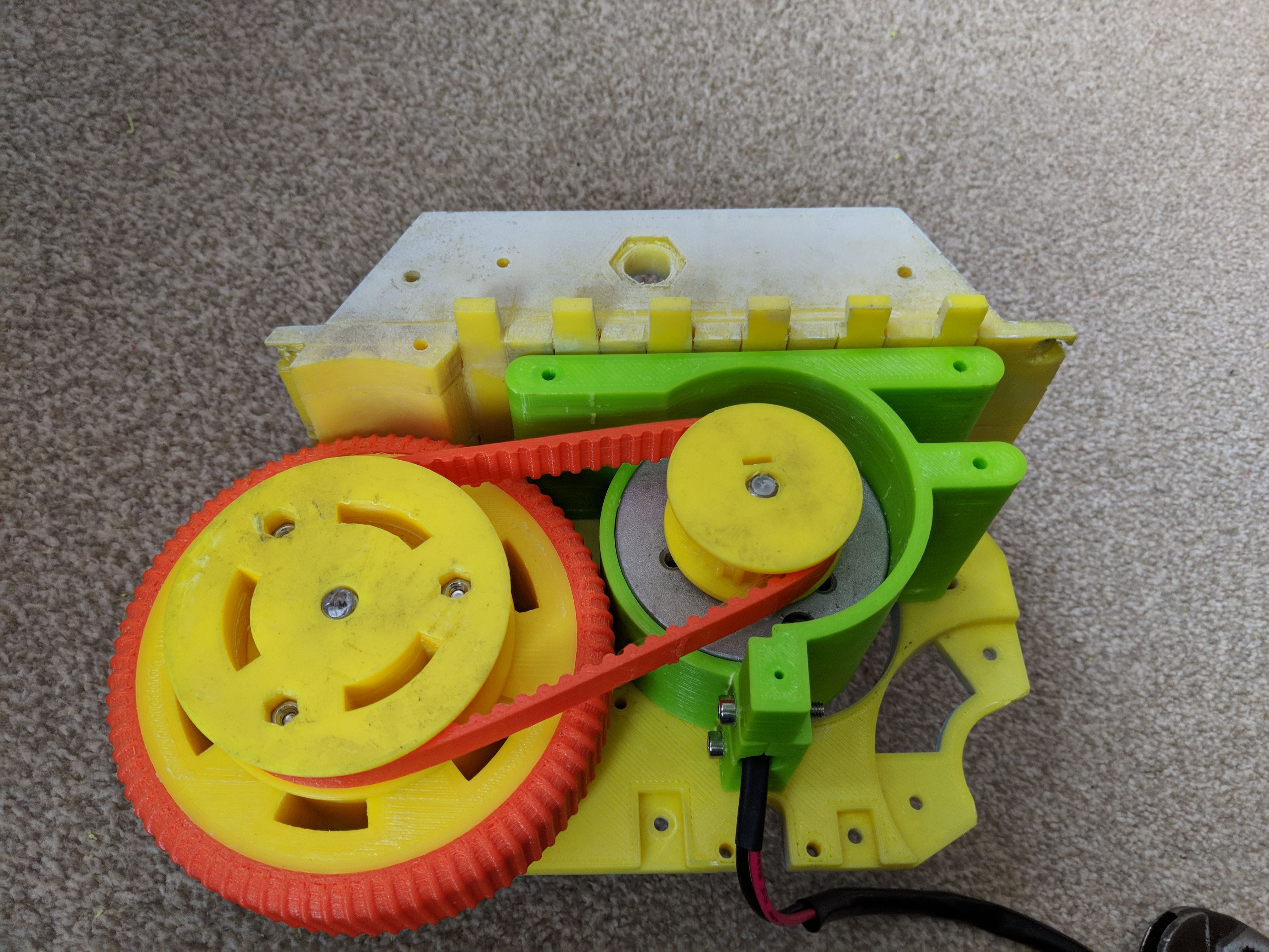

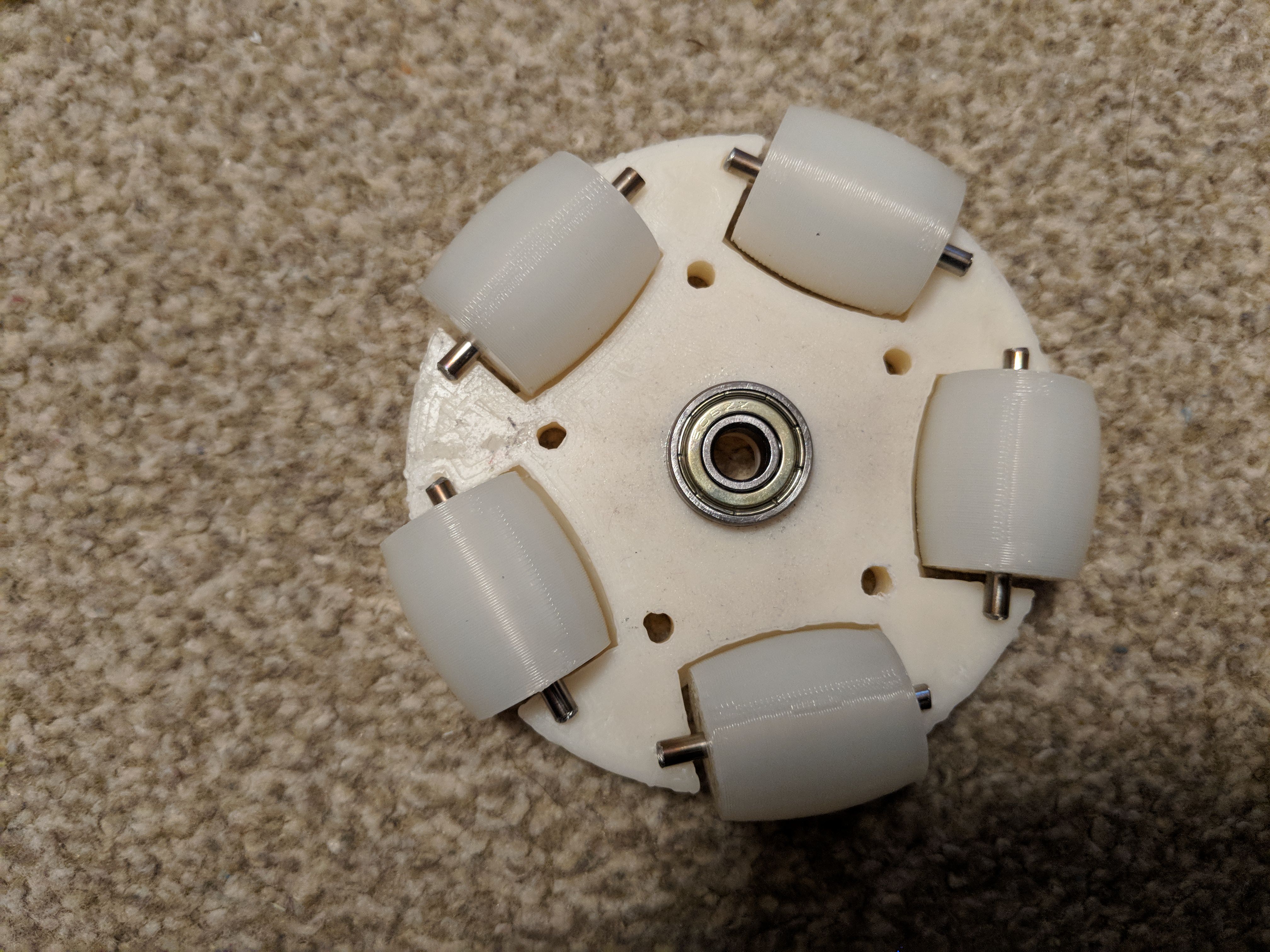

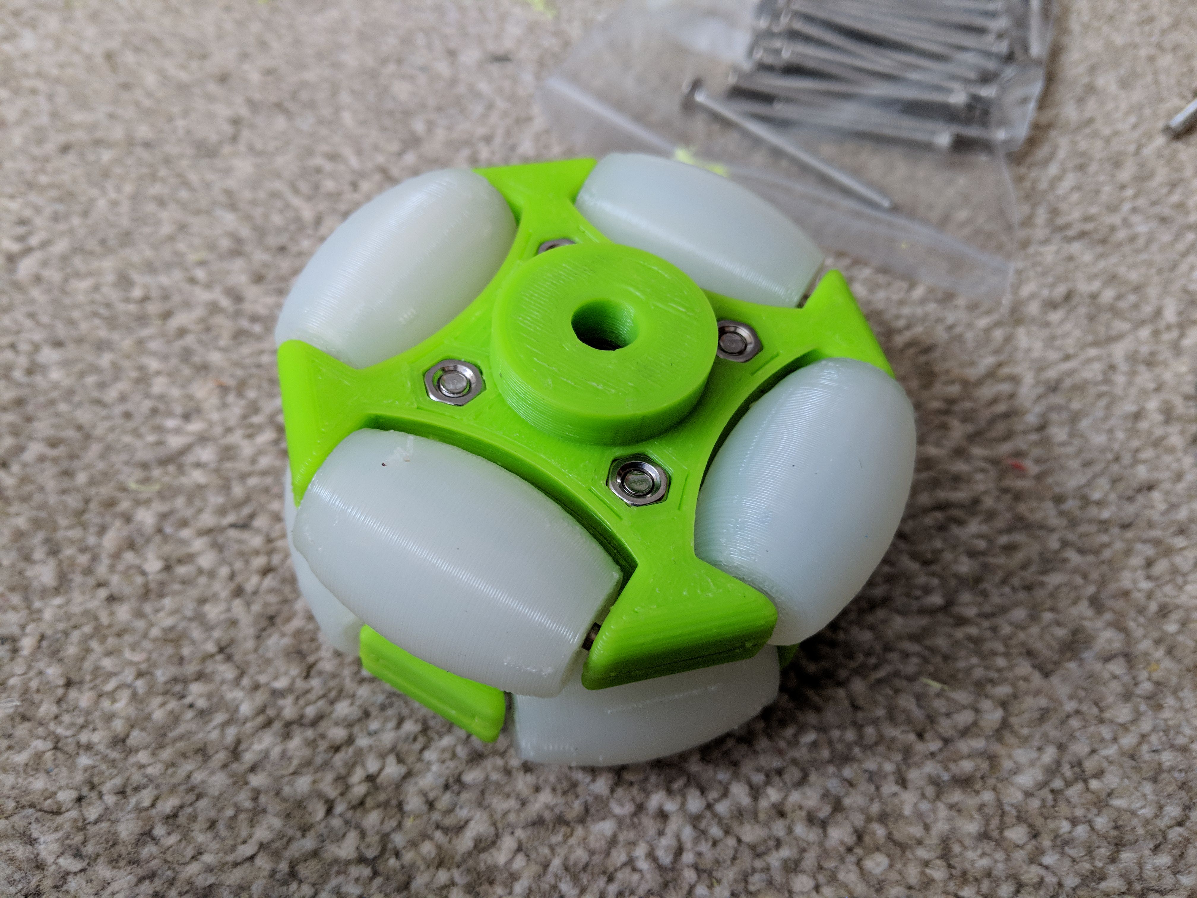

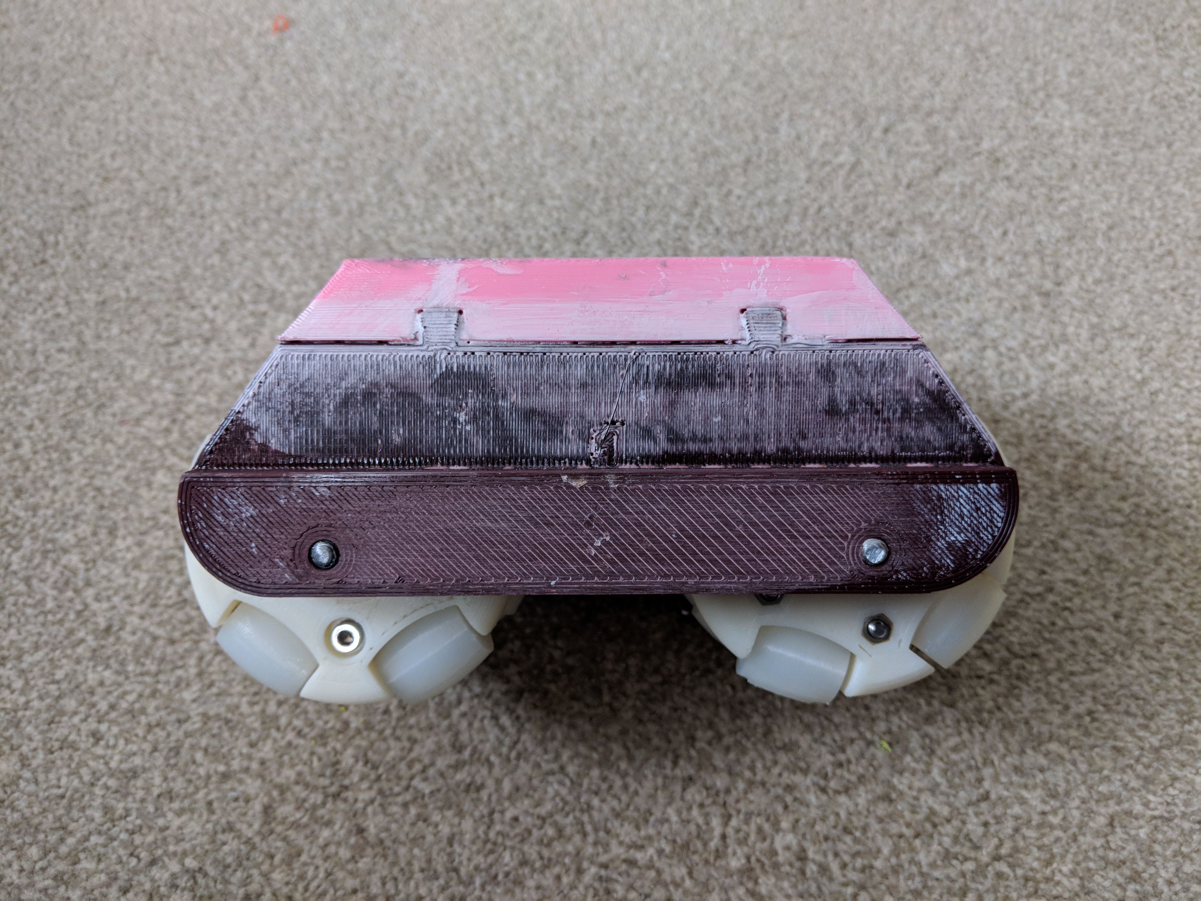

I printed out and assembled the feet drives
Center foot
I kept getting belts slipping and when they did grip wheelspin.
I ordered some scooter wheels and belts.
I used 100w 24d scooter motors but found they weren't really powerful enough on a carpeted floor so upgraded to 150w 24v.
