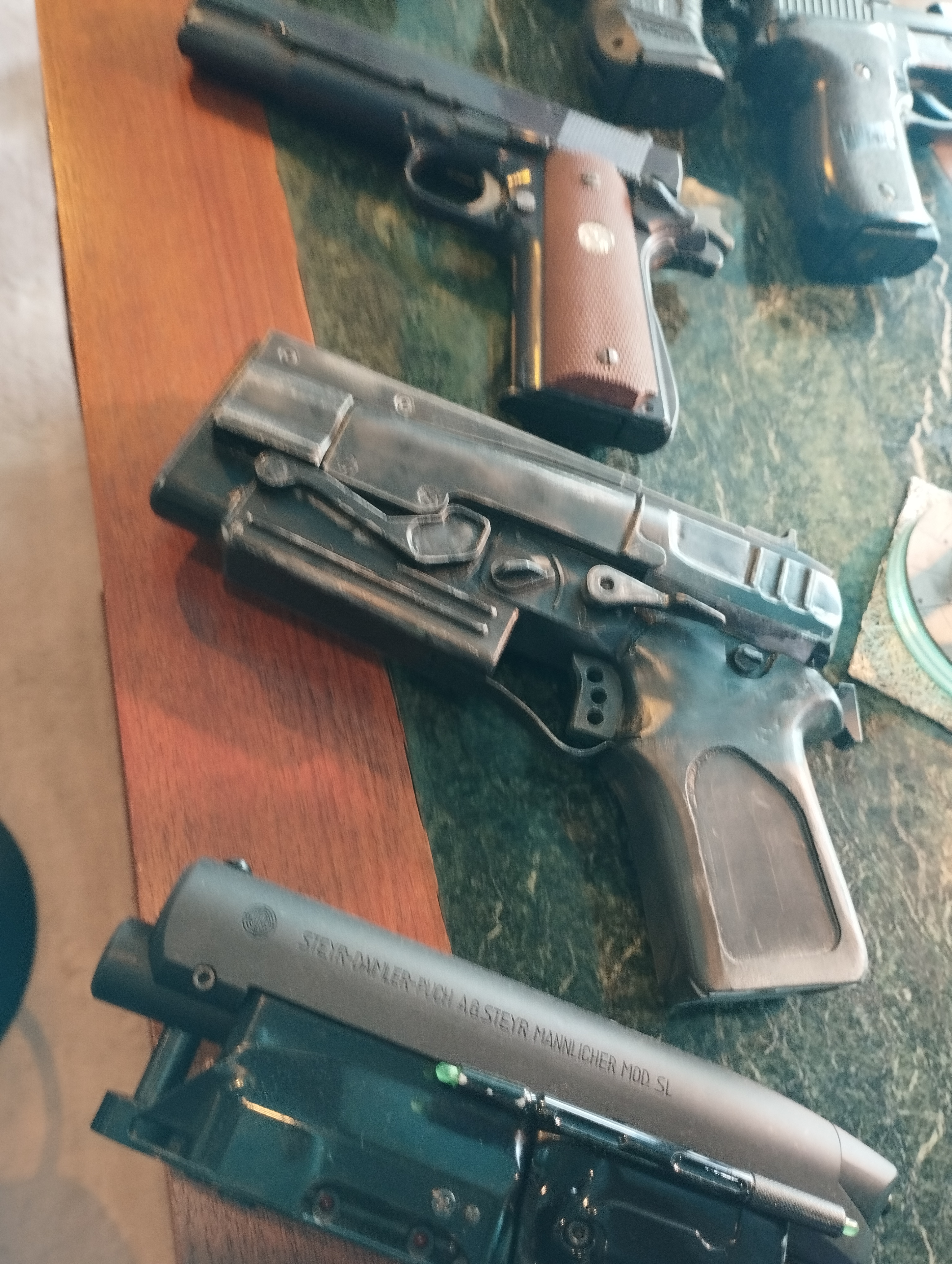

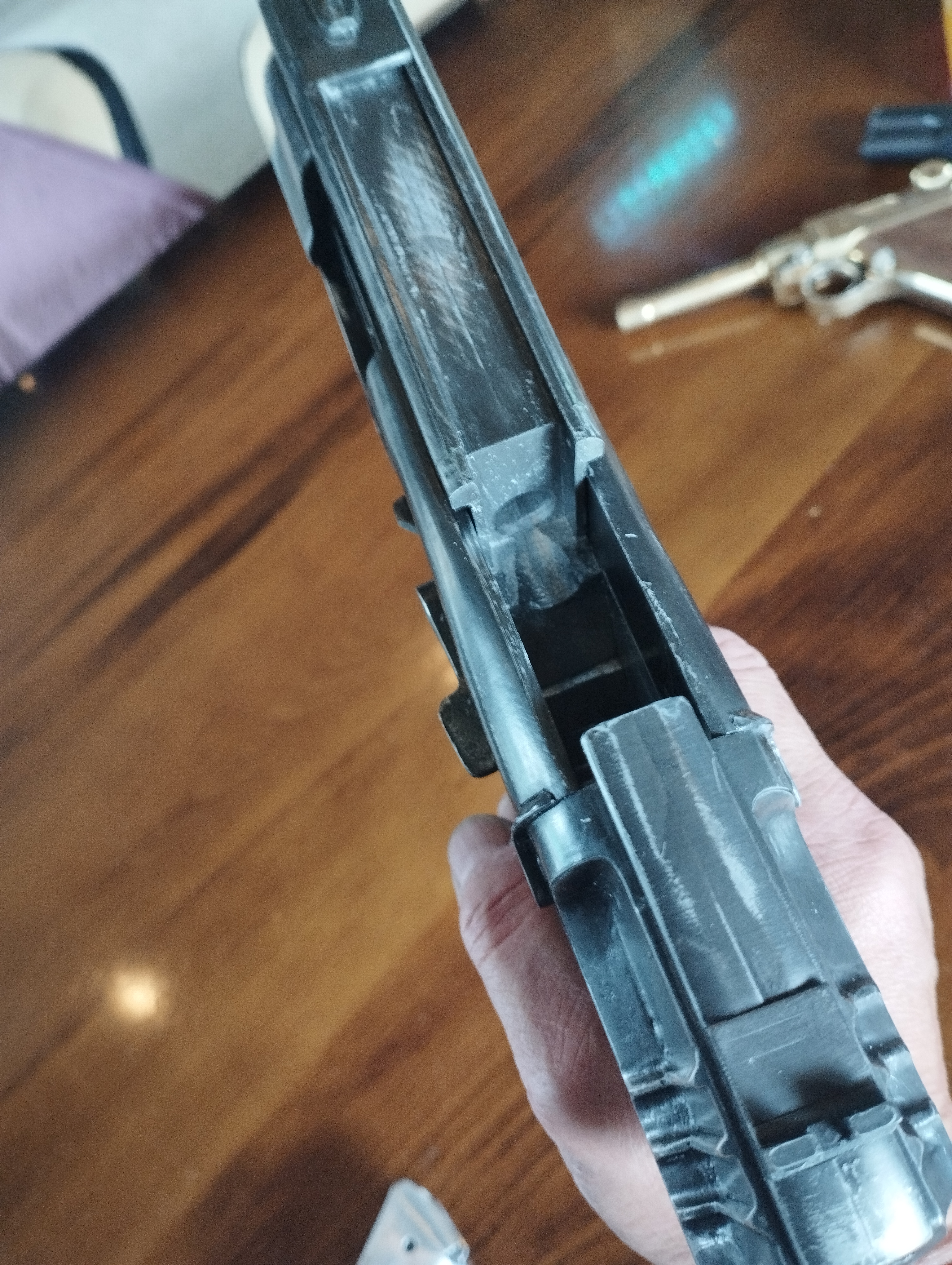

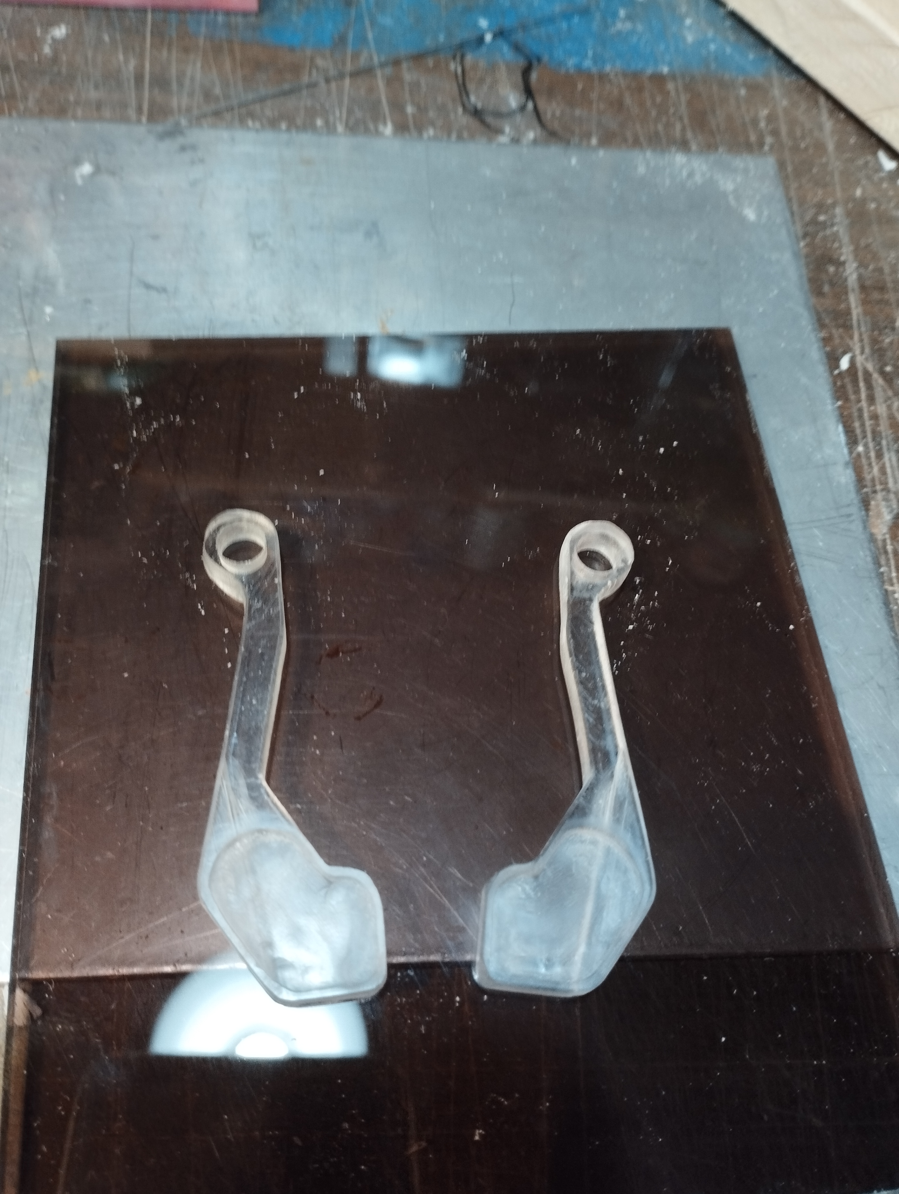

Today, I built these parts.

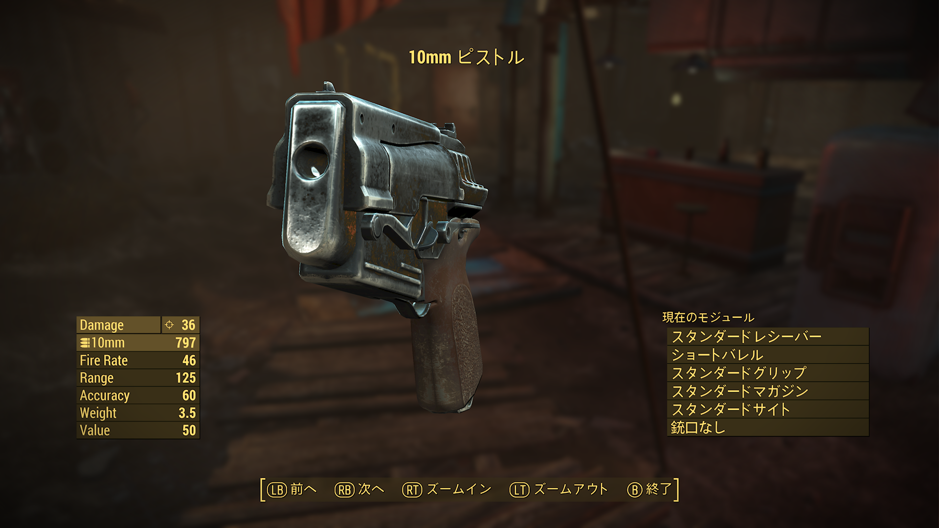

I'm not an expert on the gun but I guess it is some bolt-locking system (A mechanism that prevents the bolt from opening until the pressure inside the gun barrel drops to a safe level) because there is no tilt-locking lug on the barrel like the Colt 45 automatic. It is just another fictional gun in a game that doesn't exist but Fallout is the American game. Some experts of the gun might designed these. So these parts might have some meaning. Also, I guess this gun might be gas-operated because I see a gas port in the barrel near the muzzle. It is fun for me to imagine those those.​
If anyone has any comments, please let me know.​
I love guns!
Thanks for watching!
katsu
It could also be an overly-complicated dust cover, similar to those in an M249 or FN FNC, it would be in line with the screws on the slide.
Although I do like your idea of a slide lock too. It also could be some sort of a rate reducing mechanism.
_A

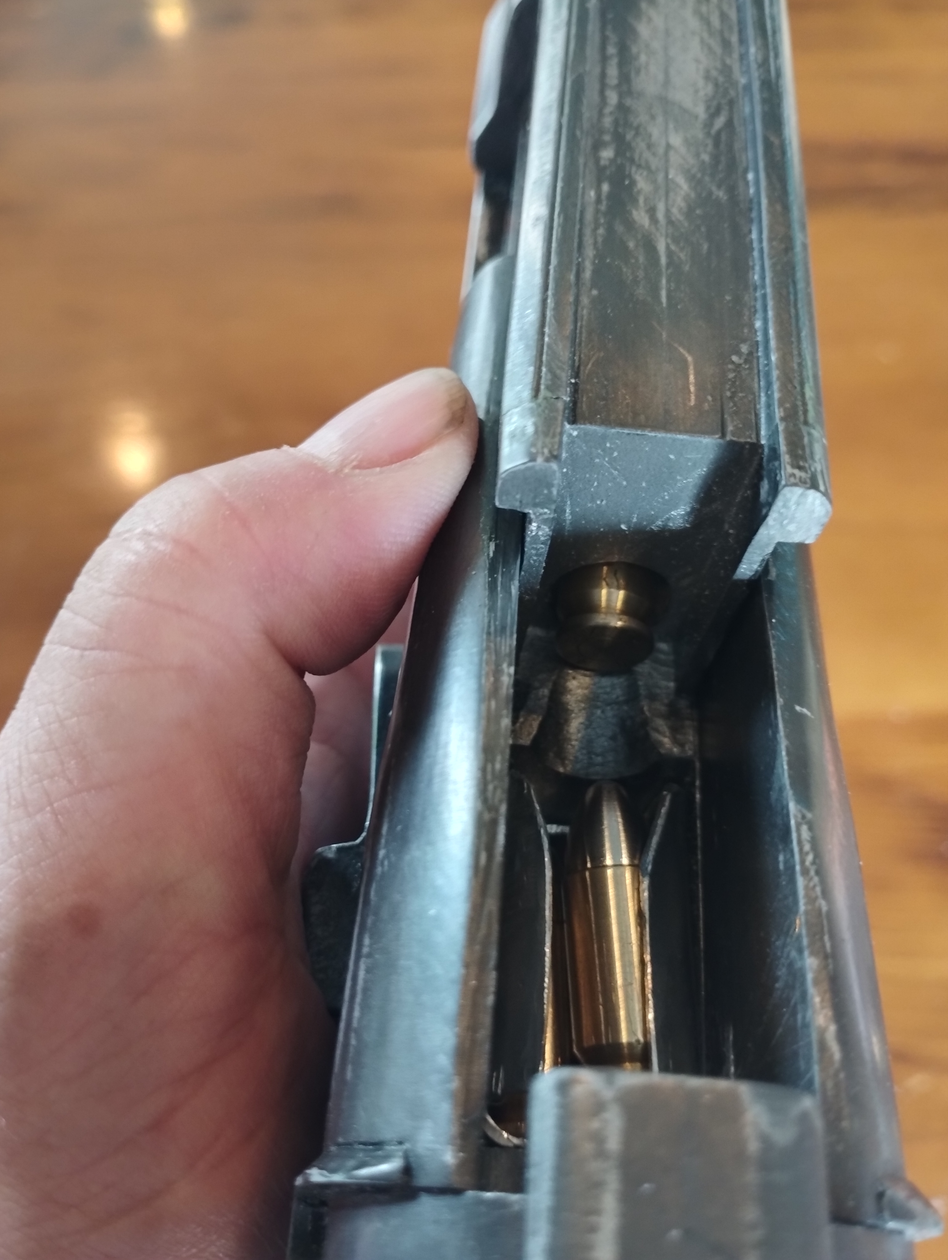

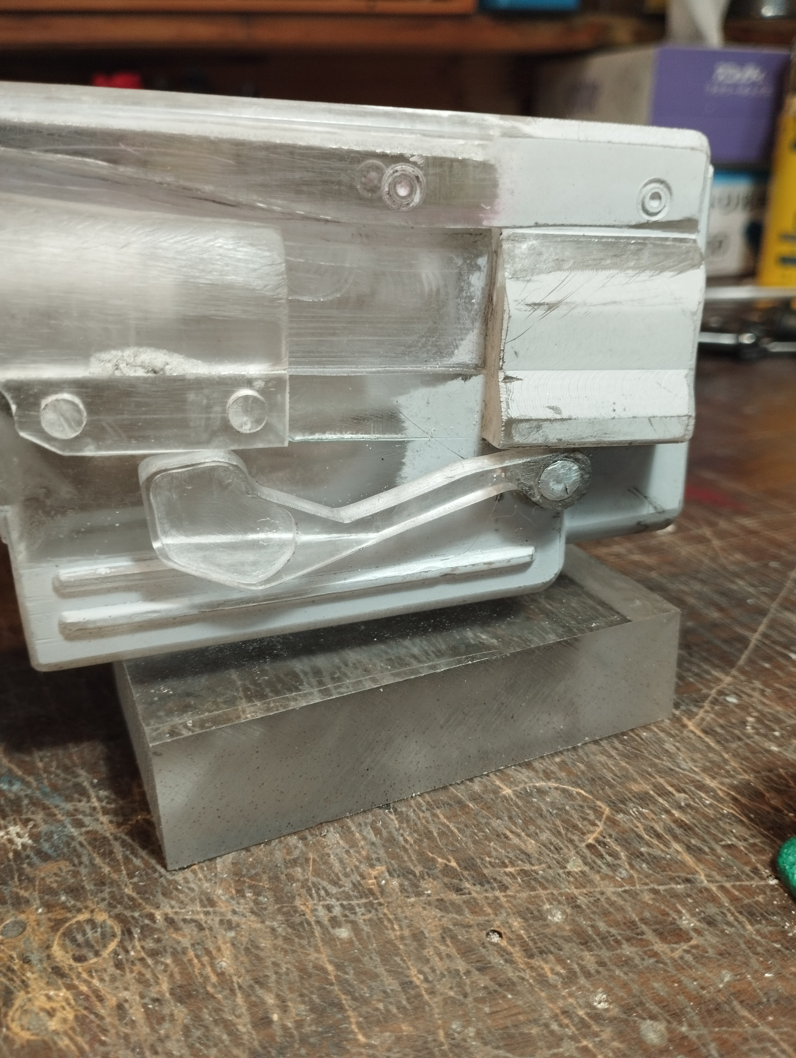

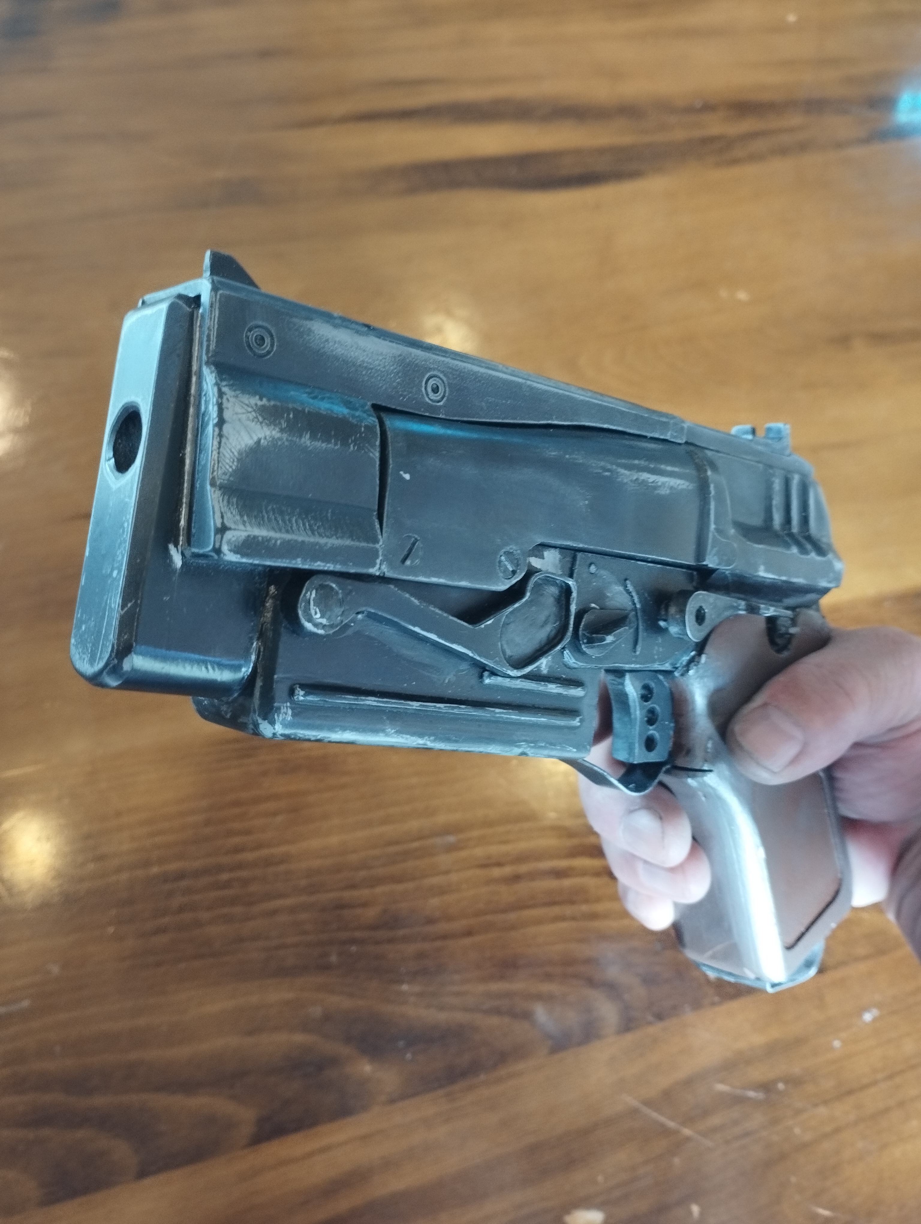

The hammer was fixed with a small coil spring, and the dummy trigger was fixed. Put the coil spring in a receiver assy- that was a complicated work - and connected the barrel assy. and the receiver assy.
I gave up the linking trigger and hammer mechanisms.
Honestly, I forgot to leave the space for them in a grip part. :p :lol:
The rest of the work is to make some parts like the slide stop lever and so on.
That's the easy part.
I have to think about the magazine and bullet.
Thanks for watching,
katsu

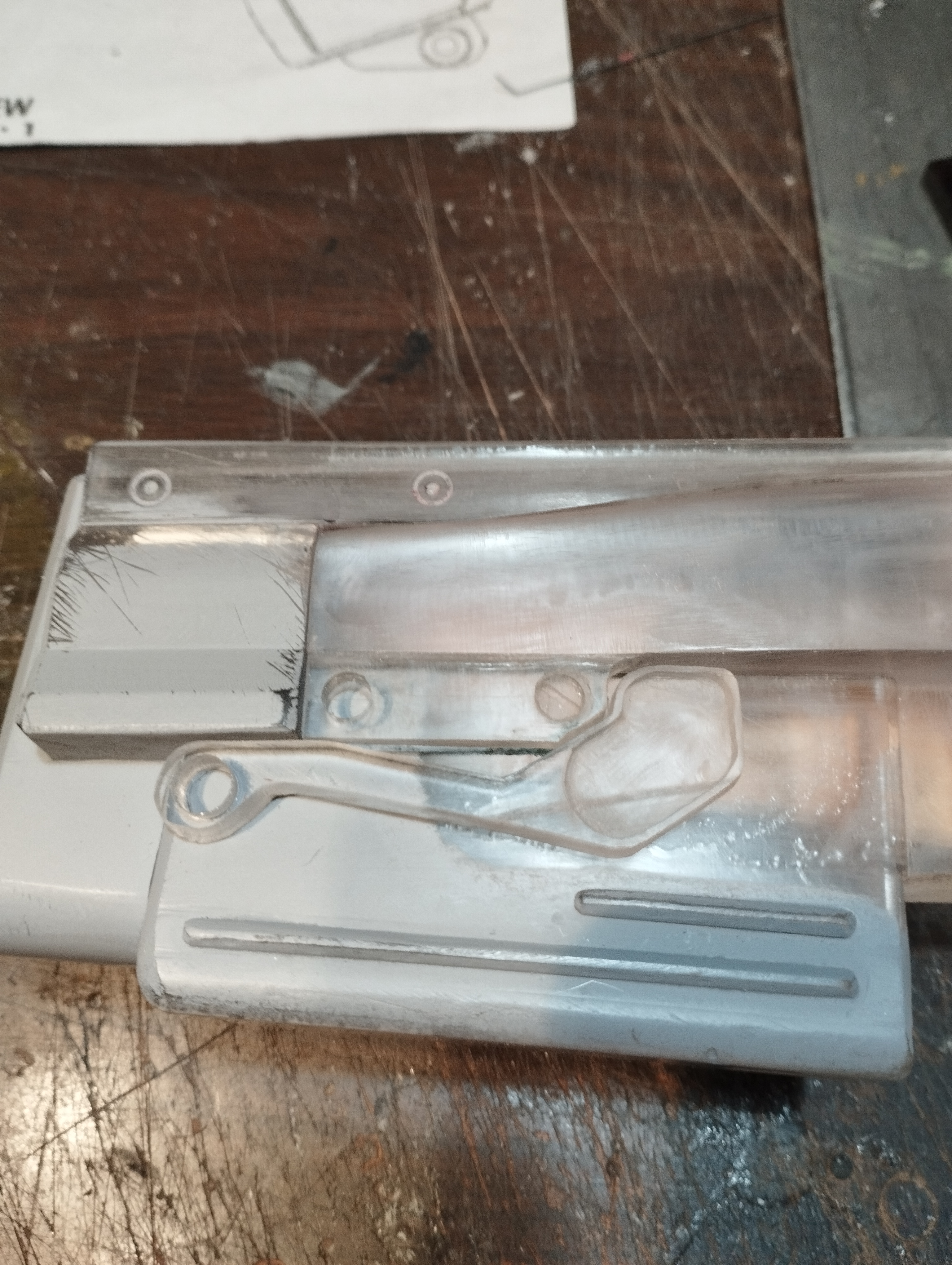

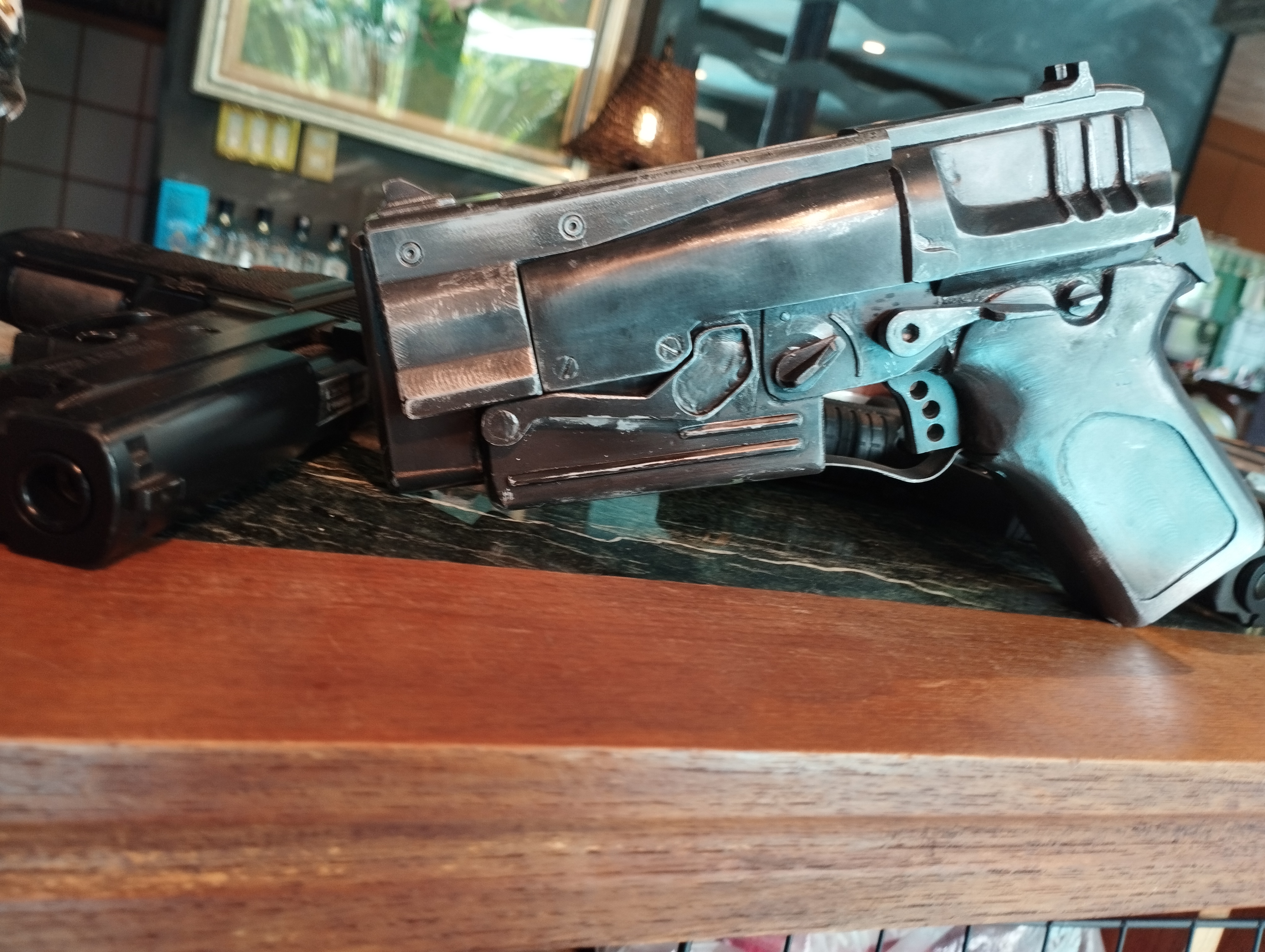

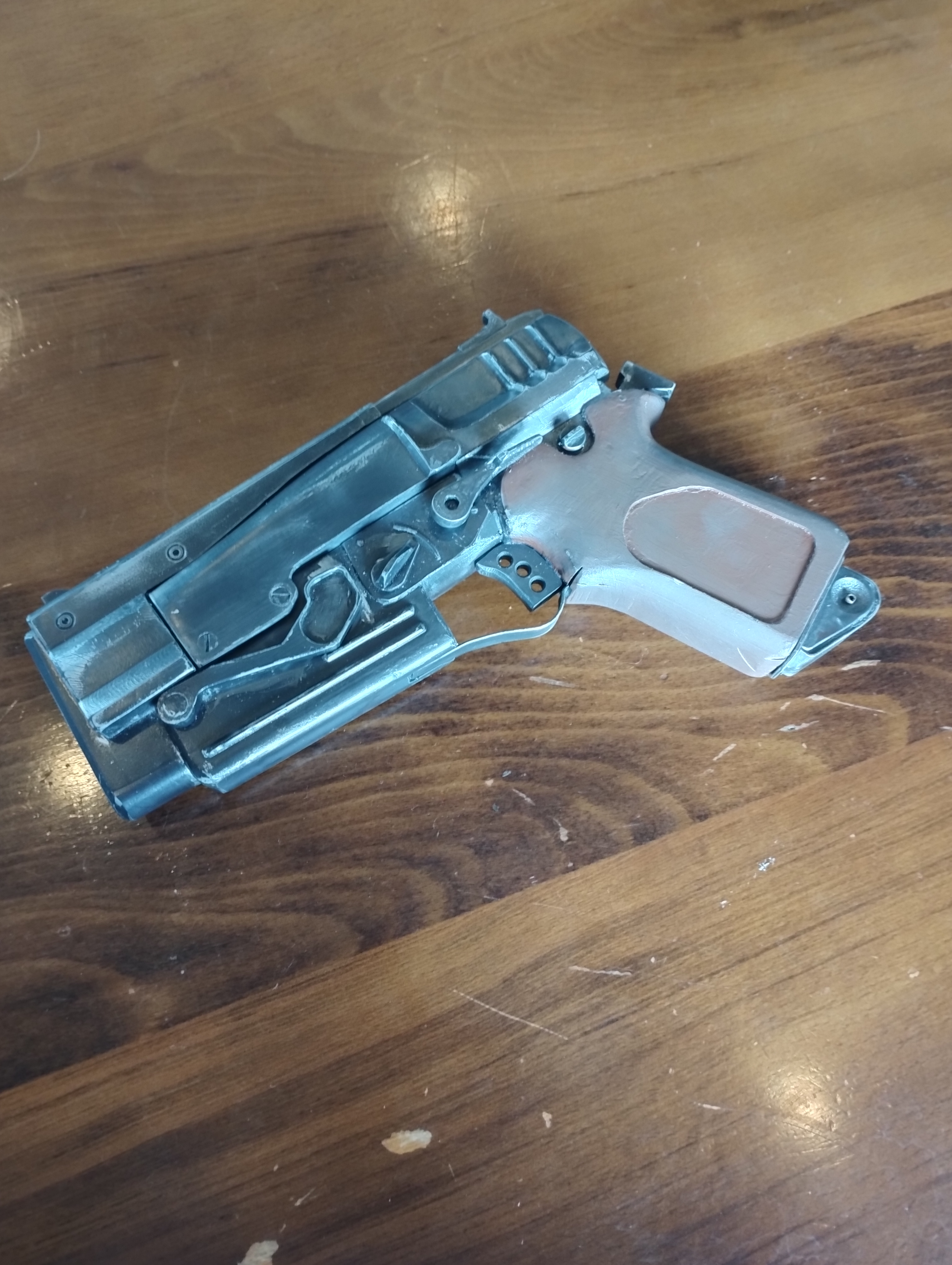

A paint job.

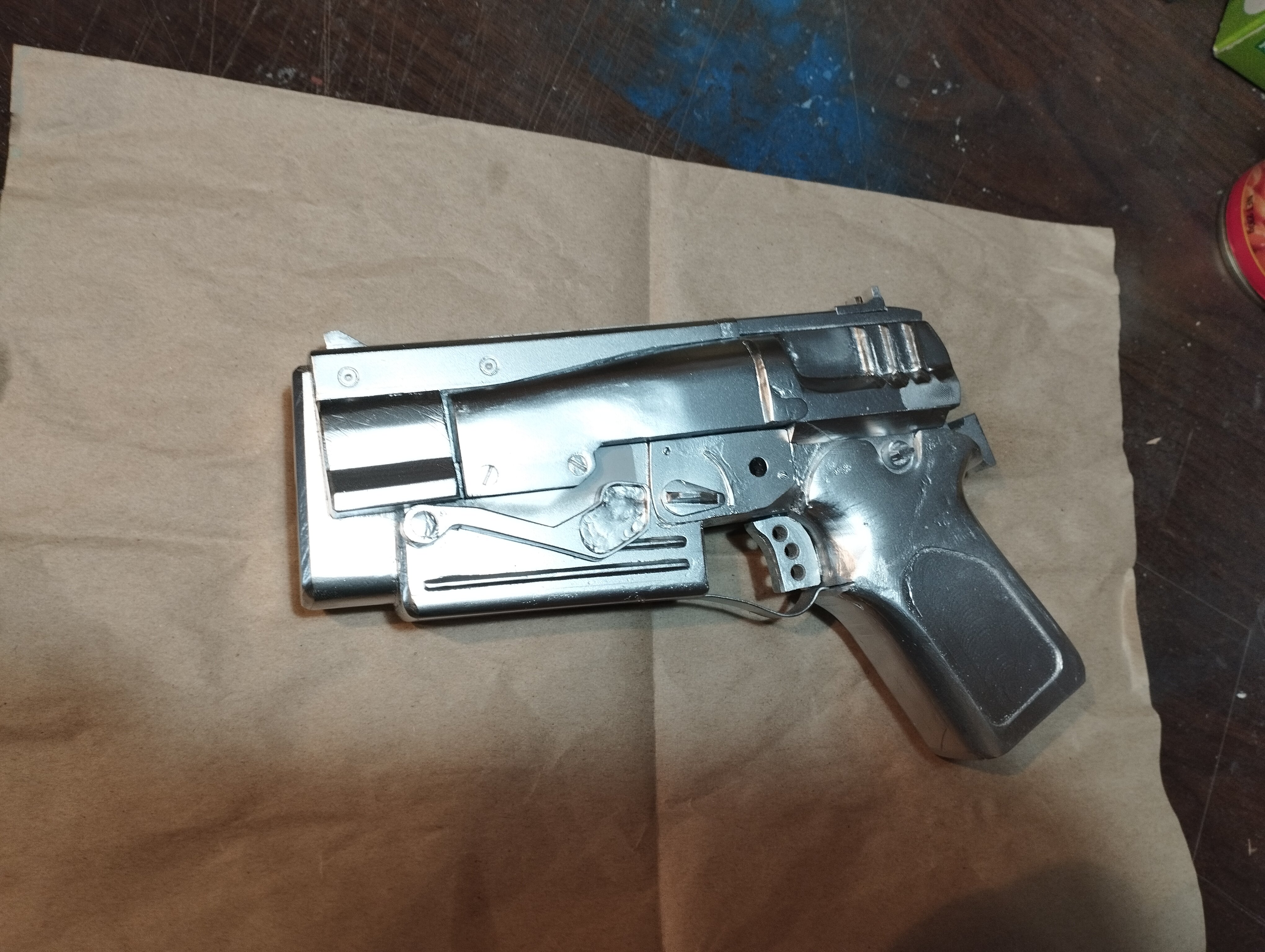

It took hours more than I thought to build some small parts but they were done and went to a paint job. Usually, a silver dry brush is used to create a weathering effect. But I tried the other way.
Primer applied.
At first, spray metal color all over.
It looks like a chrome-plated finish.
And then, splayed a black steel paint.
I polished it with 3M ultra-fine and micro-fine.
Carefully polished until the silver paint below is vaguely seen and ran 3M to leave a very smooth hairline on the surface.
The next things to do are make a checker on the grip and paint it. Then make a Magazine. That will be it.
