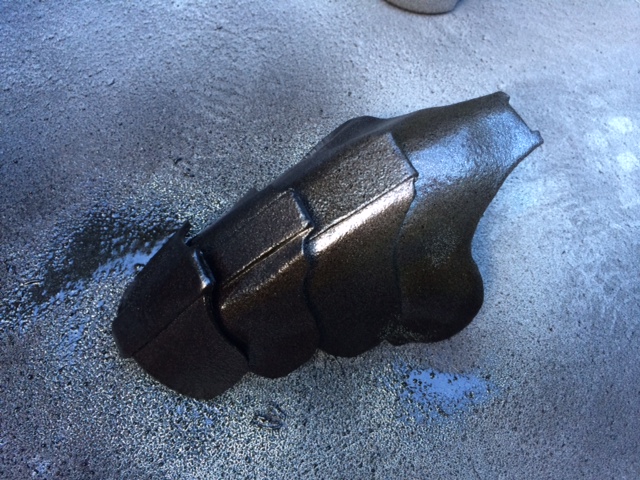

1. Worbla over foam: For the shin armor I did the sandwich method, which is basically sandwiching foam with worbla. I found this to be inefficient use of worbla because there is a lot of waste. So for the larger armor pieces I did one side with worbla and wrapped it around the edges. So with the more complex armor pieces like the kneepad I heated up a cutout piece of worbla over the finished foam kneepad. When it became pliable I started from the center front of the foam piece and started pushing down and around the foam so it went into all the creases and edges. I used a variety of tools to push in the worbla so it could have sharper corners, divets and whatnot. Then heating up the edges again and wrapping the worbla around the edges of the armor. For the corners I just squeeze the corners so I can get a nice 90 degree corner. Then use scissors to cut off the excess.
2. Dremel: After I was happy with the piece I worked on I moved to dremeling. There will be some overlapping of worbla or folds from trying to form it around the foam. I used my dremel on the high setting with a sanding cylinder and went to town. It's way easier than trying to dremel foam where a slight move can ruin your armor. I dremel around the edges of the armor usually where it's too thick or wherever I'm not really happy with yet. I also sand the edges and corners of the worbla so I can get a sharper edge.

I used the same technique as I did with the wrist guard (eva foam/worbla) technique with all the other pieces of armor. I was going to use velcro to help the thigh pieces stay on but felt like the velcro wouldn't last long, so I found a tutorial on how to install snaps and the armor snaps on the body suit. I ended up finding a local guy to sub dye my suit and found a seamstress to sew it. She sewed it upside down :(. But eventually I'd like to replace the body suit and body trim with the stuff that MaskedRider has come up with.
