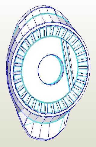

George, I mean that the pep file here is designed for paper/cardstock and needs modification to work with 1/4" EVA foam. For example, many of the darts/relief cuts aren't applicable/needed or are too small to be practical for use with foam along the sides of the helmet. Of the image here, the squares on top need to be integrated into the surrounding shapes, the folds on the facemask are replaced with heat-shaping etc., and once revised one tries to get shapes that don't need to span many pieces of 8.5x11" paper.

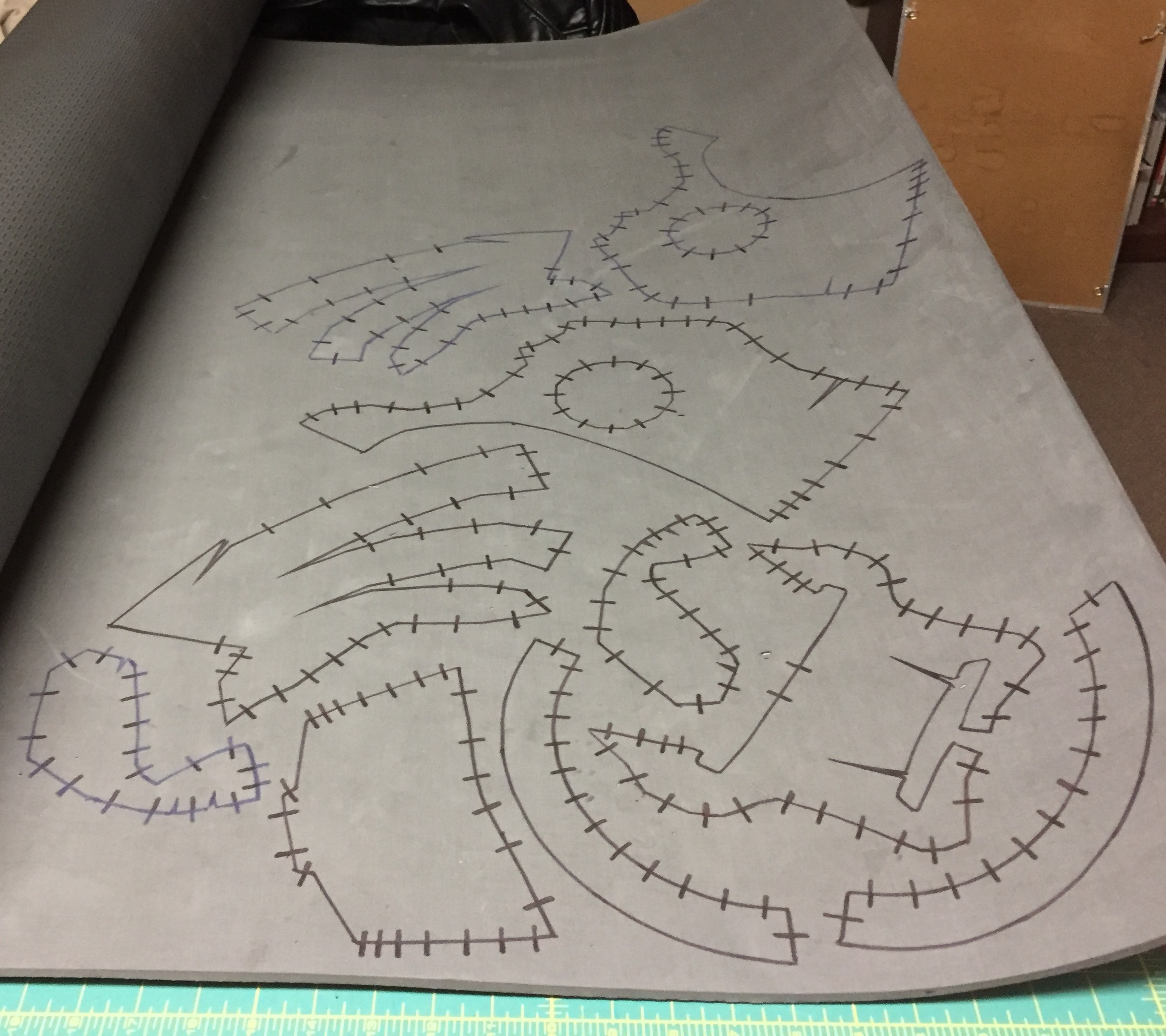

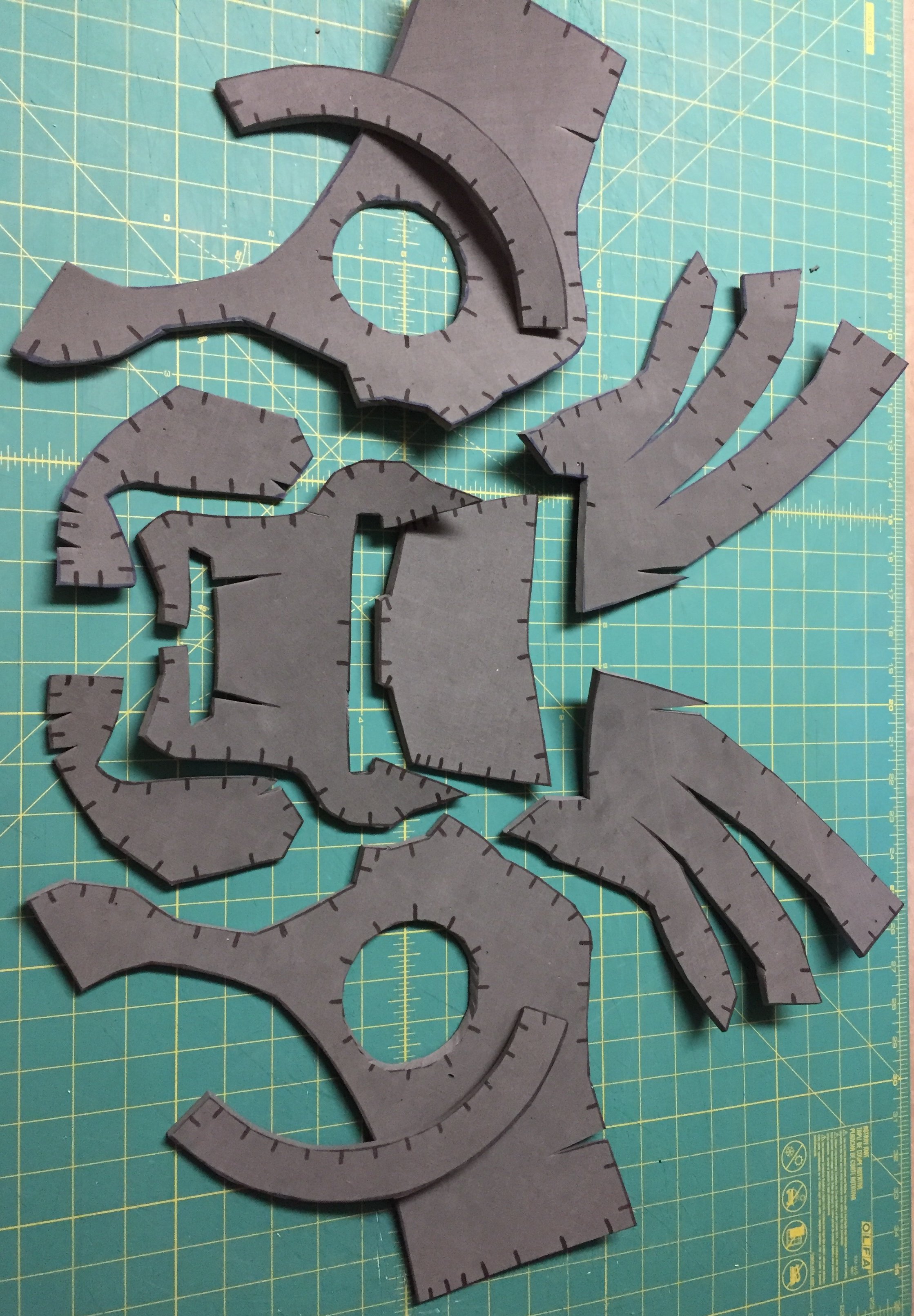

I've done my attempt at editing this - first time using Pepakura Creator 4.16 - and tonight seek to glue the parts together. They are up-sized by 10% thanks to use of a foam caliper via Wayne's Workshop of YouTube.

I see.But some of the cuts are actually part of the model, even the ones in the face plate are meant to make that curve, I think in cooperation with the heat gun.The program dissects the 3d model into parts with cuts for a reason.I don't think you can just omit some, as it will affect the design.
Your foam pieces look good though.I think the biggest difference between paper and foam building is depth, since foam has thickness and thus edges.Small edges that are replaced by thickness of foam can easily be separated and omitted from the design, and the rest can be fused/altered according to your own point of view.

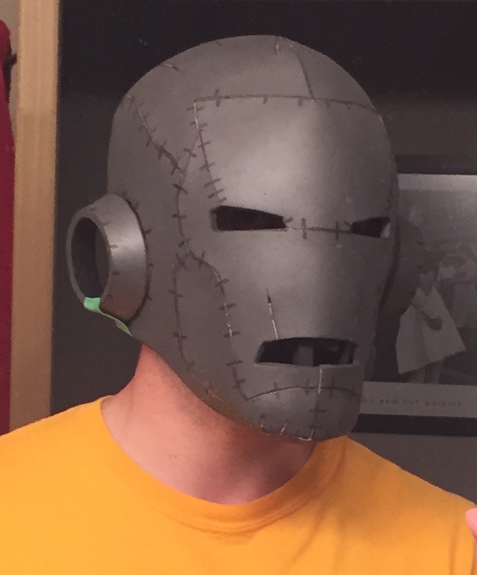

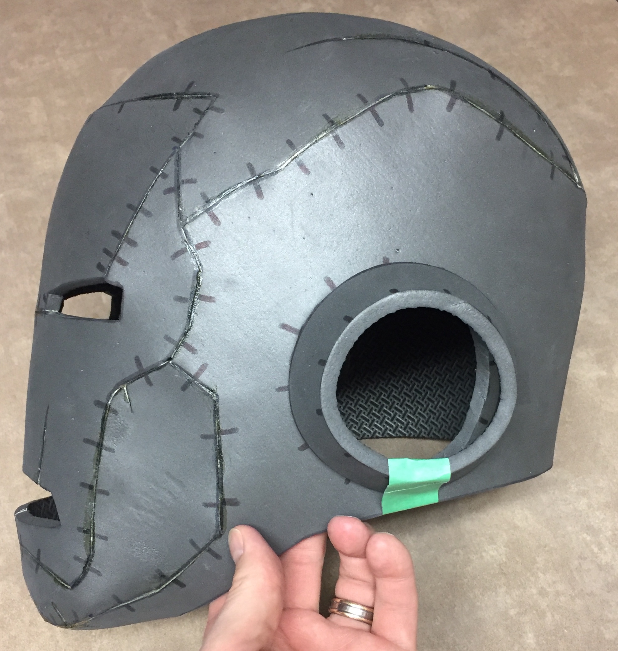

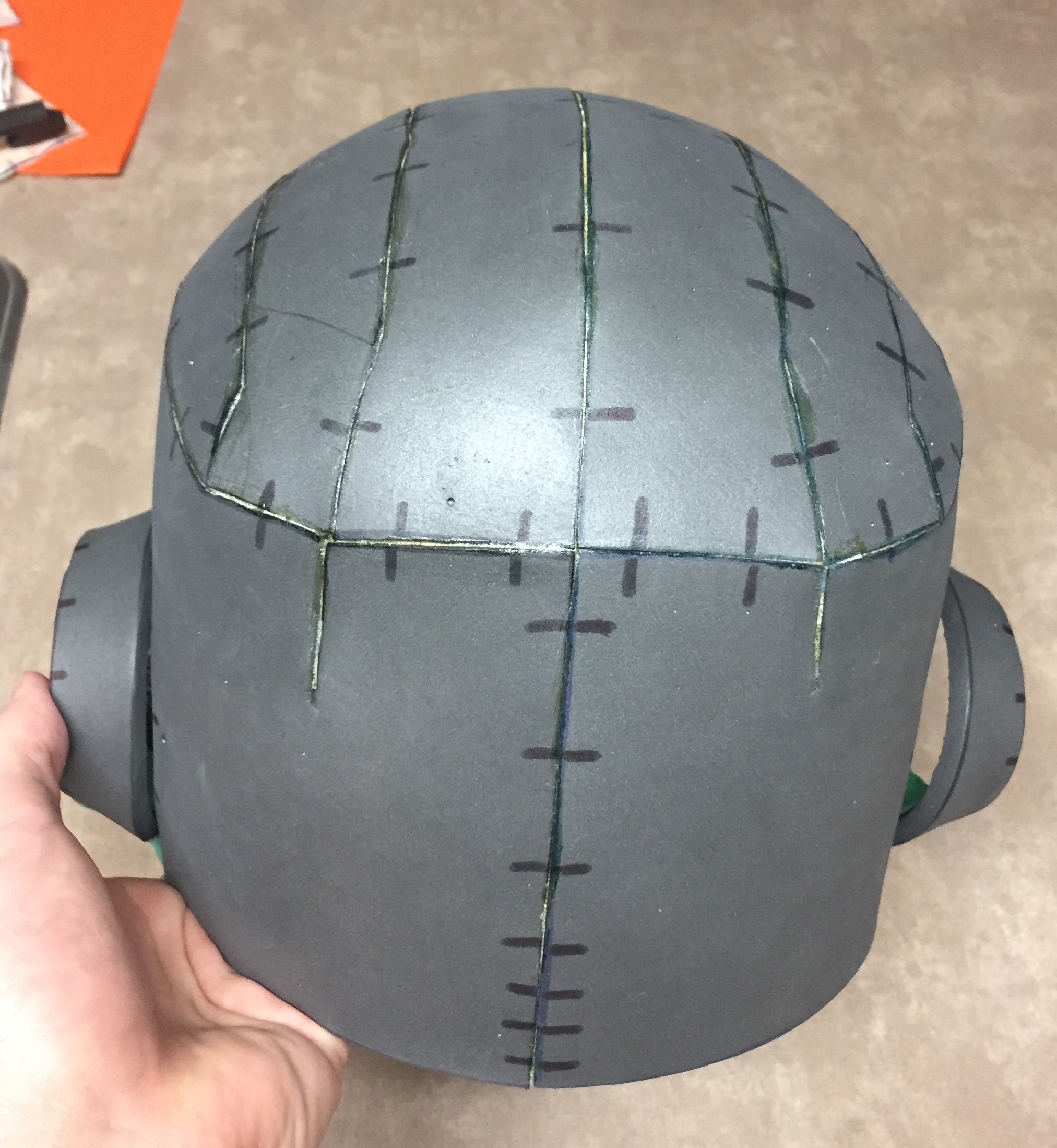

Indeed, there's a sliding scale of importance of the curves. It took me a record 4 hours to glue this together as well & carefully as I could, being my first try with these shape sizes & 1/4" foam. The upper forehead would have done a bit better with that relief cut, but I'm satisfied with how mine turned out there. It was a fight near the end to get the seams lined up..!
I've yet to re-heat shape after gluing but will do so (lower lip is most obvious part). I do have a fair bit of work to do cleaning up the seams, but I think I'll use this first attempt for the costume. Happy with the results!
There is enough space for 3/8"+ padding within which is what I was hoping for. I've a large head and this is +10% scale. It is clear I'd have a hard time getting it on/off if smaller, though once on it might be ok.
