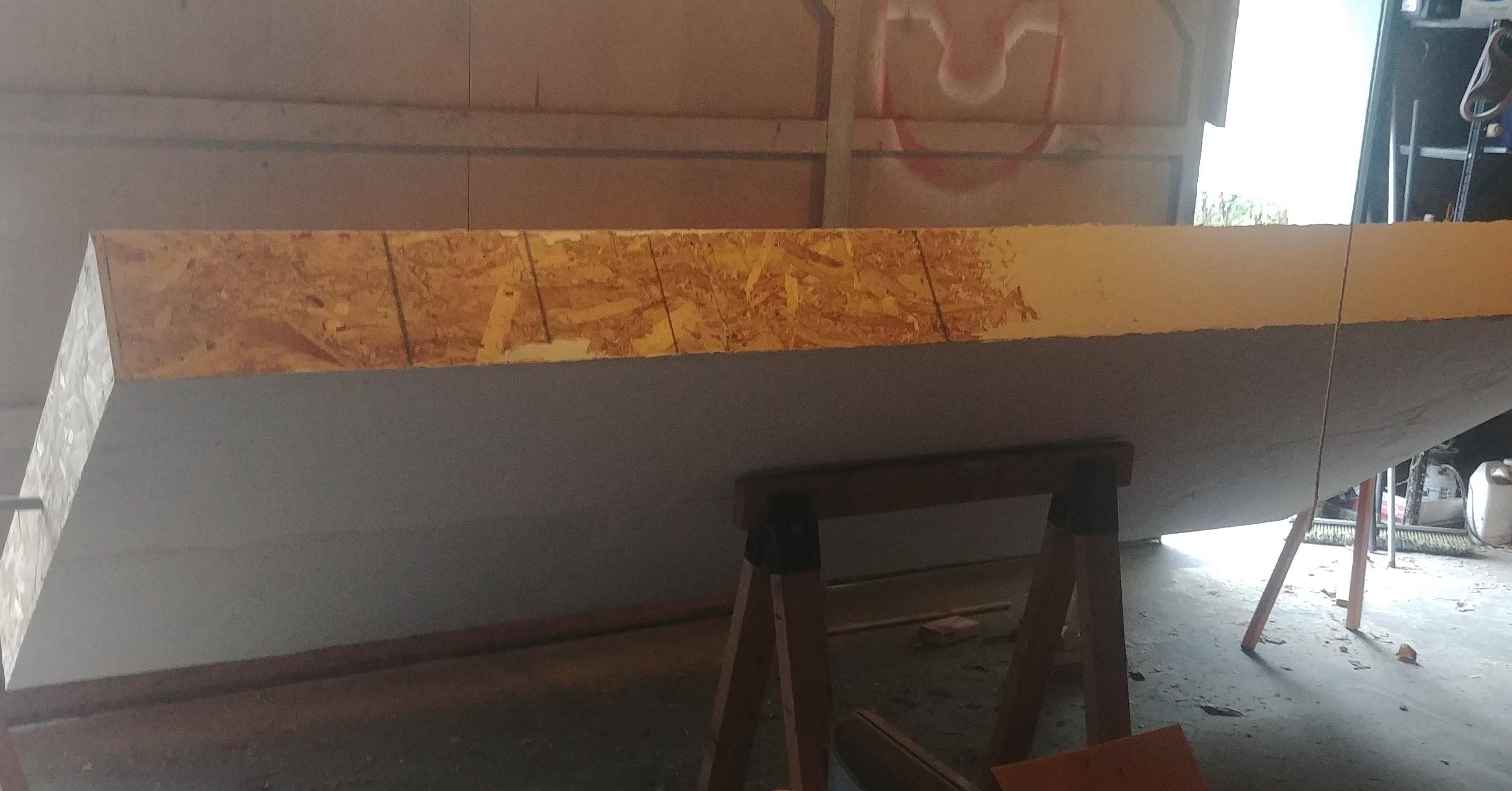

The OSB cladding has a smooth side and a fuzzy side, and except for one mistake I put the fuzzy side out. That was so it would stick to the coating, for which I used Easy-Sand joint compound. Sanding was mostly by hand using a rasp that I had configured (bent) to have a flat side. The final pass I made using an orbital sander, and my shop will have traces of that dust forever.
