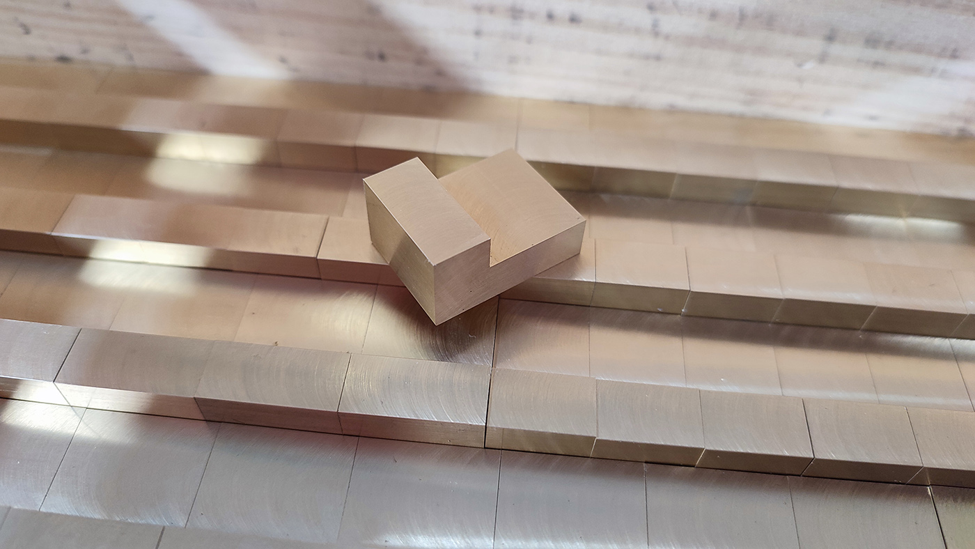

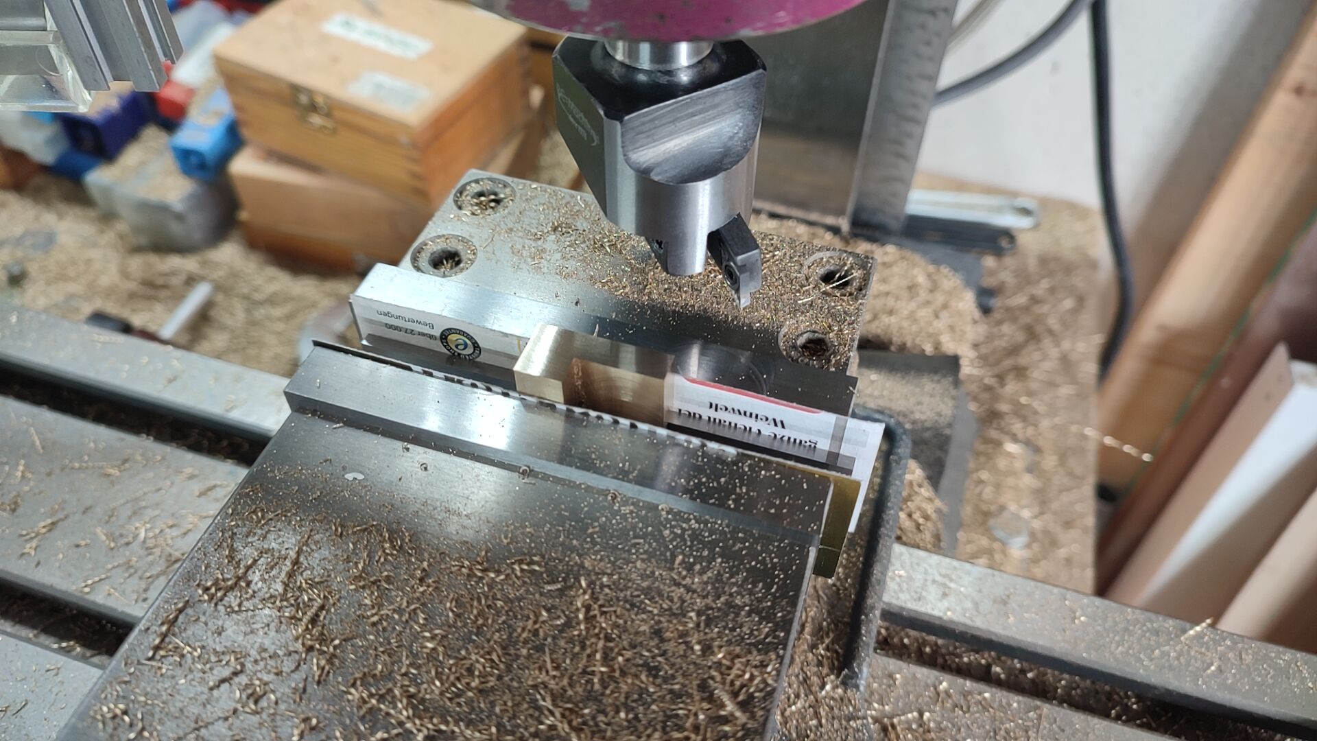

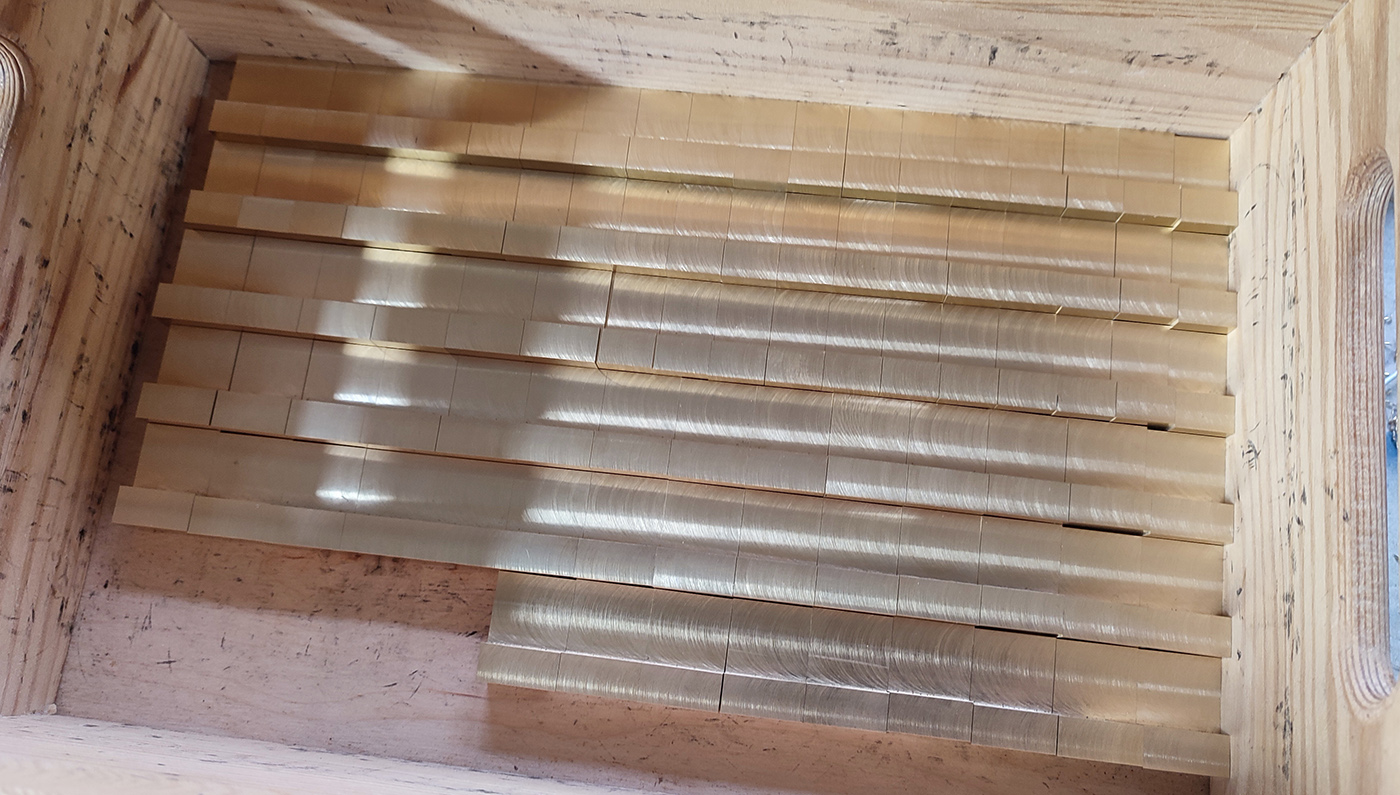

I machined the clasps for both sizes,
I started by cutting several lengths to machine several clasps at once and gain some time compared to machining each part one by one:
then machined them to size:
then i cut them to the final size and machined both sides flat and to the final thicnkess:
lots of small golden parts!

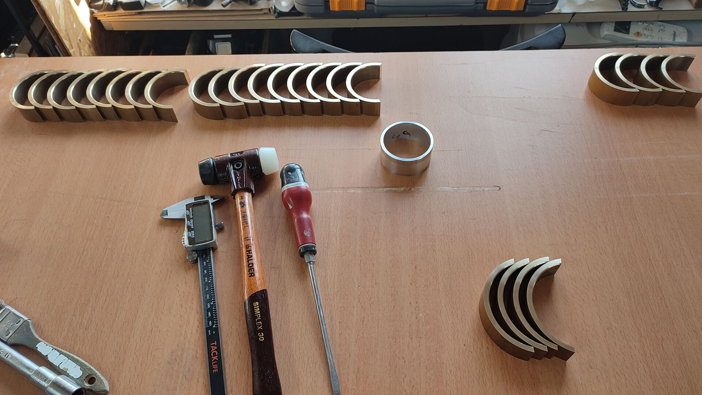

second big step, I beveled all the inside of the rings with the wood router, the wood bit survived the 2x 86 sides to machine, all good :)
sorry, lots of blurry pics lately, maybe my phone needs to be cleaned or something!

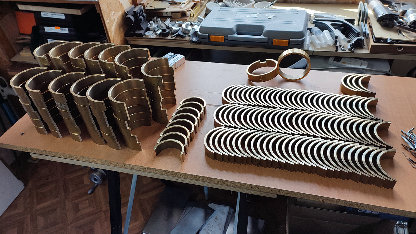

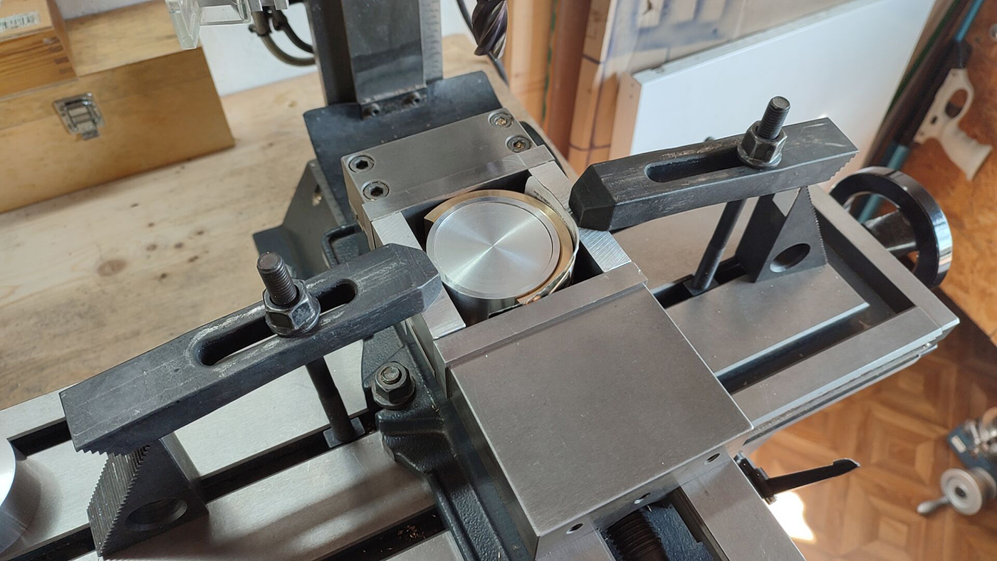

I have milled the ends of the Chewie cuts, clean and to the proper height. Basically, I put the C shape at the bottom of the vice, alight the top ends, then I go to a certain depth on the clasp side, and 6.2mm deeper on the hinges side, and I mark the hinge side with a small marker dot for later on :)
alright, this took a while to do on all 84 of those!

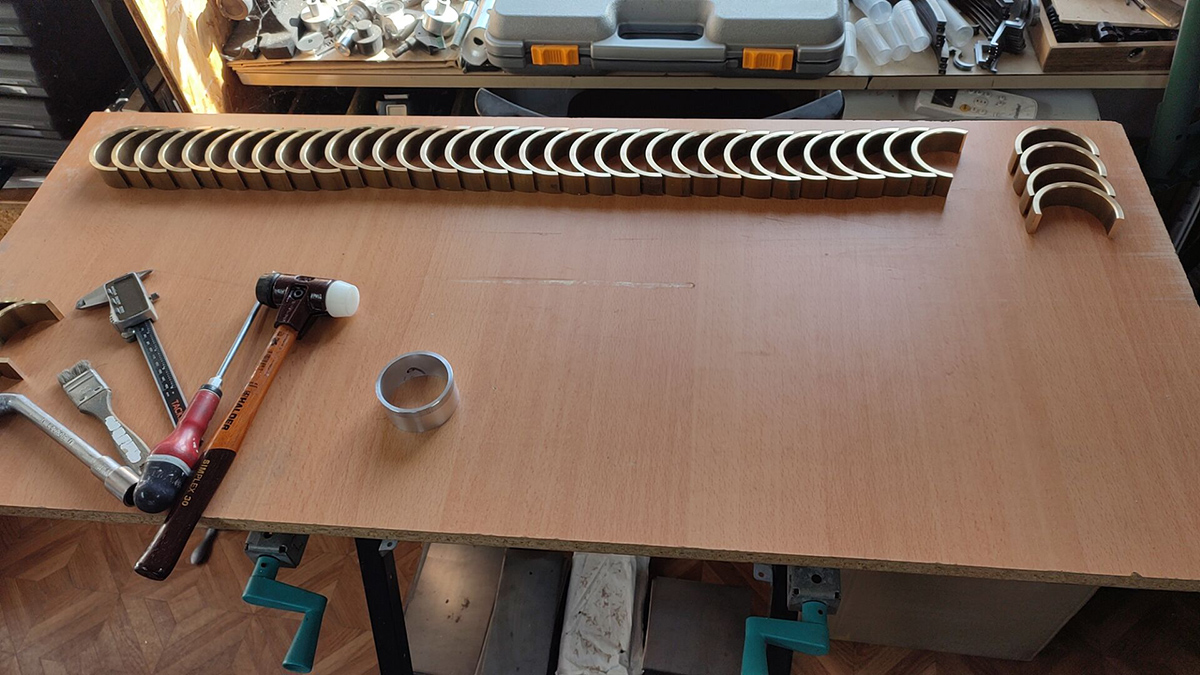

Now, as the Chewies are very demanded, I really want to release both Leia's and Chewie's together and give a chance to everyone to get a Leia instead or something, so I want to move forward on the Leias too so they don't get behind.
So, I started bending the parts to size now :)
after a few, I realized it worked a bit better with adding a sheet of aluminium on each side, the alu won's mark the brass and it will also slide along the vice steel at the begining of the bend, preventing even more marks to be done on the brass :)
