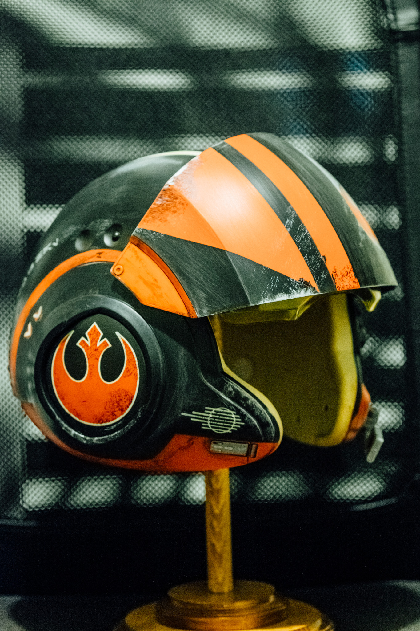

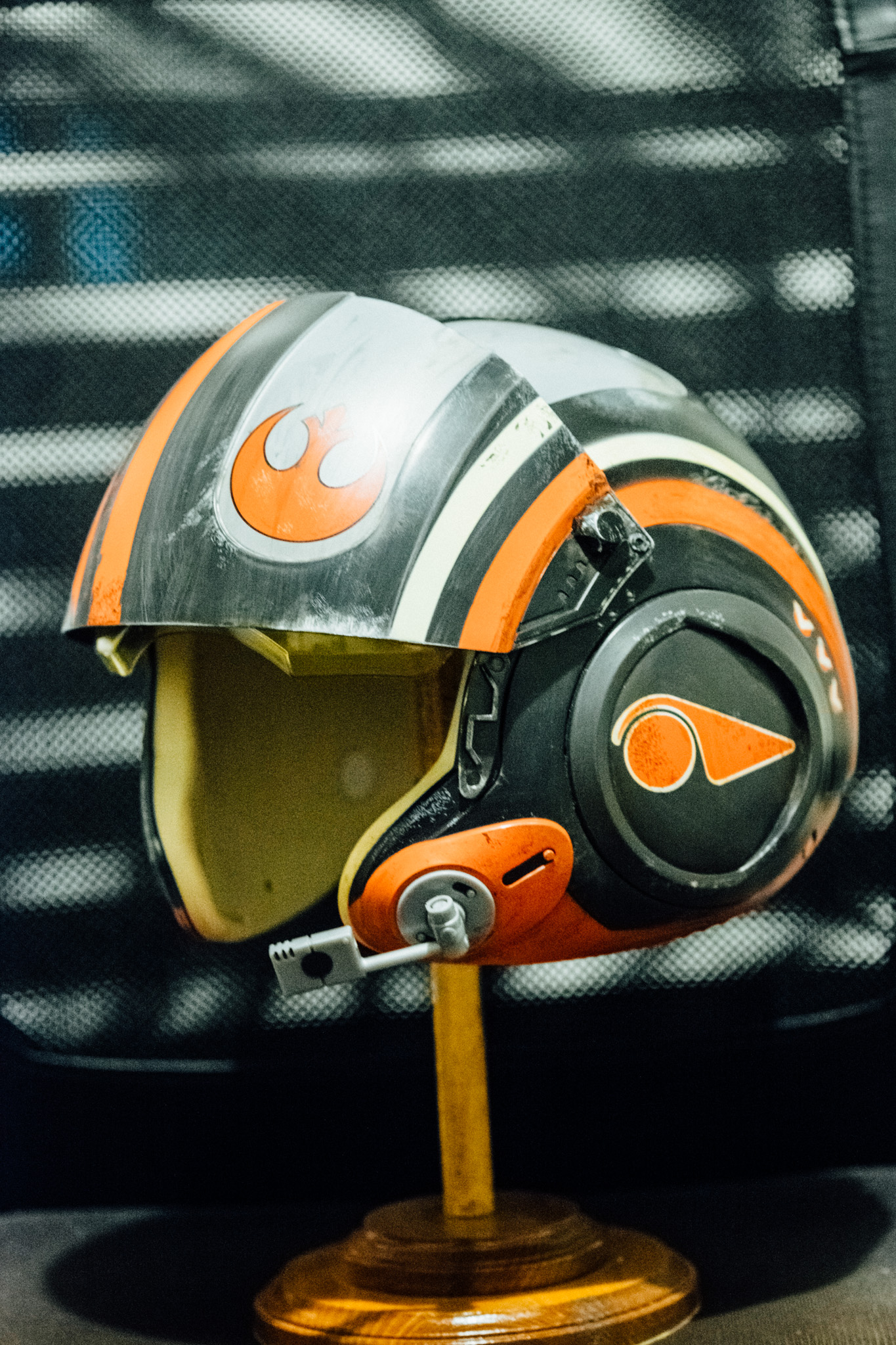

Progress so far on my repaint. A light scuff with sand paper then more finer sanding with steel wool. Followed by a burnt umber and carbon black weather with a chip brush and a rag. Then some rub and buff silver on the edges and raised areas. Still more to do, contemplating fixing the mic with an aluminium rod and then respray with chrome. Very pleased so far - not looking for 1 to 1 accuracy, just want it to look real.

The process was relatively straightforward. I disassembled the helmet. The only tricky bit here is the rear right "data port" greeblie and the right cheek "latch" greeblie. The data port is glued in and you have to break the glue to get it out. The cheek greeblie is held in firmly and there is are two retaining tab in the rear that one of which needs to be removed to get the greeblie out. The rest is straight forward.
I removed the electronics since I am wearing this as a costume piece. Then it's MOSTLY paint. The only physical mods were: Replaced the thick plastic stalk on the mic with a metal rod. Added the black wire after paint. Replaced the rigid plastic wire on the left rear greeblie with thicker black wire (after paint). And I cut up the cheek greeblie and glued it is the holes sitting up slightly proud of the surface (after all the paint. I did glue the two ear cups in place. I used Rustoleum semi-gloss white as the base. I used Rustoleum "ink blue" for the blue areas, Valspar Chrome for the mic, and and vallejo model color paints for the details. I used a black wash on the liner to dirty it up. Weathering is done with needle files, sandpaper, raw umber and burnt umber paint, and fuller's earth.

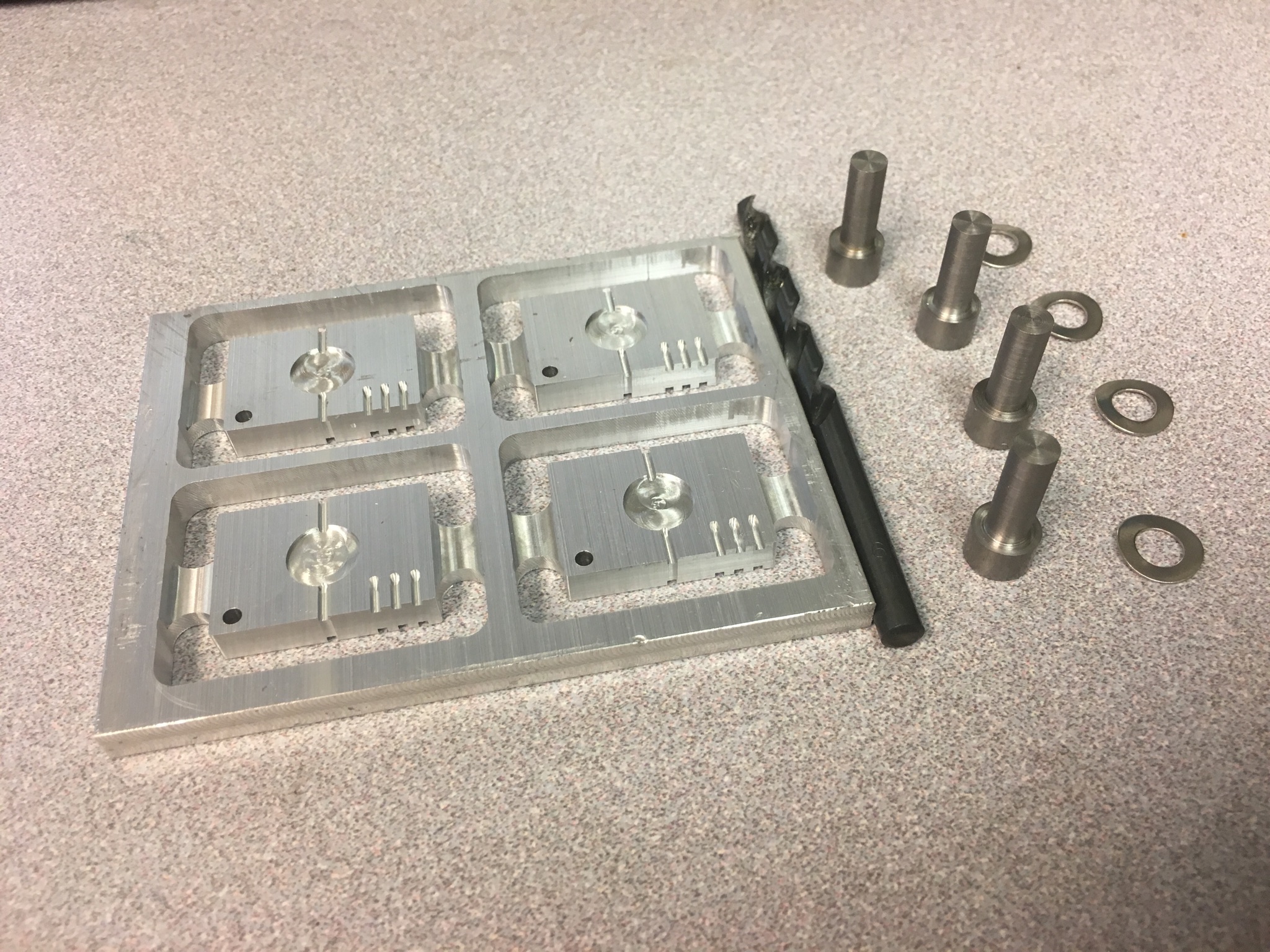

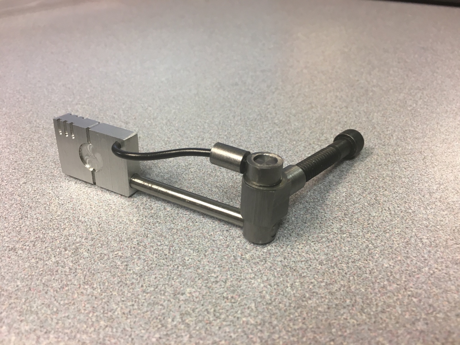

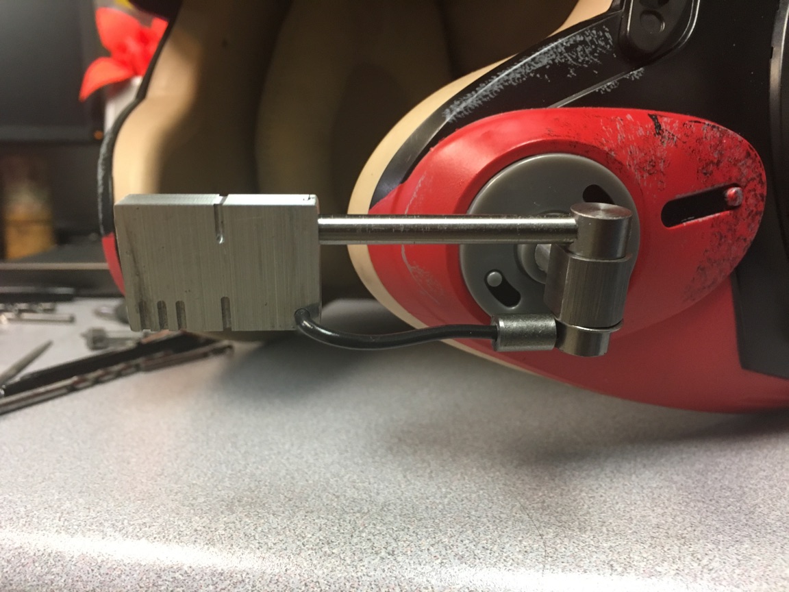

Hey gang!
I just wanted to let you all know that I haven't been idle while working on these parts. I'm waiting on a part for my lathe and then I'll be finishing a few more of the parts that we need.
More updates to come!
WANT :cool

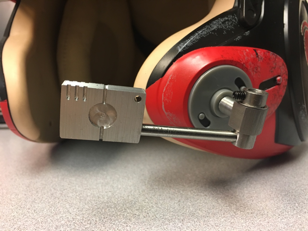

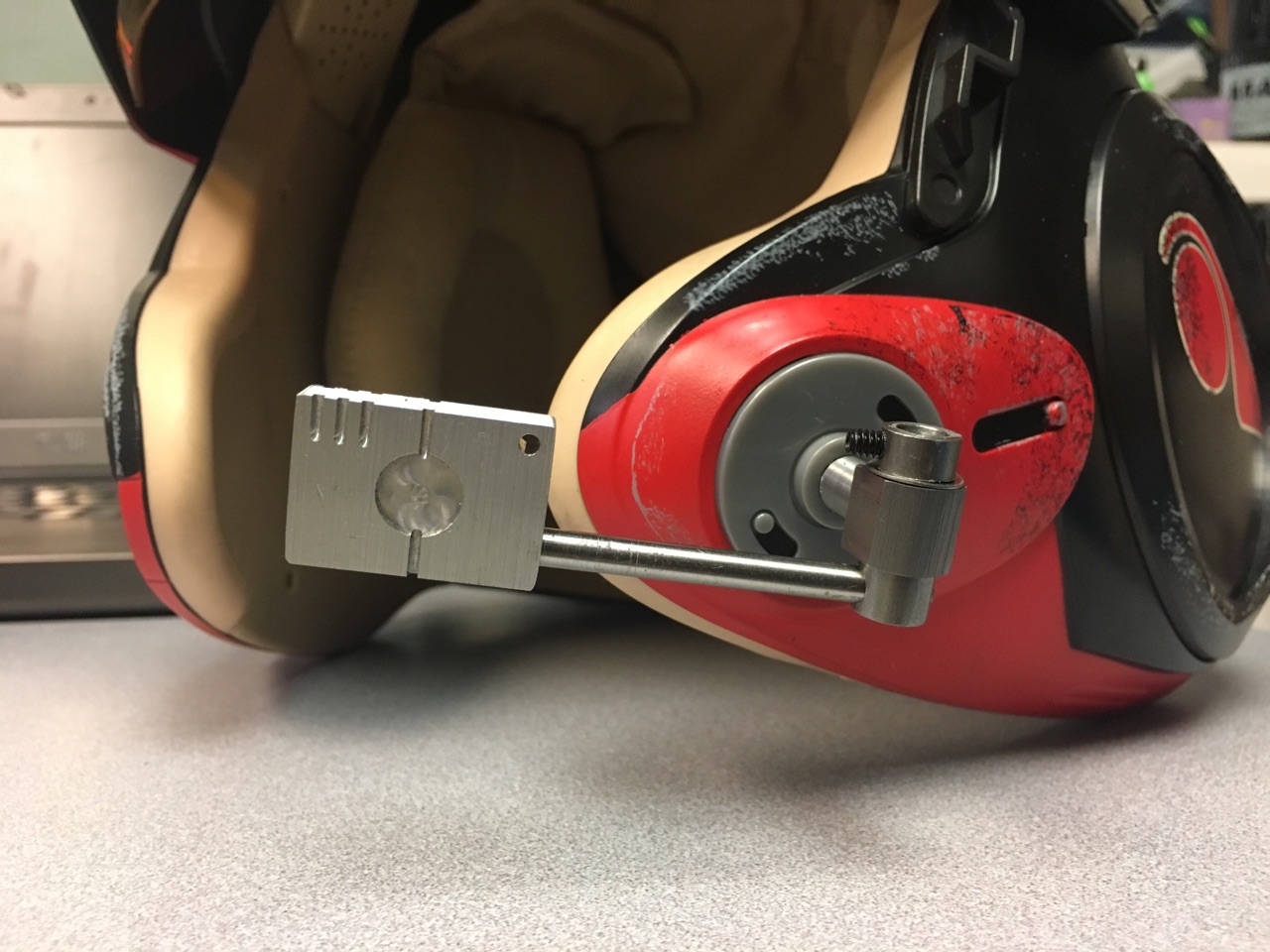

You guys want to see something cool? It's not done yet; I still need to mill the circle on the other side of the microphone tip.
The microphone is simple to install; just drill a 1/4" hole through the helmet and screw on the stem of the microphone.
