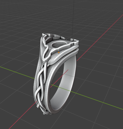

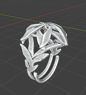

I guess an update is overdue on this project!
This project is still alive, but the scope has changed pretty significantly... and I don't where this will lead me, but at least I'm having fun!
Specifically for this project, I've spent the vast majority of the last 2 years (other than real life stuff like work and kids :)) looking for good references on all the rings, talking to people (including Dallas), teaching myself blender and trying to recreate highly accurate 3d models of all the major rings (other than Vilya which I already have from Jens Hansen). I think I've collected a pretty good amount of references, some of them public, some of them not. By now, I believe I have very accurate models for most of them, and I'm going through a constant loop of modelling - 3d printing - adjusting, until I'm fully satisfied with the physical model. Once I'm there, I intend to either have them by cast or cast them myself if I can invest the time and money into a small lost wax casting equipment.

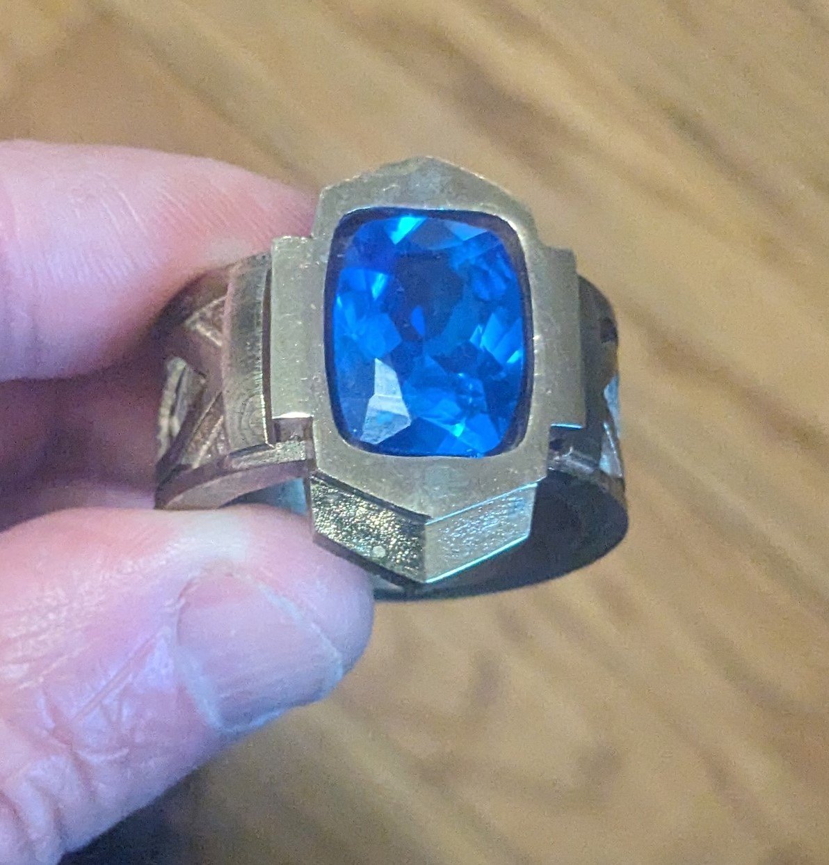

I've already had one ring cast (ring of Thror), and I'm pretty happy with the result. Still needs some gold plating and finishing but overall the model is very accurate to the on screen version as it was based off of production close ups.. As I said I don't know where this will all lead me, and this is a multi year project, but this is a lot of fun! At the very least, I will have the most accurate 3d models out there for most of the rings! What I do with that is still TBD..

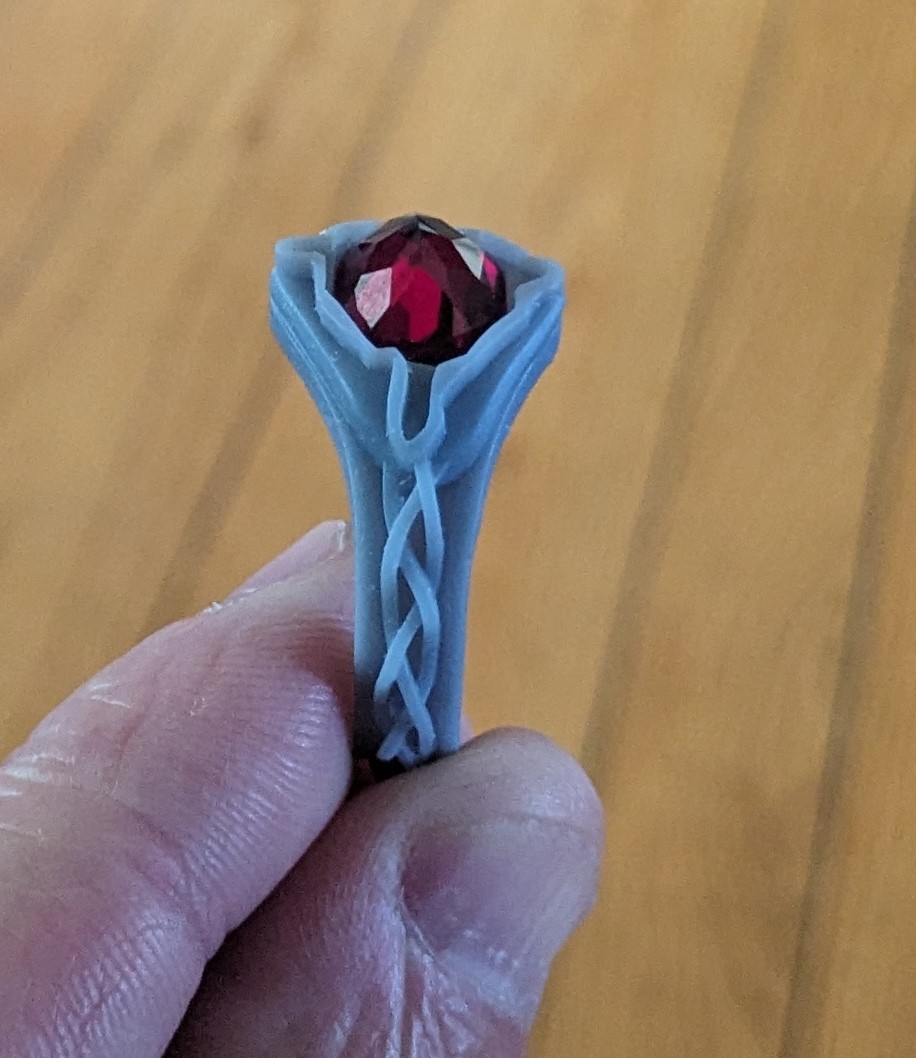

Thanks all for the interest - Sharing a few pics of the different models (some of them are still WIP) as well as the ring of Thror and my latest Narya print out.

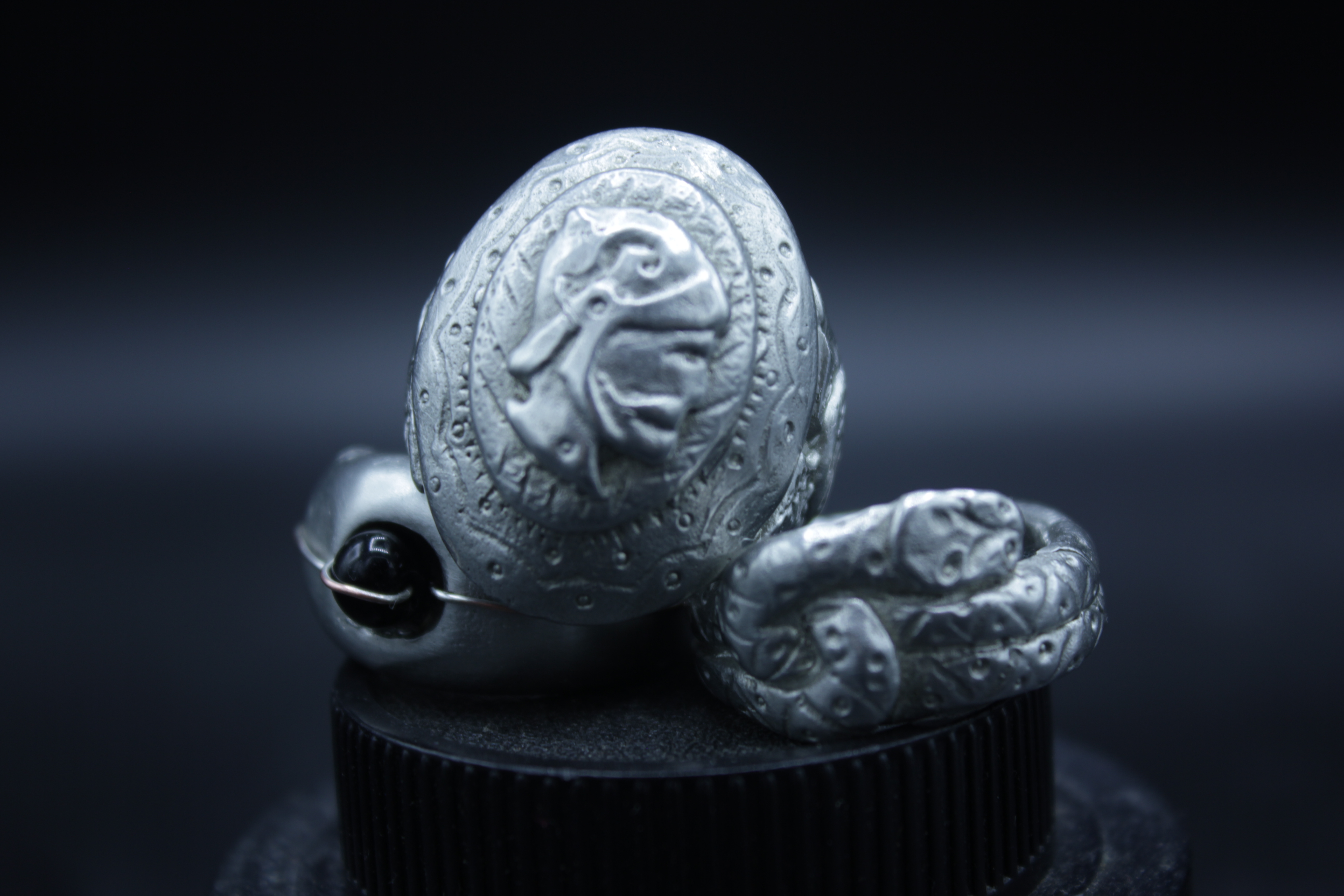

The only rings I ever made were for my Tuco GBU costume, and these were simply cast in tin pewter in rubber molds:

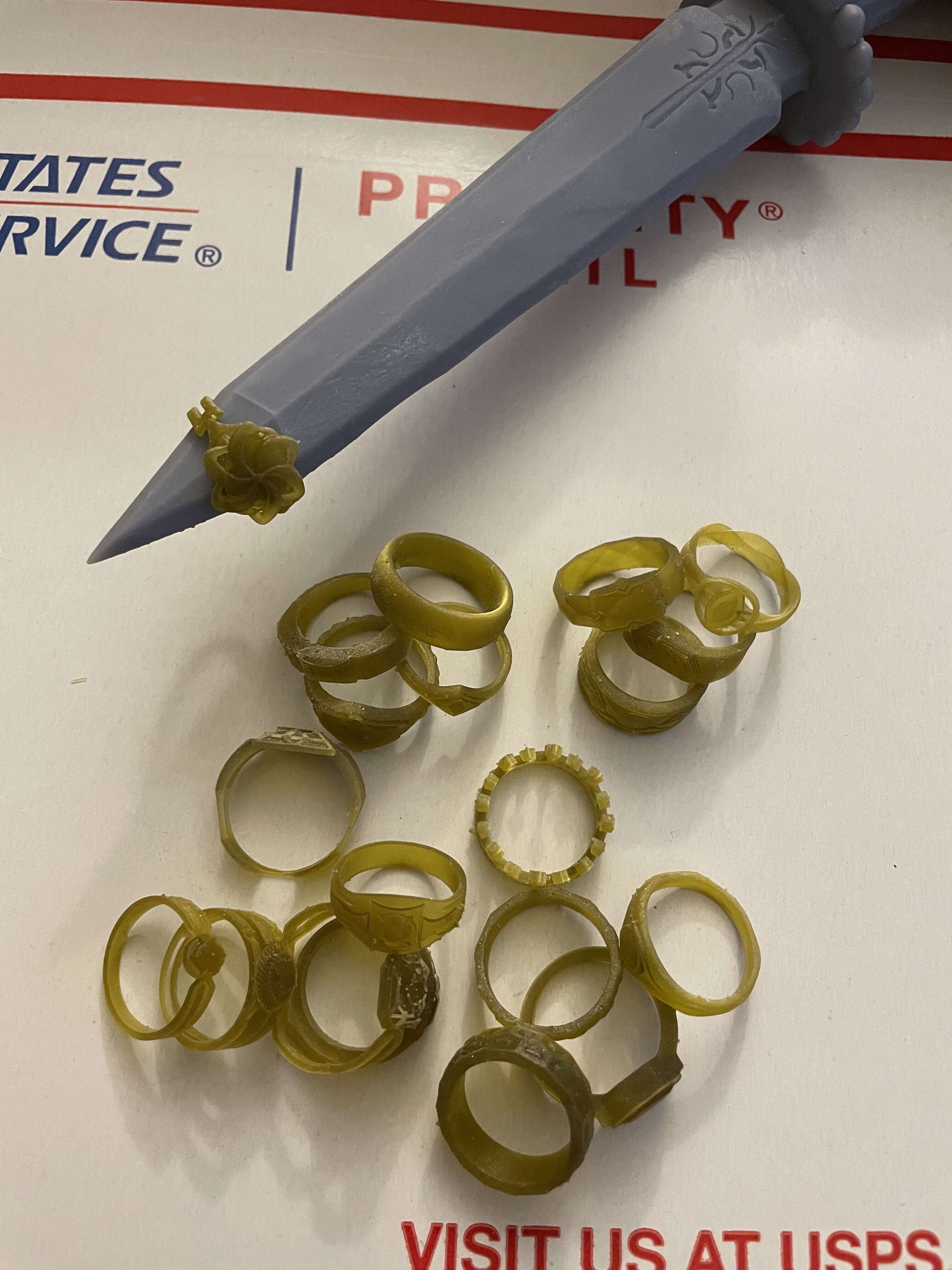

I do, I've got a little Elgoo Mars 2. I use it to print of prototypes before I send them off for casting.
Found some of my wax prints that I use for Lost Wax Casting. These rings were a size six and I made a few sets of rings going up to size 11.5. Each batch of rings takes about 45 min from print to cure. Using a tough resin would allow for electro plating, but this wax resin is for casting.

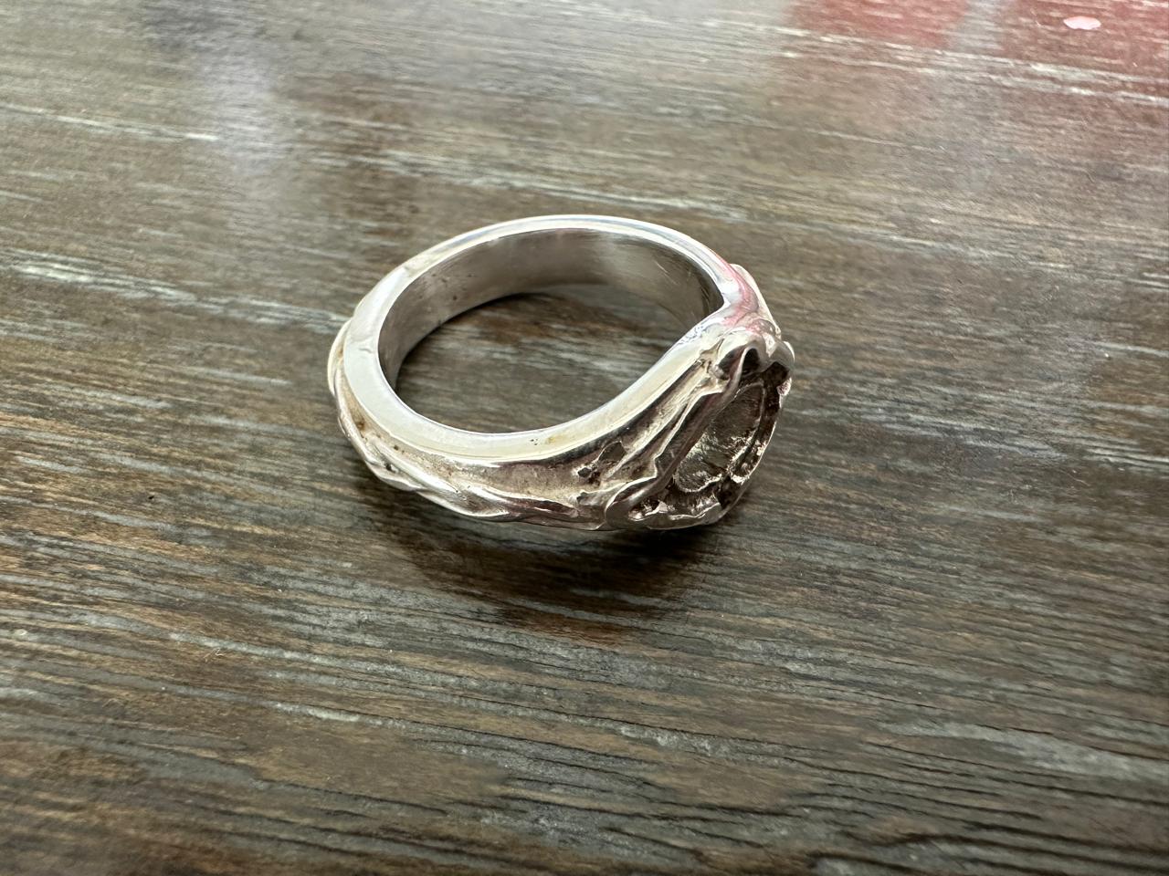

Rnmld91 That refernce is really awesome, I wish i'd waited and seen those before I made mine Narya - I ended up slightly fudging the braiding on the sides. The customer is still happy but I should spent the extra little bit of time getting it right​

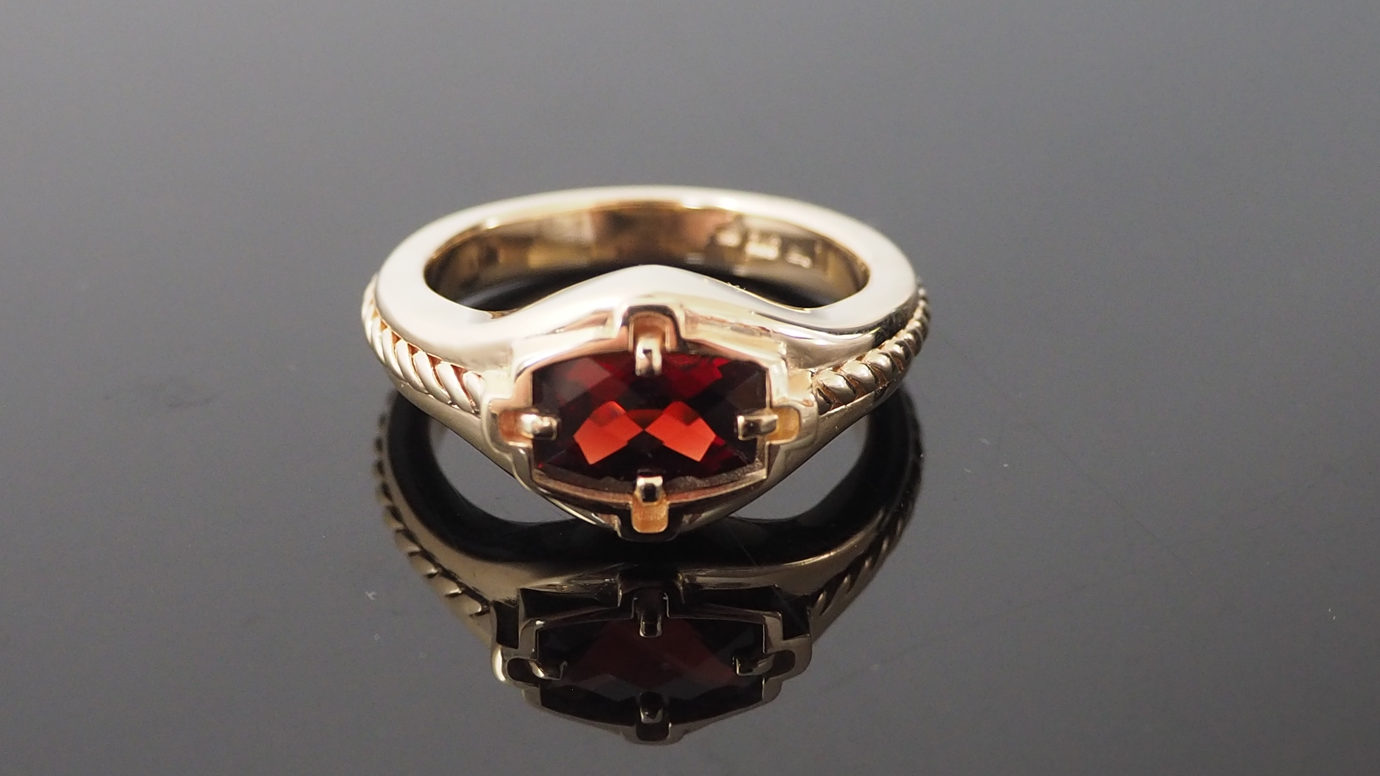

Here are my 3 rings done as a custom comission. I had to make some tweaks to fit the customer's needs and budget, all in 9ct gold. Nenya is much smaller, with a 5mm diamond. I think the original was probably more like a 10mm or something massive but this was for an engagement ring so customer wanted to use a diamond and not something cheaper. Vilya is a natural Sapphire.
Narya has a garnet, I had to change the shape at the top a little as customer didn't have the budget to get a stone custom cut for the project. This was the closest that I could source. It's not a bad fit but it doesnt come to a point at the edges like the original. And obviously The braiding around the shank isn't accurate.
As a take on the 3 rings i'm pretty pleased, though i'd like to redo Narya with a better matched gemstone and fix the braiding. Maybe i'll just make one for myself.

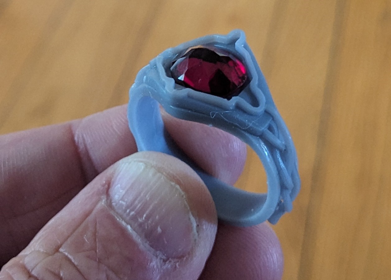

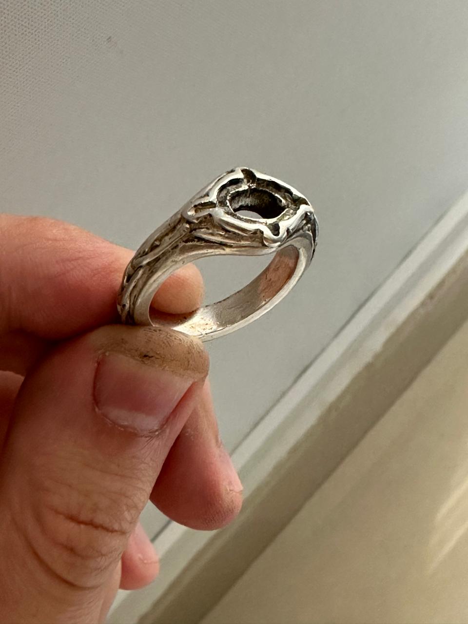

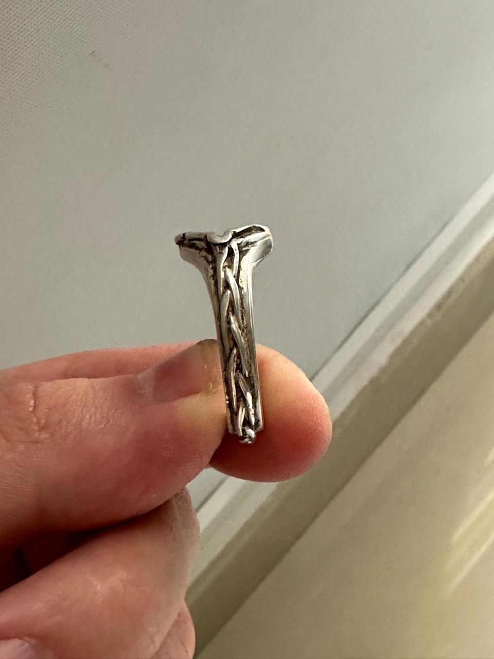

Here's the latest progress on my sterling silver Narya replica. I actually ordered a custom cut garnet, but I recently found out the cut wasn't as accurate as I'd have liked, and it didn't end up fitting into the "setting" I made, so it was really poor planning on my part. Next time I'll probably plan the ring around the stone size and shape to get a better fit.

Those are some really impressive rings!! It's always satisfying to see precious metal and stone versions of the rings of power, specifically Narya which is probably my favourite of the three. Were they 3D modeled by any chance?
Here's the latest progress on my sterling silver Narya replica. I actually ordered a custom cut garnet, but I recently found out the cut wasn't as accurate as I'd have liked, and it didn't end up fitting into the "setting" I made, so it was really poor planning on my part. Next time I'll probably plan the ring around the stone size and shape to get a better fit. The braiding pattern gave way at one point, you can kind of tell some of the silver melted around the main bezel as I was soldering it to the band.
