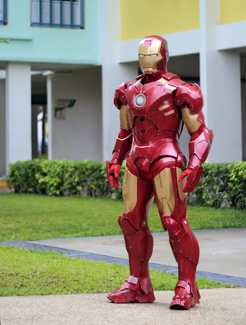

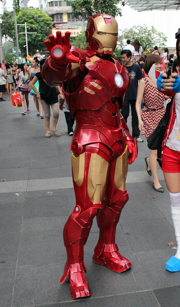

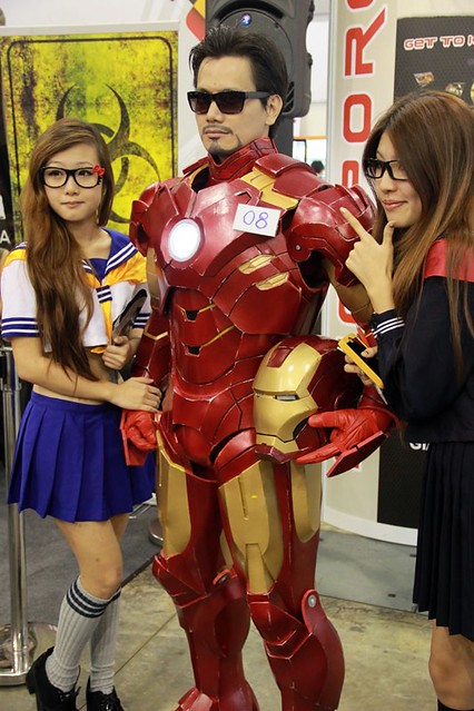

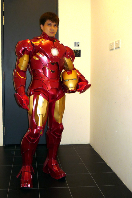

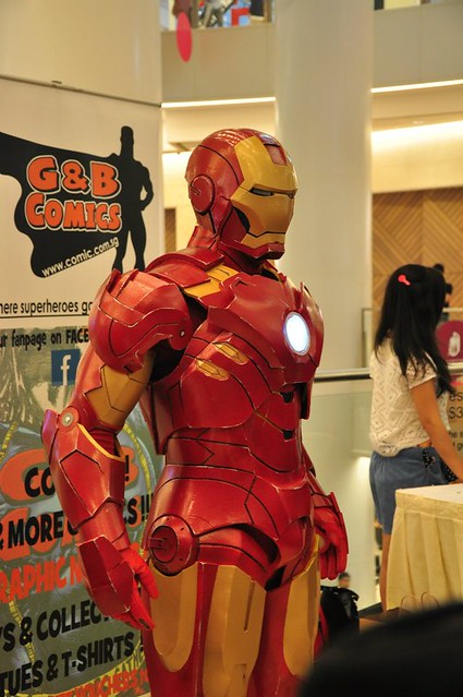

Hi! I think it's very cool that you are using XiengProd's templates as they are great for the beginner level. If you need reference for any of the details, a great example is roy. His suit has amazing details, and he has pictures showing it from all sides. It is quite honestly my favourite Iron Man suit, and you can see some of the work-in-progress shots on this thread here: Our Iron Man Mark IV. Other great examples are on this thread: Show me your Iron Man suit. I hope this helps.
(roy I hope you don't mind me using you as an example :) )
A couple of photos:)
(DISCLAIMER: These photos are in no way mine, but photos roy has posted on his thread and the Show me your Iron Man suit thread)
