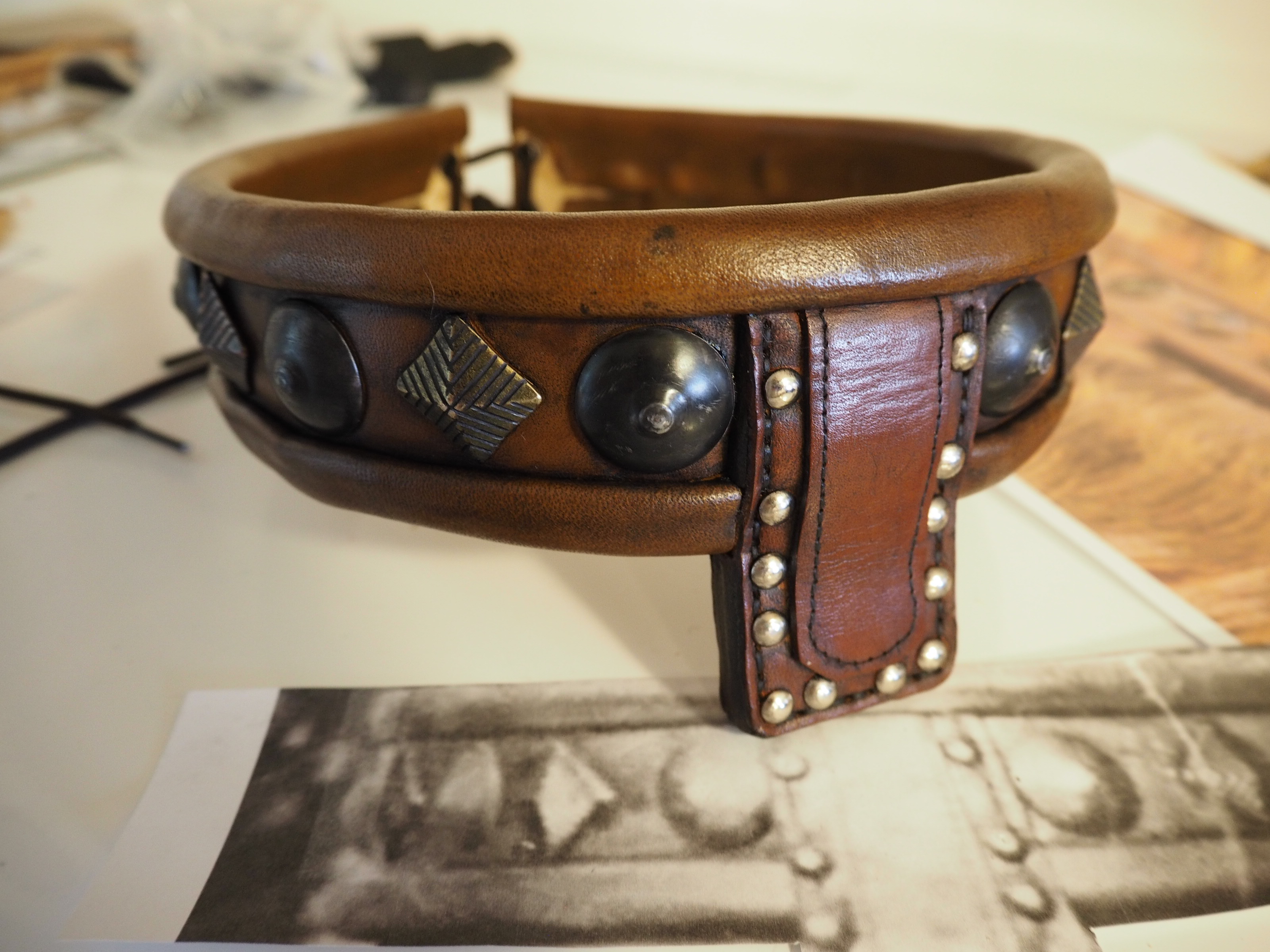

We are almost there ...
Comparison shows coloring, dimensions etc. are ok. The nailsheads in the original seem a little bit more domed – maybe one thing to optimize in the future, when I am able to find suited nails ...
