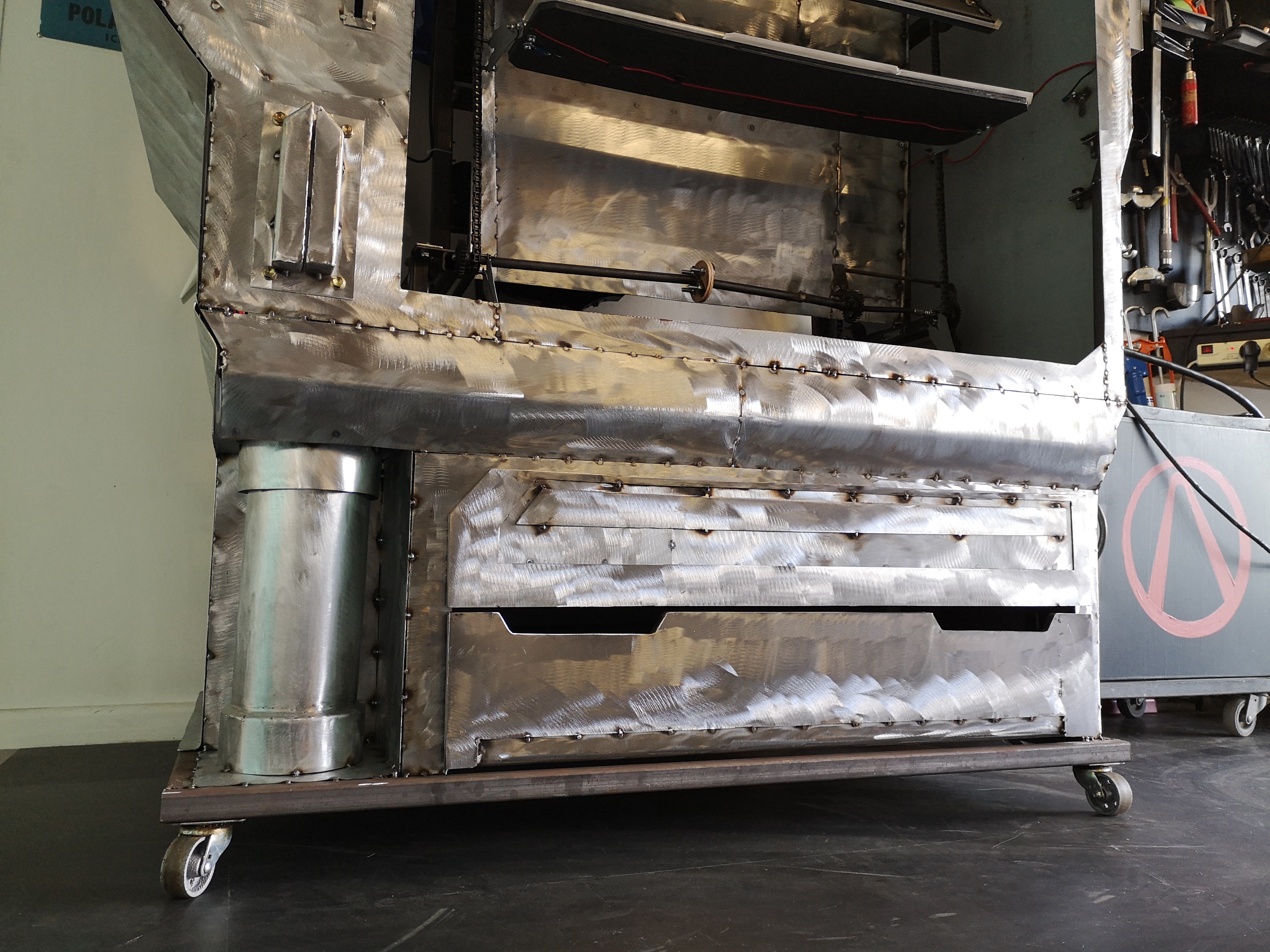

Finishing off the final details, have completed the cylinder in the bottom left corner.

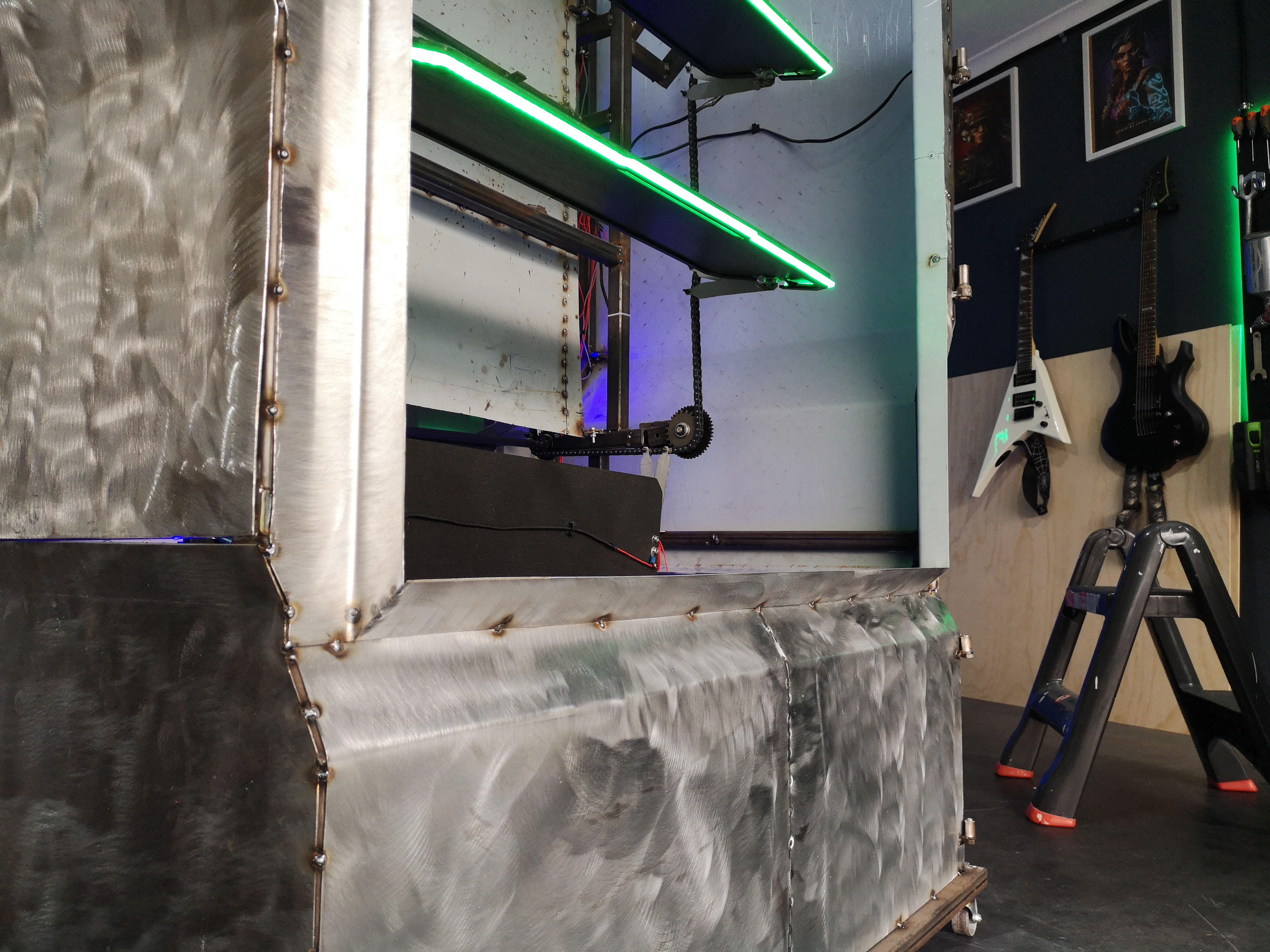

Spent a few hours last and this weekend doing a few cover panels around the back. Pretty much ready for the back centre panel and the roof. Those will be the only panels made out of ply - the machine is bloody heavy already so if I can avoid adding another few kgs of sheet steel that noone will ever see then now is probably the time to do it.
The back panel had to be modified to clear the shelves. I noticed that they were protruding slightly past the frame a few months back but didnt want to modify the chain drive since it's been working so well - so thats why the back has flat sections aroudn the top and sides, but the center will be protruding by 40mm.

Ok I think I'm going to wrap it up at this point. I've had a good look at the finish, and I think getting this ready for primer and paint will be a bit of a nightmare. So I think a brare metal finish will suffice in this case. However I think I've learnt that when I make other replicas I'll make sure that every component that I finish is in a state that's ready for primer. Or perhaps I can prime each panel as I go - gives it time to shrink and cure anyway if I'm going for automotive-finish quality.
Thanks for sticking around with me - it was a great way to keep myself busy during covid, here is my small attempt at a "cinematic showcase".
